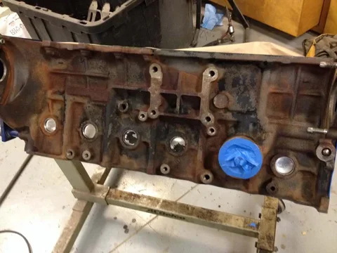

Started on the block too. Taped it all off to keep it clean. Wire brushed everything real good even found a dremel cone shaped wire brush that was great in the corners and tight areas. I never used the engine primer but since everything suggested using it, went ahead. Shot 2 coats of black.
