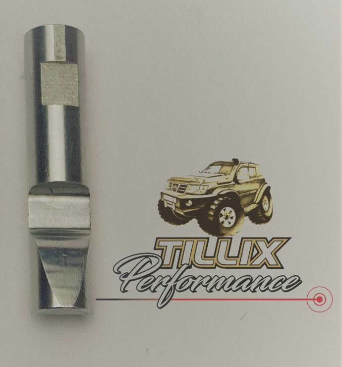

Hi all, I’m after a 1hdft boost pin, can anyone help or direct me to a site to even obtain an aftermarket one ?
Thanks
Trundles Automotive out of New Zealand. They also sell a taller cap and various springs.

Just found a local AUS guy wth an interesting pin, ordered so will report. Bought a spring in the up to 20psi range s well, he as various springs as well as diaphragms.
Priced to please!
Priced to please!
He doesn't have any shipping options for the US. Does anyone else in the states have interest in this? We could maybe do a group buy?
I own Tillix, I can ship to the USA using DHL or Aus Post express.
If you found a few people that want to buy them it would be alot more cost effective for me to ship them all in one hit, then use the US domestic postal system to get them where they need once they arrive there.
