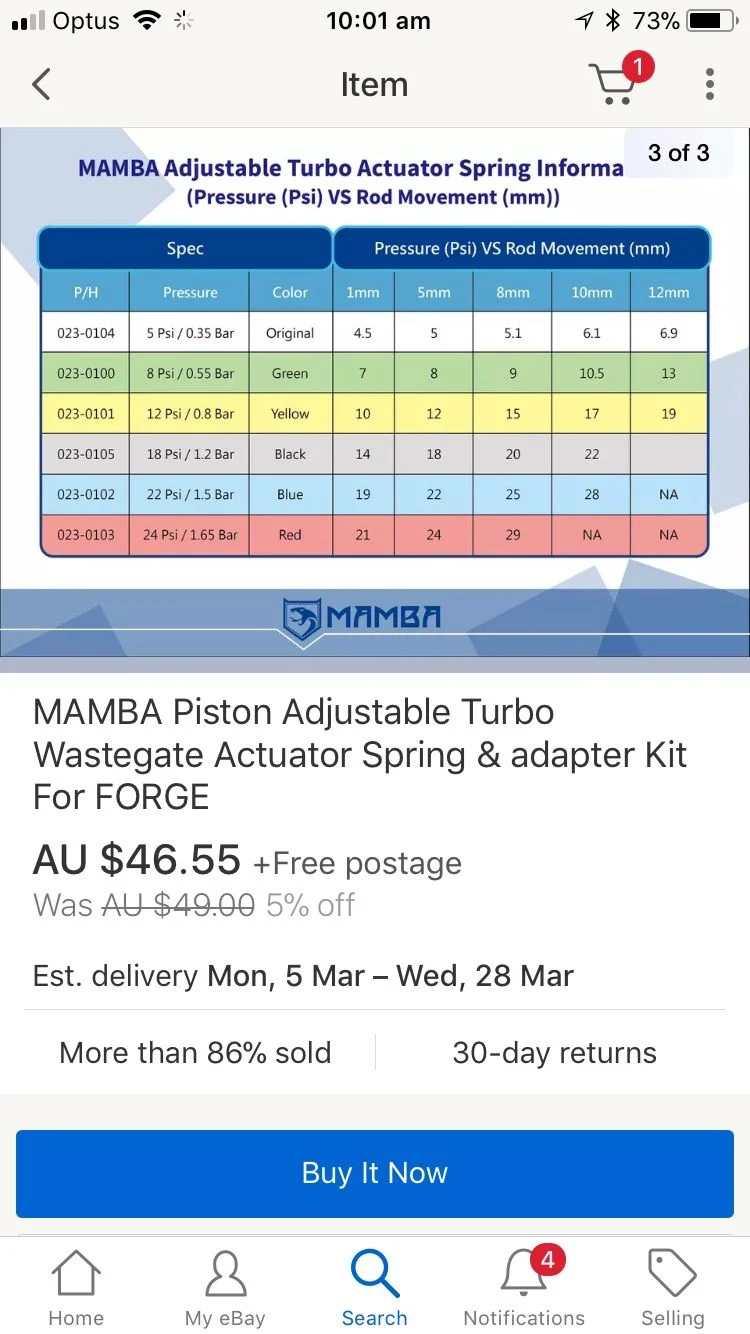

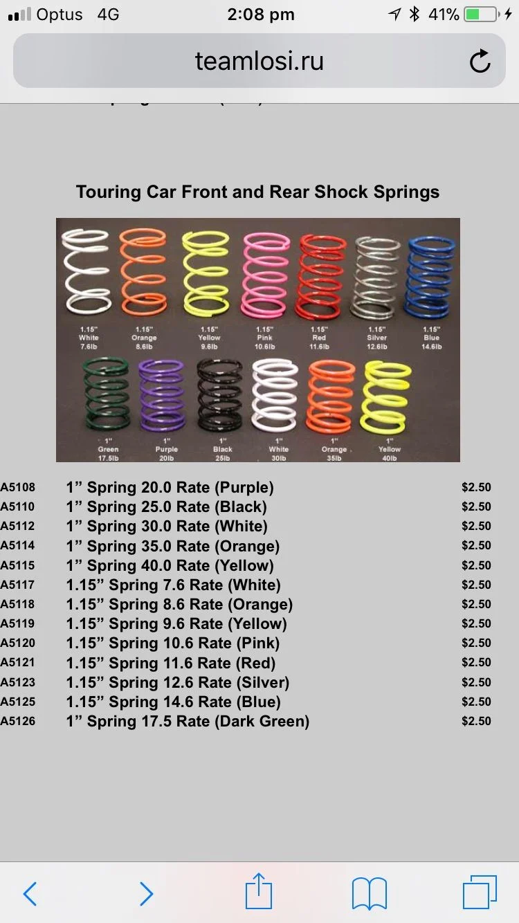

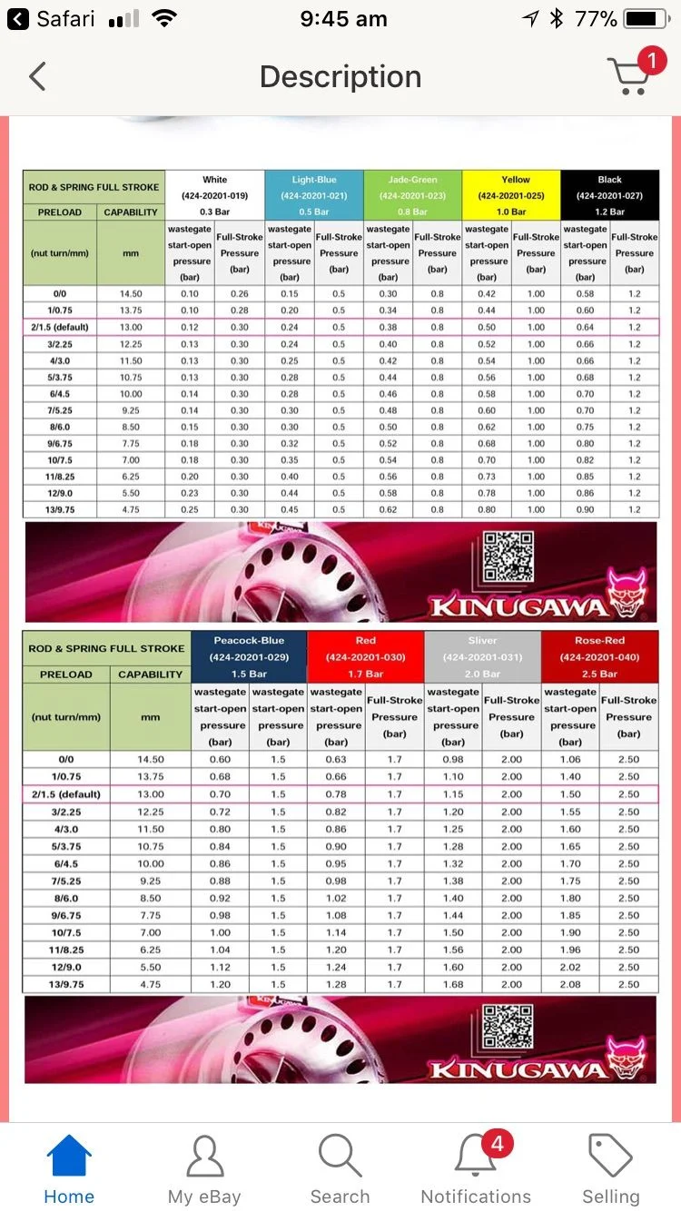

Anybody used RC springs or wastegate springs for the boost comp? I’m probably doing this the hard way but I like the range and data you get with them. Got a feeling the RC springs are going to be too small and the wastegate springs will be too big tho

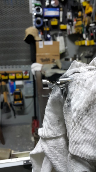

my pin ..

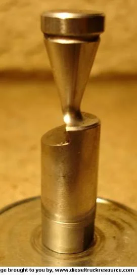

If u make the deepest part of the grind higher on the pin you'll get smoother transition, easier to tune fuel ramp in . The idea is to have it deep enough to max the follower pin travel. And rather than the reverse taper (Toyota overboost protection style) after the deepest part on your pin just make a step 90o to the pin . That way it won't de fuel with a slight over boost it will just stay in the max position . Kind of like the pic
noted .. makes sense ..
