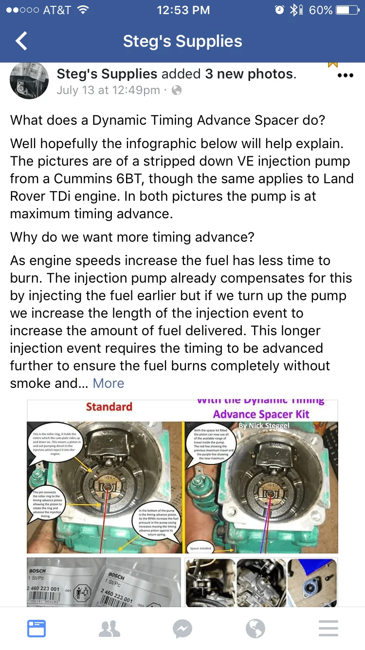

Thoughts on advancing timing kit?
I have been looking at this recently.
Have a look at your pump. Mine has an Allen key grub screw in the end.
I'm not sure if this would adjust the range for the dynamic advance, or the rate of change or both.

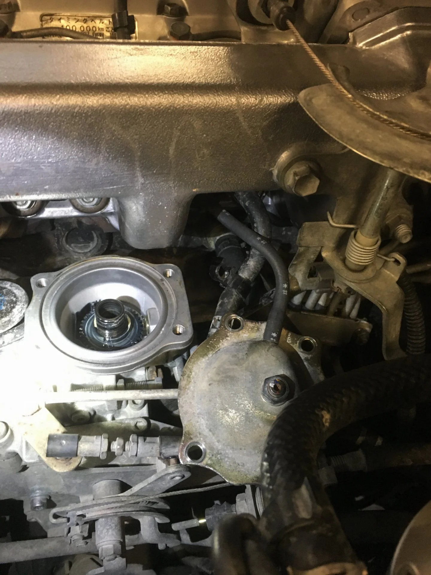

I've been playing with mine some more lately whenever I get some time. I got the shim out of there so the pin moves deeper into the pump last time I posted, but had completely backed off the starwheel in my previous tuning efforts, meaning fuel dumped in hard when it came on boost, but pin travel was limited by the remaining shim. So it wasn't extending further than I wanted, just going to full fueling sooner than it needed to, resulting in a puff of black that clears quickly during the day, and a heavy haze with headlights behind me at night under full throttle, and some big grins. I'm now winding the starwheel back up until the exhaust clears up, or the performance drops off, whichever comes first.
I'd peg the performance gains at 15-20% over the previous tune, it's much more fun to drive, and much more eager to be driven enthusiastically. Low boost and constant load is unchanged, but as boost comes on so does the fuel now, and it goes nicely. I'm able to lead traffic from a red light at medium throttle now, whereas it was a full throttle job before. Makes maneuvers in traffic much easier, and highway passing is greatly improved, the new tune would bus length the old tune at highway speed. I'm averaging 18.4mpg over the last 10 tanks, including my tuning pulls from stop to 120km/h.

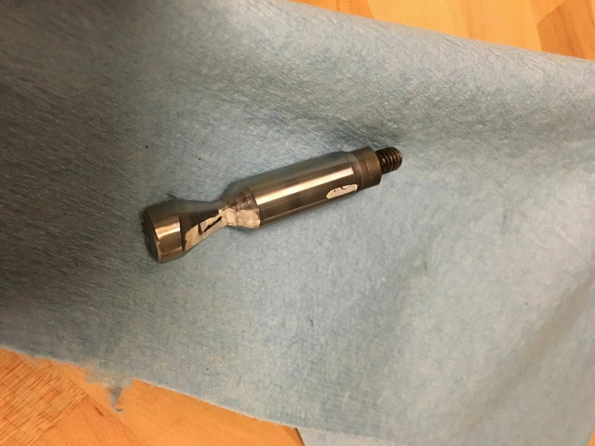

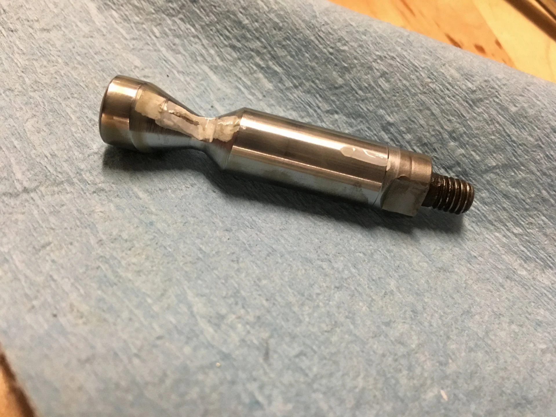

A few pics showing my pin travel, I'm repainting the pin and cranking the starwheel up about 3/4 full turn at a time, until I see pin travel reduced, or performance reduced, and back it off to final setting. With that done I'll turn boost down to 18psi and roll like that until I get the Gturbo installed, likely spring.

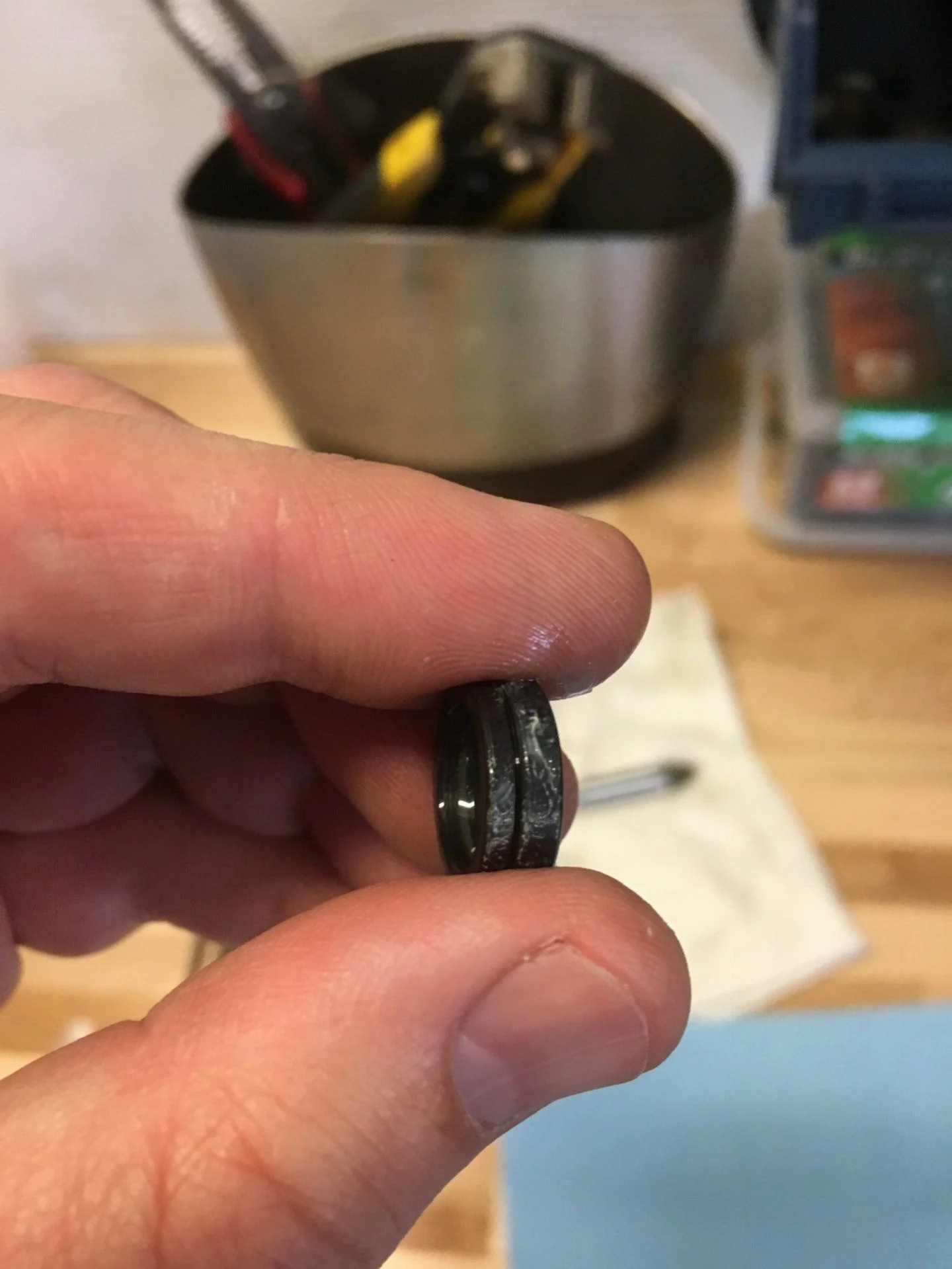

Played with the pump some more, further star wheel adjustments weren't seeing the pin move any further downward, and eventually bottomed out the star wheel. There's a couple of shims that sit on the top of the bore the aneroid pin goes into that were limiting downward travel, so I removed the thinner of the 2, and NOW we're getting somewhere! Bigger change from removing that spacer than from any of the other adjustments I've made to date!
Truck now gives off a small cloud when you punch it as boost catches up then cleans up quickly, engine pulls much harder and holds gears to redline much more readily, it's great! I'll monitor things and probably dial the star wheel back up a bit as time goes on.
View attachment 1530445 View attachment 1530446
I have a similar stack of washers in my pump. These were installed when my pump was rebuilt and bench tuned. I was told by @yotahed that the shims were there to limit max fueling. If I needed more on boost fuel I was to remove a shim or 2 until my egts and afr were decent. He also mentioned not to adjust the fuel screw for topend fuel only remove washers. The pump was tuned for 20 psi on the bench and worked very nicely. I upped my boost to 25psi and was running alittle lean so I removed 1 washer and am pretty close. 23:1 wot. Egts 1150F. Your results would seem to agree with mine.

I figured out already that i'm supposed to pull the fuel pin out of the pump and re-profile it, but is there a side-by-side photo of a before and after of that somewhere in all these pages that someone can point me to?

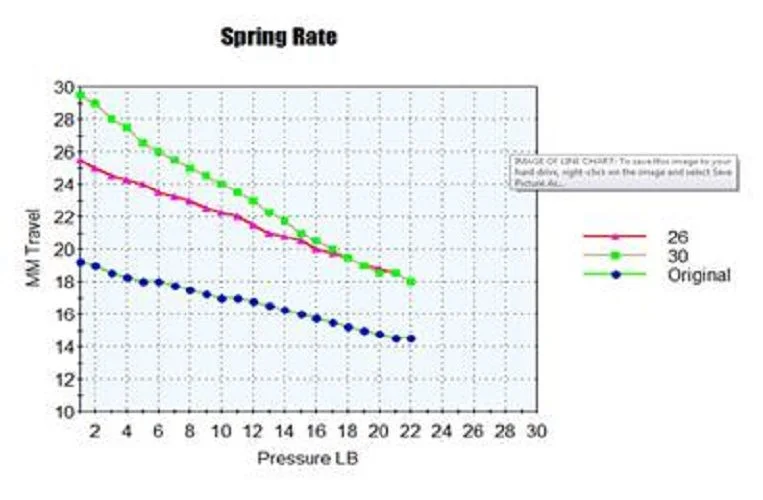

I have been tinkering with the pump. I could not really get the travel I wanted out of the old spring (19mm) so had two new ones (26mm and 30mm) made ($35 Cairns Spring works, free plug, good to deal with and can make anything). I also tested the springs to see how the performed under pressure as well as the original spring. Put the data into a graph because everyone likes a pretty picture.
Atleast I know exactly what the springs do. Reckon I will end up using the 26mm spring as it gives about 12mm of movement. I couldn't test any higher than 22lb because the cooking scales I used maxed out so there is actually a few more mm of travel in the two custom springs. The original is just about maxed. and to get the university to test them is about $1000. DOH.
Anyway. With more pin travel makes it easier for me to fine tune. I might change later to a stiffer spring that will help tune for 24lb. With the longer spring the start height is obviously high as is the height at which it fully compresses but you get more travel inbetween only 8mm for original and over 10mm for the 26mm spring.
I will be running about 24lb boost and these spring will handle no drama. You can get custom springs made easily and then its just trial and error.

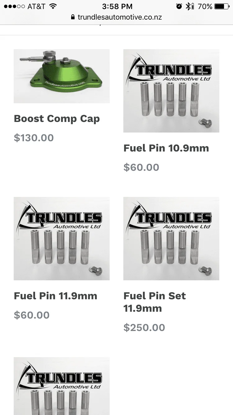

30 minutes after saying I'm done messing with my tune and I order a cap and pin.
Are the pins all the same profile? Or are there different profiles available like I've seen for the Cummins pumps? What does that cap do that the OEM one doesn't?
The cap is taller to allow more movement of the pin. However, they usually use a custom spring and shims to eliminate the star wheel. I ordered one pin, 8mm. You can order an individual pin or the tuner pack with one of each. The mm measurement is how much material is left in the pin. The lower the number the more fuel. I chose the least aggressive because I can always grind it deeper and leave my stock pin alone. He said you can also remove the pin and install varying diameter drill bits and cap off the boost line to determine the amount of depth the following pin needs to move to hit your target AFR at full boost. I guess the profile is all the same, just the depth is different.
