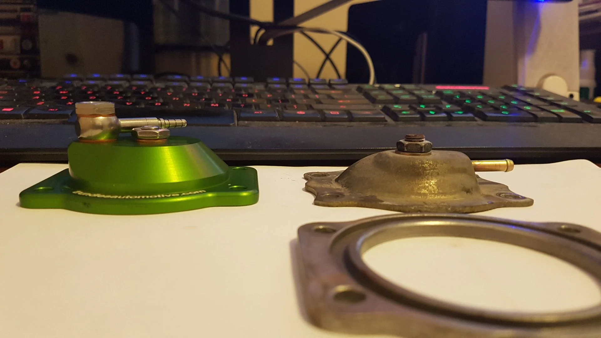

Anyway... Most probably the best solution is to go with a bosst compensator cover like your new one...

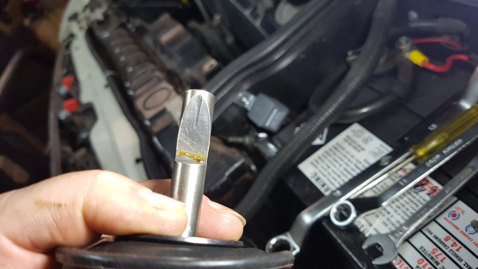

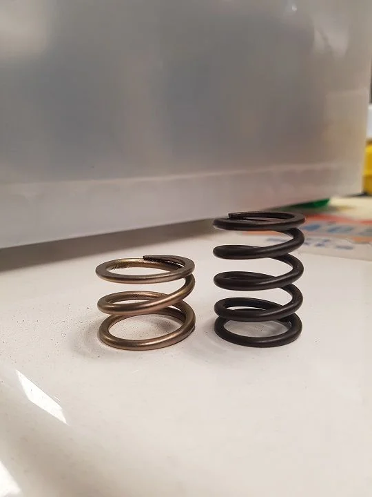

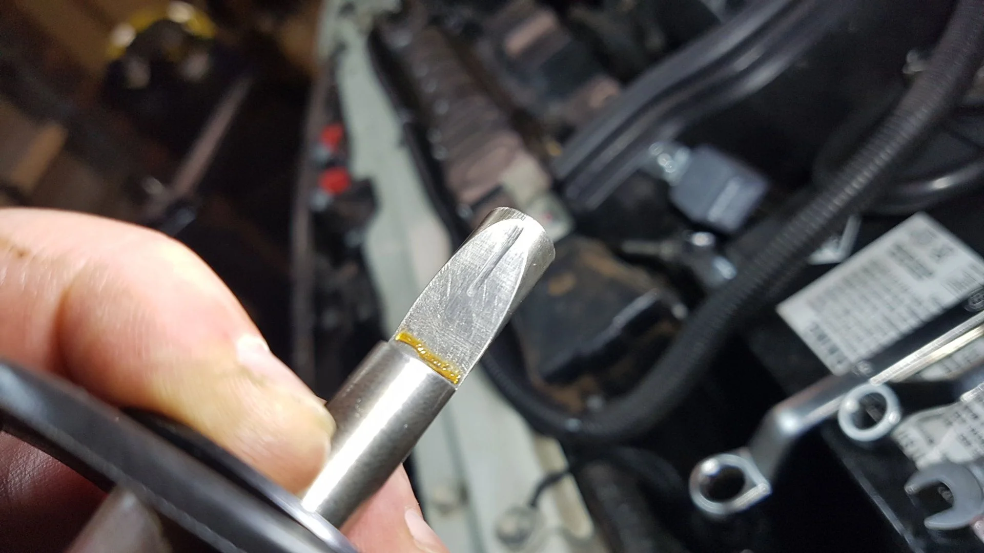

I am happy with the new cap, it has good off boost adjustment and looks bling :) The fuel pins, not so much, there made of stainless not chrome molly, and after less than 10,000km has worn a noticeable groove. I have gone back to my original ground FT pin, and the with new cap can get enough off boost adjustment to compensate for the lost height in the pin since it was ground down to the nut at some stage. Also happy with the stiff spring, and removing the star wheel, using shim washers to adjust spring tension

Hey SeaJay, could you please share the measurements of the 6mm PIN please? If you have a digital caliper will be great!
