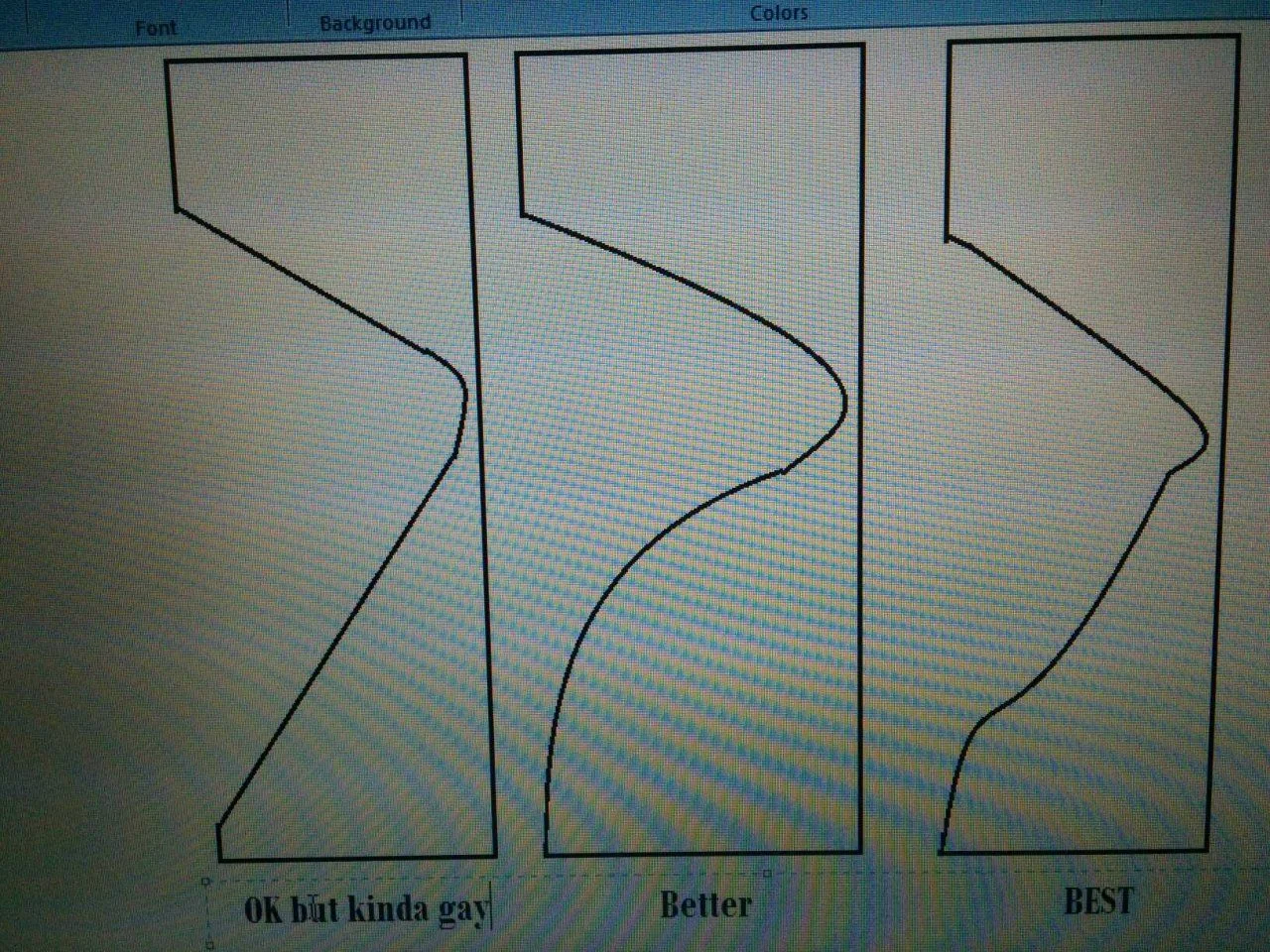

Its going to be a balance to find your optimum spring tension.
You want the pin to travel full depth for maximum fuel.
With the far right fuel depending on your turbo it would be nice to find that sweet spot of cruising boost for the highway where your not fueling excessively so to speak. Mainly being the pin is indexed right before the steep part of the roller coaster (remember the pin travels down into the boost comp to fuel more)
That way you can punch it, your boost will launch up, and you will be into more fuel.
Reason why TBB uses the pin he does it to maximize full throw and get max fueling of the aneroid.
By allowing the pin to be hollow so to speak at the higher boost levels it gets his pin to full throw.

= in the above pictures you have not allowed enough room for the fueling pin itself. And every truck that runs different loads/intercooler/fuel pump/injector condition etc etc will require a different grind. Its that simple

Hi rebuilt80,
I think the problem is the same as 90% others experience who try to tune themselves and usually wind the main fuel screw in too far searching for the holy grail in power :)
It's simply that the spring tension isn't high enough such that pin depression at 24psi is enough to run the aneroid pin profile follower up the reverse taper (overboost fuel cut).
You can get around this when tuning by:
A) increasing spring tension
B) using washers installed over the pin to limit maximum depression
C) grind away that area.
I typically do C, because it also allows better fuel control - I grind the increased fuel profile further into the pin in the area it's usually defueled. So this gives a longer pin travel/wider area of operation for the spring

I'd love to see any additional tuning guide you could send me. I understand what you're saying, and have originally ground the pin as per your instructions that come with the turbo (I'd like to make the grind a tad more concave towards the last third to bring in a bit more fuel in the mid section) and tuned it to a safe variation of your instructions. I don't recall exactly how many turns I put on the star wheel but it was quite a few, and was under the impression that I was close. Early boost was good and reasonably clean as per your instructions, its just the flat spot at the upper end that's confusing me. I don't understand the theory required to get it to push through that spot - is it more RPM/ gas pressure/ more fuel or more air?! As is the case with most tuning, I suspect its a combination of both, it just seems to be a very strange spot to have a flat spot.
There is no flat section left on my pin either, the grind goes all the way back to max fuel which is a continuation of the original grind in effect, just a little deeper.
Again, I'm just trying to understand what is causing a flat spot in the boost curve, effectively... I can't see how the spring tension is affecting it. If its travelling too far and trimming fuel back out, then surely it wouldn't go past the 19psi or so, and the EGT wouldn't rise up hard after it pushes past (under WOT) unless there is some sort of fuel pumper/secondary I don't know about?! That to me says its getting the fuel it needs through to the max, its just got a flat spot. My thought would be to add a concave in right towards the end similar to the pictures a few posts back ^^^ More fuel around that point would help to push it through and continue to raise boost/turbine pressure/BC pin etc. (this is very ghetto backyard thinking, but everyone starts somewhere I guess!)
Am I close, or is the key in the spring tension do you think? Happy for anyone to chime in that can help, I'm surely not the first to experience something like this during tuning.

Does anyone know of the spring rate is linear, or does it tighten up with compression? Is there a point where the star wheel is so high that the spring will actually restrict the travel of the B/C pin? Is the starting position of the B/C pin in relation to the metering rod pretty much constant no matter the spring tension, ie when you fit the cap on (with the smoke screw/slanted disk ground off and the top of the B/C pin ground down to the nut) does the pin always start in the same position, and then its just a matter of spring tension, or does spring tension drastically change the B/C pin starting point.
the spring does tighten up with compression.
It can affect it depending on how much you have the start wheel turned out (more spring tension) or turned into the housing (decreased spring tension)

Following up on my post a little while back, I've made some changes;
Tightened the spring up two full turns - this was to get the starting position of the B/C pin high enough so that the fueling pin starts at the full diameter section of the pin.
added one 2.1mm shim under the pin to restrict its travel depth
Ground down the top slanted disc/smoke screw as much as I dare without compromising the o-ring groove.That resulted in a slightly less responsive feel down low, AFR was less likely to move off '30' or 'at rest' during normal suburban driving and was still experiencing 800+ degrees (pre) at full load (we're talking maybe 10 sec of WOT/foot to the floor up a gradual hill) however AFR's looked to stablize around 20-21.
Wanted a bit more low down response so loosened the spring off 1/4 turn and added another 2.1mm washer under the pin to try and restrict top end fuel a little. AFR's became a bit more responsive
Still seeing the higher temps at the top end so trimmed 1/3rd turn of fuel out of the main screw.Idle has dropped about 30-40RPM
AFR has moved a little closer to 30 during each spike of movement. LEaving the lights it would dip to 25 say previously and then return to 28, now it dips to 27 and returns to 29. Its moved up the scale of lean-ness but seems to head the right way quickly (lean) when the boost catches up to the fuel.
BUT, when standing on it at 95 and getting to 100, AFR is stable about 16-17...!! :( This was not the case before. Fuel screw must have been wound the correct way as the idle dropped so its not additional fuel... Pin has 4mm underneath it so it shouldn't be getting too much fuel and boost seems to be not that keen to move past 22-23. If the pin is restricted for depth by the washers, surely we shouldn't be getting to much fuel, but if the boost was able to go higher, that would correct the AFR issue...!?
Seems like I'm starting to chase my tail a little. Happy with most of it, just the fueling at WOT with the TC locked up. Did a test yesterday with the TC manually locked up from 60km to 100kmh, AFR was stable around 16-17 as well, but thats not a normal driving situation. Fairly smoky and obviously very hot... All these tests have been done towing my work trailer which is fairly heavy at about 2.5tonne. Ambient temps's are around the 25deg.
Thoughts to address the top end??
Thanks

Another pointer is that for fine tuning, don't be afraid to adjust the maximum pin depression by using washers installed around the pin to restrict it's movement. This is done at the end of the tune to raise the afrs. Of course you can always add more spring tension or unwind the main screw, but if the ramp is nice and "just matches" the turbo, the tension increase or main fuel screw unwind will have a noticeably adverse affect on the spool up. So, everything else being good, the washers work well to raise up the afrs without affecting drivability. Not that I often do this....
Another trick in setting the pump up is to remove the aneroid pin completely, set boost level on turbo and adjust main fuel screw to desired afr target at max power. Well, torque really. I tune mine at 2000rpm with this method, but you should check how the afrs change with rpm at full throttle, as intercooling efficiency, turbo efficiency, air filter restriction and pump condition (as it affects the fueling vs rpm curve) all contribute to how the afrs change over rpm with boost set to 14, 25 or whatever you run. Then don't touch the main fuel screw again.
Everything else done is for minimizing smoke. Note that turbine drive energy on a 1HDT seems to fall away below 16:1 and it's smokes like a steam train at this AFR anyway, so 17 is the lowest I like to see as the base off boost setting. There's more time for combustion to take place at the low rpms, so 17:1 at 1400 looks better than at 2500!
Happy tuning
In any case, pick a number, target that. Set main fuel screw to get your target AFR (suggest 21:1) at that rpm and see what happens to afrs from that rpm to redline. Make sure it doesn't dip below 20:1.
Reinstall pin, set afrs to be no less than 17:1 steady state at the earliest point of lockup (1400rpm~) in 4th.
Then, with a bit of mucking around, following the procedure outlined earlier will result in a great tune that's the highest performance that has a respectable exhaust and be on the higher end of acceptable EGTs.
On the std turbo, there won't be a heap of boost at 1400tpm, so you shouldn't see a huge dip below 17:1 when you stab it.
I would personally do what G mentioned about removing the aneroid and setting your max AFR under full load.
Your first tune didn't sound too bad but you said it lacked a little down low. Make a note of that.
Its going to be finicky.
So by loosing your start wheel off and reducing the spring tension by 1/4 turn your going to make the pin it more responsive to boost (travel deeper). Another shim was added to try and restrict the top end. The second tune you did sounds like (because your running a turbo that boost really good down low aka the GX) the aneroid pin is getting enough boost that its indexing where its getting too much fuel at highway cruise.
I would tighten the star wheel back up in that case.
