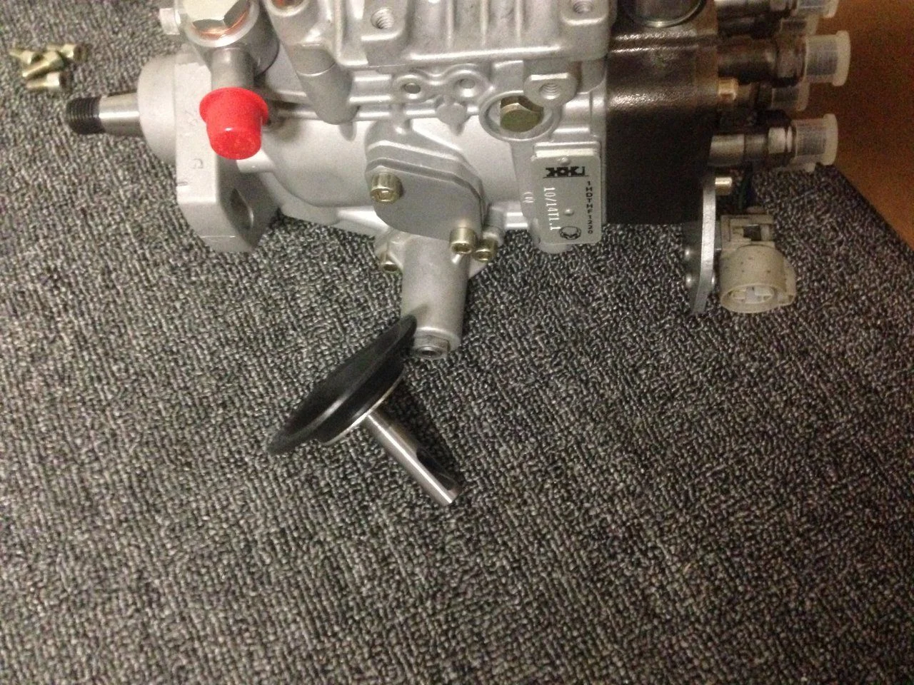

Just to put this silly push rod business to bed. This is how we do ours. Its milled/machined from 4140. They are done this way so we can then case harden them without the fear of the pin warping to give as good service life as factory chrome plated. These have been fine tuned to the pumps to be very close indeed to the correct tuning specs for the given parameters. But fine tuning adjustments will always need to be made due to many variables.
The same cant be said for custom tuning push rods (not our pump). They need to be ground and are left with a polished finish.
