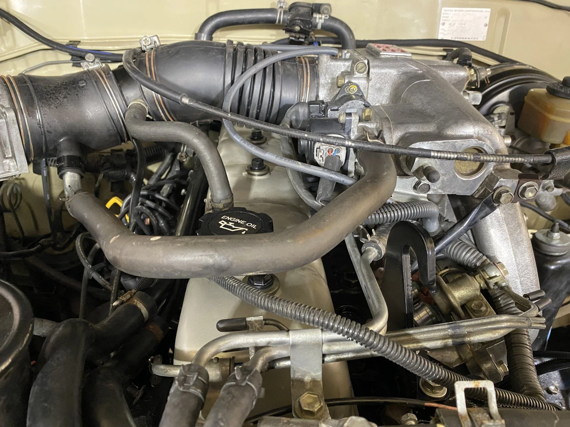

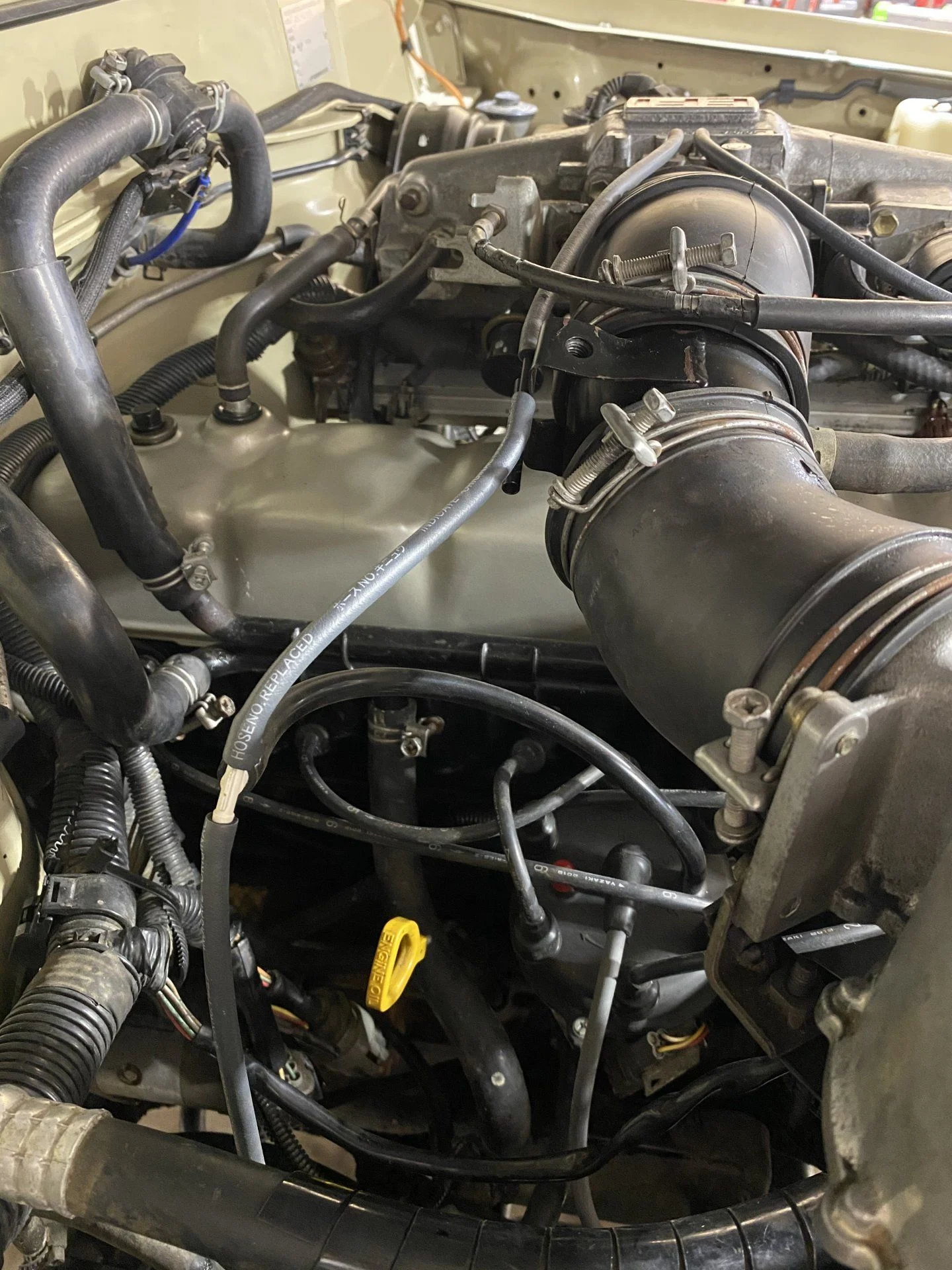

I lied. I grabbed that other vacuum Port off the top of the intake and put my dissy and charcoal cannister in that using a T
Anyone have any reasons why that’s not OK?
This is about as simple as I can make this 3FE. Lots cleaner than before.
RPMs pull nicely to redline and it seems to still make power above 3500 better with the bigger head. Now I have to get some miles on it.

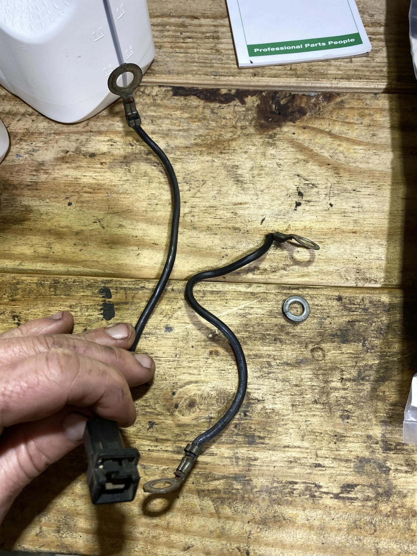

Still can’t find a home for these grounds though.

Now's time to wonder if that ground you can't find is EFI related.
I added a couple of grounds. One to head and one to plenum just to see. No change
