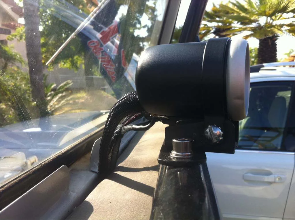

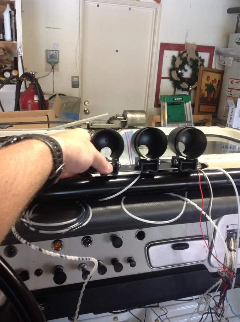

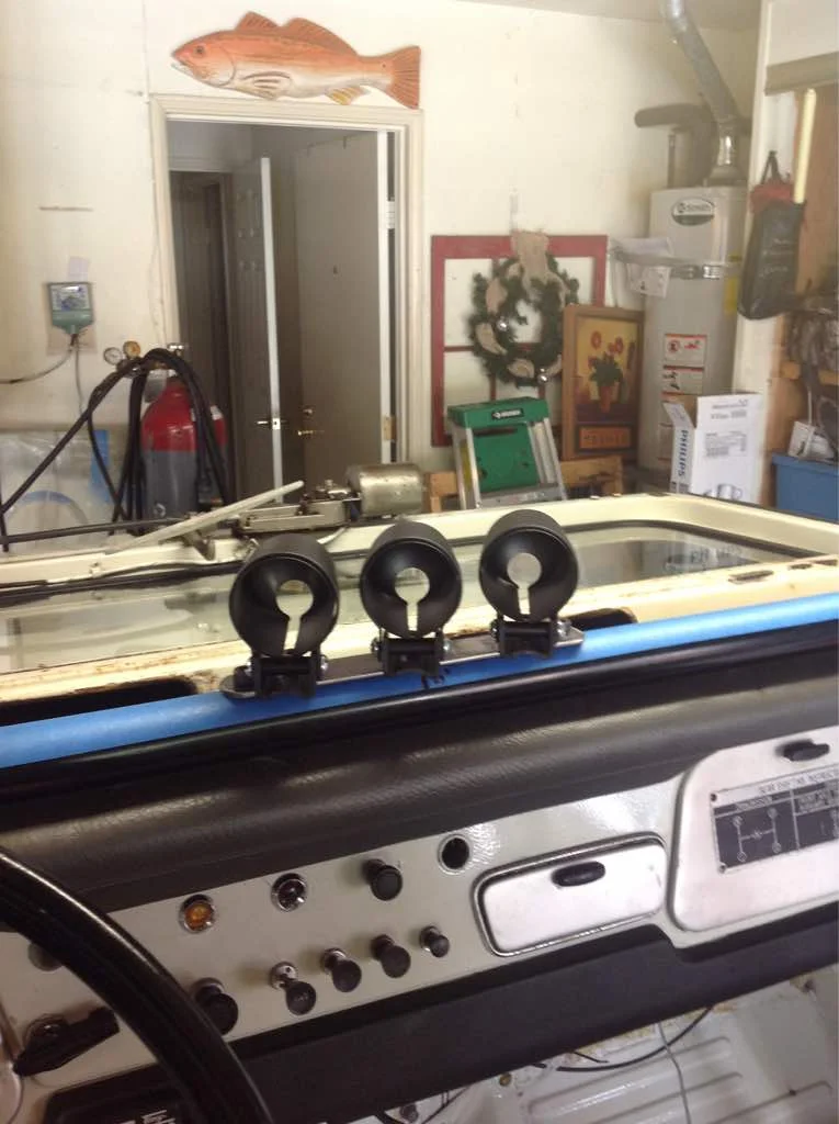

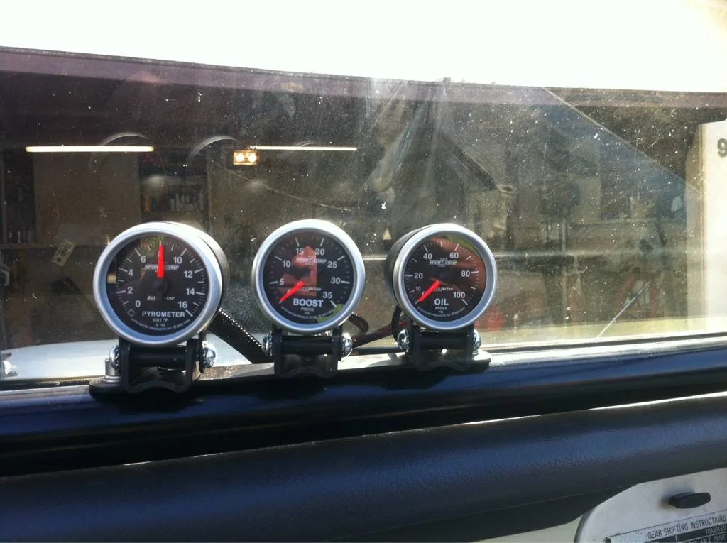

Working on gauges today. Part number for mounts: Autometer 2204
Thoughts on placement? I think I like the middle better, plus it will give the kiddos something to watch...

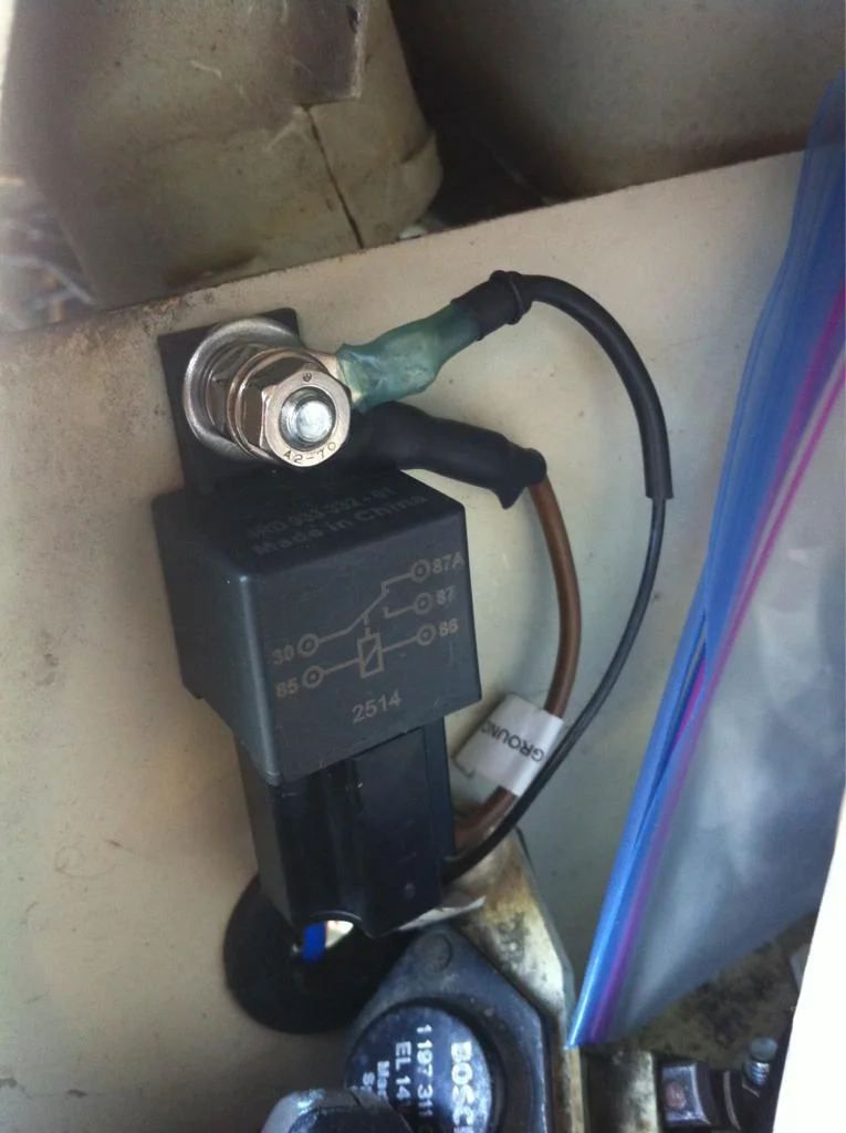

By the way here's how the gauges turned out...
I used a relay to activate the LED back lights, pulled in via relay and powered by the battery, so I wouldn't add any load to the headlight circuit.
Relay is in the glovebox. Terminal is under the glovebox...

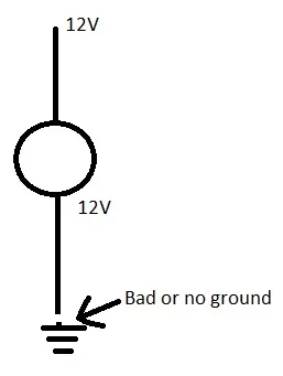

FYI....grounds always have voltage on them when they aren't grounded....it doesn't mean that any wires are shorted. As a matter of fact, if you had a true short to ground, you would blow a fuse. Clean your grounds.
Just to make it visual......
If you have a bad or no ground, you'll see voltage on the ground wire.
