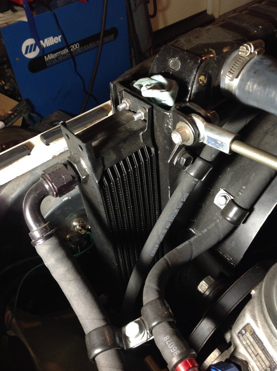

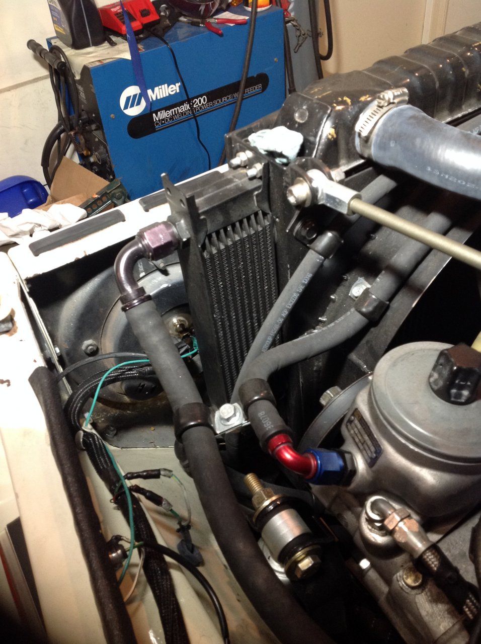

i've been going through your tread again and again as i'm finally moving along with my swap again. you said your OEM oil cooler did work out for you. do you have any shots of how you have it set up? you are using the fj40 radiator right? you've just modified the fan shroud is that correct?
I'll get some pictures for you this weekend. Honestly, I think my oil cooler placement could be better, but it is what it is. However, I haven't had ANY problems running it hard in any conditions, even 115* temps here in the summer....

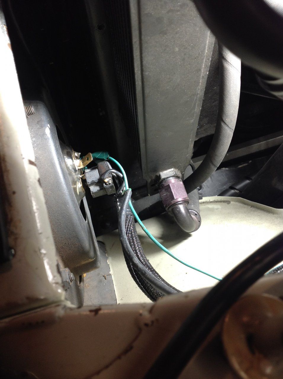

do you have any pics of your oil cooler set up? i'm still trying to decide how i want to do it and more ideas are better if course
I totally forgot, I'll go get some right now...
Probably does not get as much airflow as the OEM set up, however Space was at a premium. I've kept my eye on the oil temperature after freeway drives with him infrared temperature gun, and the temperatures did not seem obscene to me. That said I can't remember what those temperatures were, ha ha. I think 180-185ish
You could build a pretty sweet rear shroud for that with an under-side scoop, looks like there's an opening below it.
