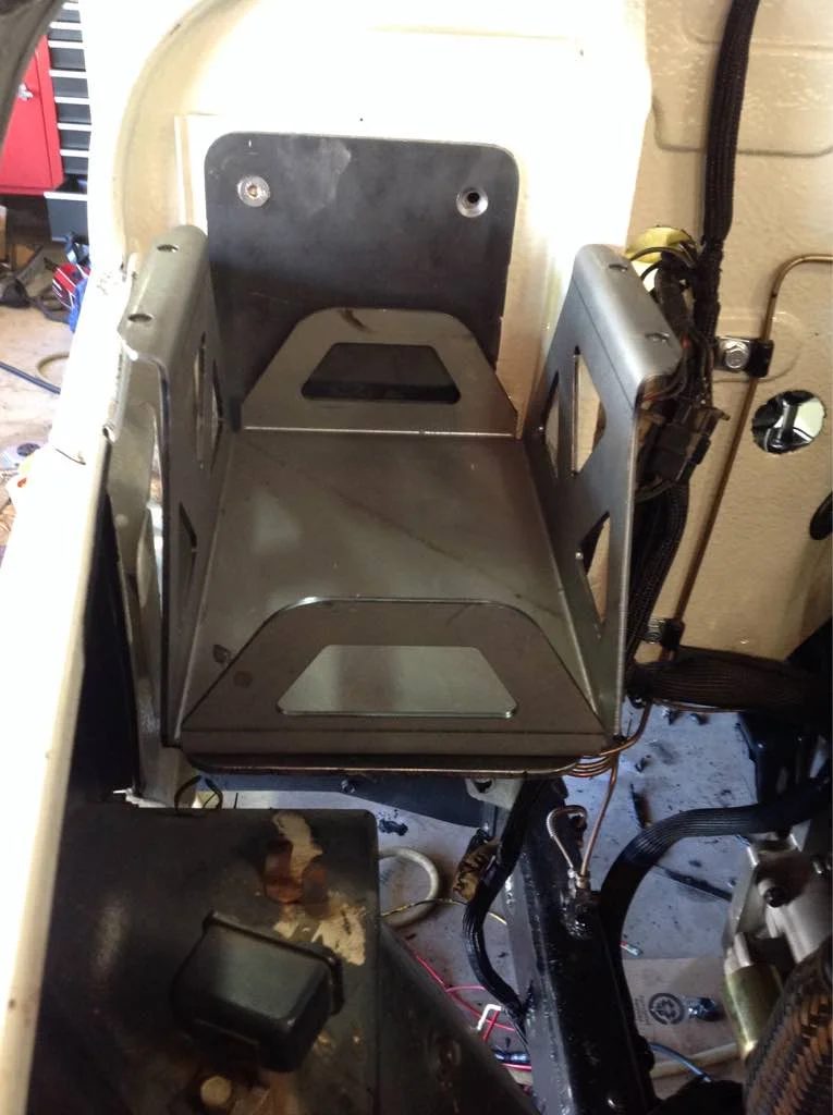

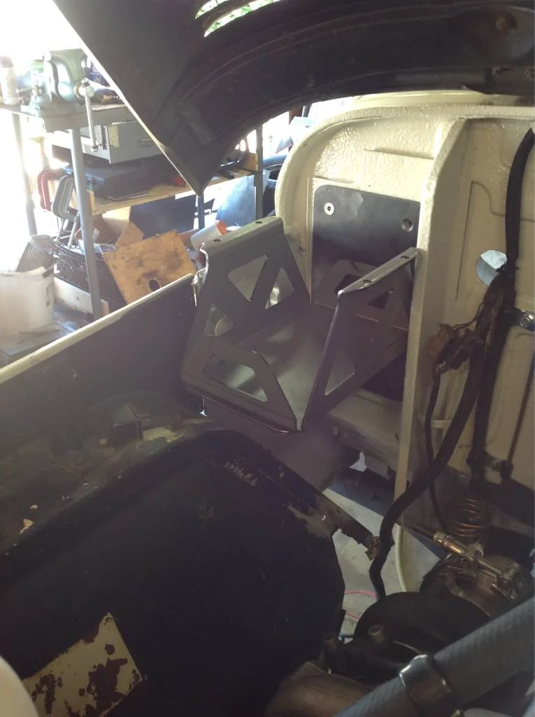

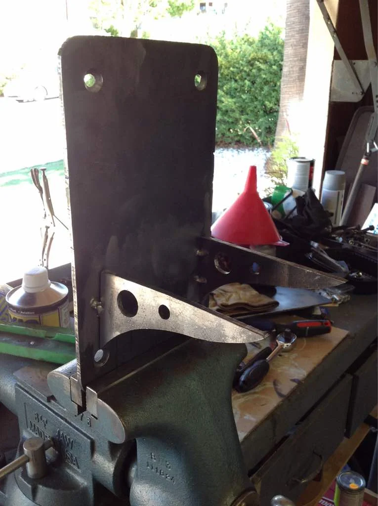

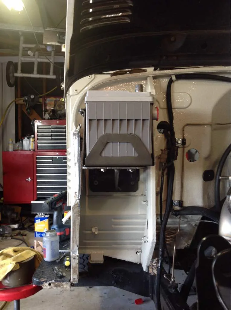

So I decided to mount the battery on the firewall...
Ugly fab, check!'

There will be more gussetts, those were just to rough it in.

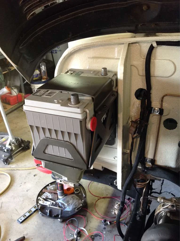

Battery restraint is Ruffstuff Specialties Oddessy/DieHard 34/78DT. It's pure beef! Love this thing. Plus I can't say enough good things about these guys, they accidentally sent me the wrong model, so they overnighted the correct one. That's customer service!!!
I guess I'll repaint the wheel wells since I've got them out. Just need to decide on white or semi flat black.
Opinions?

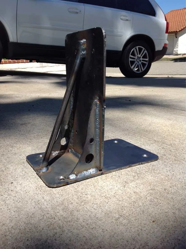

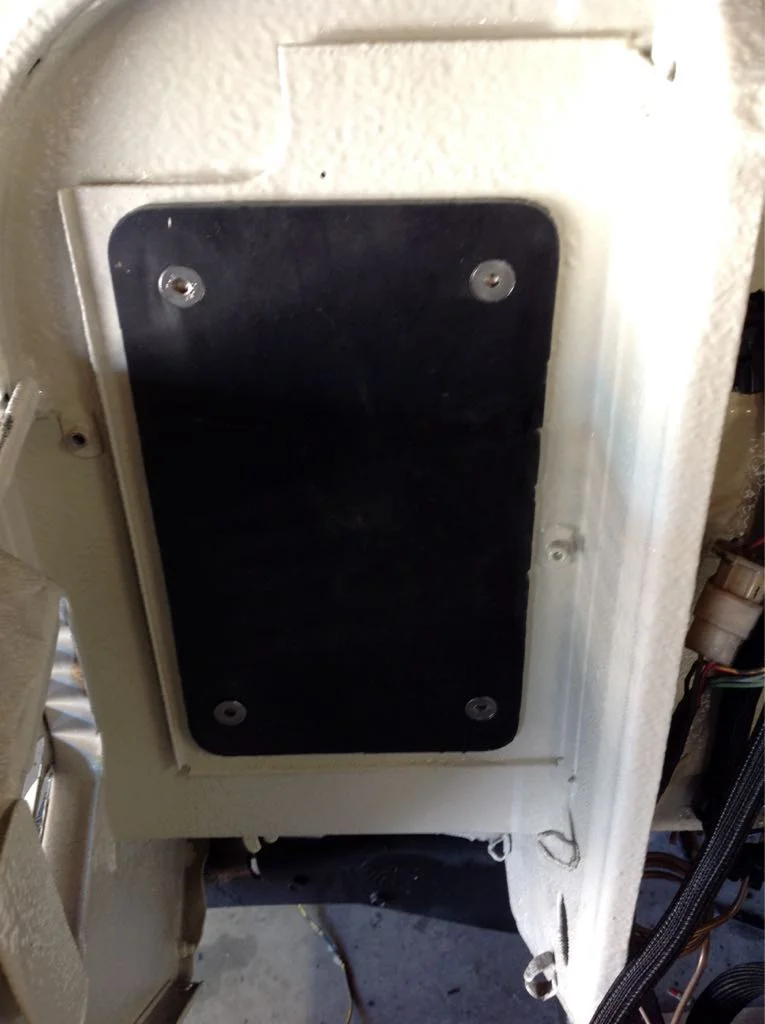

I decided to use up the scrap from the twin stick project...
I think this will hold, I just hope I'm not putting too much stress on the cowl. On the other hand, I'm not rock bouncing this thing...
Maybe make a a second plate for the other side of the cowl and run bolts through the cowl? Essentially sandwiching the cowl? I'm sure there's a technical term for this but I haven't finished my mechanical engineering degree yet.
Initially, that was my plan but there are captured nuts on the interior side. I'm still thinking on how to skin this cat.
In other news, this project pretty much completes what's needed for an initial test drive. I still have to sort out my pyro, boost, and oil pressure gauge mounting. I also want to try to use the OEM temp gauge, but that's another can of worms.
Min that case you will probably be ok, maybe think about a support bracket at the end of the platform going down to the fender though.

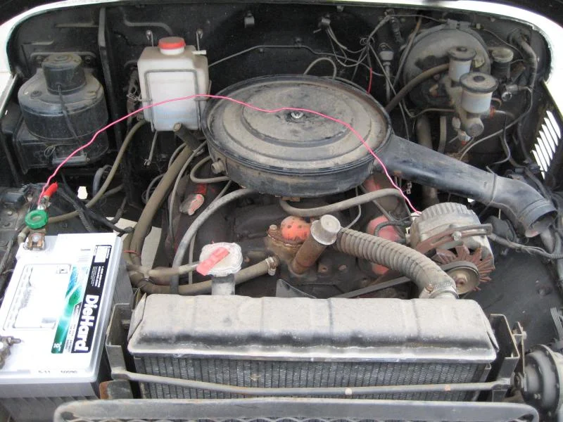

Before:

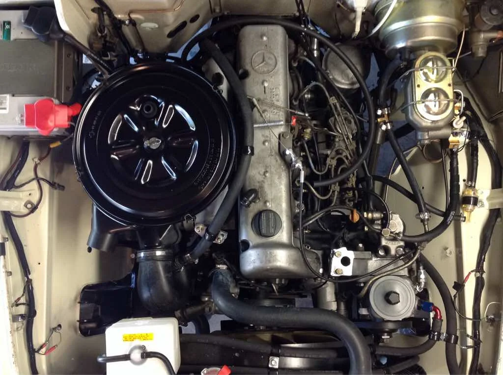

After:

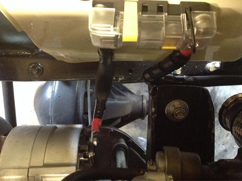

Really like the Blue Sea Littlefuse Holder

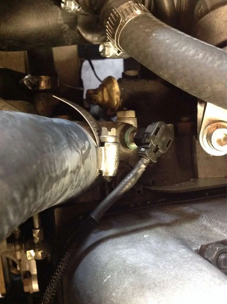

OEM Benz water temp sensor. Originally I think this was used for the auxiliary cooling fan. Works fine for the OEM cluster...

Been busy lately:
Intake cleaned, painted, installed
1/0 battery cables made up
Military battery terminals
Fusible link made, spares ready to go
Fused alternator circuit with Blue Sea systems sealed fuse holder
Etched, primed and painted fender wells
OEM water temp gauge operational now
Wiring harness loomed
Battery cables heat shielded

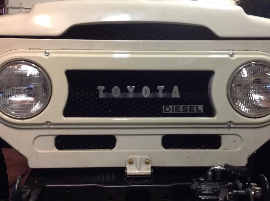

Re-install grille mesh and TOYOTA emblem, DIESEL emblem

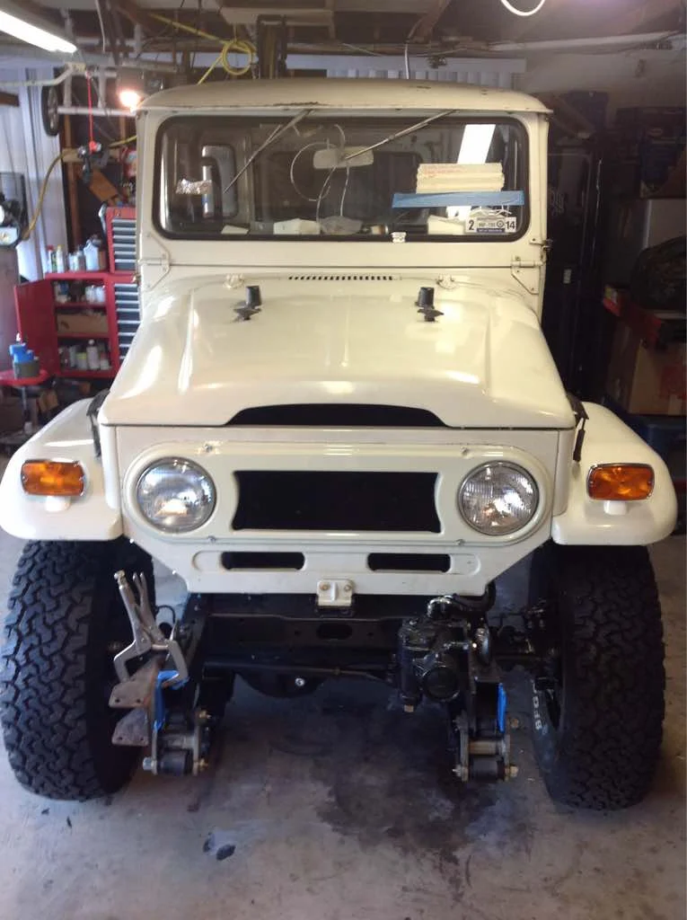

Driveway alignment
Shocks
Mount bumper, wire winch

I was pretty stoked with how simple it was to adapt the OEM water temp gauge to this engine. Literally just run a wire using the OEM Benz connector on a temp sensor on the thermostat neck to the back of the cluster, fire it up, and watch the gauge rise. After idling for about 15 minutes the gauge was on the low end of the "normal" zone.

I forgot to show a shot of the battery installed...

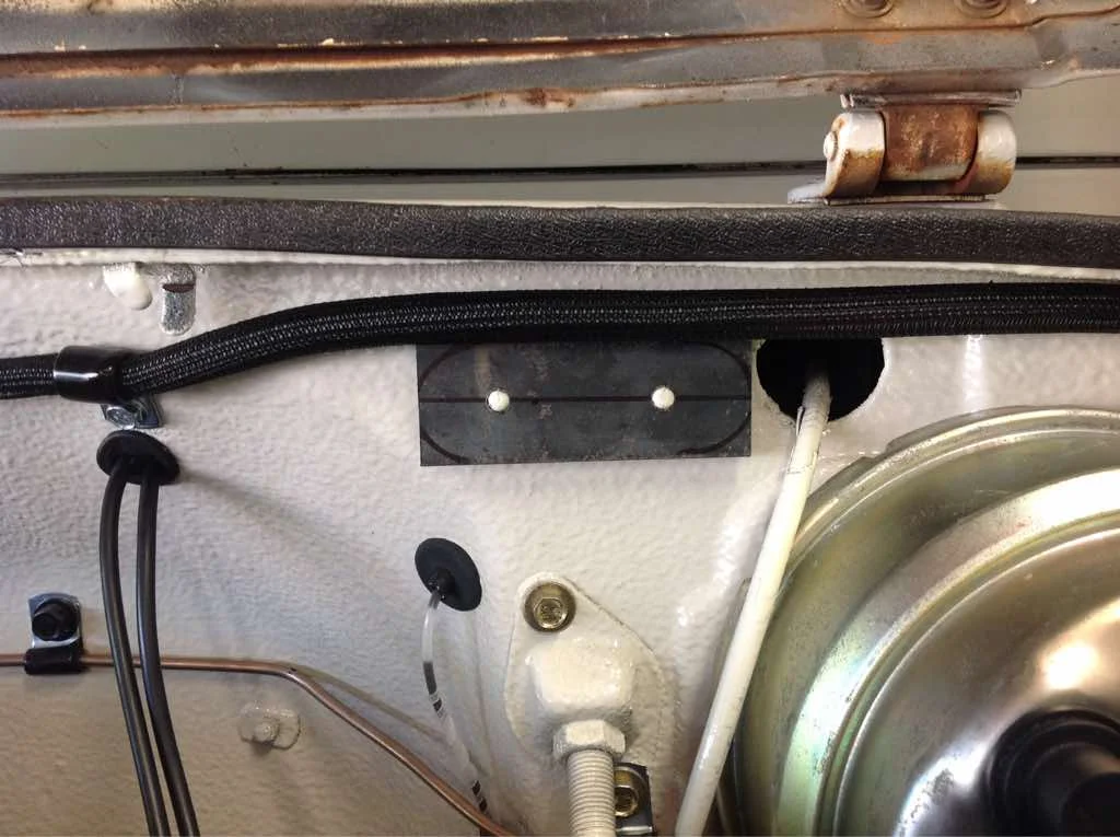

I used some leftover foam from the SOR trans tunnel gasket cut into 1" strips and then sealed it with some ultra-black. Shouldn't have a problem with water, dirt, etc intrusion into the cab through the heater opening.
Heresy?

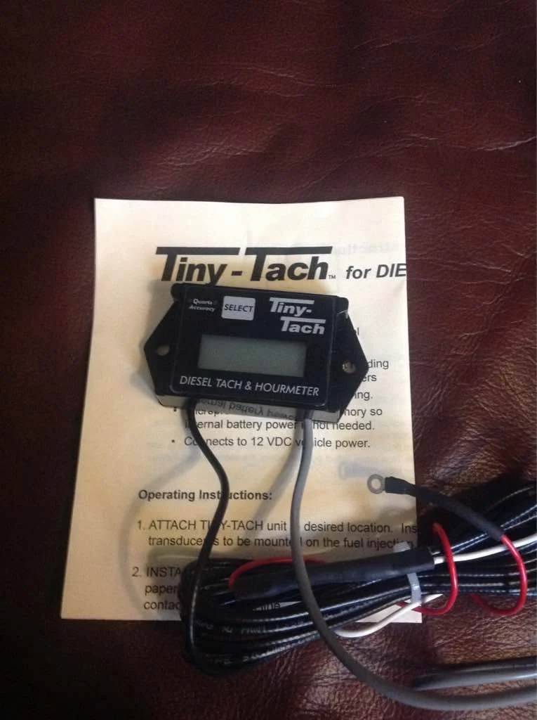

Tiny Tach
