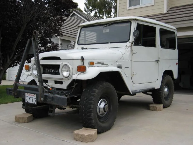

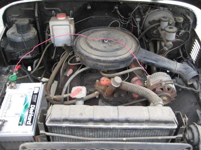

I started with a 6/72 40 with a hack job '70 350 swap completed that was mated to the stock 3spd drivetrain. Everything else was pretty much left alone. The truck had been freshened up at some point and has been repainted the original color. I suspect the original engine burned up since there was a heavy smell of burned plastic / rubber when I first got it.
The backstory is I purchased the rig back in 2010 from an older gent who was a private detective and cruiser enthusiast, but was disabled by a difficult bout with cancer (he claims it was from Agent Orange during Vietnam). He said he had intentions of bringing it back to stock, but he just didn't have the time/money/health to do so. According to him, he scored the 40 from a public auction that resulted from an operation that involved the takedown of a drug operation up in LA county that he had the inside scoop on. As such, I wasn't surprised to find a crack rock in the horn button months later during some clean up of the interior. Coincidentally, my wife coined the term "mule" as in a drug mule and I guess it stuck. The name has been fitting as this project has been so dang stubborn at times. However, I'm starting the think it's name should be something that reflects how much time and money this thing has taken thus far.
I'm already "in progress" with this swap, so I'll be catching up but hope someone gets something out of it. If nothing else, it might help me organize my plans.

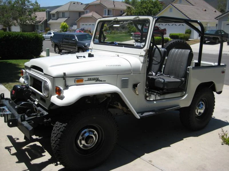

Here's the day I brought it home
Being a complete Land Cruiser newb, I didn't think things through very well with respect to where I wanted the truck to end up.
So I wasted money rebuilding brakes I'd later part out, rebuilt an axle that I'd eventually put different knuckles on, freshened up an engine that would eventually get pulled, powdercoated drum brake wheels I'd later sell, and a brand new Warn 8274 that may or may not have been influenced by a case of Coors..you get the drift. Money that could've been better spent elsewhere.
All lessons cost something...good lessons cost a lot!
Things I did improve that I'm glad I did were all new OEM weatherstripping, a MetalTech Jackson cage, and new 33x10.50 BFG AT's.

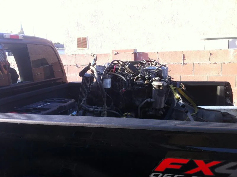

I got lucky searching CL on friday morning and found a guy with an OM617 with about 178K miles on it that was in a 300CD that had been hit in the rear (he still had the car around when I got it so I could verify mileage, etc). The only catch was he had people that wanted to see it on Saturday and it was first come first serve. Good thing I had the day off...so I raced up into LA cursing the traffic as I drove and made it up there around 1500. After a couple hours inspecting and talking, I came home with this for $500

I figured for $500 there was either something wrong or the guy really wanted to hit the club that friday night. He included the radiator, tranny, extra oil cooler, power steering pump, overflow rez, extra starter, A/C compressor, fan and fan clutch, and a lot of other small stuff.

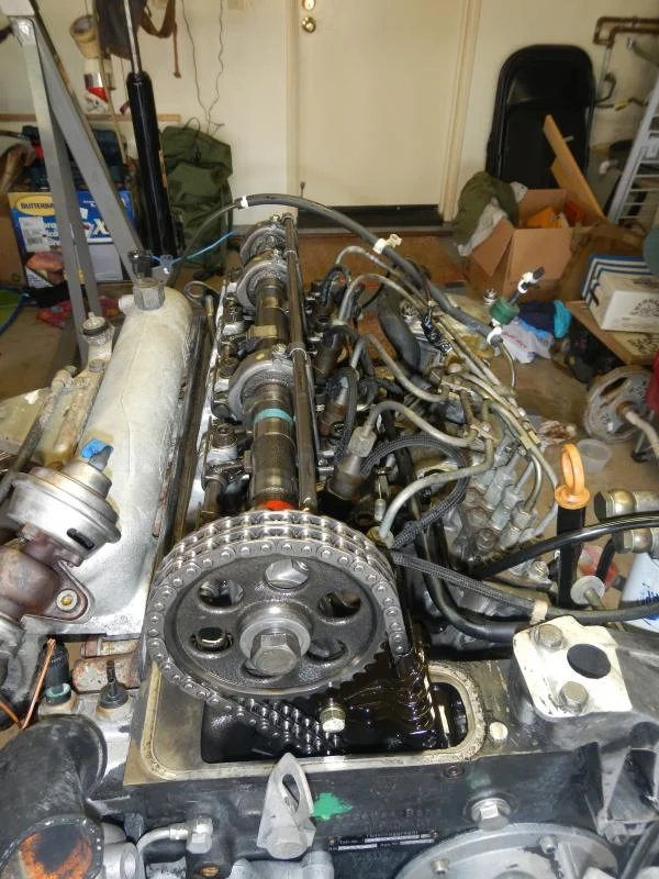

I had a turbo shop go through the turbo and they put a new compressor wheel that should help spool up faster. I can't remember the A/R ratio, but it's nothing too crazy.

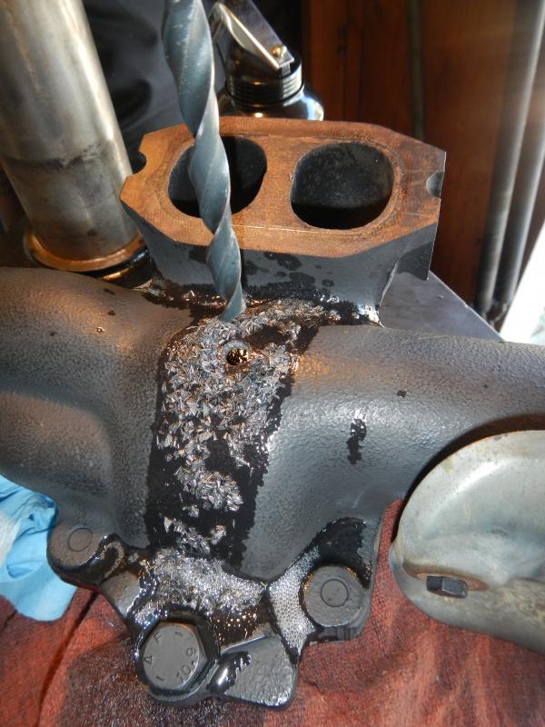

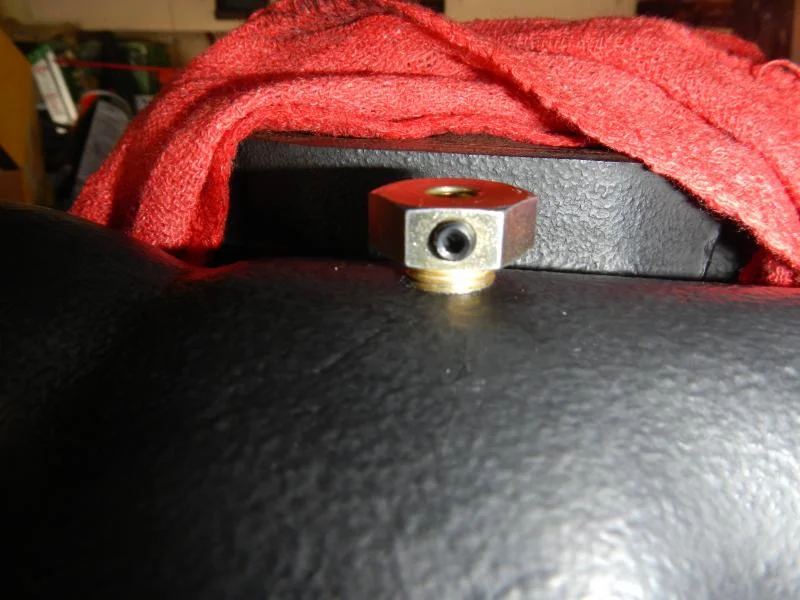

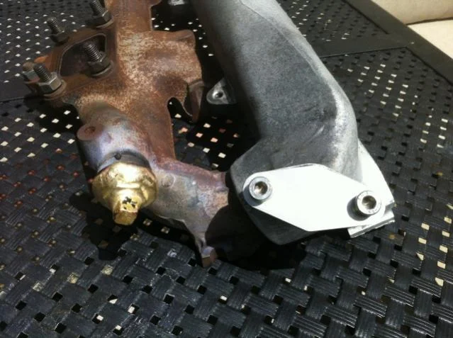

While I had it apart, I took care of a couple of things that I knew would be easier to do now rather than later. So, I drilled and tapped the exhaust manifold for a pyrometer bung, deleted the EGR which entailed blocking off the EGR on the intake (that thing was gunked up beyond belief in there--cleaning was a PITA!), and brazed the EGR port closed on the exhaust manifold. I have to admit my first foray into brazing on cast iron was a good experience. I did a lot of research and it's all about controlling the heat. It worked out well and I was pleased as punch. I coated both the intake and exhaust manifolds with some hi temp paint while I had them off so that's good for at least +20 ft-lbs right? haha
I almost screwed myself by trying to be too slick. I tapped the exh manifold on the back side in an attempt to hide all wiring harness for the thermocouple. I measured multiple times, but it just barely cleared the engine block so I guess I'll chalk that one up to luck. As a pilot, we always say I'd rather be lucky than good, so I guess it worked this time.

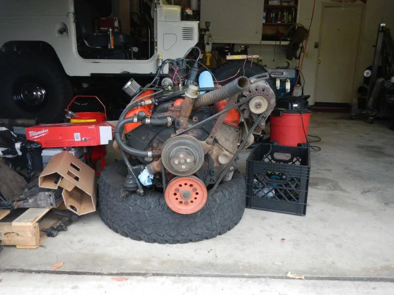

I've been very aggressive on this to date. As a result I've sold enough Benz parts (transmission, torque converter, starter, A/C condenser, extra oil cooler, driveline components, etc) that I've completely paid for my initial investment in the engine. I actually can't believe that I pulled that off, but apparently this stuff is worth money to people who need it....

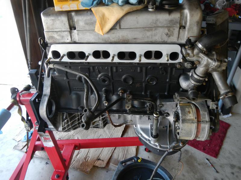

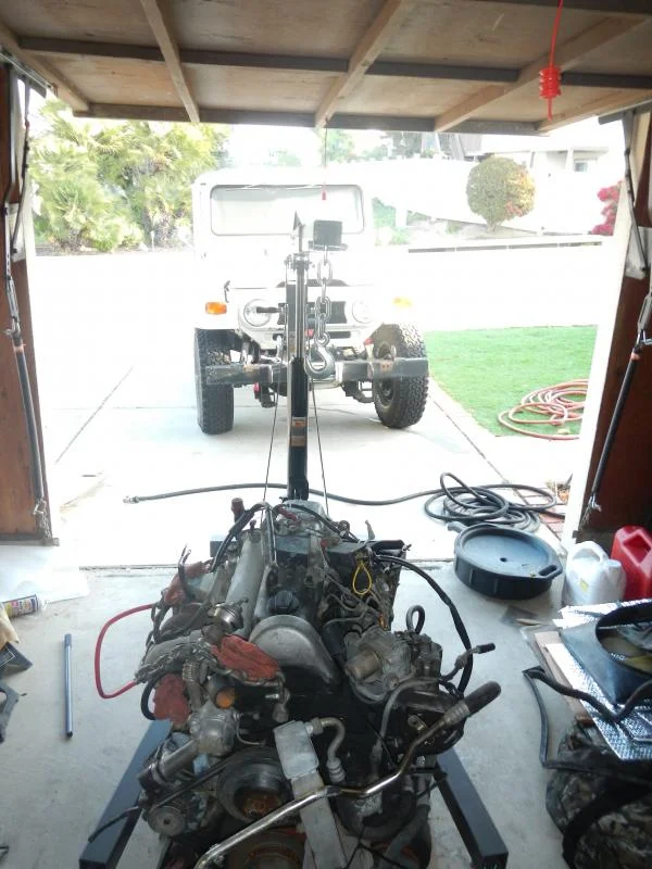

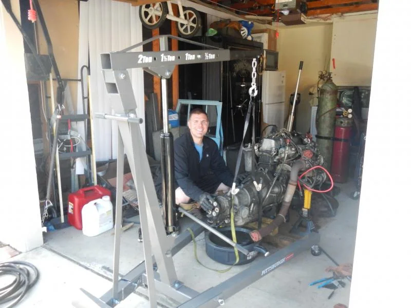

Here's some pics of breaking down the engine from the tranny

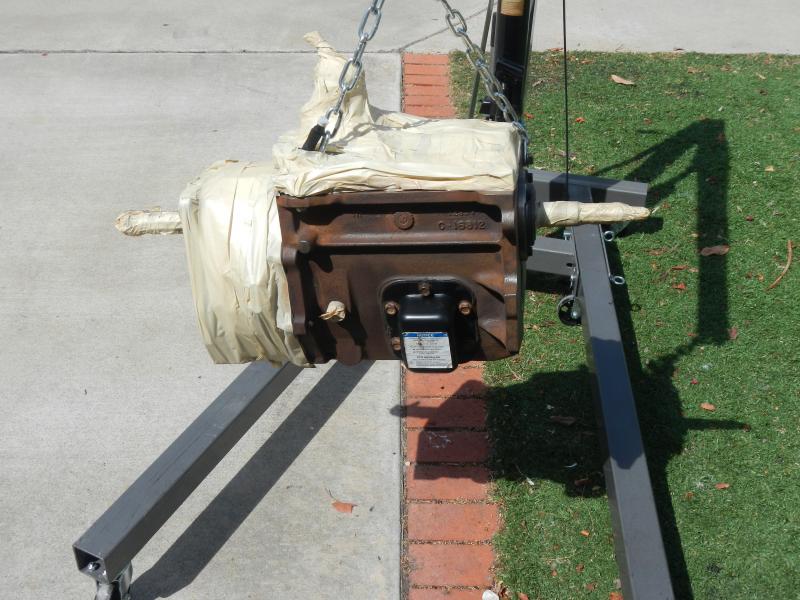

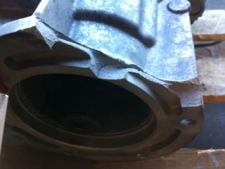

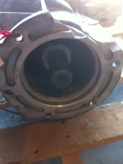

I had the NV4500 delivered to the auto hobby shop on base since they had a forklift and wouldn't you know the output housing got cracked during shipping. I wasn't too mad considering I wouldn't be using it, but then again I'd paid for it and it's the principle of the matter. I contacted the shop and they sent me a new one no questions asked. I later sold that housing to fund some adapters.

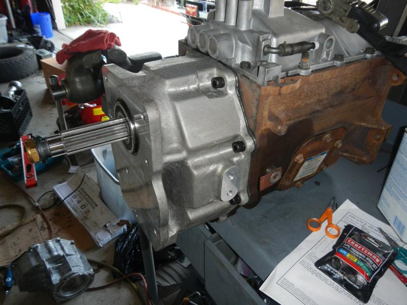

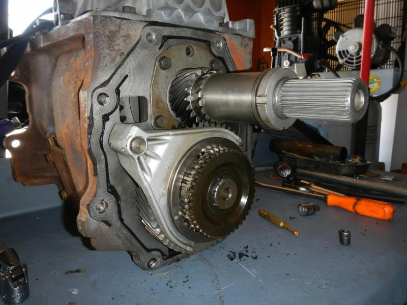

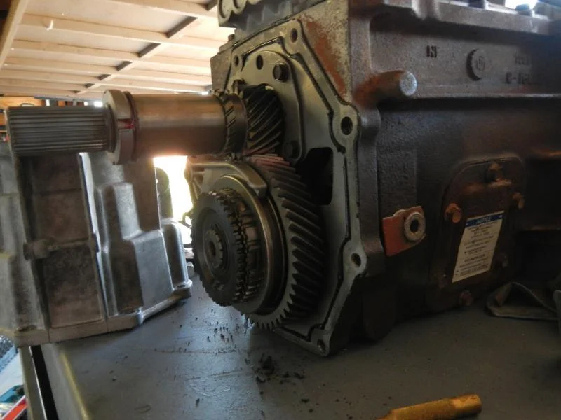

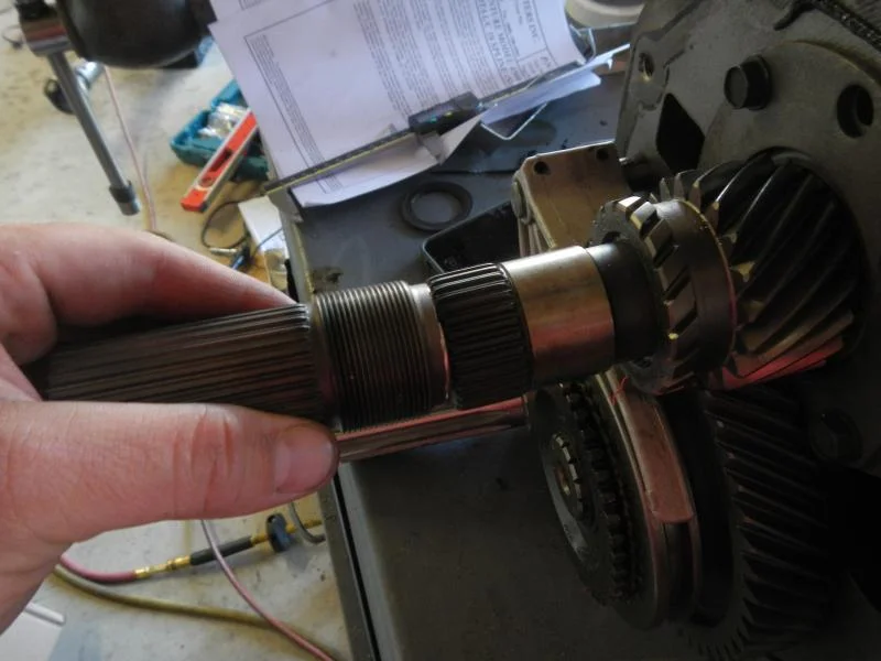

Speaking of adapters. I went with AA for their NV4500 to TLC 10 spline case and 4x4 Labs for the OM617 to GM adapter. Adapters are easily comprise 40-50% of the cost of this swap.

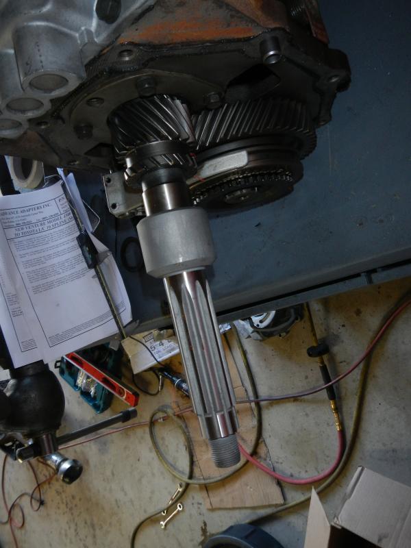

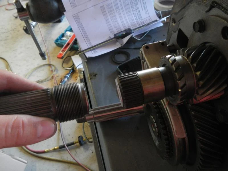

Anyways, here are some shots of installing the AA NV4500 adapter. Cutting a perfectly good transmission output shaft in two is definitely one of those things I'm glad to have behind me.
Some more tranny pics...
So for some tech here:

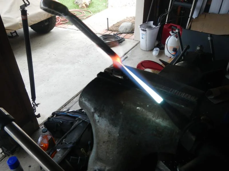

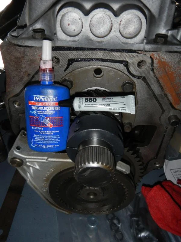

You need to follow the AA instructions to the "T" when you cut this shaft off. If you cut it too short, when you tighten the output shaft spud shaft nut, you'll pull the spud shaft against the sealed bearing as you tighten against the rear output bearing on the tcase. If you leave it too long, when you tighten the adapter housing down, you'll be forcing the sealed bearing against the spud shaft. I suspect that both will lead to premature failure of the sealed bearing. Also be sure to measure from the case of the transmission to the required length, not from anywhere else. Being a pilot, we "chair fly" a lot before the real deal, so I decided to practice the cut before I started putting marks on metal. I think it paid off-- as it went off without a hitch. I was basically checking to make sure the tool didn't interfere during execution. You don't want to find out while you're cutting on that bad boy that something was causing you to cut at a weird angle.
As far as the cutting went, I used a cutoff wheel to get through the hardened portion using tape as a guide. After that I used my bandsaw to zip through the softer "core" of the output shaft. The Milwaukee cut through the non-hardend portion like butter.
Once I had it cut, I used some some air tools and smoothed everything out as best I could, basically making sure the mating surface was as flat as possible. I also made sure the sealing surfaces were free of any old gasket material, rust, grease, etc.
I also installed a Quad4x4 PTO filter, but I'm not sure it's going to clear the front output shaft. They recommend putting it on the right side due to the countershaft assembly slinging the Syntorq in that direction. There's a couple of neodynium magnets in there that I'll be checking after a couple hundred miles.

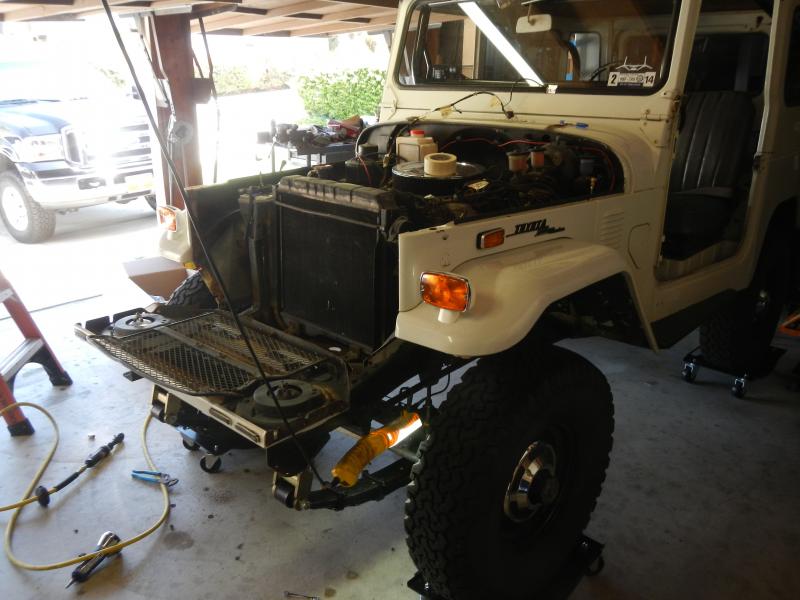

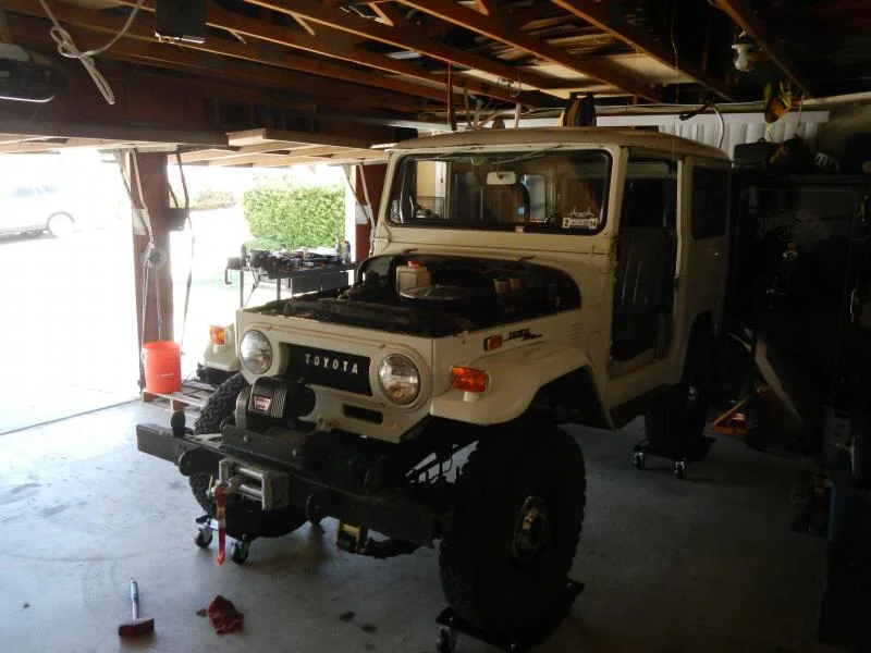

Unfortunately, the time comes in every swap to quit driving your vehicle and know that it's going to be "down" for a while--or in my line of work, "NMC" (non-mission capable).
First order of business was to square away my garage. Luckily, while I was in Afghanistan, the house my wife found to rent had a significantly larger garage (2 car). Obviously, I didn't have a problem with that. She knows me so well that when she talked to me about it she even added, "...and yes, there's a 220V outlet for your welder."
Melt my heart, haha.

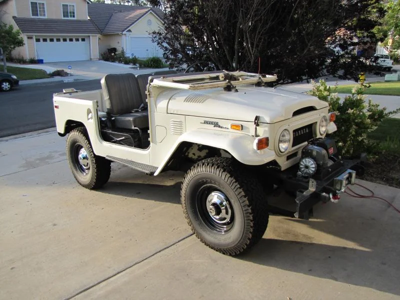

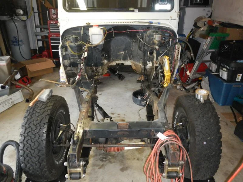

So after getting things organized, I snapped a shot of the Mule in the driveway and then in the spot it has been for the last 5-6 months...
HF had a special on some wheel dollies and if you've ever debated about spending a couple bucks on some, they're great.
I've used them for everything from moving axles, wheels, trannies, and of course--maneuvering the cruiser around the garage.

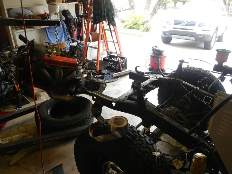

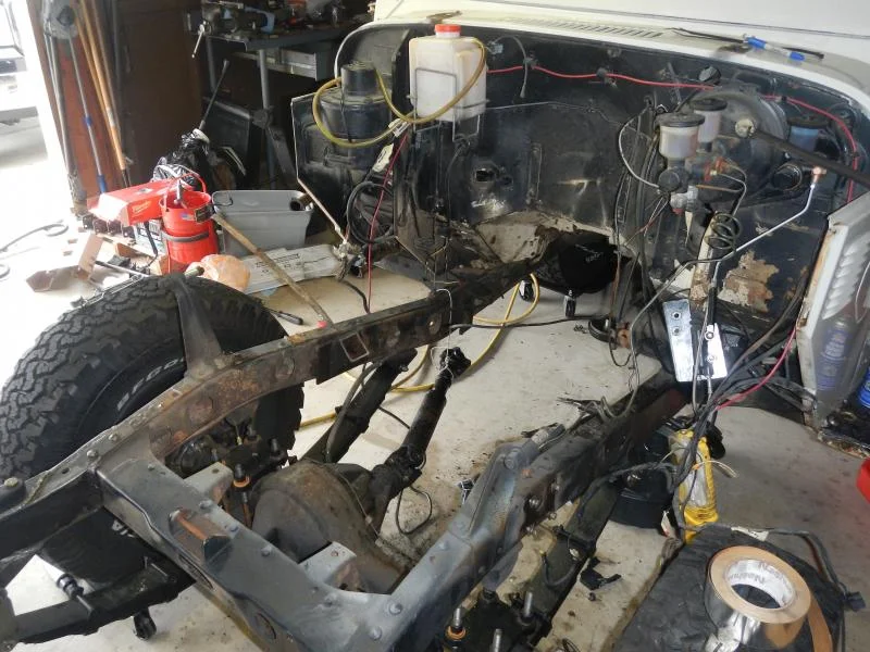

So now the major teardown began. I worked on it when I could, but I was going through some very rigorous instructor pilot qualification syllabi so I was only able to work on it when I could. I'd usually study for a few hours, then take a 30 minute wrenching break to clear my head, then get back at it. I soaked all the fasteners for a week or two in PB Blaster and only had a few that I'll have to drill out. Overall not too bad, but she's got some rust just like every other cruiser out there.

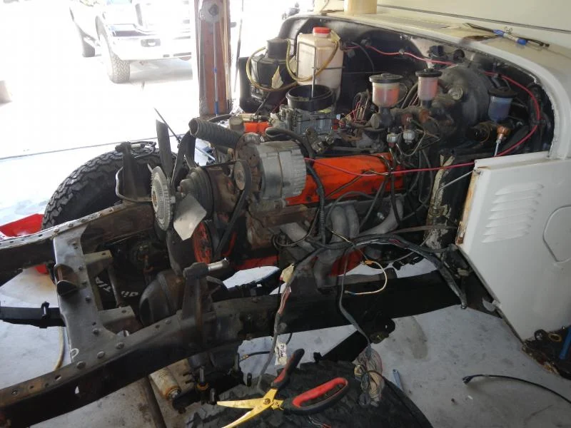

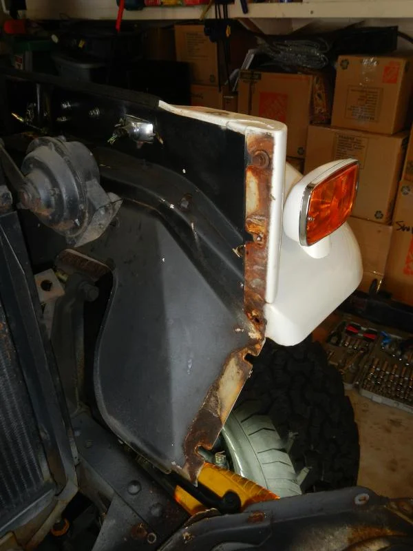

Here's the teardown. I wish y'all could see how crappy this 350 swap was. Everything they could mess up they did. Motor mount bolts that you can't get out when the headers were on. Mismatched fasteners, no drivetrain support, hacked bellhousing, etc. I'm actually surprised that it drove so well with no vibes.
More pics of the teardown:
Before pulling the motor out, I advertised it on CL as a "clapped out" 350, but still runs and had a rebuilt quadrajet. I had people lined up for this thing. Amazing. Anyways, I ended up selling it to a retired gent who takes these 350s, rebuilds them, then sells them to his hotrod buddies. He came with $400 and a truck. I sent him packing with an old 350 and an IPA. Win-Win

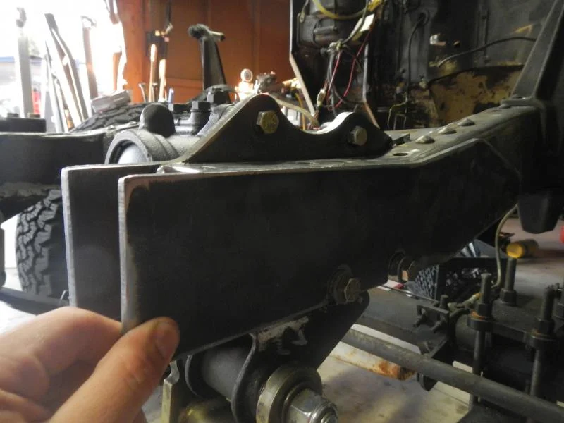

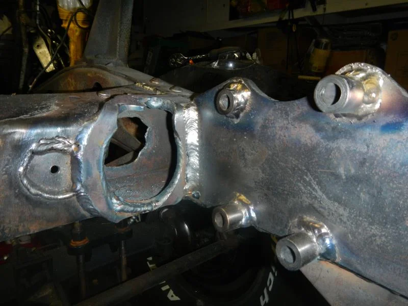

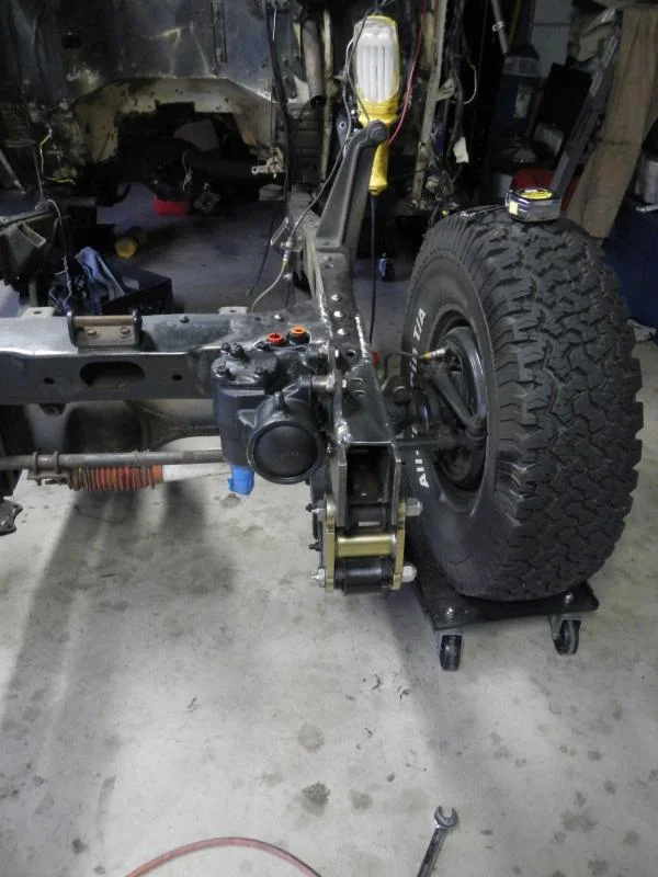

Thinking forward to engine placement, I knew that steering plays a huge part with respect to clearances, drivetrain placement, etc. I'm lucky in one respect that the OM617 is an inline engine, so that helps somewhat, but it also has accessories that take up valuable space on either side. On the passenger side, I'm going to have to deal with the turbo, exhaust, and intake and on the right side I've got the power steering pump, fuel filter, and injector pump.
So I decided that I'd better get cracking on the power steering conversion. I decided to go with 4x4Labs for a lot of my parts. Currently, I've got their power steering frame plates, steering shaft kit, and they made me up some "high-ish" (not really high steer since I'm still SUA) steer steering arms, drag links and relay rod. It's pure beef. Anyways, enough talking...here's some pics, which I know is what yall want anyways (if anyone is even reading this):

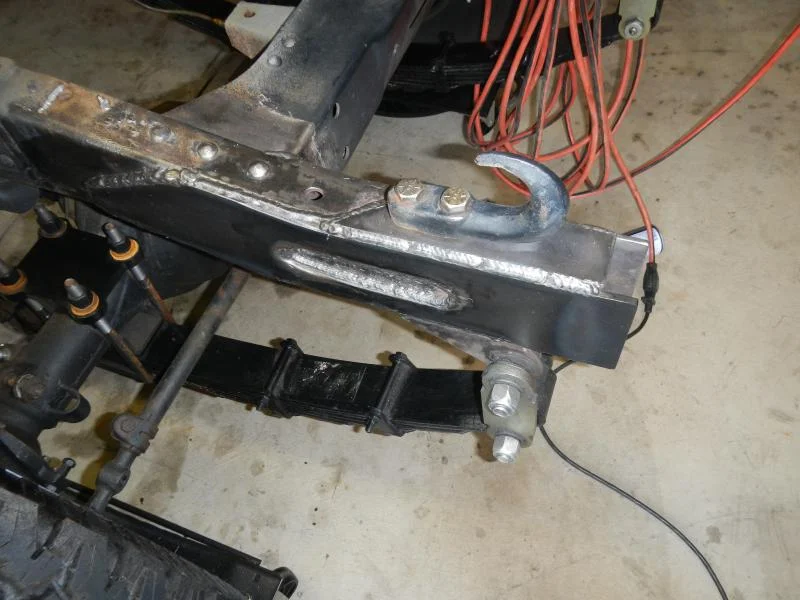

I actually screwed up a little on this install. Chalk it up to being a rookie. I messed up by I reusing the original tow hook locations when I actually should have cut square holes in the frame and inset the nuts that 4x4Labs provides. I did weld captured nuts on the inside before welding up the plates, but this is why the top plates leave the side plates exposed a little. I'm going to end up fabbing a front bump / using frame extenders anyways so I'm not too upset.

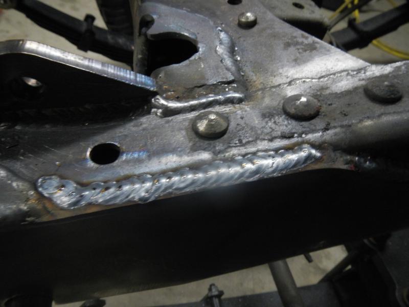

***Disclaimer*** I taught myself to weld. I'm still learning. Some of these look like boogers, but they arent. Also, I see a distinct difference when you're 12 Coors deep and when you're stone sober...haha.
I'm using a MM200 on 100% CO2.
Also, I noticed that I don't have any "forward dip" to my box, but I mounted it how 4x4Labs had theirs mounted. I can't think of any bad effects by having the box parallel to the frame. Anyone see a need to correct this? Kinda late now I guess...
