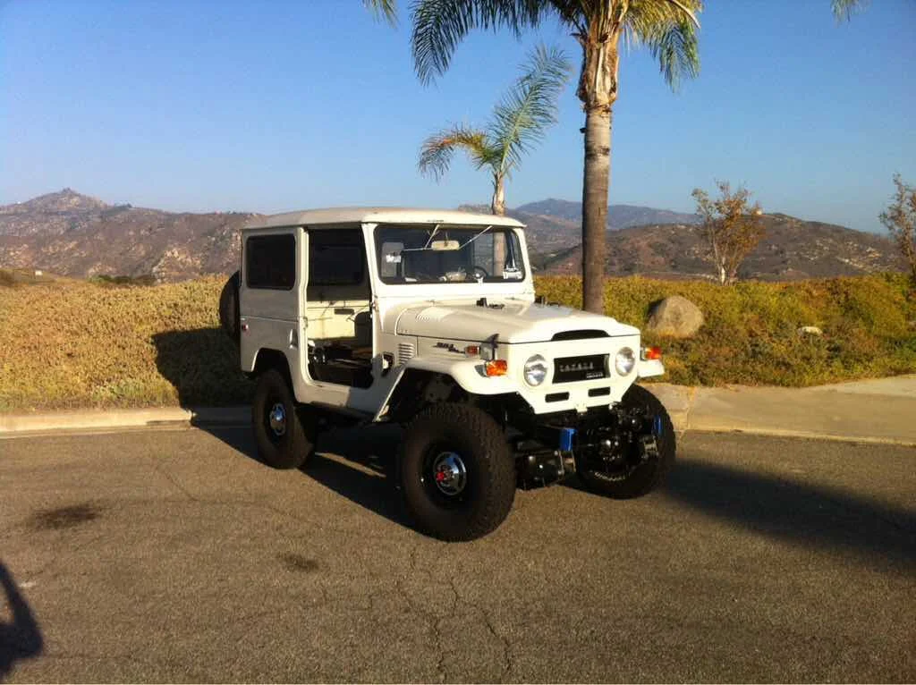

Big day today

The battery hold down is from Ruff Stuff. I fab'd the heater block off and mount.
I'll have to get some pics of the tiny tach mounted, but it'll be permanent.
Thanks for the encouragement. It's been a long process.
Woo! Sounds great!
Congratulations!!

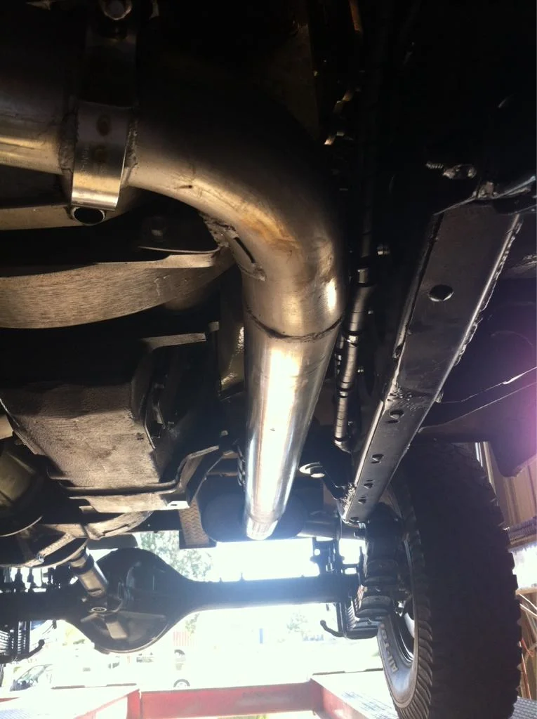

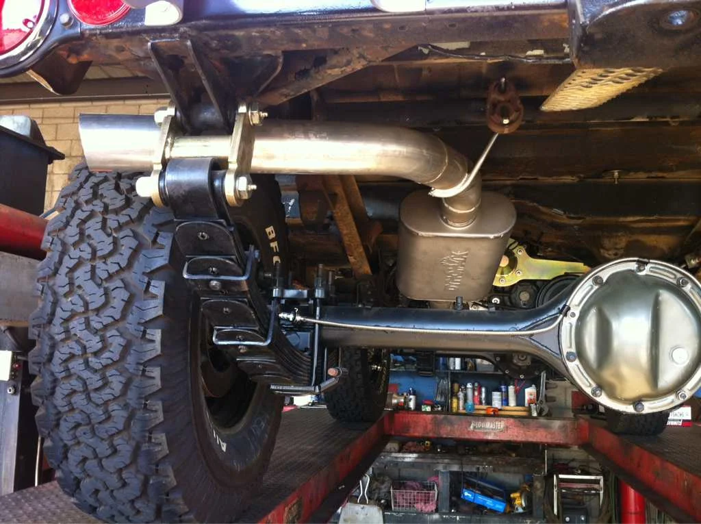

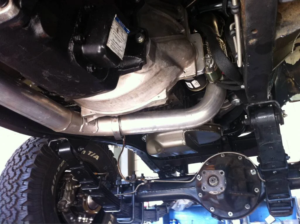

Got some exhaust put on it.
