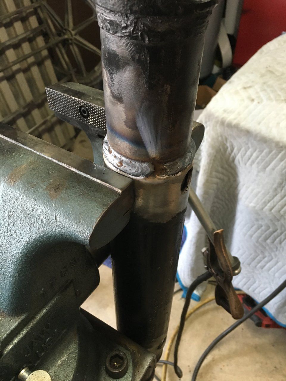

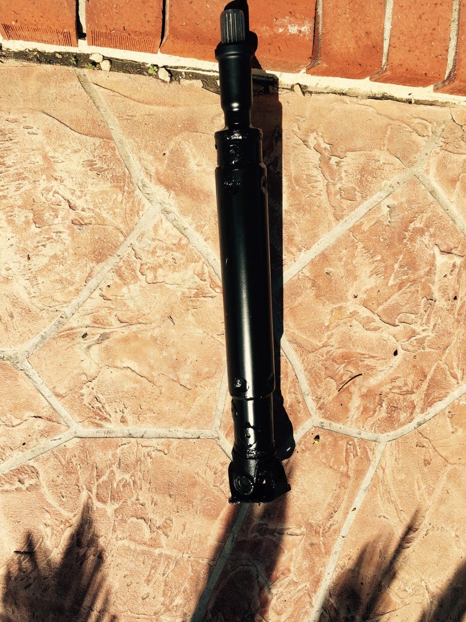

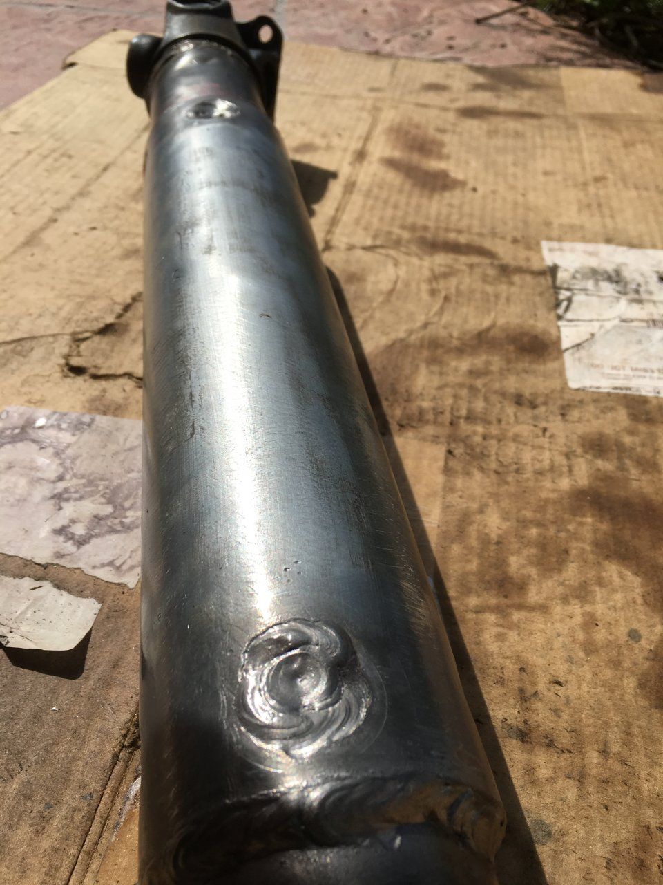

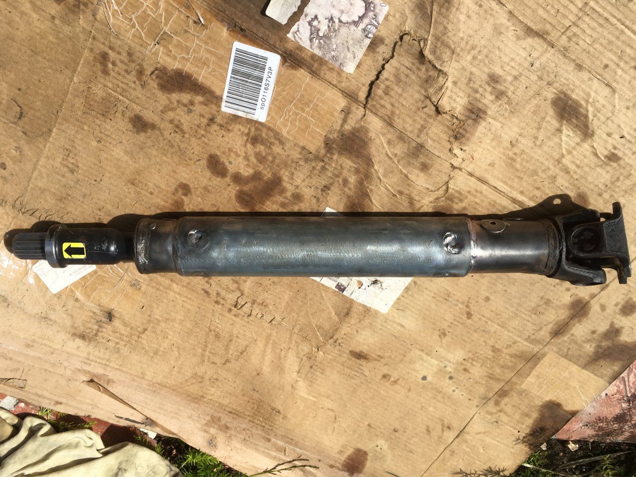

So, I decided to do a garage driveshaft lengthening of my front driveshaft... It was super straight when I tacked it together with almost zero radial runout. Well, for anybody doing this type of DIY stuff, be aware of your heat when you glue it all together. I ended up with a significant (~1.5cm--sorry my dial indicator is .001cm graduated) amount of runout. So, I decided to try my hand of "flame straightening." I was amazed at how much you can straighten a tube by this method. It's a subjective method, but you just keep doing a little bit at a time. The key part is heating then quenching. Pretty cool I think! Anyways, I know have the 4.56 LSD in the front and 4.56 in the back from @orangefj45. Gearing is sweet!
Here are some pics
Update***
I had to flame straighten my front drive shaft as it had some radial runout, but it's true now and runs without any vibes as far as I can tell...
