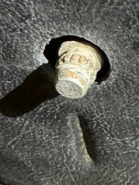

So my factory Toyota fj40 window cranks from the local dealer (still available, amazingly: thanks for the heads up and part number @sadovnik ) don't fit my new 'factory' window mechanism from Indonesia. The recess in the handles isn't deep enough. The threads align, but the splines aren't deep enough to allow the clip to engage.
Has anyone else had this issue?

My understanding is that those window cranks will only work on 1975 regulators. Here is a bad photo of the splines on my 1975 >>
My understanding is that those window cranks will only work on 1975 regulators. Here is a bad photo of the splines on my 1975 >>View attachment 4130331
Yup. That's the issue. That's definitely the way the female side of the handle is designed. I didn't realise they changed through the years. Bugger. Guess I should have looked into that one a bit more. Bloody hell. Shame; damn nice quality.

Guess I'll put the ones it came with back on. Better result than I thought it might have been: I was afraid the new 'factory' crank mechanisms were made of Chinesium and had the wrong shaft. They cane with Toyota part stickers..... but you never know.
