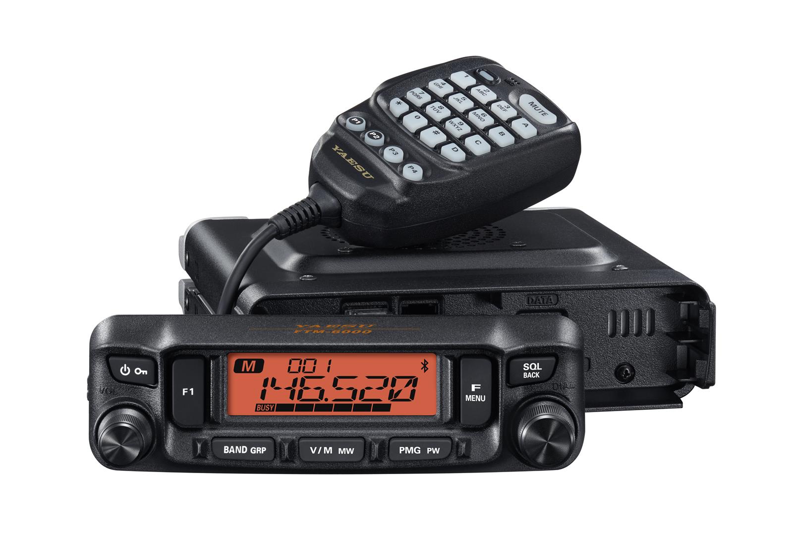

I’m also looking to add a vhf/rhf radio and am just about to order this:
Anyone have any experience with this particular radio? I have been viewing YouTube videos and talked to club members about it. Seems like a reasonable unit.
