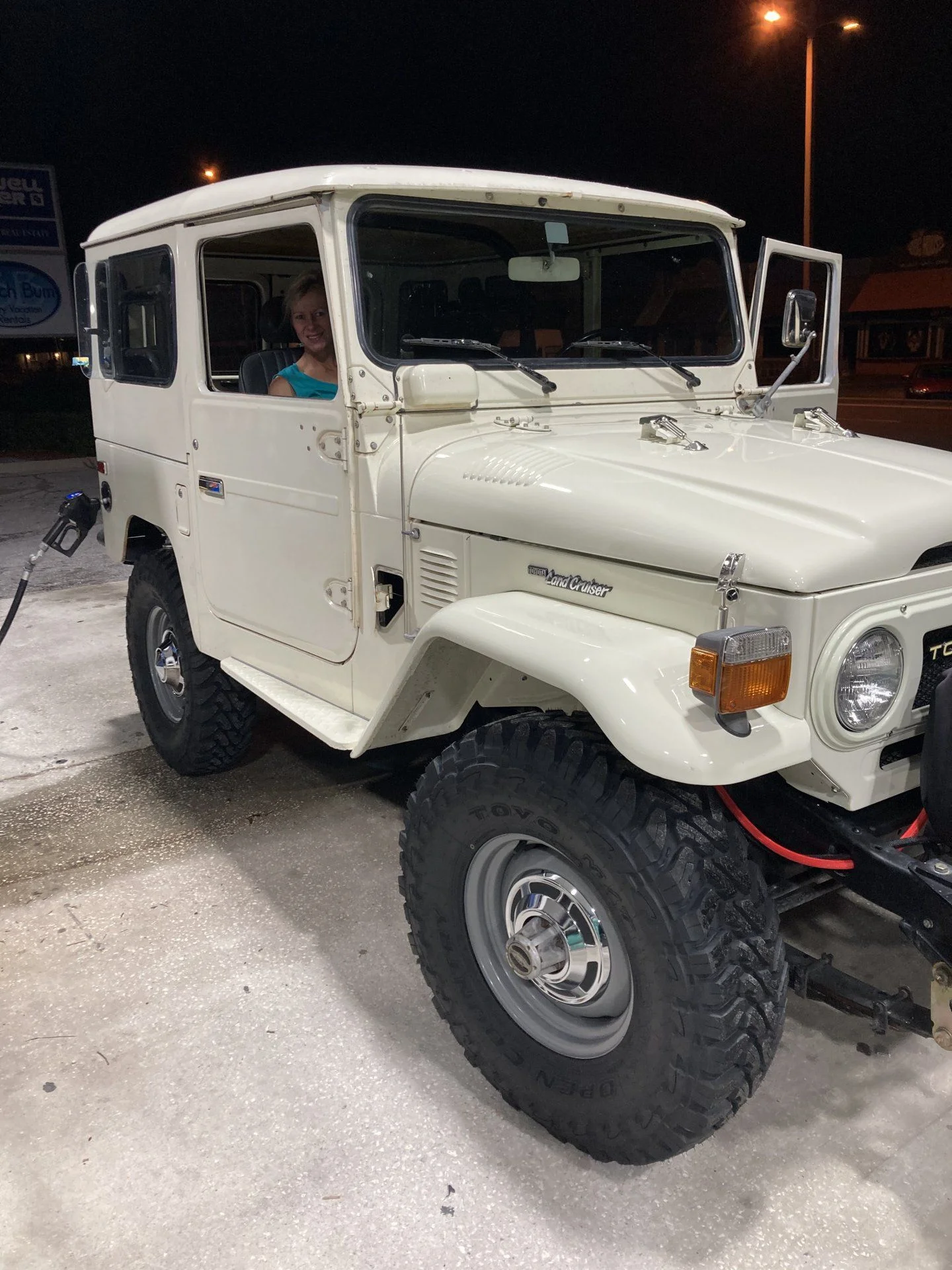

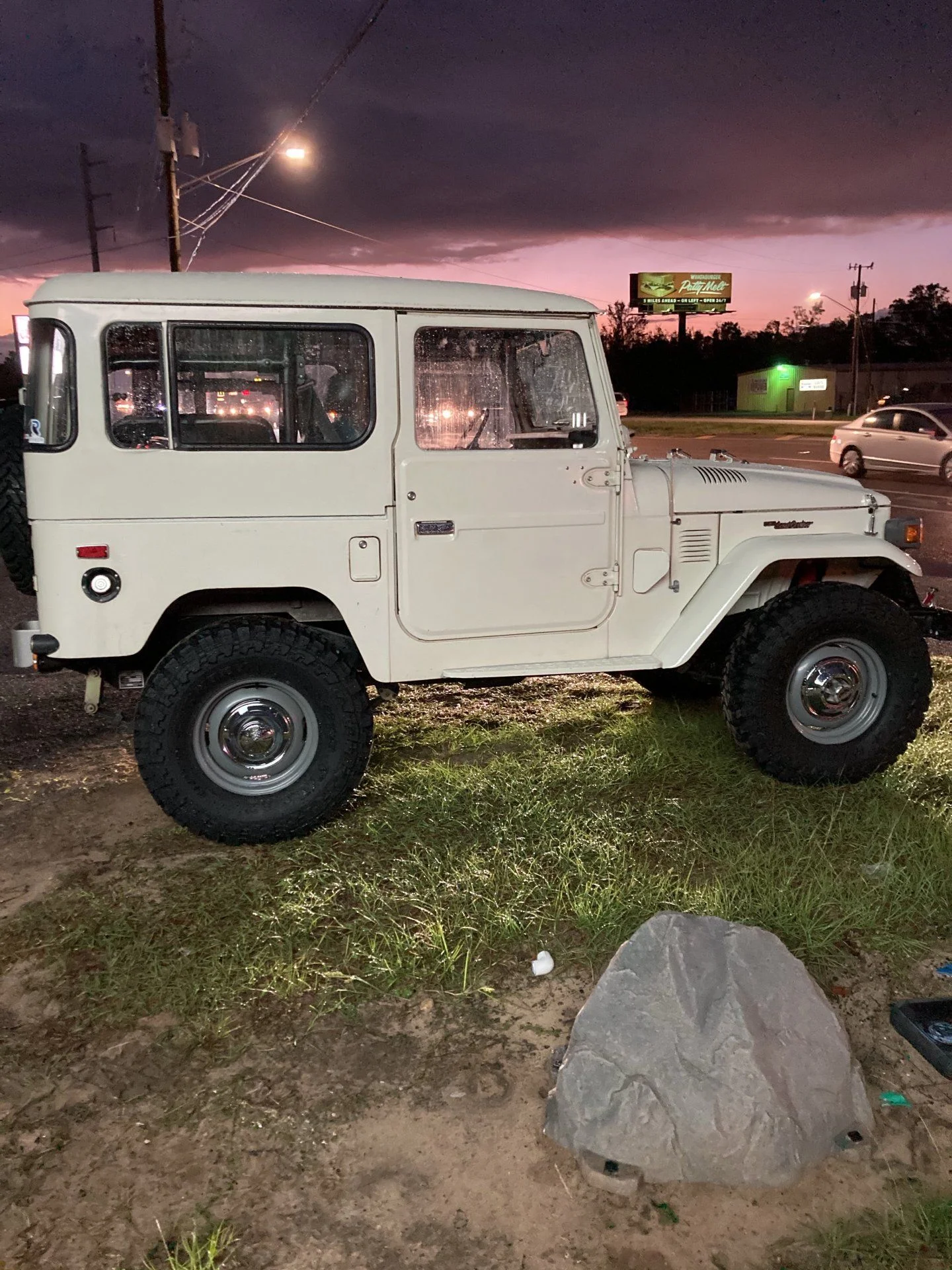

Looking very good - love those 16" rims and the white truck color (hides all manor of sins...)! That is a sharp truck and you have done all the right things to it so far, IMO.

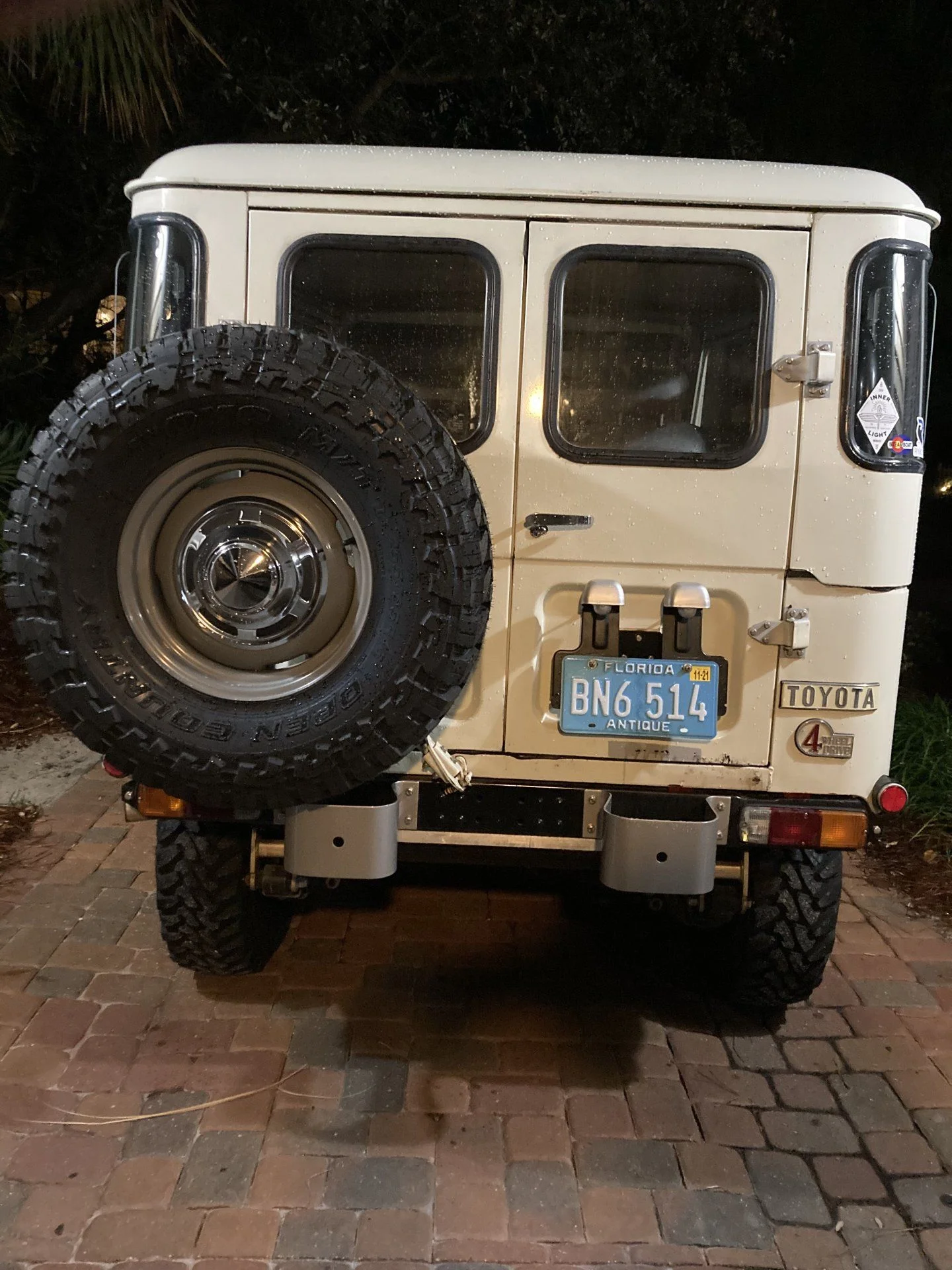

I may have missed this earlier but what color is your rig?
OH OH, I KNOW - - 031 White. You're welcome!
Not the best photo. I can get you a better one if you need it but I’m out of town until Friday. I bought a standard L bracket from Ace Hardware, cut it down a bit, primed and sprayed black.

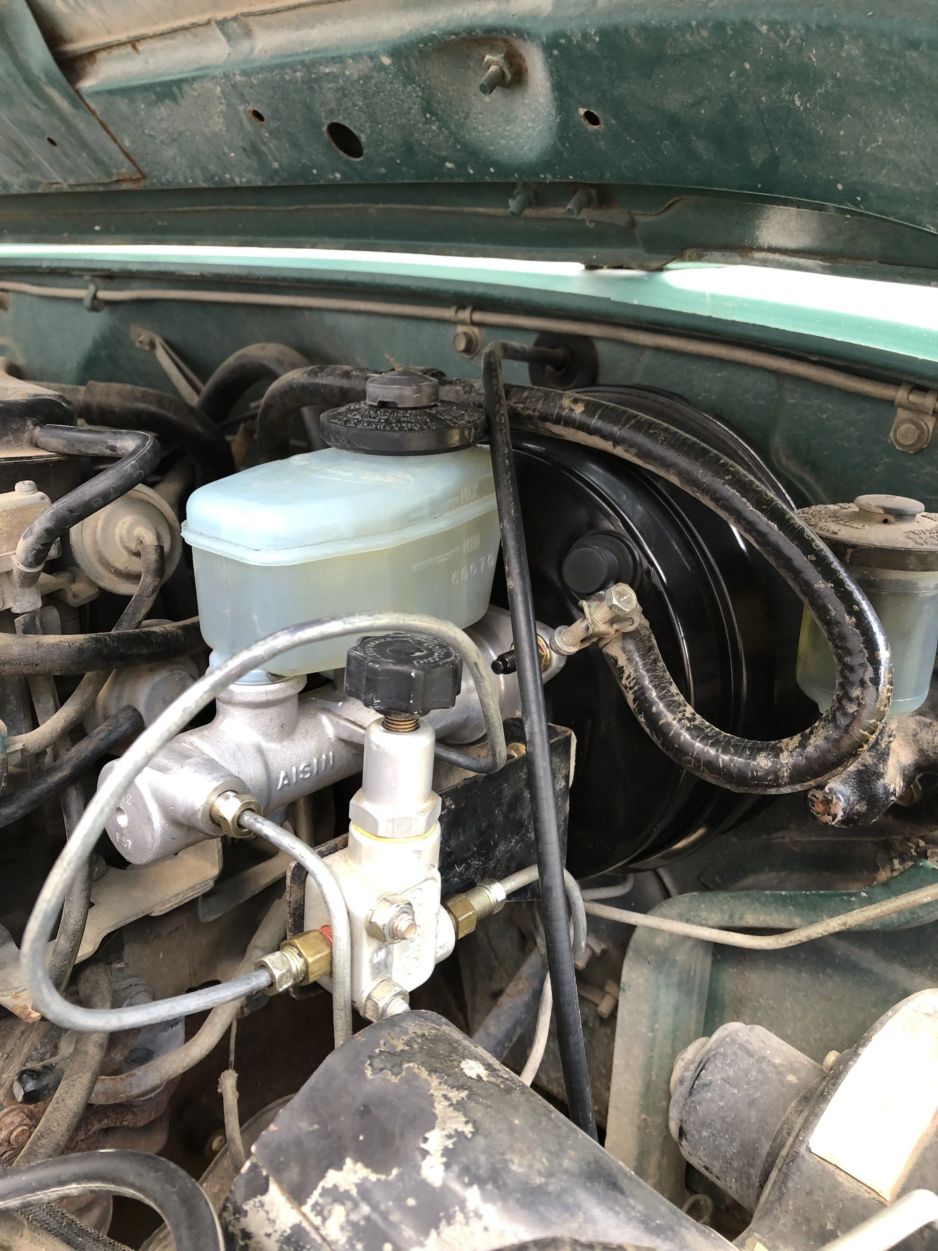

Mine is similar to @Catching Neutral , a homemade bracket on the booster/master cylinder mount:
