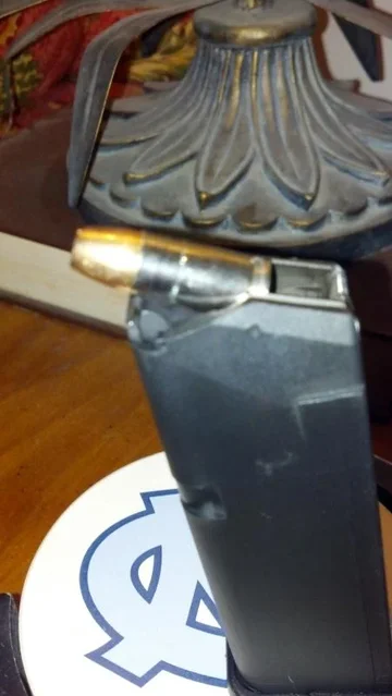

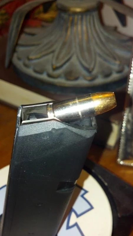

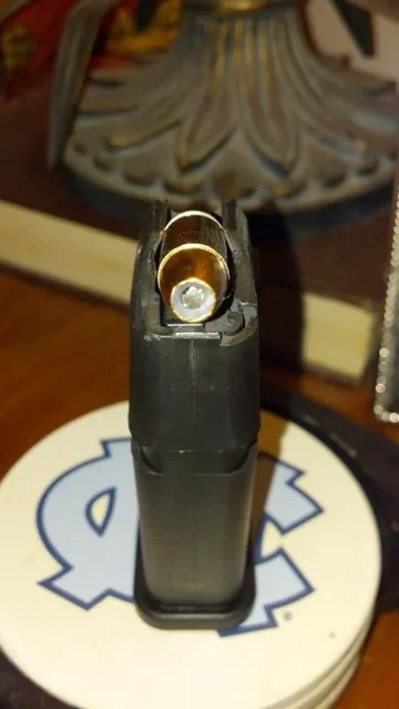

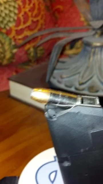

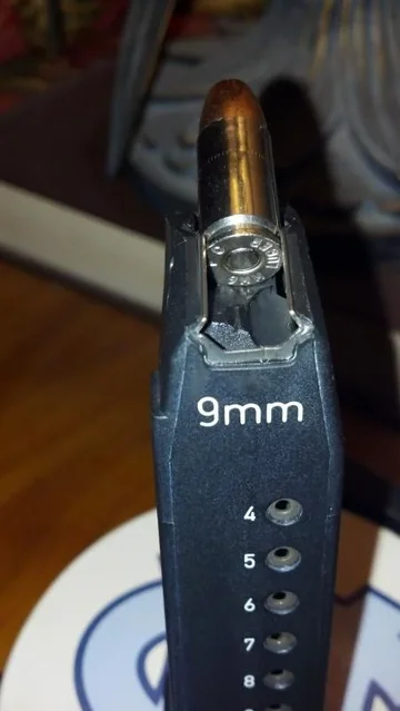

honestly that's too high. All the spare Glock mags I've ever bought were max of $25. I really think it's the mag springs. If it was the feed ramp there should be some random feed issues at other times too and not just on the last round. And it's not like these are the G26 mags either. I think these are rarely used low cap mags so I'd bet money it's the mag itself. He's calling Glock now.
well, Glock was not a huge help. they just gave me apart number to order new followers. i will be calling tomorrow to have these sent to me for free as my mags are brand new.
Below are pics of the actual mags, and where the Federal gets stuck. Again, this is only on the last round, and does not matter if its a full mag fired to the last, or one with one in it, just racked once.

The ammo manufacturers don't care if it works with all guns. When they have a crappy profile, they shorten them, thinking it helps with feeding issues.
Where you need to look next time is where its hanging up on, presumably, on the feed ramp. I'll guess you'll see the shorter round hits the feed ramp at a more perpendicular angle, right on that corner of the round, particularly, at the end of the mag when the spring is at it's lowest applied force. You should be able to repeat this without having to shoot the round.
Go into a place with a safe backdrop, bring only two rounds. Put one in a mag, have the slide held by the slide release lever, insert the mag, release the slide slowly and watch to see where it hangs up. If it doesn't do it when releasing slowly, just drop the slide by releasing the slide lever, again watching how the round slides into (or not) into the barrel.
Yes, as Stan said and I eluded to before, polish the feed ramp as Stan described, I finished mine with a soft cotton "bullet" with red polishing compound on my dremel. Reducing the friction on the ramp will help the round slide up and into the barrel.
I'd also recommend shooting from a rest, at the range where you bought it and see what they say. If you can repeat it from a bench rest, you can eliminate any "user" error.

I'm going to spitball another theory. The profile of this HP is different than the FMJ and when the follower approaches the top of the mag, its binding up because of the shortness of the HP. My guess is that the back of the follower is tipping forward as the last round is trying rack and may be enough to slow the feed, halt the action.
When there are more than one round in the magazine, then the follower is at an even keel. Its only when there is one round in the mag that the follower has wiggle room.
My guess is a polish job on the feed ramp may solve the issue here (as others have pointred out). The ogive of the Hydra-Shok bullet does not closely match that of the FMJ bullet and this causes issues with some firearms. It is a compromise in getting a large cavity that will aid expansion. Additionally, the first round in a magazine (against the follower) is usually at a different angle than the rest. All of this add up to increased possibility of feeding issues.
