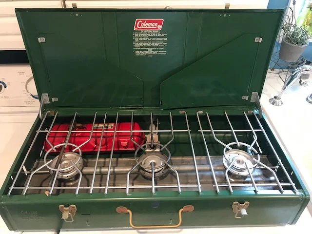

Picked this up for $50 this weekend - based on Ebay it was a More than Fair Price.
1977 - Appears only Middle burner was used 1X.
Gave it a once over, and will be using it Memorial Day in MI, when I take our 3 & 5 yr olds Canoeing
Someday it will be Theirs.
