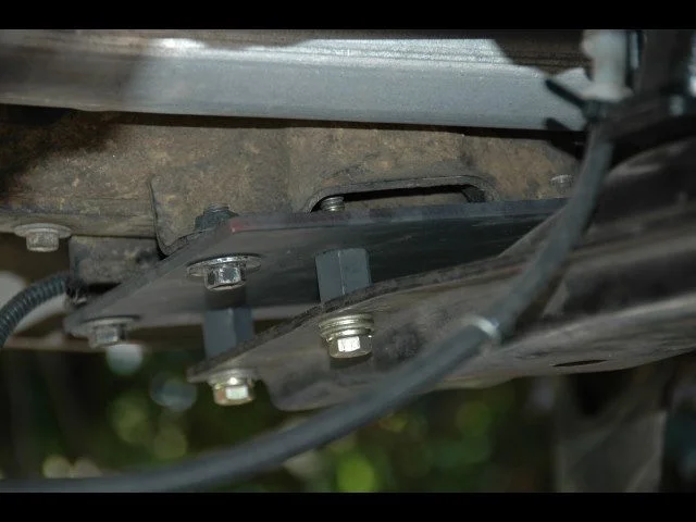

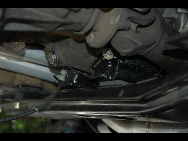

I’ll take pictures of the work and also show you what I did with the cross member. The trans only moved forward about an inch and half. I used an 8 x10 inch by quarter inch plate to move the cross member forward and some thick walled, half inch tube as spacers to lower the trans where I wanted it.

I’ll take pictures of the work and also show you what I did with the cross member. The trans only moved forward about an inch and half. I used an 8 x10 inch by quarter inch plate to move the cross member forward and some thick walled, half inch tube as spacers to lower the trans where I wanted it.[/quote]
Attached are pictures of my cross member mod. Once I do the stick shift mod, I post some pictures of that also. The middle picture is to show how I compensated for the clocking of the transmission.
