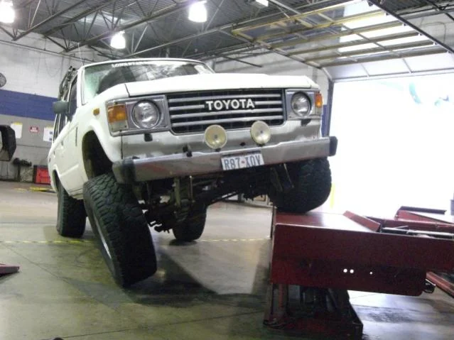

So I took it by my local tire guy and asked if he could flex it out for me to I could see if I need to get a long travel front d-shaft. Everything looked good on compression, there was not enough room to check the droop so I'll have to check that out later. but here are the pics. It was around 30" of travel. Saweeeeeeet!!!!:clap::steer::bounce2::bounce:

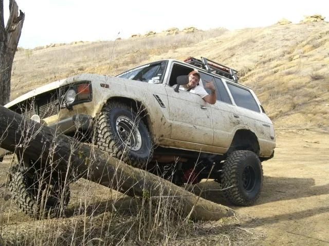

mine about 1 year ago on brand new OME springs and stock backspace wheels and 35's the rear tires were hitting on the wheel wells after about 6 inches... now with the springs broke in and dif wheels i get much more flex.
first is right after lift
2nd is somewhat recent. im around 27-28" of travel before i puick up a tire. being SUA.

very nice cruisinfj60. I was about the same SUA too. i love the SOA now! I said I would never do it but I am glad I did! To my surprise I like the ride even more now.
