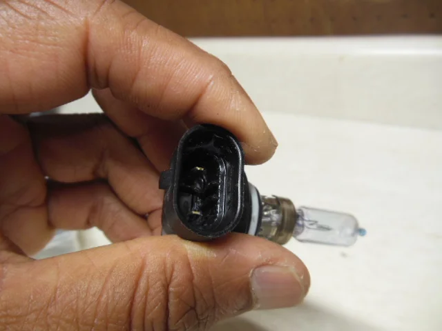

Bulb: HB-3 9005 (I bought Hella $2.21 at Rockauto). This bulb is originally for high beam so the following modifications to go into the low beam
1st Picture: Cut the two long plastic tabs shown

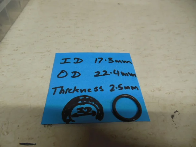

2nd picture: remove the O-ring

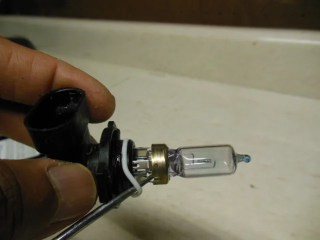

3rd picture : The required O ring
