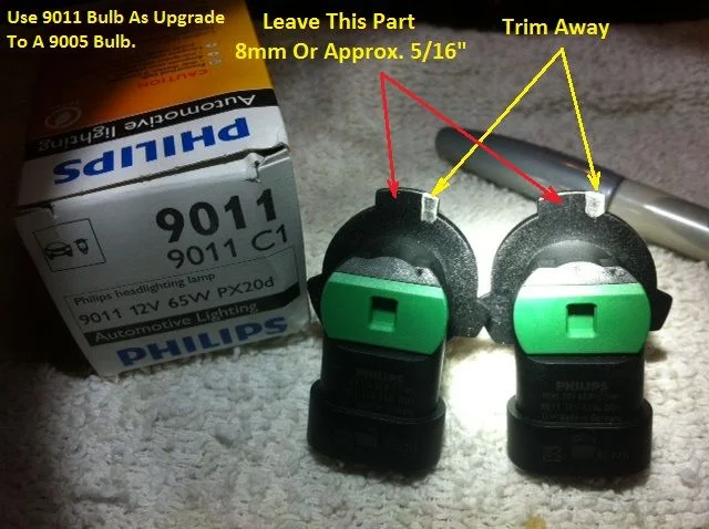

I‘m not familiar with those housings, but if your stock bulbs are 9005 and 9006 then I’d think you can try the 9011’s. They have to be modified to fit but it only took me a few minutes per bulb to trim them to fit. They burn hotter and won’t last as long as the stock bulbs so I trimmed an extra low beam bulb and put in the glove box as a spare in case. IIRC I pulled off the rubber ring on my old bulb and added it to the 9011 bulb going in the 9005 location so it would fit snug in the housing and keep moisture out. Can’t wait to see what they do in my 100 housings.
Trim base as below, take O-ring from 9005 bulb and ADD (not substitute) it to the 9011 and it will fit snugly. Much improved lighting over the 9005. Trim a couple of spares and keep them handy. (Wagner from RockAuto, crazy cheap).

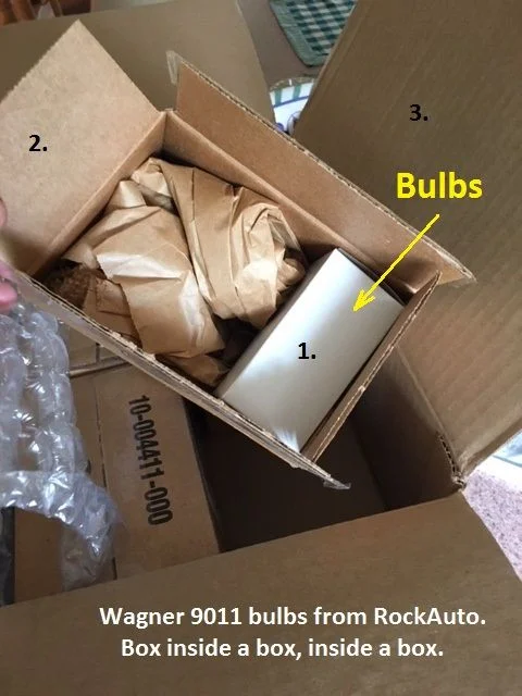

Always get a laugh when RockAuto ships the Wagner (re-boxed Phillips ) bulbs. You get this huge box , with another box inside, with another box (the actual bulb) inside of that. I guess they REALLY don't want them to break.
I just received a set few mins ago and this is how they were packed. It'd be better if they bubble wrap the bulb instead of wasting so much packaging. Oh well...
