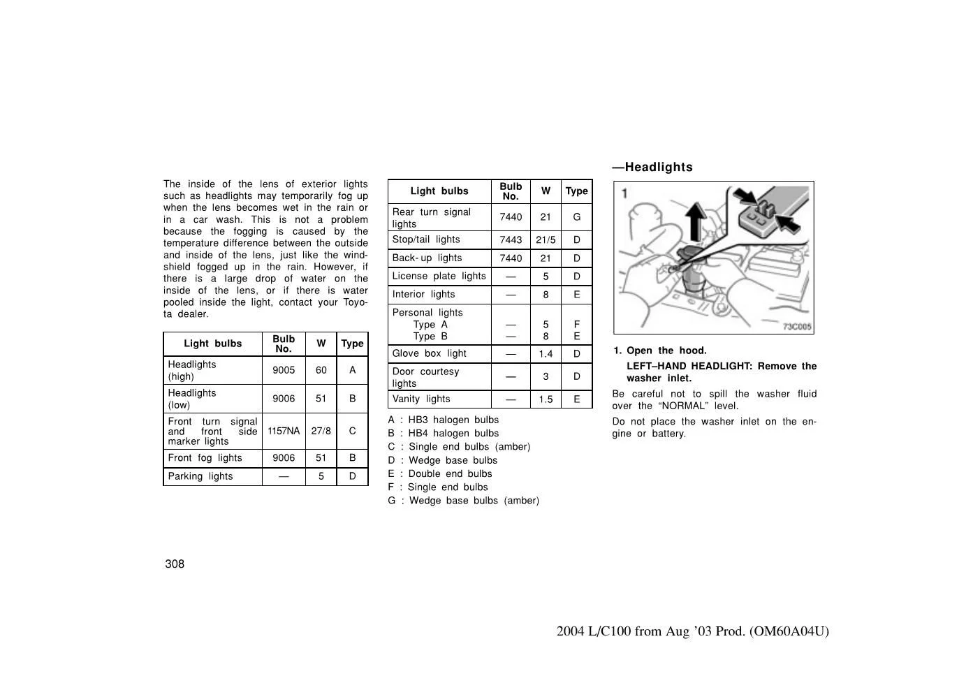

I see conflicting info in this thread. Is 9011 or 9012 in low beam? I want the brightest possible and do not care about life span.
9006 = low beam = 9012
9005 = high beam = 9011
Between @bamabrock’s diagram and my copy of owners manual page, you need 9012 for low beam.
Heck, get two sets of each and upgrade both trucks high and low.
Thanks for the clear instructions, I ordered for my 04LC.
