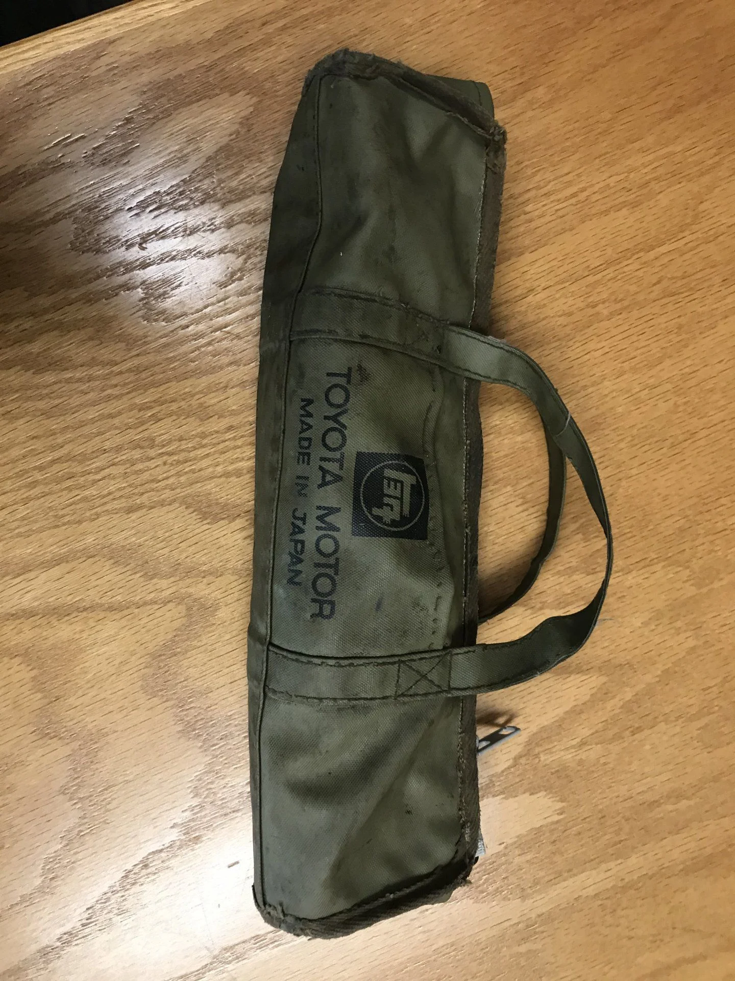

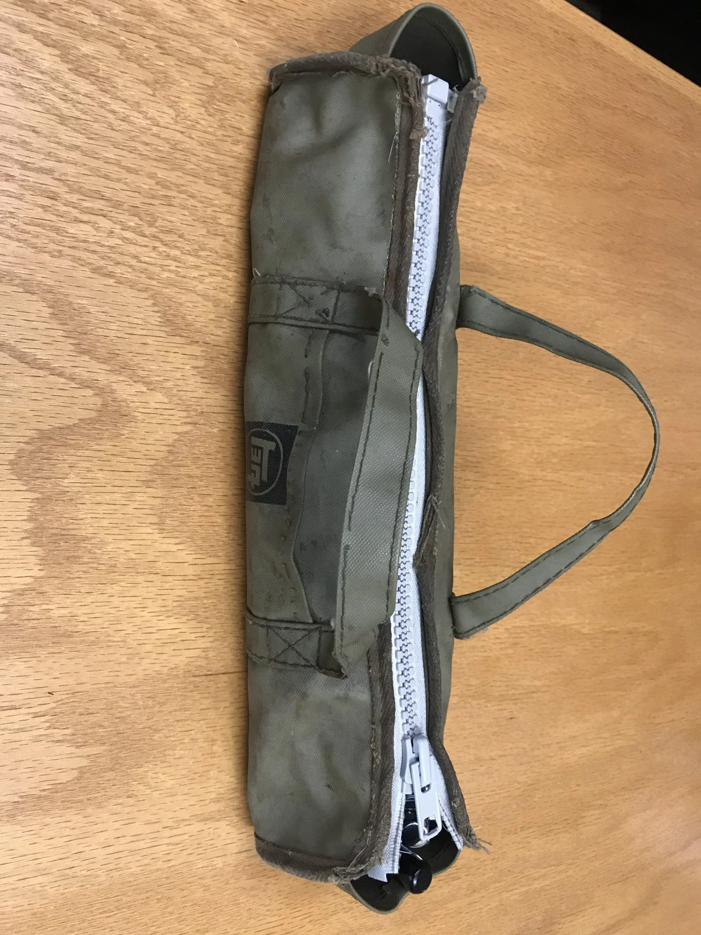

My OEM tool bag needed some help.....the zipper came totally apart, as seen below.

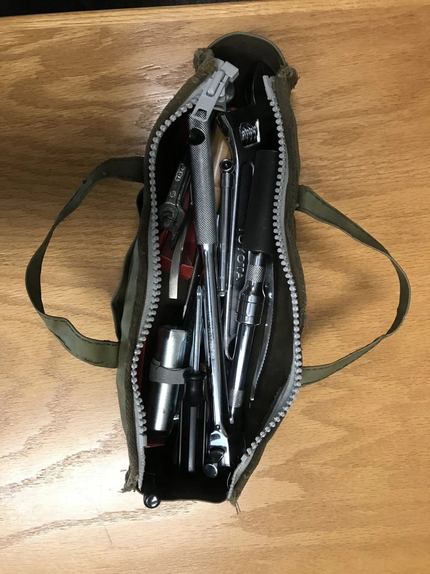

So, I bought a #10 zipper...
Whoa....it went from tan to green! That’s some special zipper.
Didn't even realize it. Goes to show how things look under the natural Sun light vs the LED of my office. Rest assured, it's the same green tool bag.
