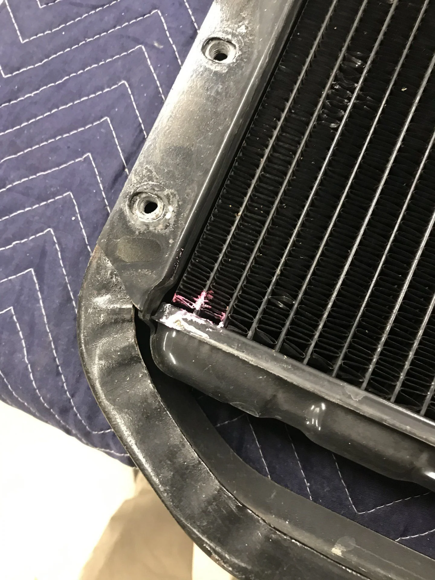

Alright, got the old radiator drained and removed.
The U-Support seems to be square and true.

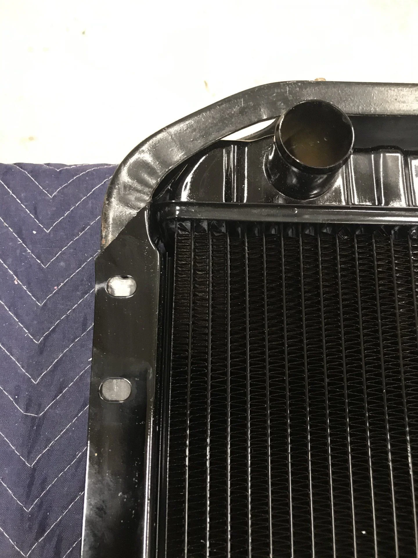

The new CSF 2888 radiator arrived today, so it looked like I was well on the way to getting this project completed..........until!
$HIT!!!! That won't do! I am NOT going to modify the U-Support or the new radiator......time for some more research! Anyone care to throwout some radiators, make & model number that are a direct replacement for the OEM radiator units?
Note: Below is how the OEM radiator unit aligns inside the U-Support.
View attachment 2569342 View attachment 2569344
View attachment 2569348 View attachment 2569351

Interesting, I was researching both those last night. One thing that I did notice about the Champion, their attachments brackets are different than the others. They use some sort of vertical angle "L" piece.
The Champion that I installed into a ‘69 is a little high making contact with the hood. I have to go back and slot the mounting holes so it will sit a little lower.
For the sake of moving forward, I'm going to re-drill the 7 bolt holes in the new 2888 radiator. Wish me luck! :hillbilly:
