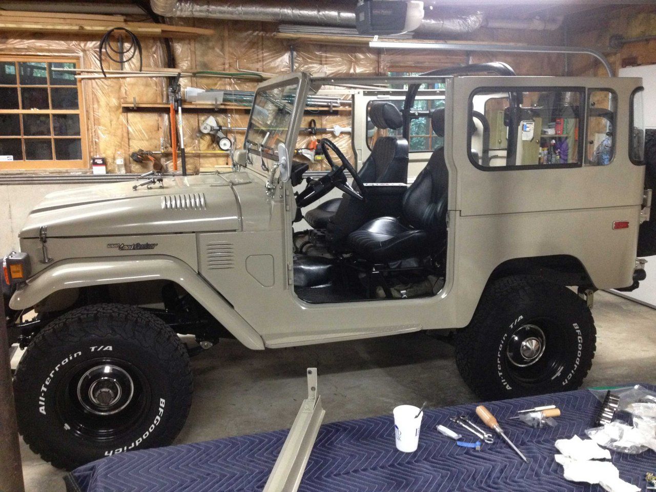

Old Man Winter is approaching, so I started the process of the re-installing the Winter Clothing. First, removed the nice Bikini that it wore over the Summer, then I cleaned up all the adjoining surfaces, and installed some new OEM weatherstripping & @Racer65 63167-90302 & 93168-90302 spacers.
Then the side panels and rear cross member.
Next up, lay in all the OEM roof weatherstripping and then the roof. Followed up by the refurbished doors.
I did this same job late last week - completely disassembled hard top for paint in the spring. Ran with a bikini top all summer. It is a major pain. I also insulated the roof and did the headliner.

Thanks for the tips! I'll heed your advice......As for the rear door cross member, I used a ratchet strap between the upper door hinges and pulled each side together. That piece is "tight as a tick" for sure!
The new side panel's weatherstripping kept the panel up off the rubber packing so I could line up the holes and start the new bolts. Once all together, I started alternating torquing on the bolts. As I alternated the bolts, I checked the weatherstripping, and the side panels slid onto the tub nicely, tucking the weatherstripping up under the side panel. These bolts are a little loose, and a final torque will take place once the entire roof assembly is back in place.
