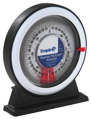

The alignment is a heck of a lot better than it was. Used this for the angle finder:
