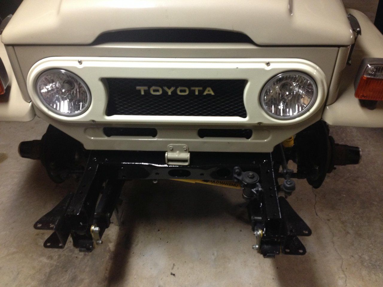

Backed it out of the basement, cruised thru the country side for a few minutes, then parked it, set it on jack stands, and now awaits getting it's under-belly rubbed with some paint. Then it will sit for a while for the paint to cure........It is also getting a face lift as well!
Here are some pic's:
This I can't stand:
