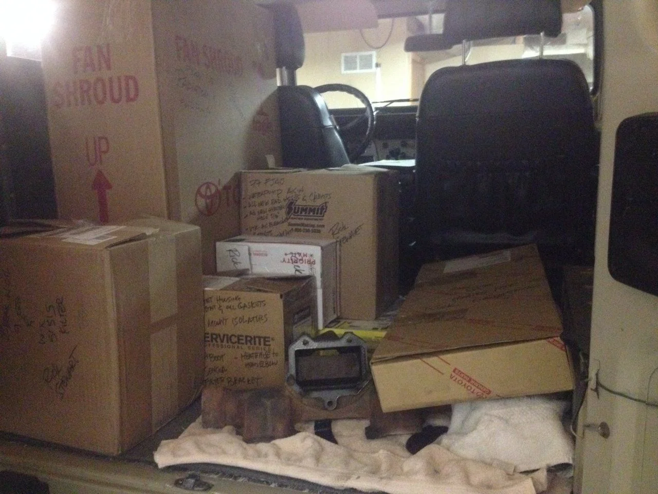

My attachments are; intake mani, exhaust mani, carb, dizzyy, new thermostat & new housing, oil filter bracket & new sensor, engine brackets & new bushings, valve cover, new radiator, new radiator hoses, all new heater hoses & engine connectors, new OEM hose clamps, new Clutch kit, Vintage Air bracket for my CCOT compressor and alternator, spark plugs & wires, Energy Suspension Kit, and anything else I've forgot to mention.
Yep, that will keep me busy for the foreseeable future. The process will begin tomorrow night.

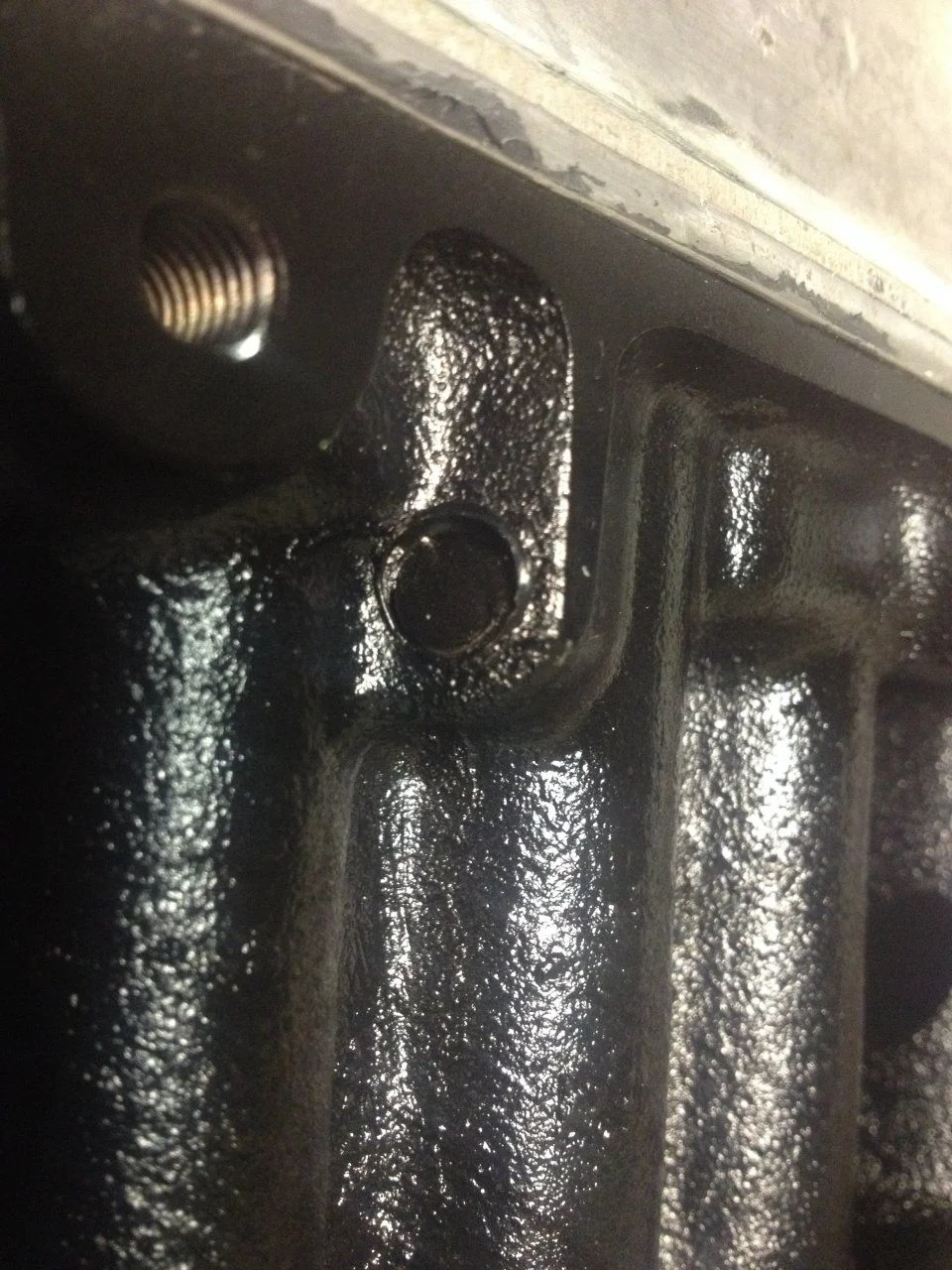

Guess what got overlooked at the machine shop? I don't even have my engine installed and I've already got to make modifications to it. :flush:
I hate to see that they missed that, but on a positive note, you did catch it and it is a pretty easy fix, even with the head on. Obviously, it would have been easier with it off, but with your attention to detail, you'll ace it with great care...a one :banana: job for you!

Heck, I missed it twice! Instead of doing it when I rebuilt my spare engine, I missed it when my engine failed. Put in a new crank and one rod and saw the spurting oil on first startup. :bang: So I ended up doing it while the engine was in the truck. So far so good.

Thanks for the vote of confidence, Skip....a 45 minute job that will take me a few hours to complete! :hmm:
OCD is no fun!......I've been told, use grease on the bits and the shavings will stick to it. Less chance for them getting inside the galley way.
Now to figure the best method to tackle this job.
Most also remove the corresponding head bolt inside that galley - I'd suggest putting some sort of a rag down inside the hole past the oil port to prevent shavings from falling down inside . Yes , a light coat of chassis grease helps hold the chips to the tap and it takes quite a few passes and clean/repeat cycles but can be done .

That's what I did

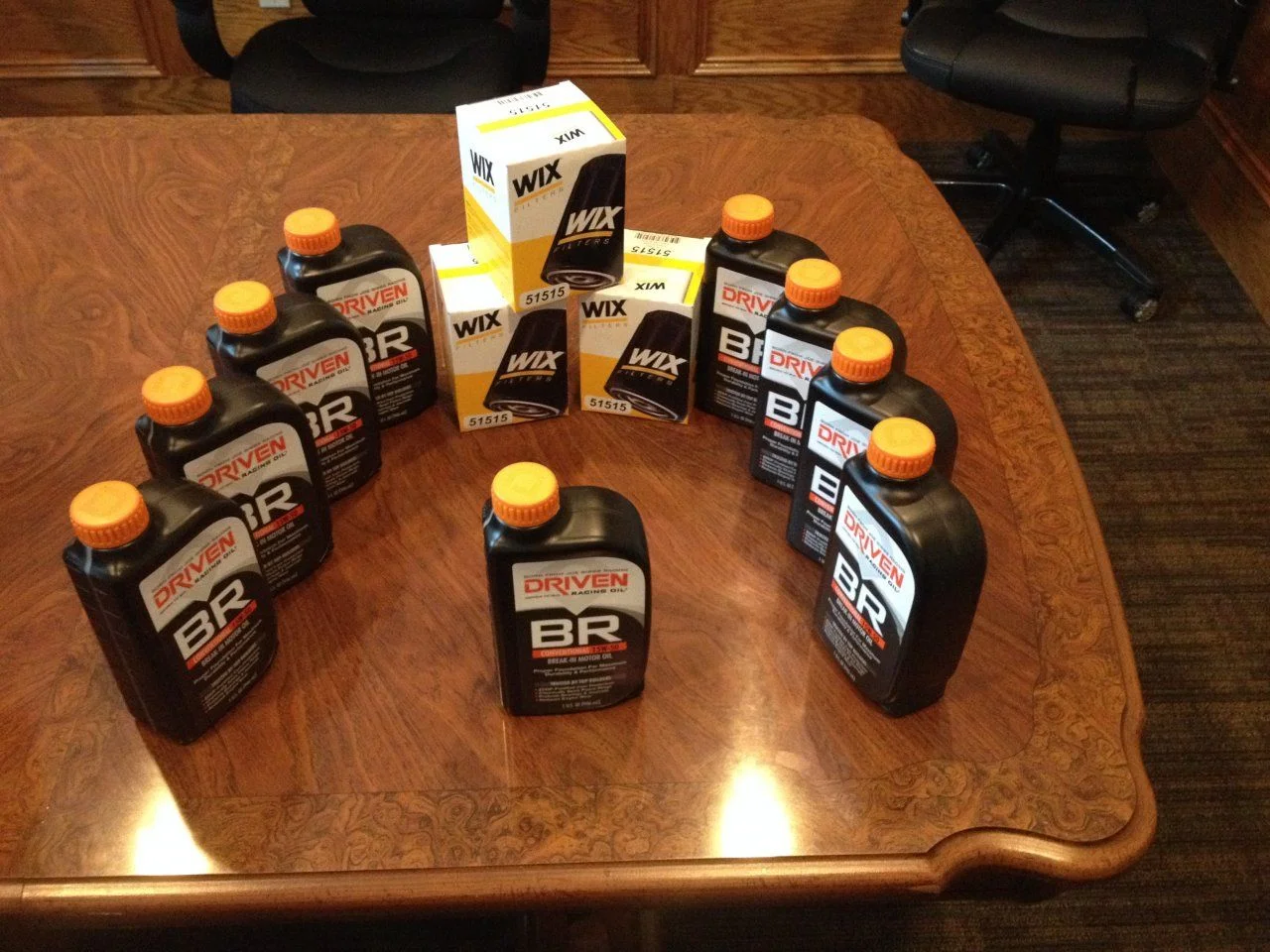

The last few items are trickling in for the engine swap. Received my rebuilt 2F's initial oil transfusion! For the first 500 miles, the GOOD STUFF from Mr. Joe Gibbs! After that, it will be (per the engine builder) Valvoline VR1 20w50 with a Wix 51515.

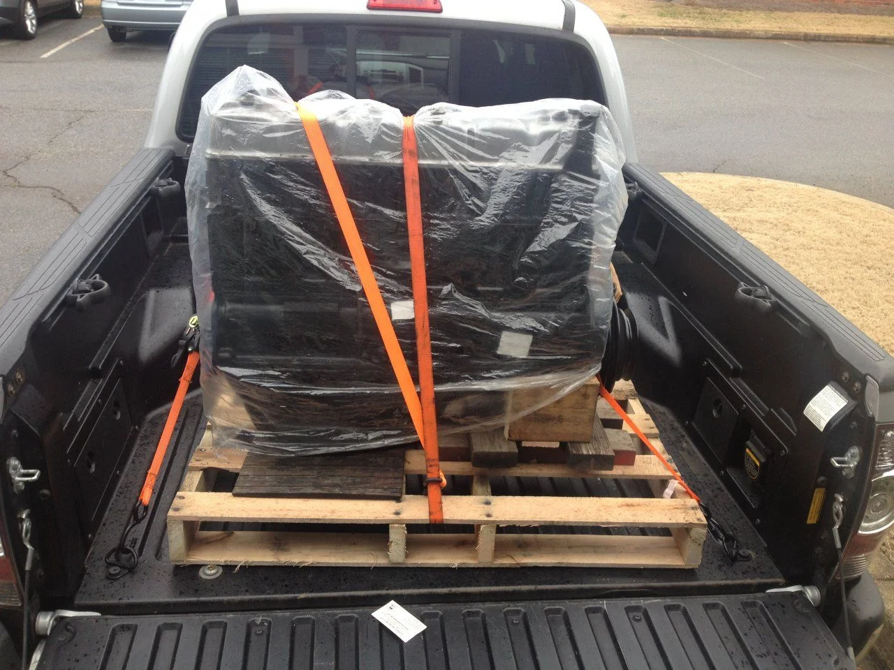

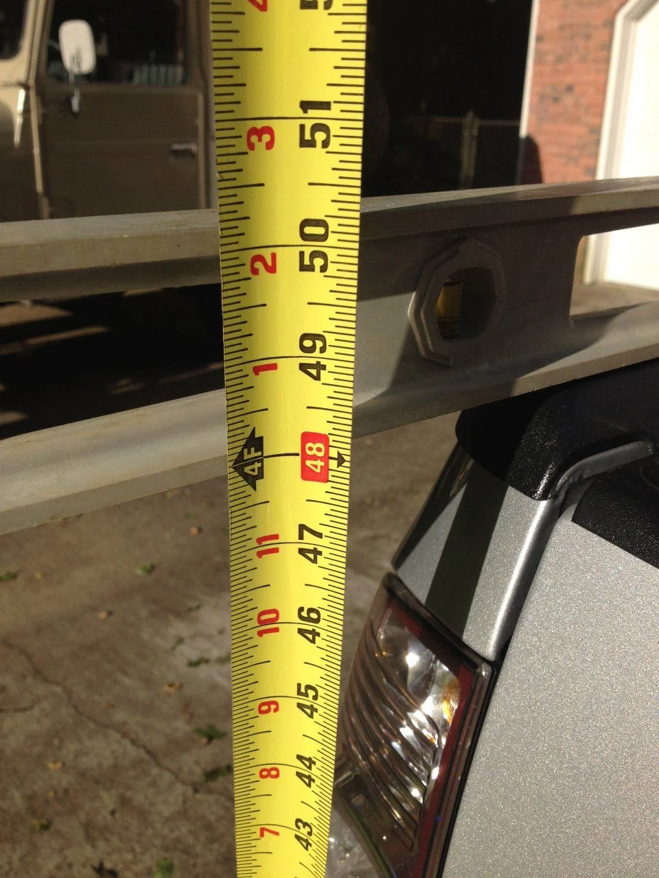

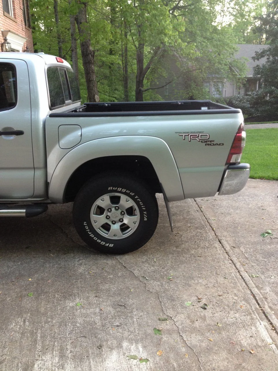

I was hoping for a pic of the Taco sagging with that lump in the back of it - their springs are not from the same lineage as a Cruiser for sure , mine bottoms out with around 350lbs in it ....
Sarge

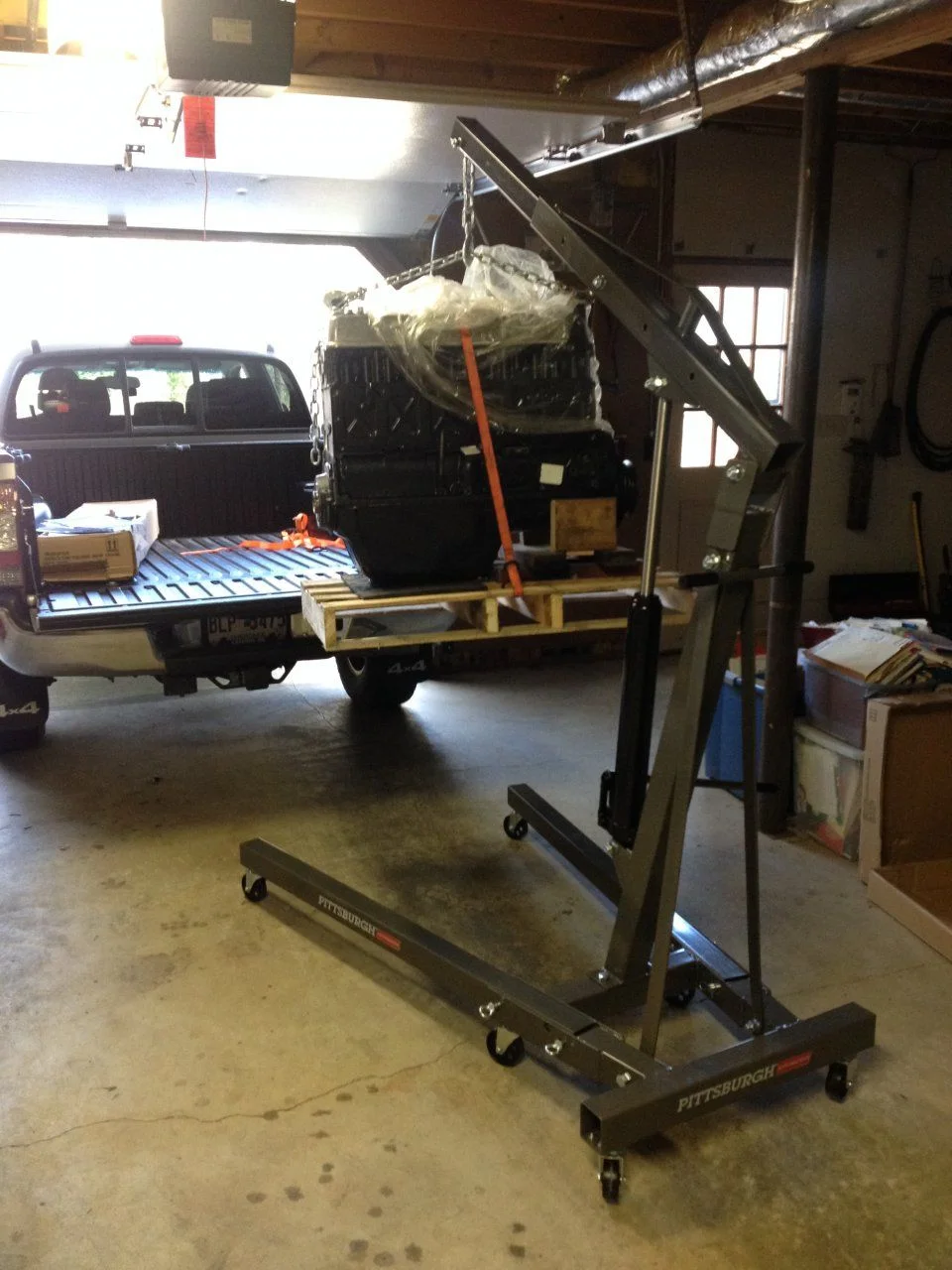

Sarge - These are for you.

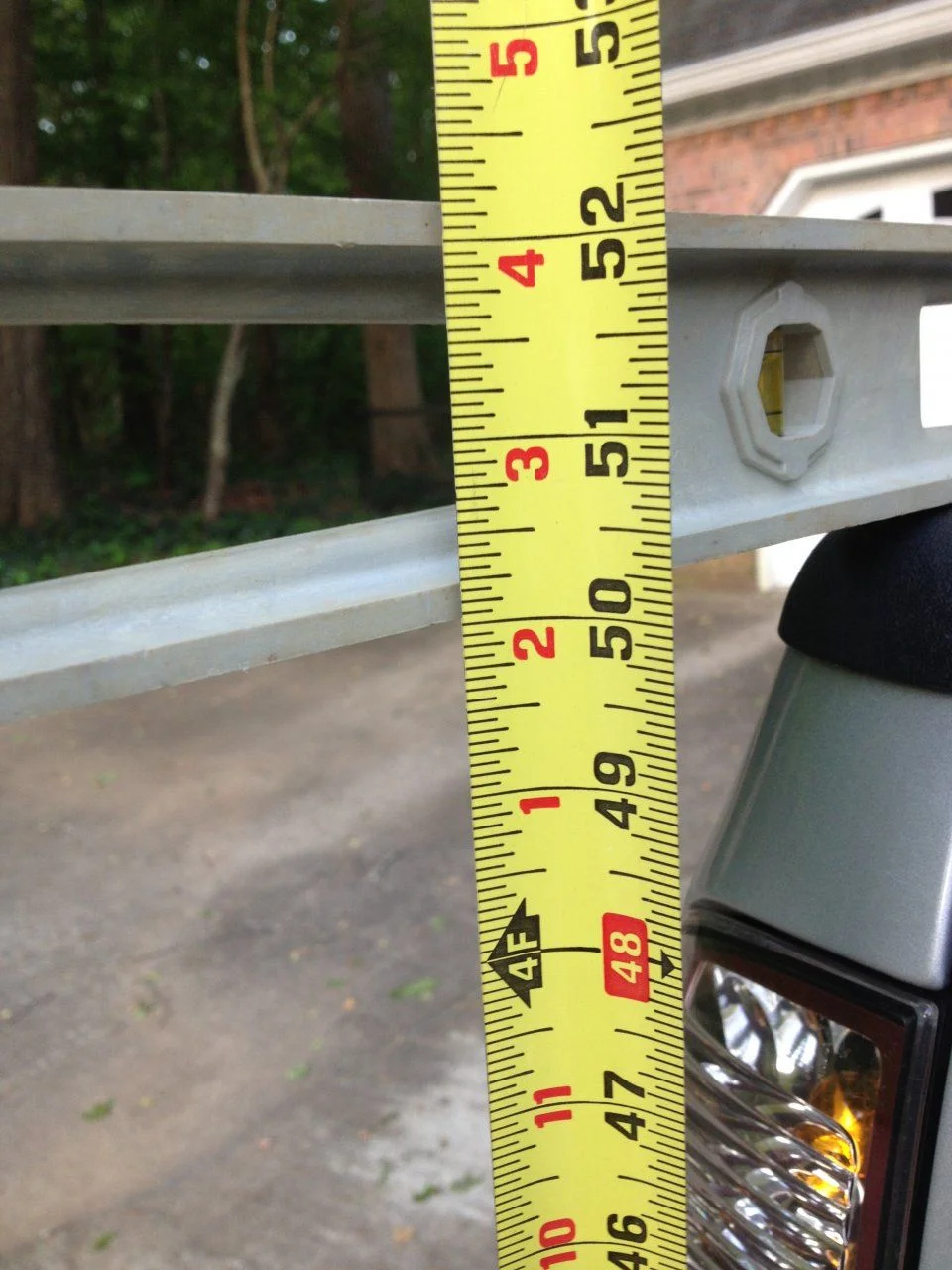

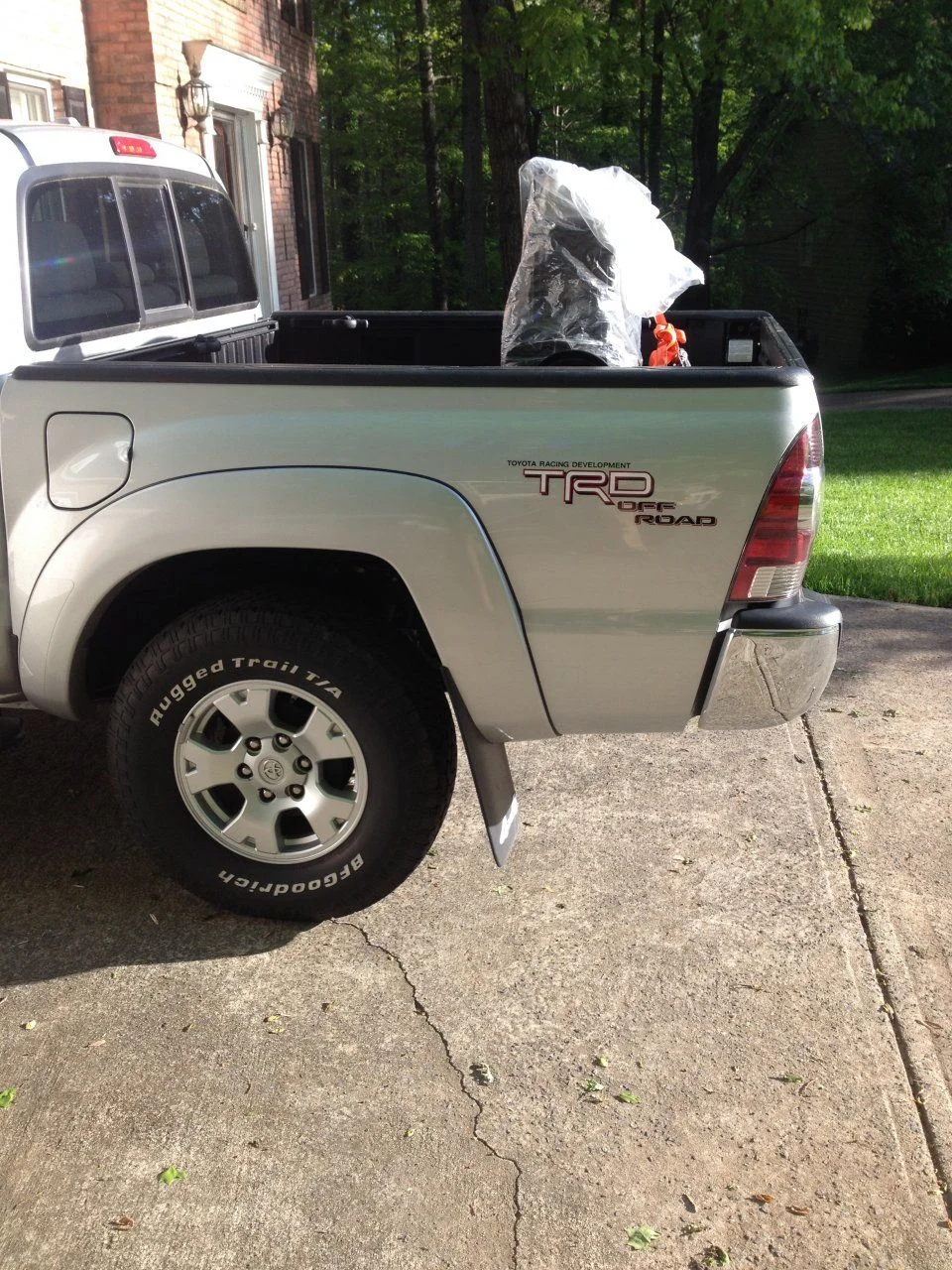

Before loading up the rebuilt 2F....empty bed
After loading up my rebuilt 2F at 750 lbs......about 2" of drop, see below.
Maybe it is time for some new springs on your Tacoma?
