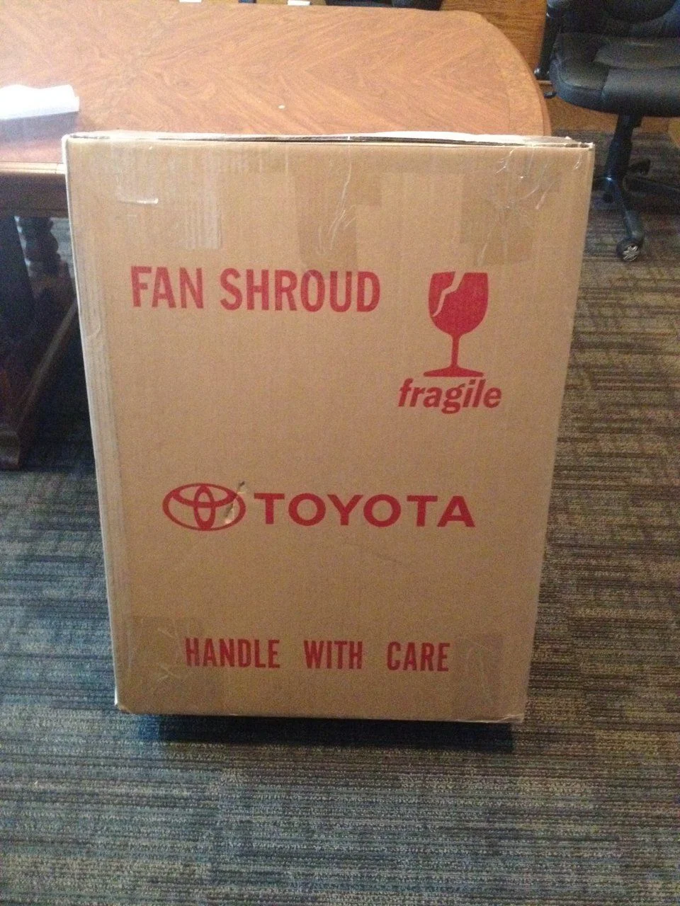

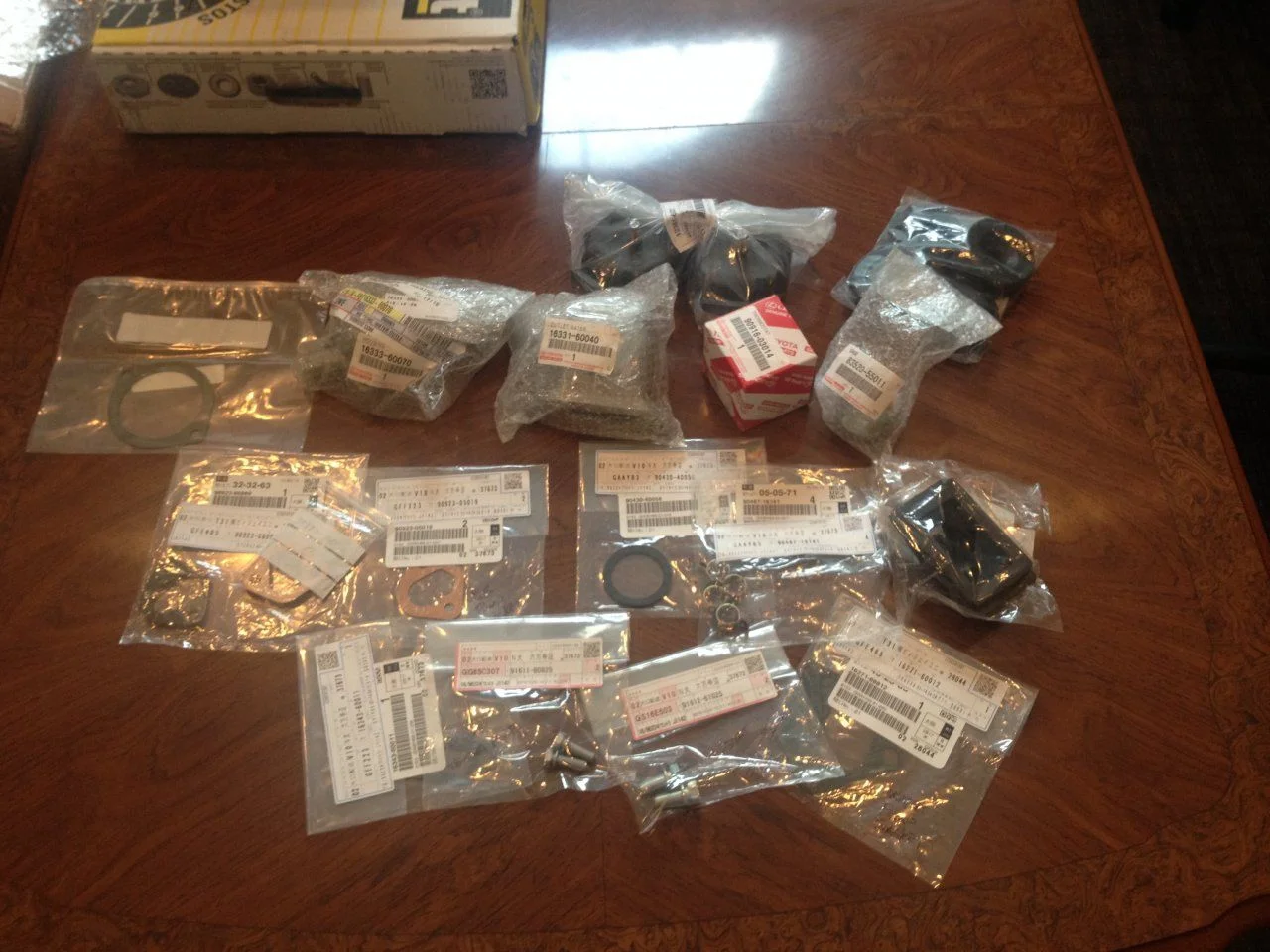

A care package from the "Mother Land" came today!
I believe I have all the parts for my engine swap now. I've just got to schedule this work before too long.
Special thanks to Beno for all the engine parts, radiator, fuel pump and spacer....Jim C. for his knowledge of parts between the '77 and '86 2F engine....NOMSG for all the engine work....Carolina Clutch for the LUK Clutch Kit....to the International Company over seas for a good bit of the small parts....and not to mention Amazon for the Energy Suspension body kit..........Last but not least, City Racer, LLC for this:

My attachments are; intake mani, exhaust mani, carb, dizzyy, new thermostat & new housing, oil filter bracket & new sensor, engine brackets & new bushings, valve cover, new radiator, new radiator hoses, all new heater hoses & engine connectors, new OEM hose clamps, new Clutch kit, Vintage Air bracket for my CCOT compressor and alternator, spark plugs & wires, Energy Suspension Kit, and anything else I've forgot to mention.
Yep, that will keep me busy for the foreseeable future. The process will begin tomorrow night.
