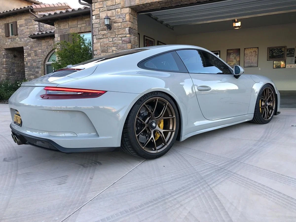

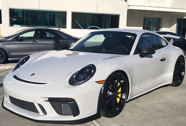

I really liked your idea about going Porsche Chalk Grey.
That's still a thought as well. Every pic I see of that color, it looks different.
I need to give the guy the color choice in about two weeks. The green does give me a military-feel. I'd be ok with not having a military-feel ever again beside receiving my pension and VA payments 😁
Dune Beige! Would be way sleeker than a German color...

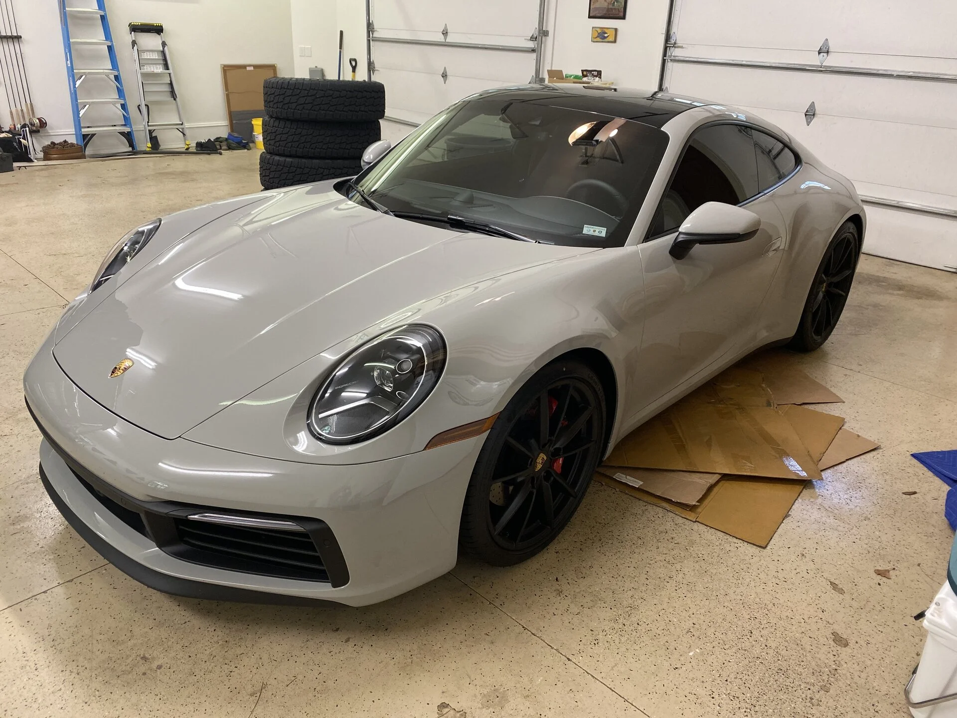

I had a new 911 in Chalk Grey. One of my favorite Porsche colors.
Some pics it looks lighter, others darker, sometimes it even looks like a slight hint of pink. Lighting and cameras I guess. I haven't seen this color in person so I have no idea. I'm definitely not opposed to it though. Gray certainly fits my daily mindset 🙂
Haven’t seen one in person in that color but the pinkish tone is likely a mix of lighting and bad digital camera color temperature/white balance choice.

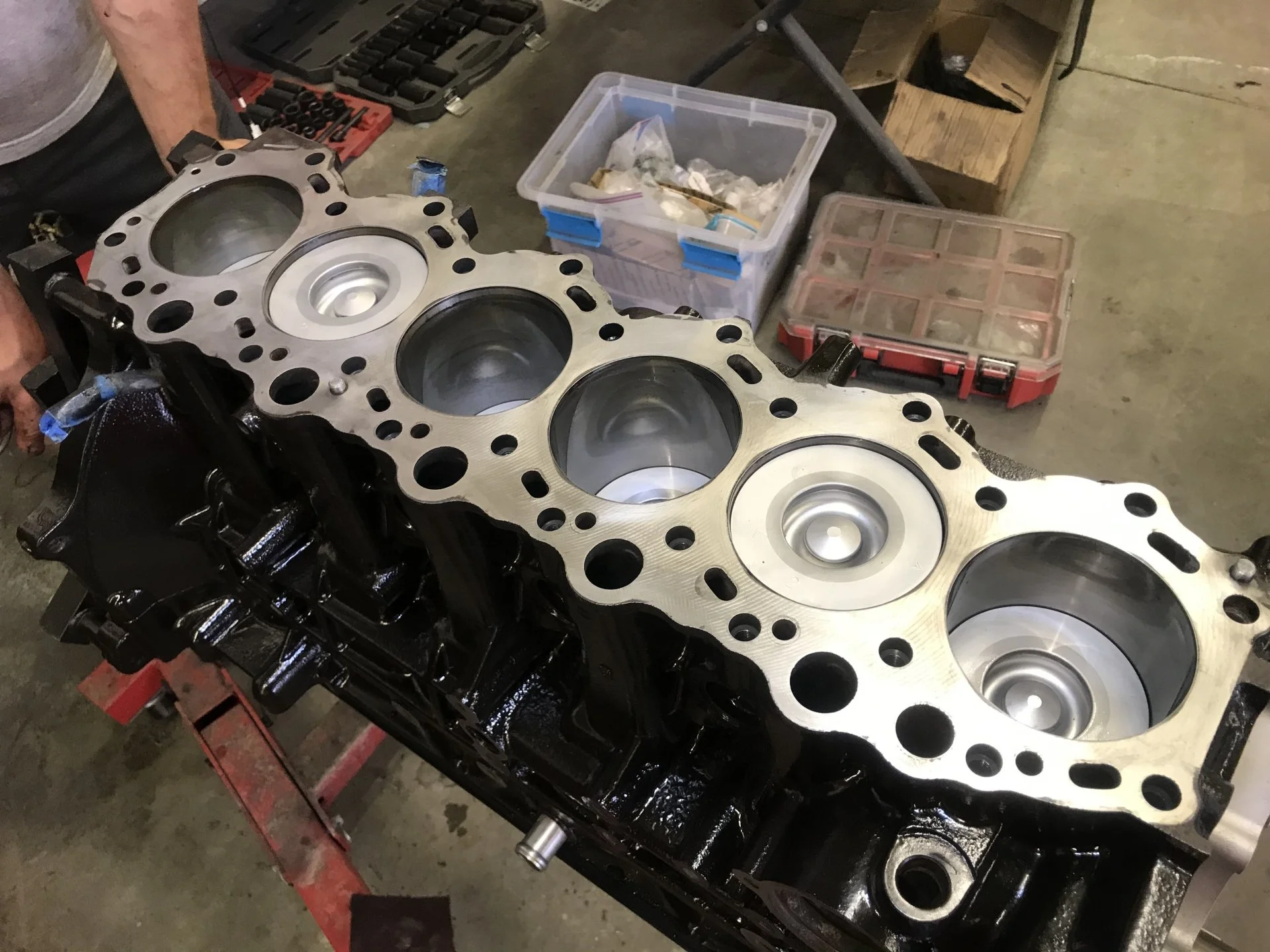

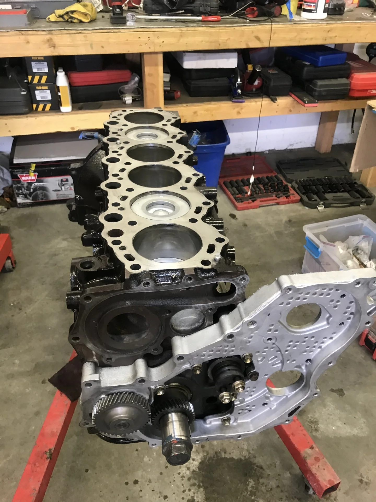

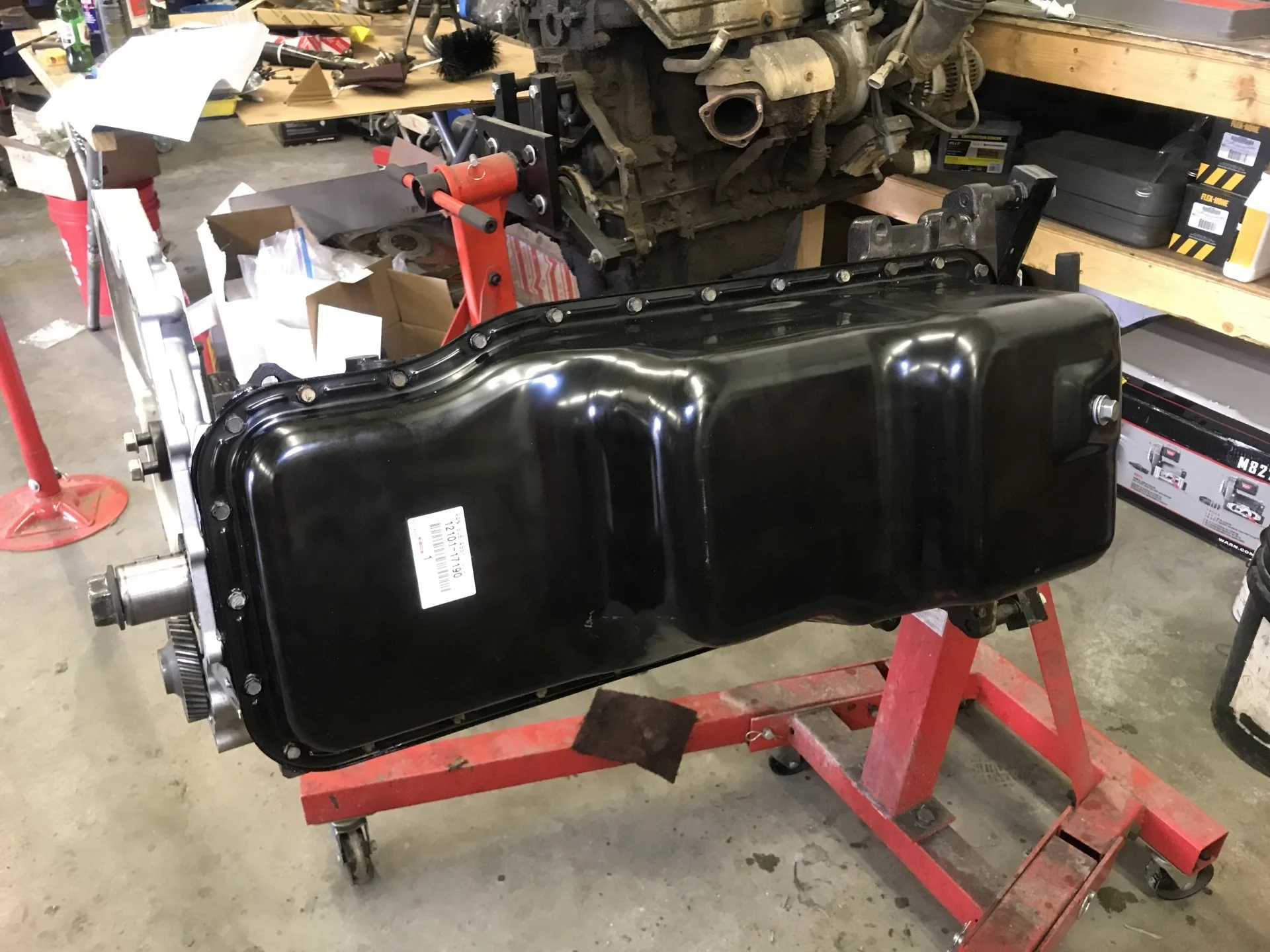

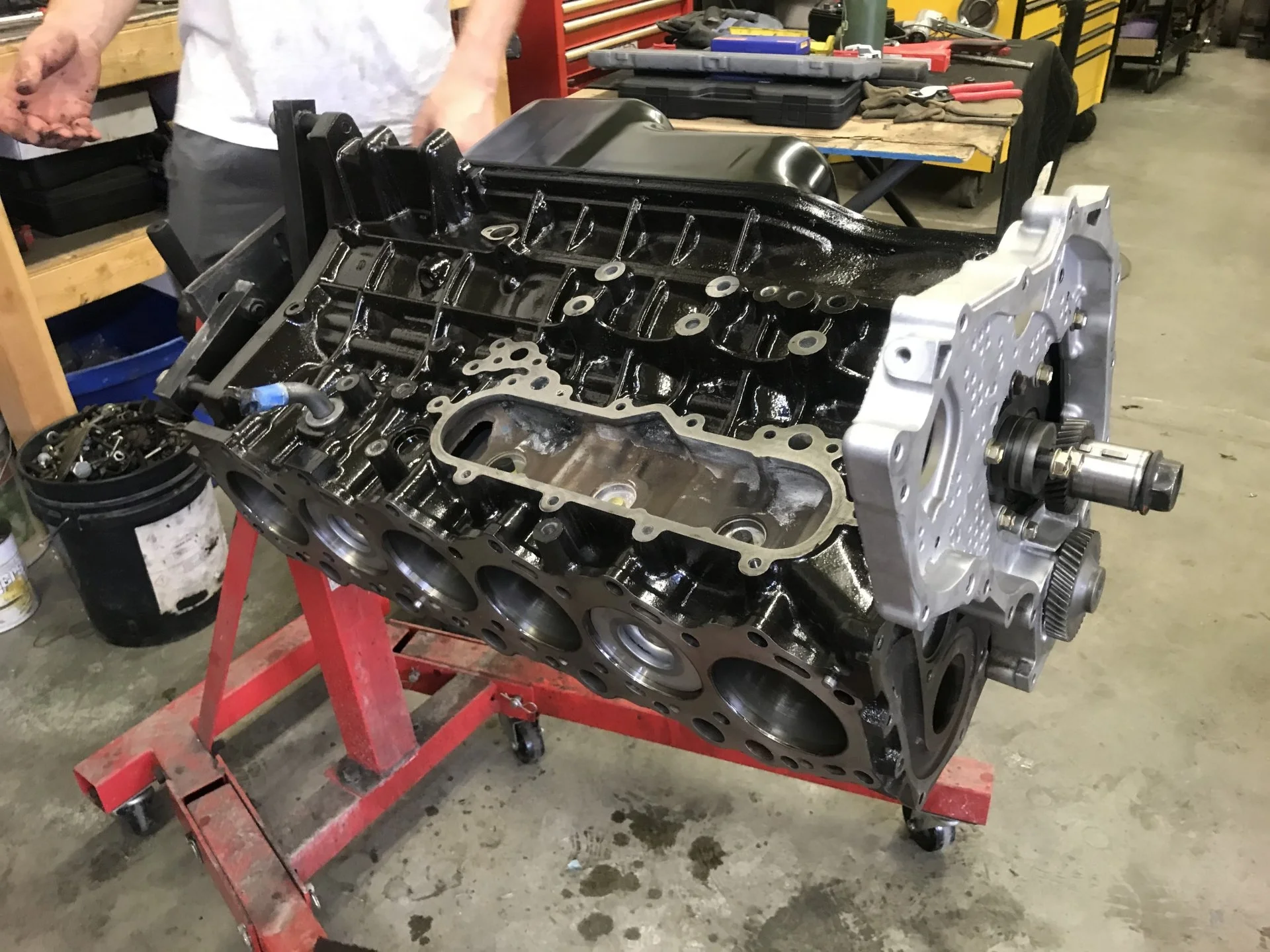

Tony installed the rings & pistons today. He also did rear main seal, oil pickup, oil pan and the rear timing case. 😎
View attachment 2742735View attachment 2742736View attachment 2742737View attachment 2742738View attachment 2742739
Once assembled, we gave it a run by hand. 😆
If I didn’t already know I would think these are new pistons. Everything is-did assemble beautifully.
Cheers
bit late to the post, do all engines turn so smoothly by hand like you demonstrated ?
In regular engines, with no ancillaries, yes. It should be buttery smooth. Cylinder walls were well oiled and bearings were gooped with assembly lube.
In something like a NASCAR or high performance drag car with tight bearing tolerances, not so much.
Blow out!, just sat and went through the whole post. Thank you for showing how it is done proper. Very humbling.
