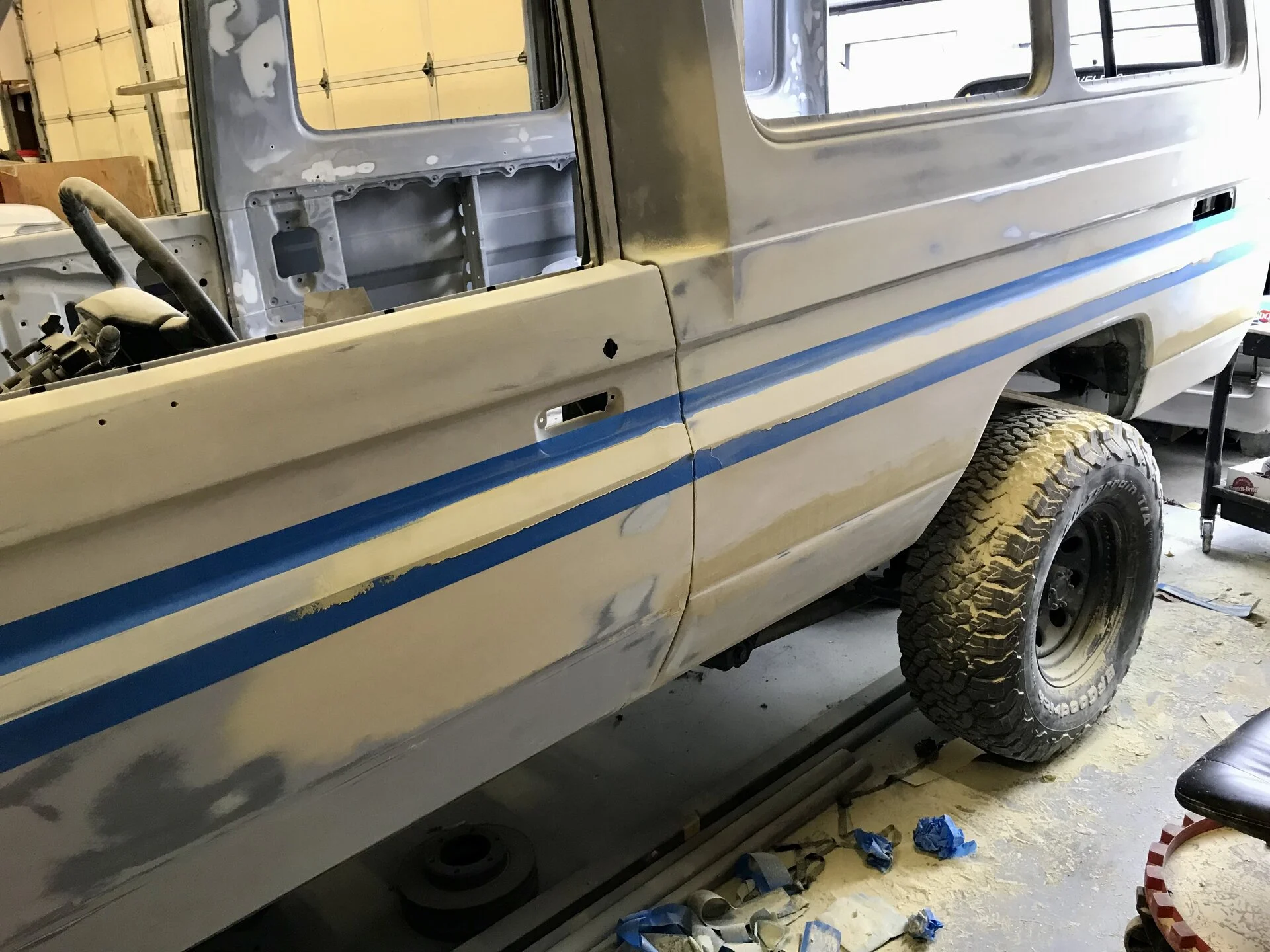

Chris who works for me has a four year degree in automotive restoration. So he knows paint & body work real well. We don’t have a paint booth though and we are not painting Cruisers. However we can do ALL the prep for paint, which we are starting on now.

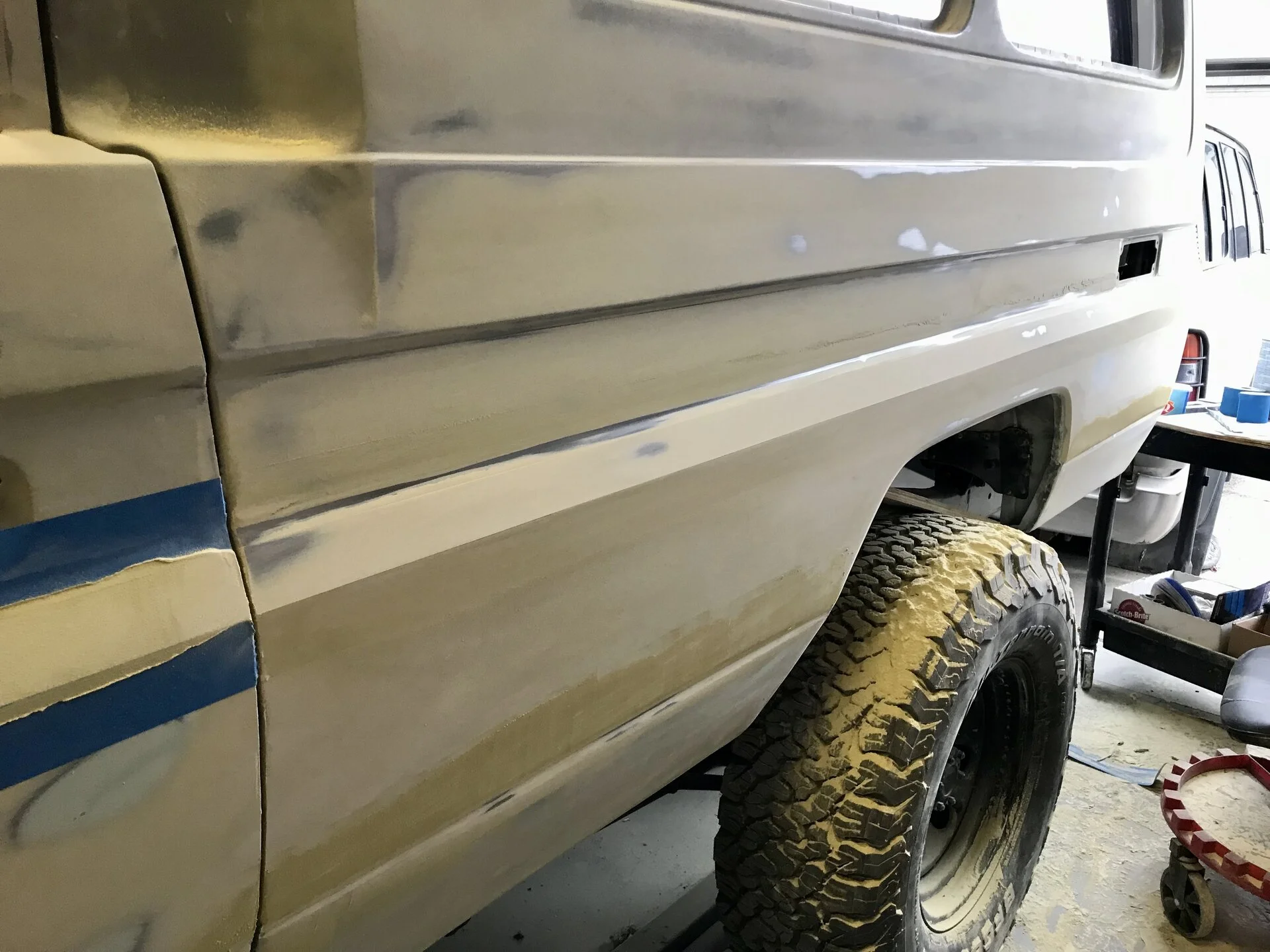

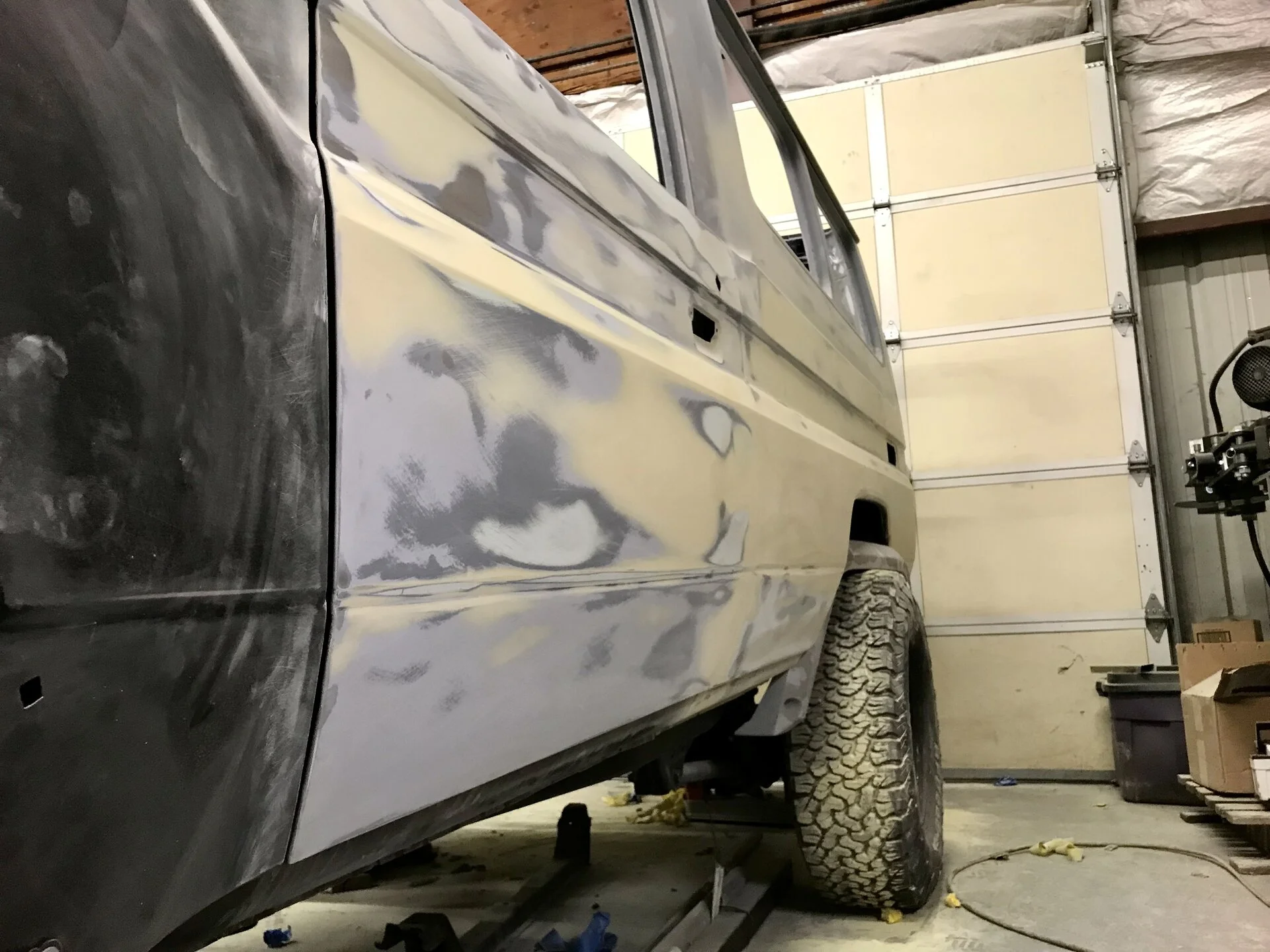

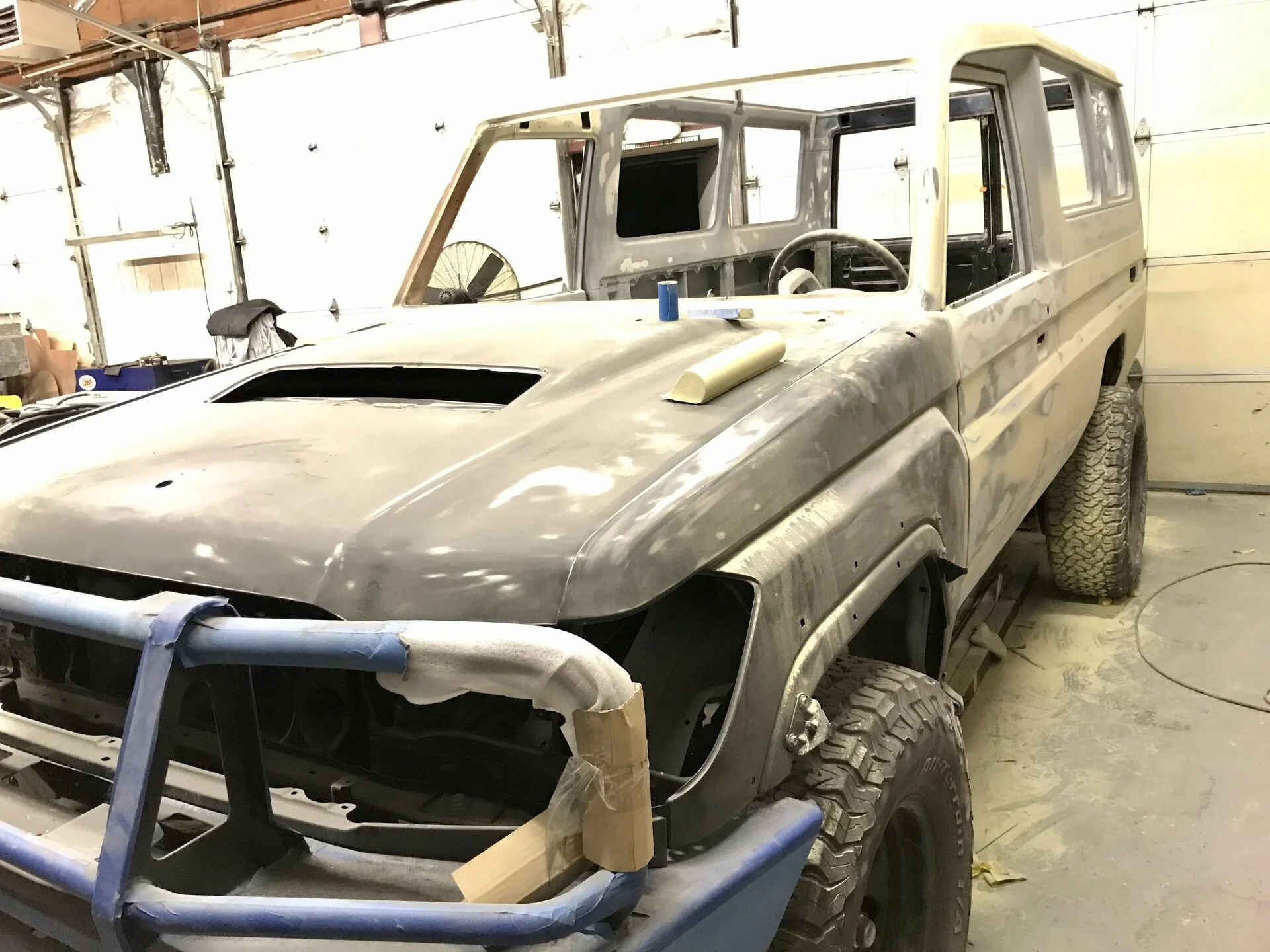

This side we took down where there was to much filler and because there was a bunch of bare metal we had to spray some 2k epoxy primer. #1 rule with body filler is don’t lay it down on bare metal.
The spot on the door Chris did and is what we will be doing to the whole body on the Troopy. We will need to primer this side as well where it got over sanded and we have bare metal.

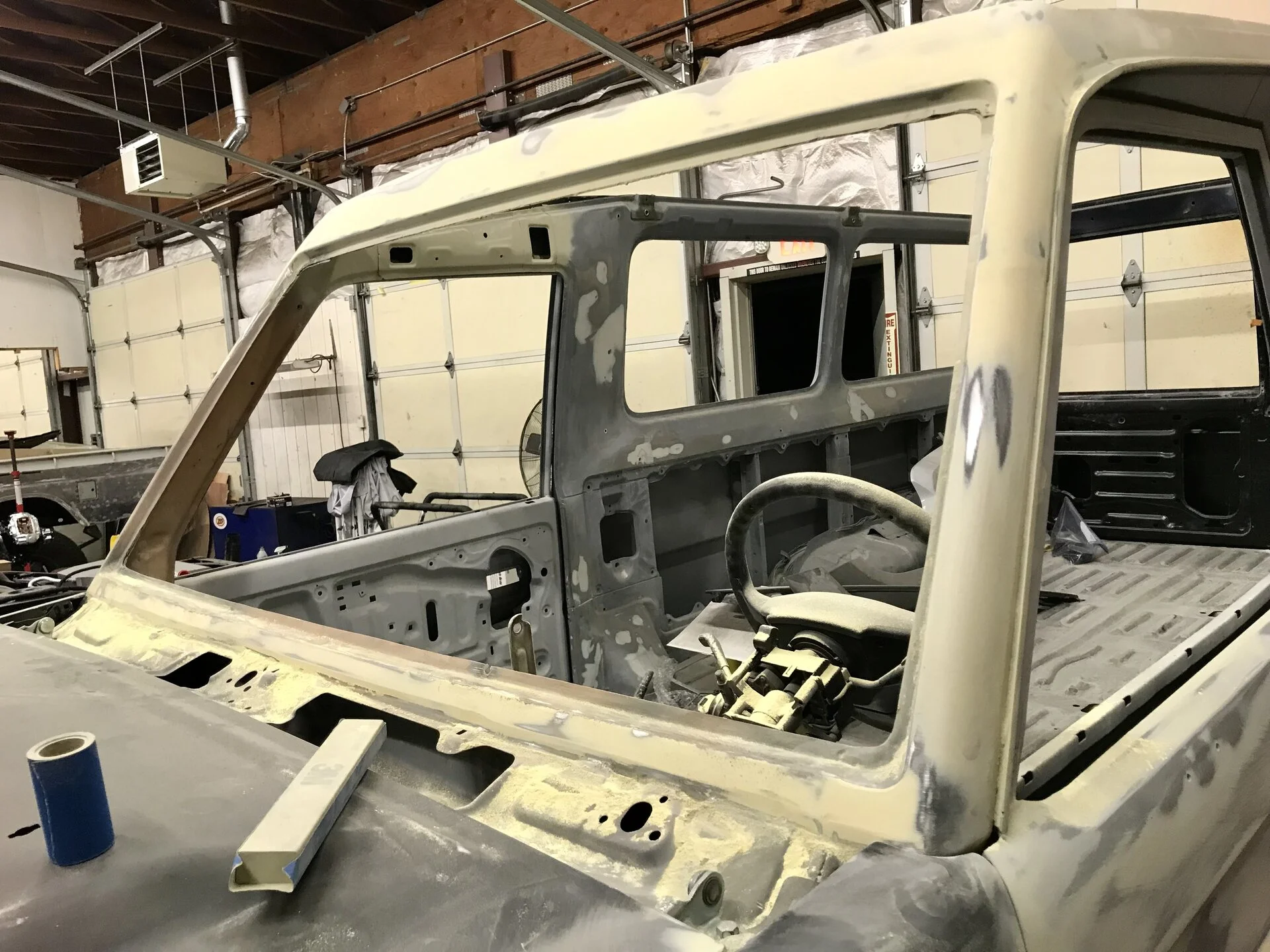

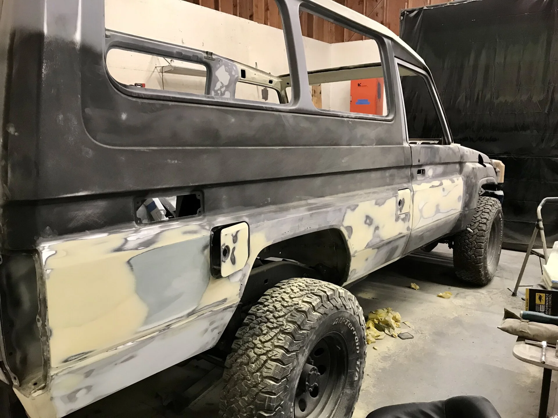

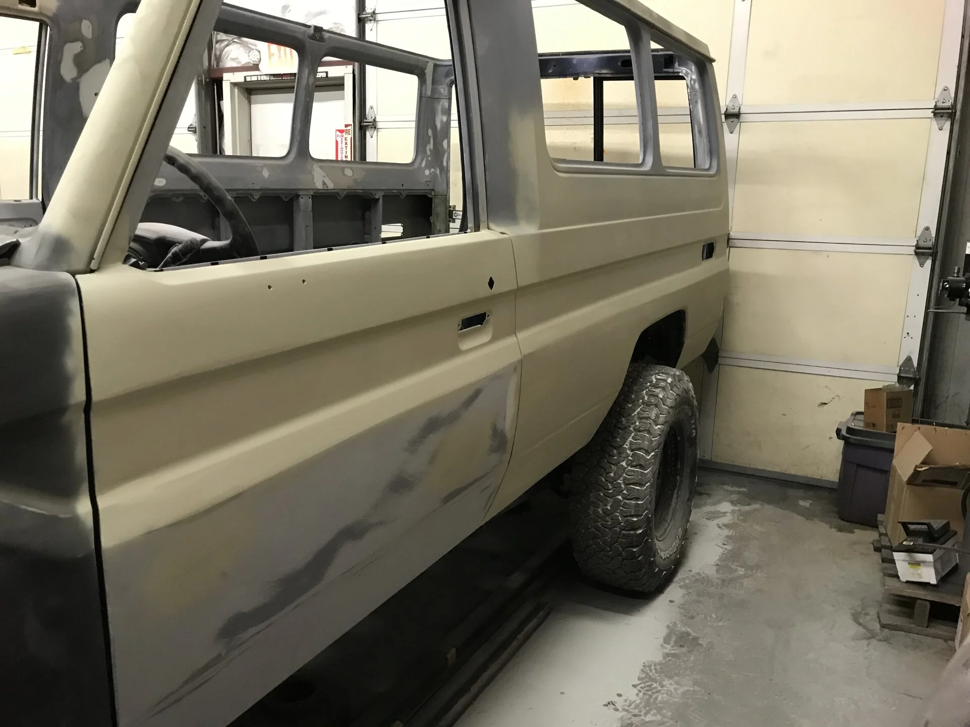

Hard to see when not in primer but this side is pretty much done and ready for primer.

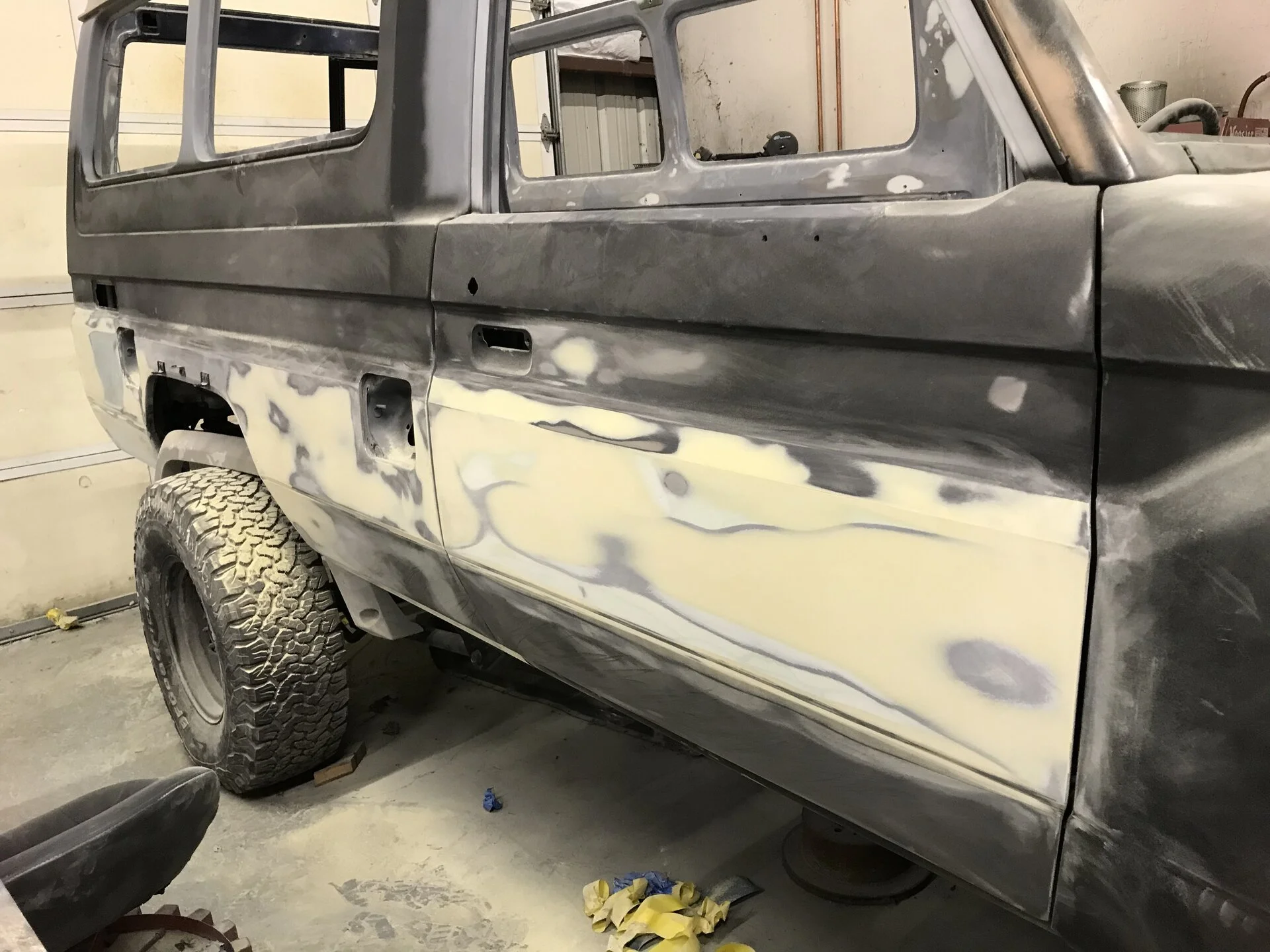

This is the other side which was better.

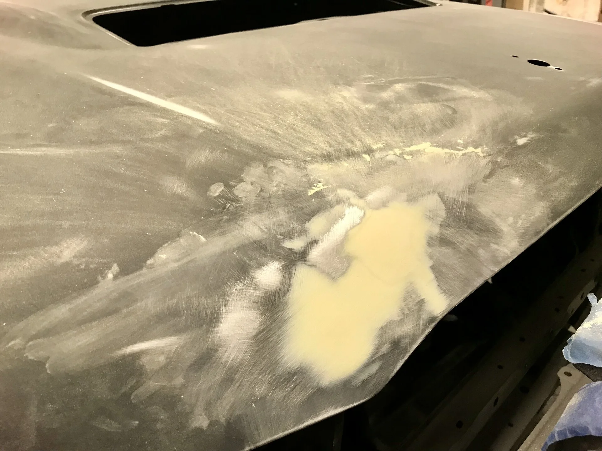

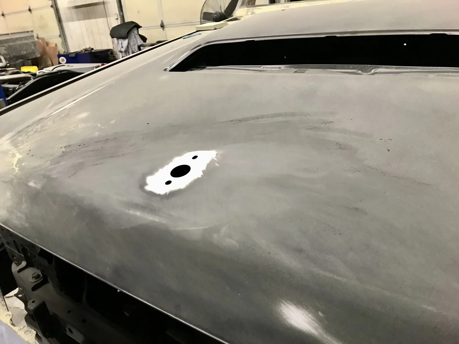

Spot on the hood that got damaged in shipping.

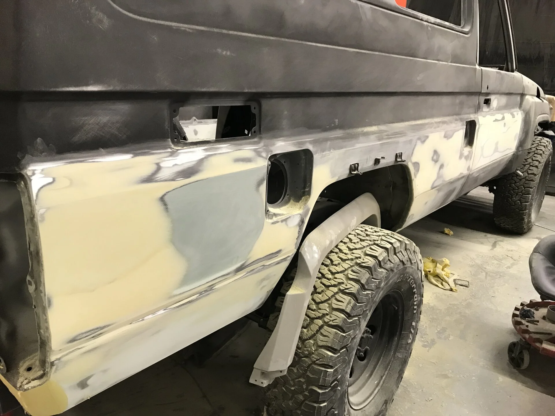

Looks like we will have used about a gallon on body filler when done but as anyone who has done this kind of work knows, a lot ends up sanded off.

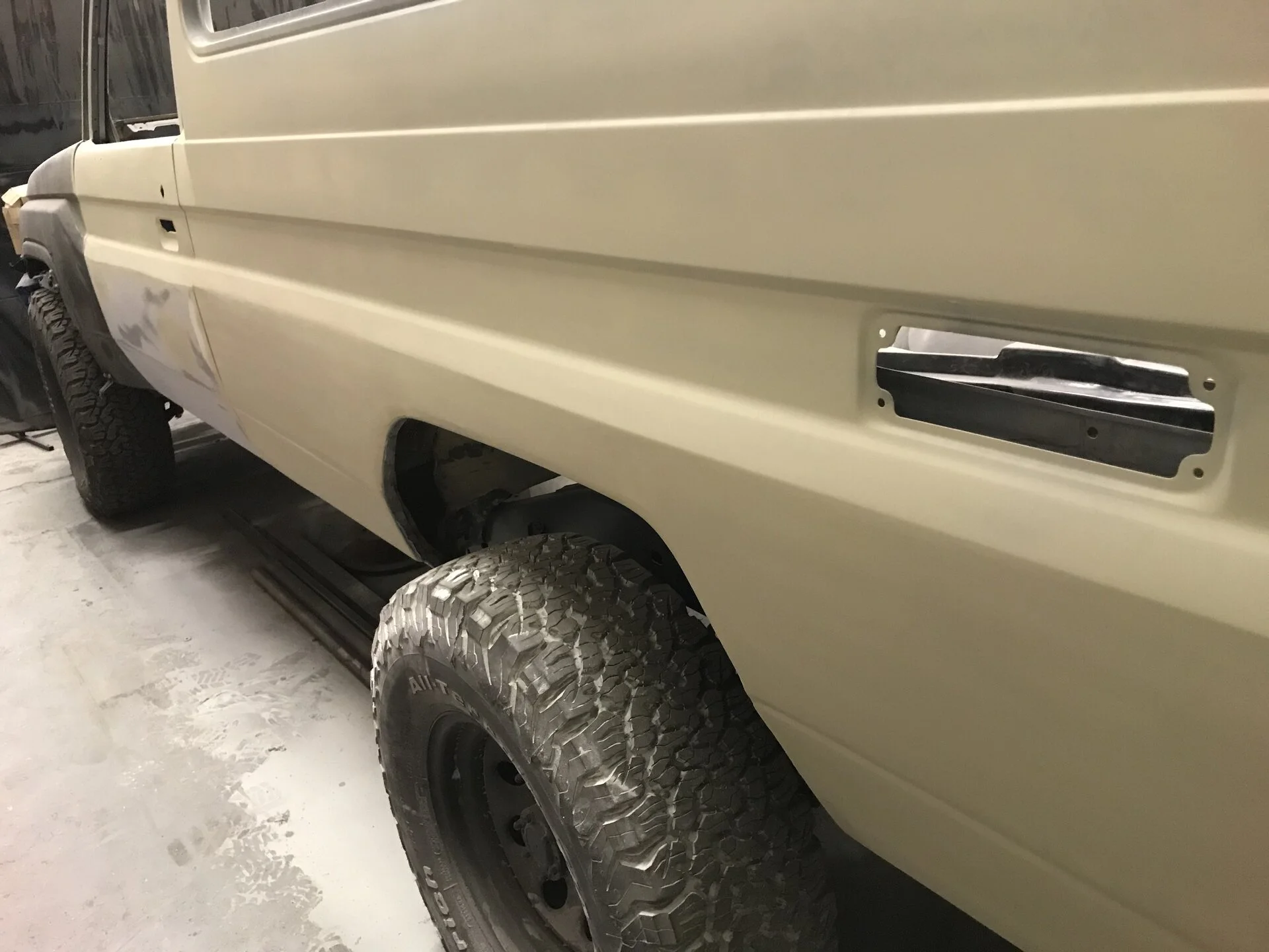

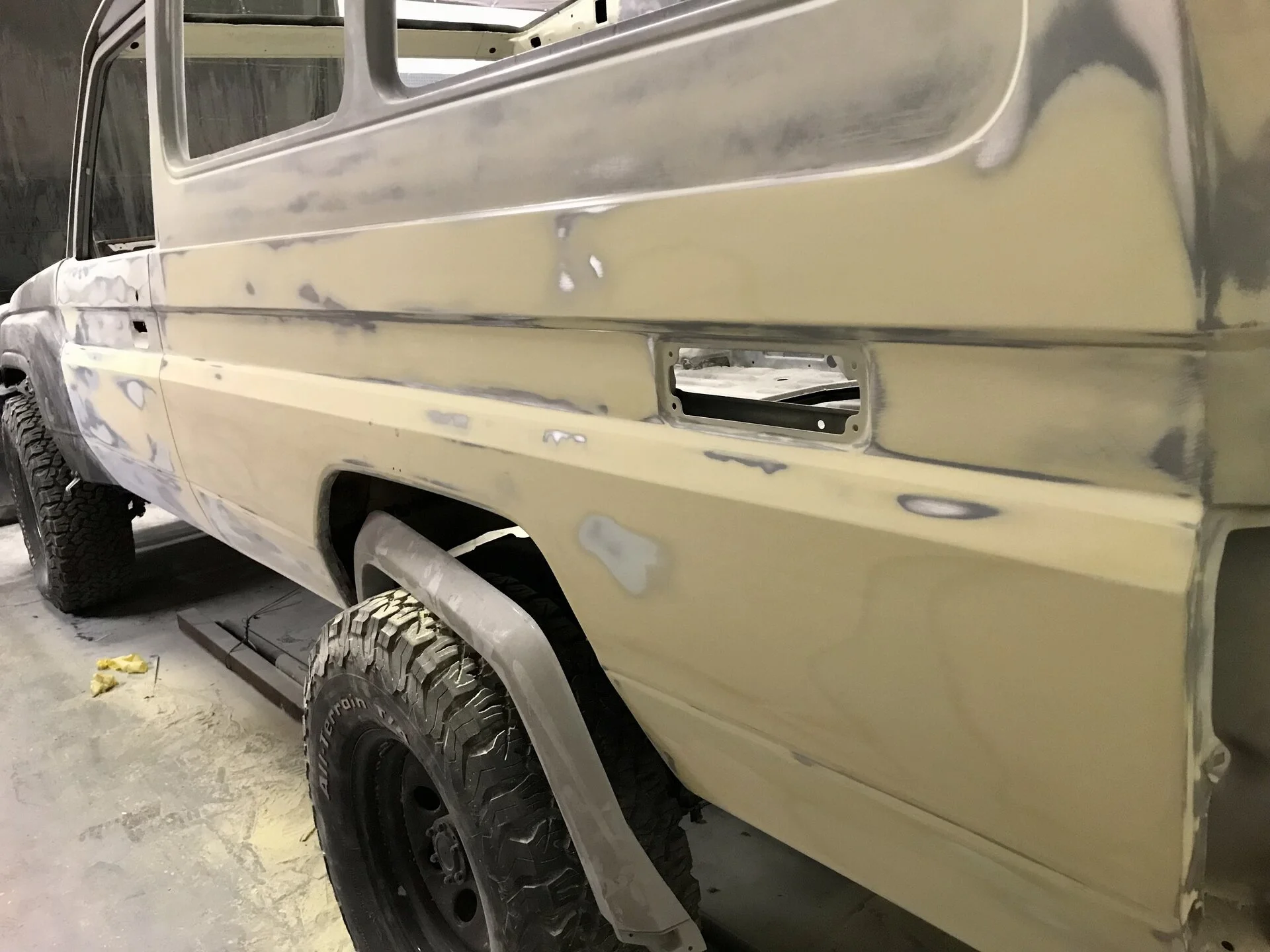

This side is done and ready for primer.
Back doors are done.
Working the windshield frame.

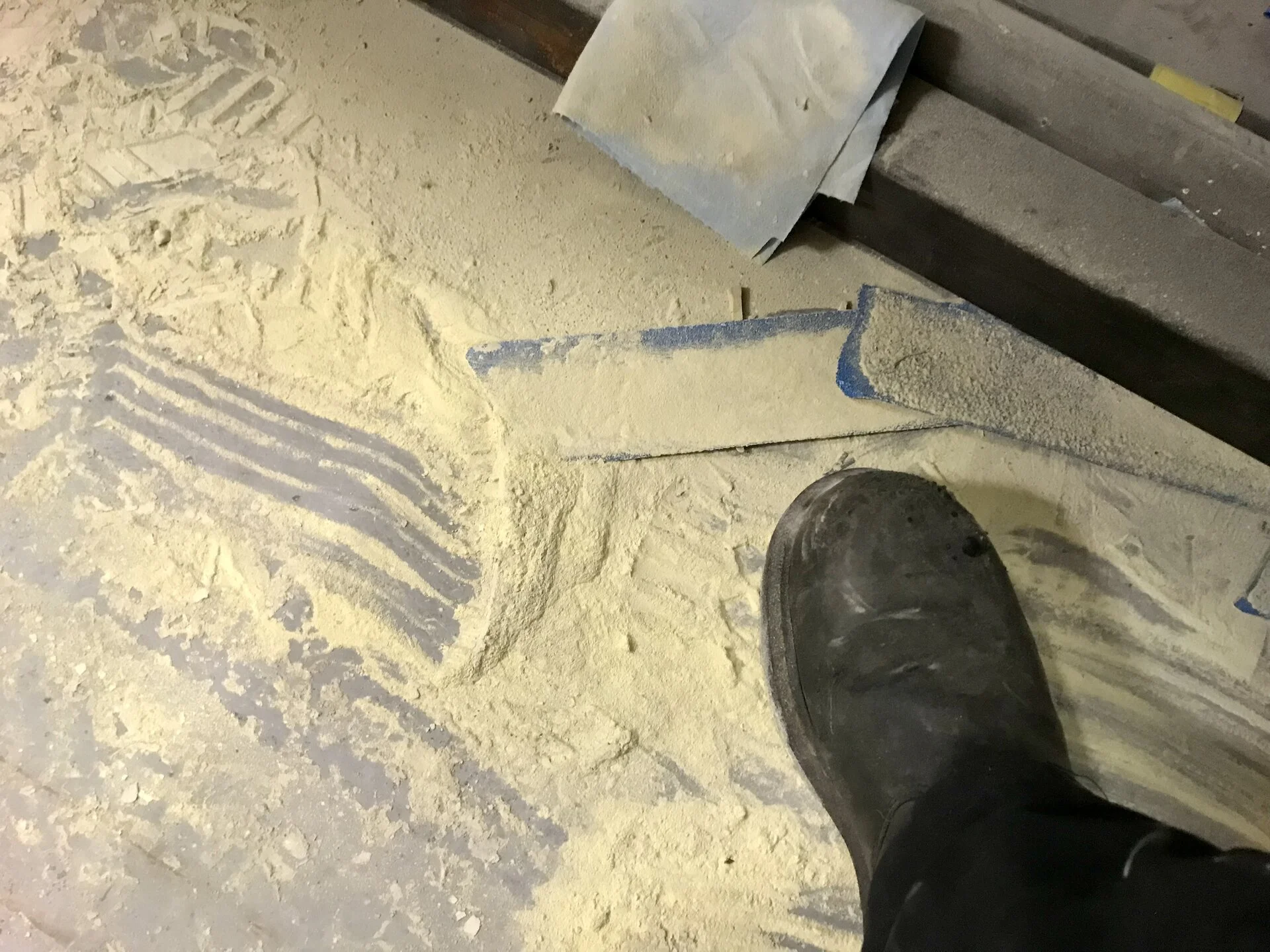

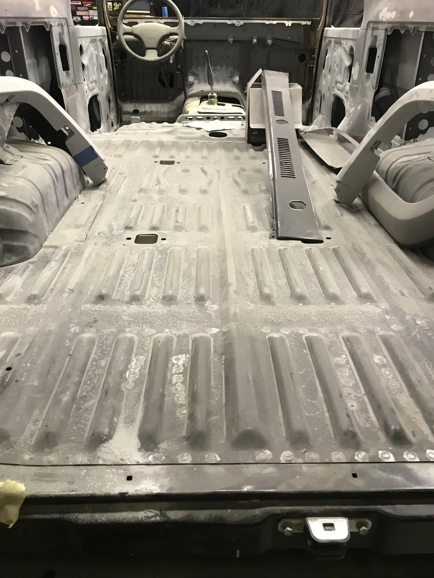

Dusty but this new floor is 🥰 even dusty!
A bit of a big deal to me to be getting to this stage in the build. Been a long road with the Hodgepodge! 😜
