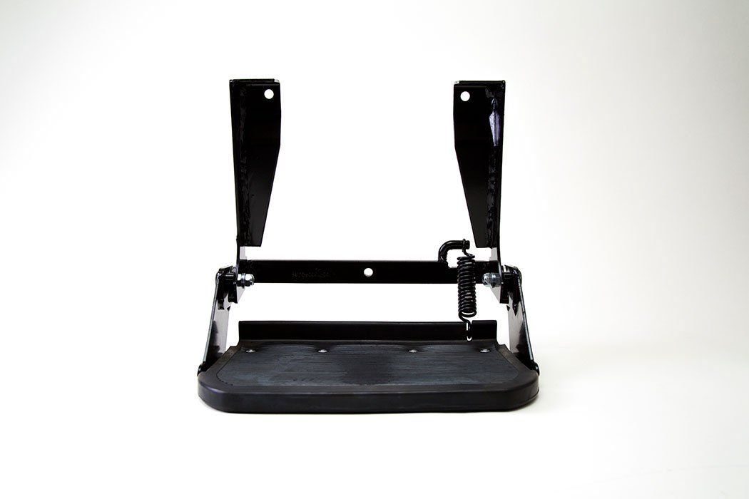

Hey Trail Tailor. Do you know anything about the step off the back of the bumper on this rig? I have a a Gobi X bumper on my 2002 HZJ78 and was looking for something like that for my setup.
Yes, it is off of a Land Rover Defender. Customer added the spring loaded step, not sure of the particulars though.
