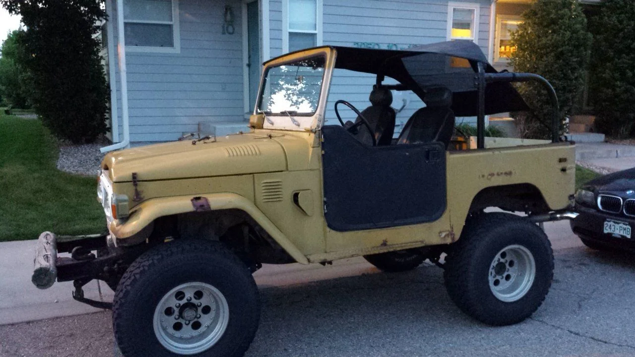

I have been driving it on short trips to work and school and decided to pull the top since it has been so nice out.
The rust under the top was not as bad as it could have been. I also need to come up with a plan for the rear quarters as they are rough.

Also installed some Bestop doors and a SOR Extreme Summer top that I just didn't like installed how it was supposed to be so I attached it to work more like a bikini top. The gas fumes rolling into the cab were killing me though so I did a quick fab job on a tailgate. Seems to help.
