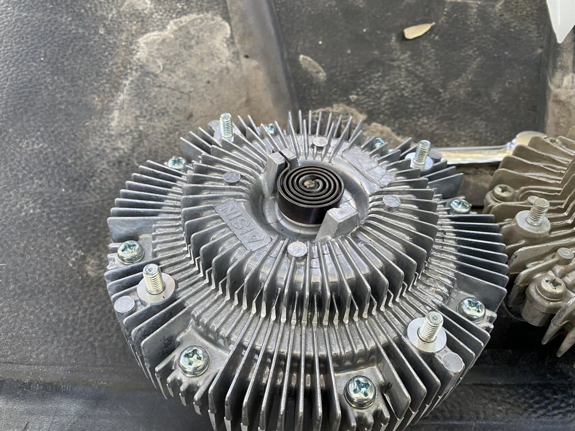

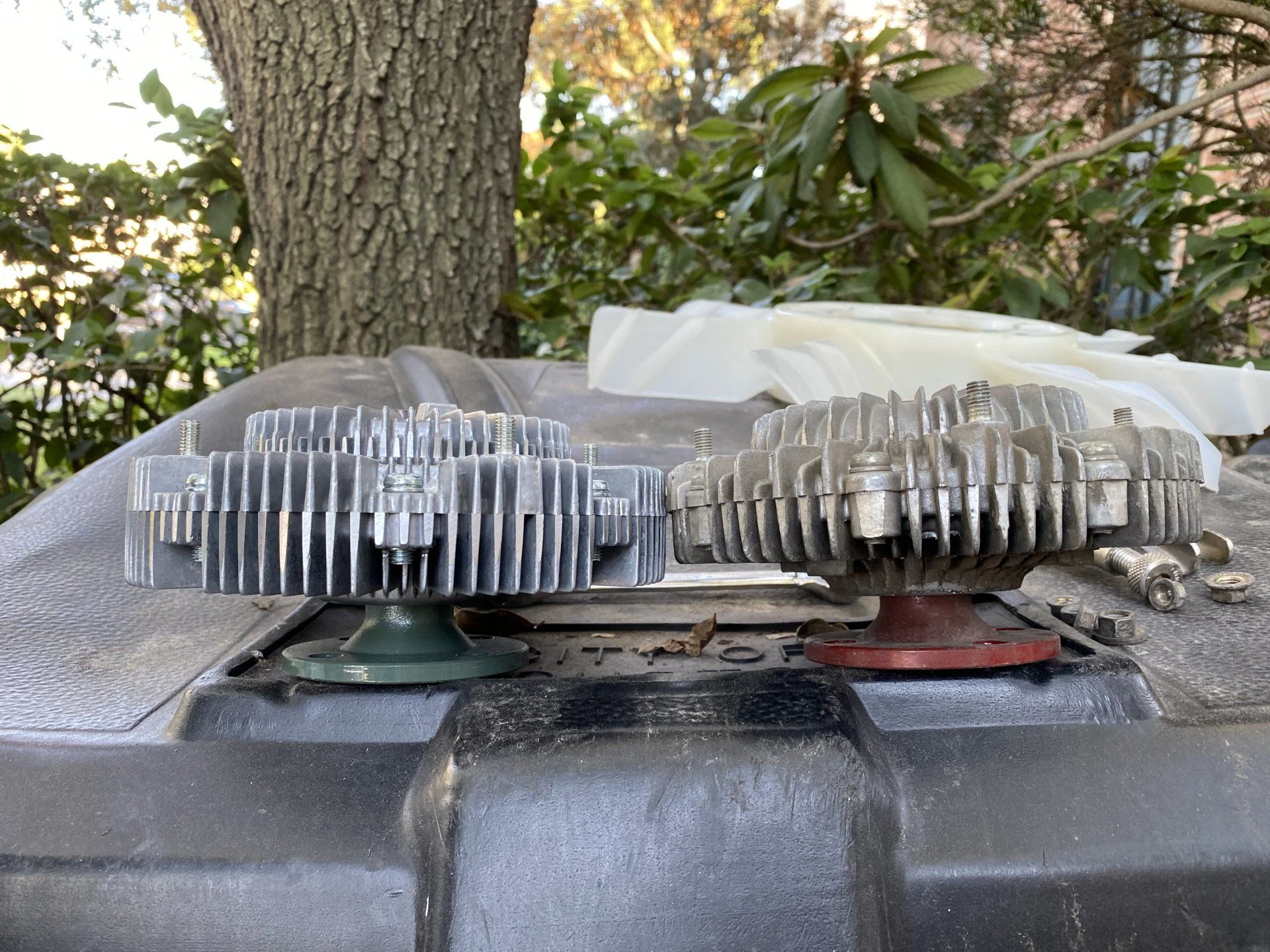

The initial review of the FJ80 3FE fan clutch is good. A lot heavier and way more air at idle.
It’s audibly louder and you can feel the air coming off the radiator like never before.
Temperatures here in Texas are mild right now, but I’m really hoping that the ac works a little better due to better heat exchange across the condenser and that the idle temps stay at the thermostat opening temp for longer.
I used the aisin fct049 for $121 from rock auto from a 91 FJ80

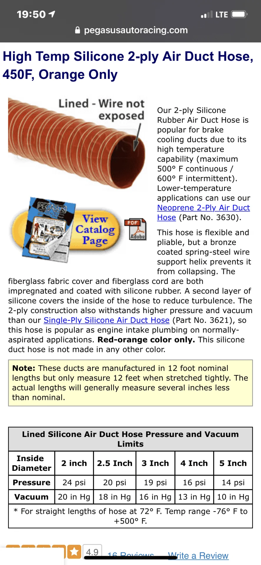

Hopefully, that fan clutch doesn't offset all your H.P. gains from the red intake hose.
Surprised you went with heater hose. I dig the options for silicone with the 45* bend. Plus it is far more rigid.
Heater hose? It’s actually just brake duct hose from a Racecar. A lot of cars used it as the duct work to the low pressure side of the turbo since it can handle vacuum and not collapse.
Complete overkill but for me it’s always function over form.
yea it’s also heater hose on 911s, haha. I ran it on mine. Just curious since it’s rather loose ball something more rigid and...attractive :)
This makes sense! I was watching hoonigan last night where Vinny Antara did the exhaust on his 911 and they mentioned all that...
I’ve had a huge problem with anything rubber cracking and falling apart in the engine bay of this truck. The heat must be too much. I crack the rubber vacuum nipples in about 6 to 8 months. I’m converting it all to high temp silicone.
that's just because of cheap rubber. That being said i have not been able to find vacuum caps that last longer then a year.
We need numbers!
My McMasterCarr silicone vacuum hose has been great at 6 years since the desmog.

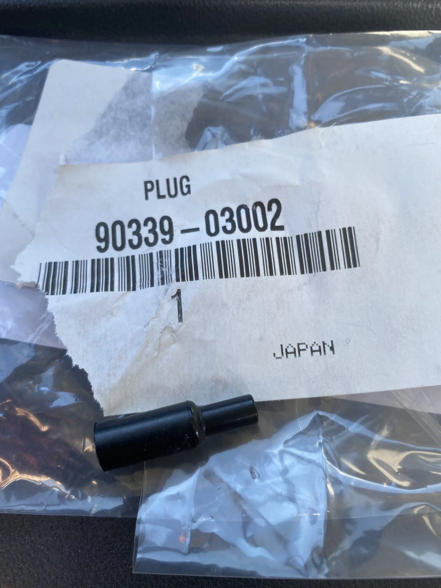

This is the vacuum port toyota notes for the carb base:
90339-03005
The following I haven't tried but are other options:
90339-03002 - 3mm
90339-07016 - This is either 5mm or 8mm...I forget.
Another fun one:
Single port gas filter: 90917-11022
Dual port gas filter: 90917-11023
I'll order a couple up tomorrow and tell you what is best, it's been a while and didn't manage to save the exact numbers I used.
