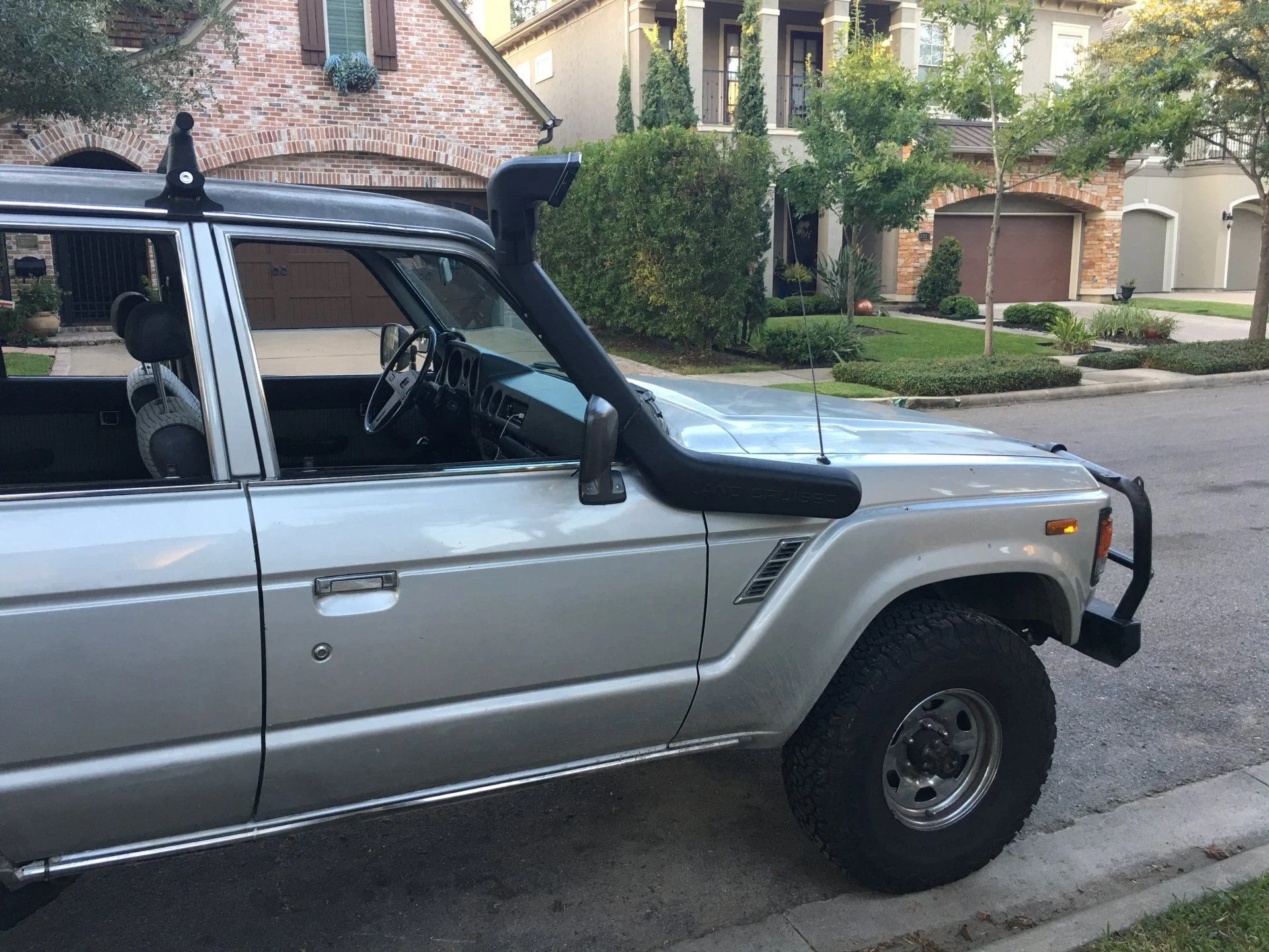

Also, I zip tied the snorkel to the mirror and I like the look of it. I'm very excited to install it in a few weeks.
None on my phone but it was super easy. Took about 15 mins and only needed three screws into the fender by the battery.
I ran the harness through the radiator cross member, into the fender and then out by the battery.
Don't forget to join the two jumpers together by the relays to activate your high beams.
Glad you snorkle says "Land Cruiser" my Malaysian snorkle was blank. Take care to visually verify the mounting position the supplied template comes with. Mine is even with the top of the fender (per the template) but looks like it should have been a little lower due to the cutout for the fender arch. Let me know if that makes sense or not.

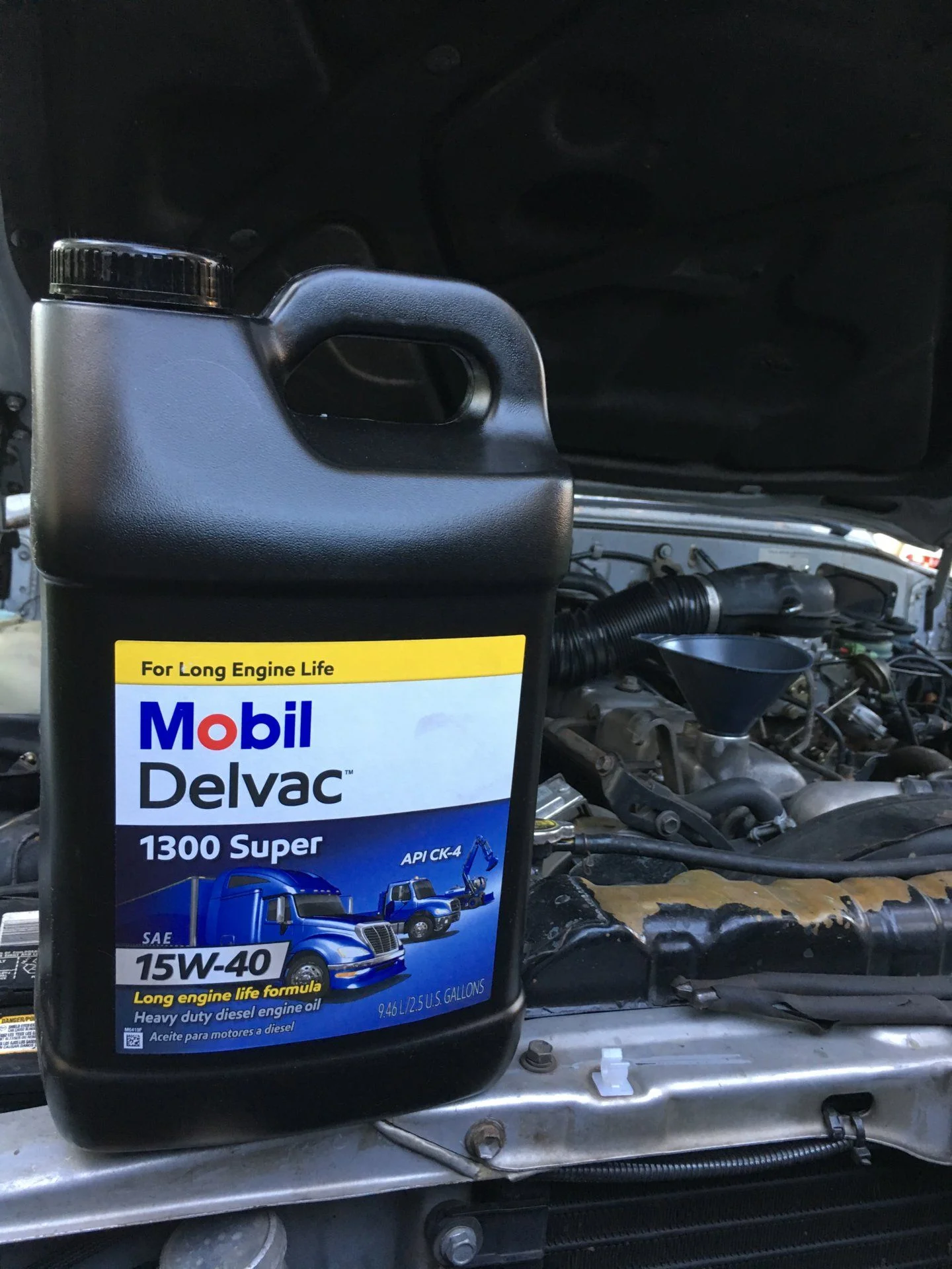

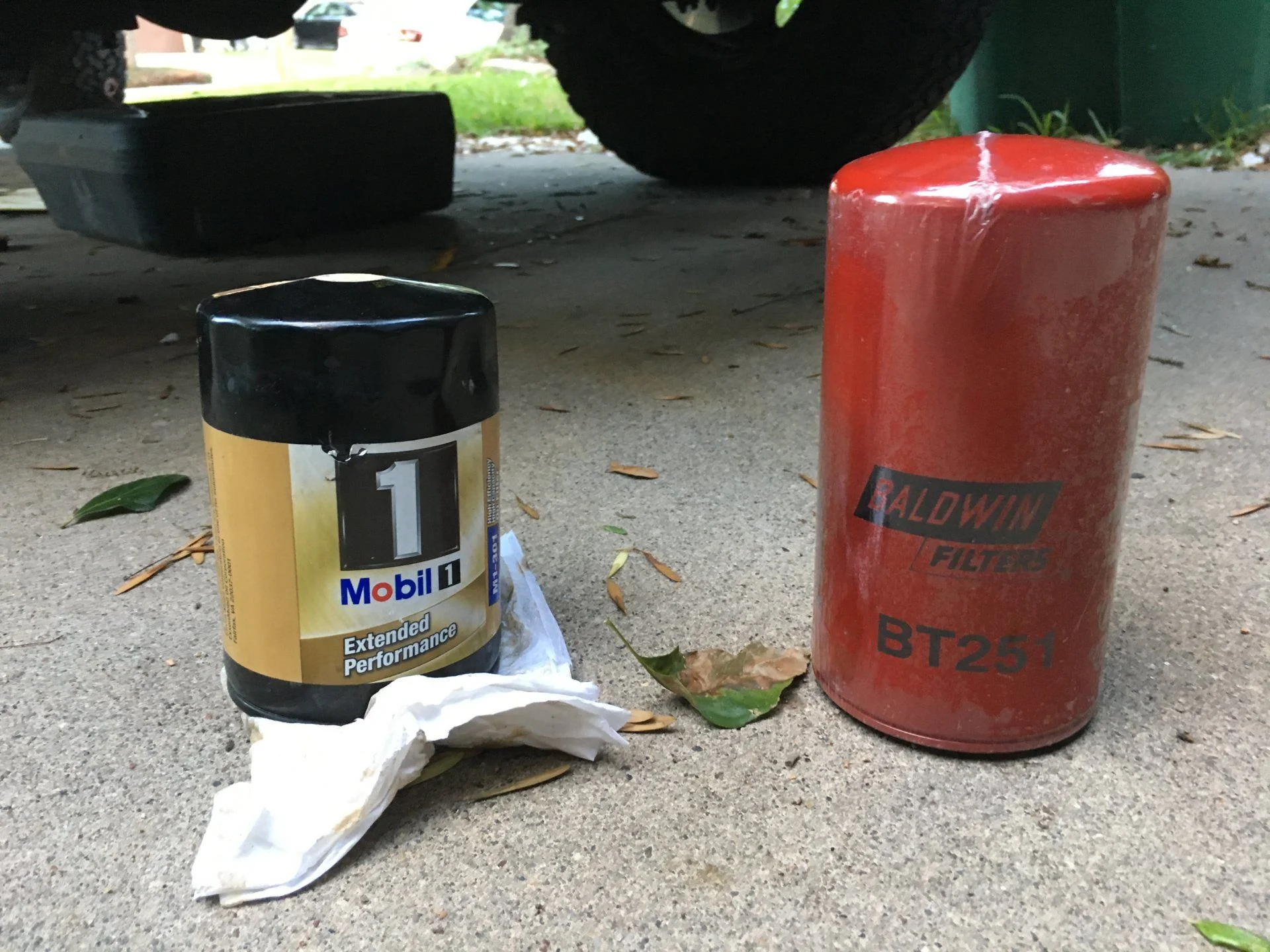

Changed the oil and added the even bigger filter. Delvac for $26 at Wally World and the big Baldwin filter. I’ve got a good line on the big oem yota filters so I’m ordering those to sell over here.

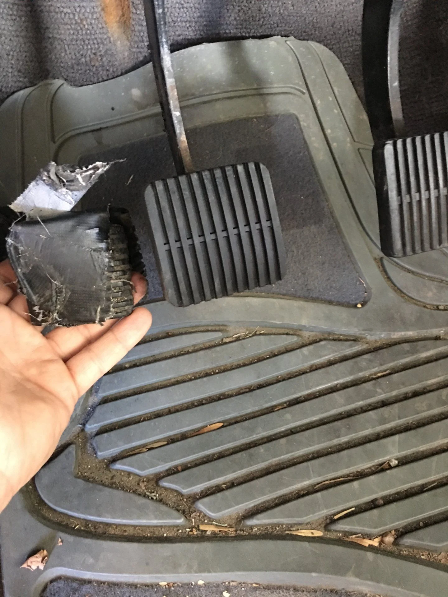

I did new pedal pads all around from cruiser corps, hood prop hardware and hood bumpers. The wiper covers are another little detail that will make it look slightly more complete.

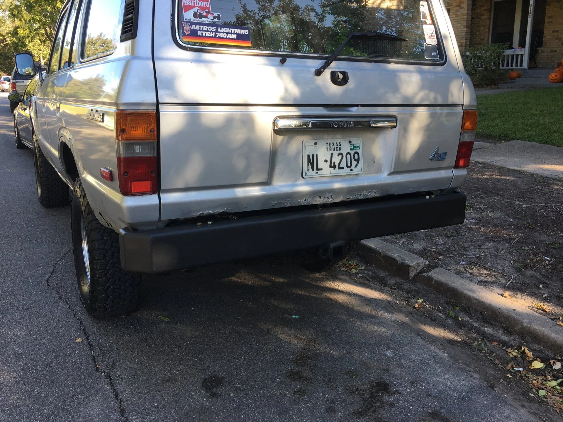

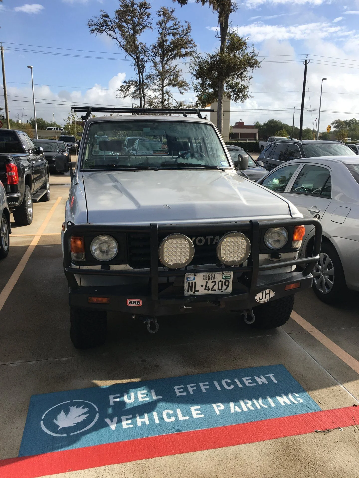

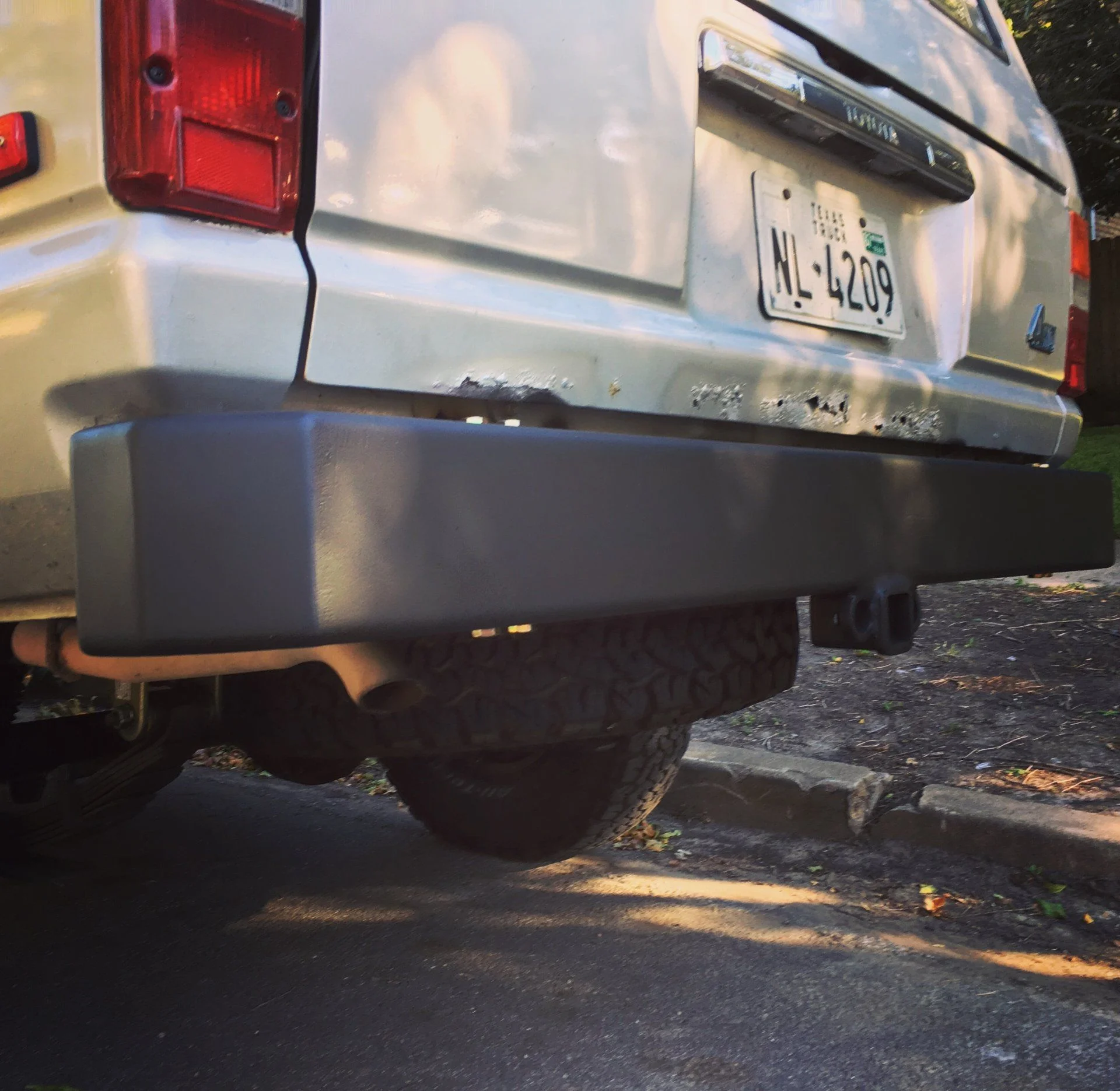

I finally put on a fabbed bumper that I’ve had sitting behind the shed for over a year.
Uses stock points and is about 5x as heavy as the stock bumper. I wouldn’t use that hitch for anything more than a recovery point but it’s nice to have. I’m thinking of bolting my hi-lift across the back of it.

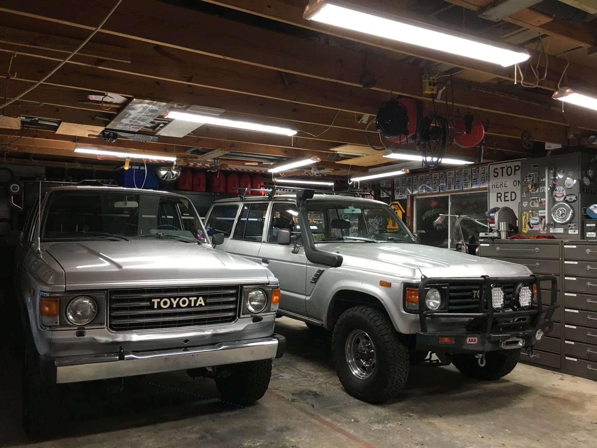

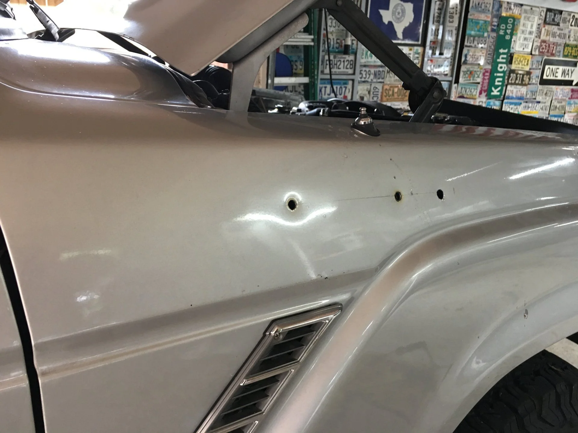

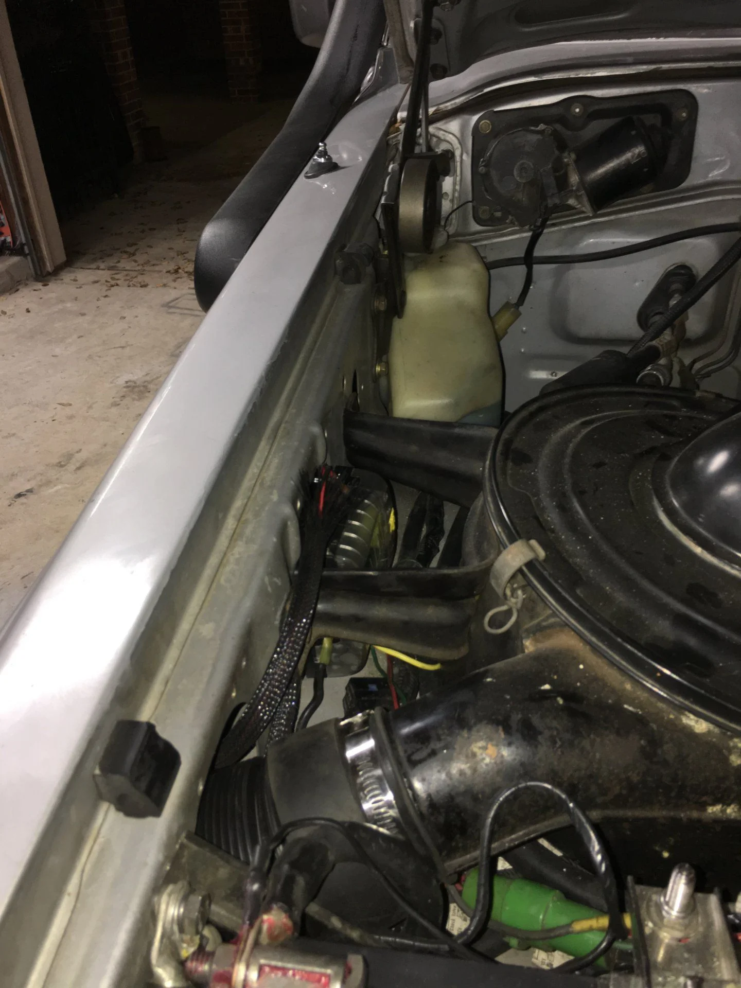

@FARMAN33 was kind enough to do all the hardwork and let me use his garage for the snorkel install.
It’s properly routed to the diesel air cleaner and for a knock off snorkel it fits very well.
His garage is what we all should strive for.

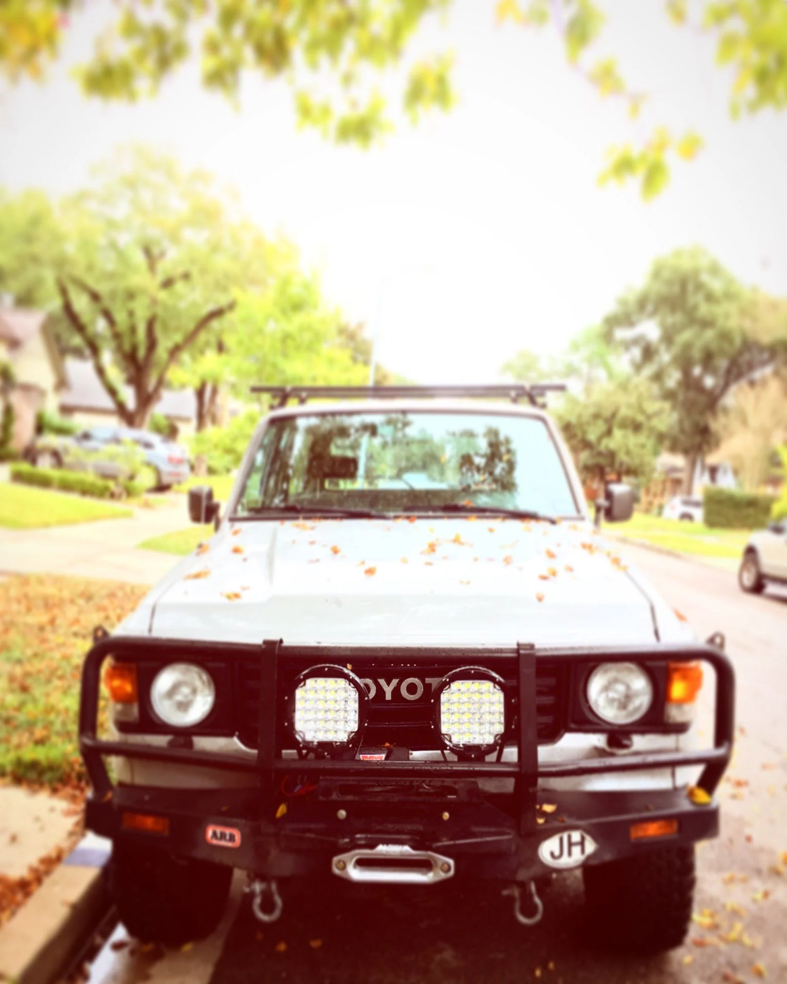

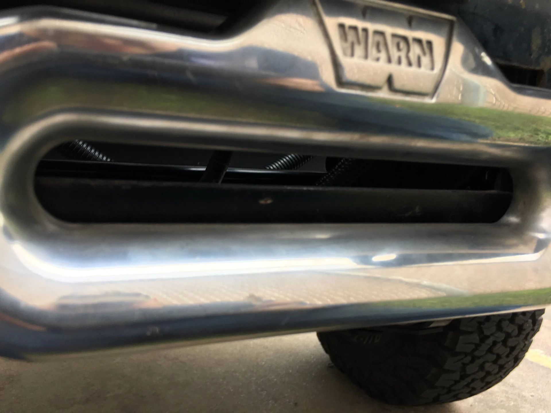

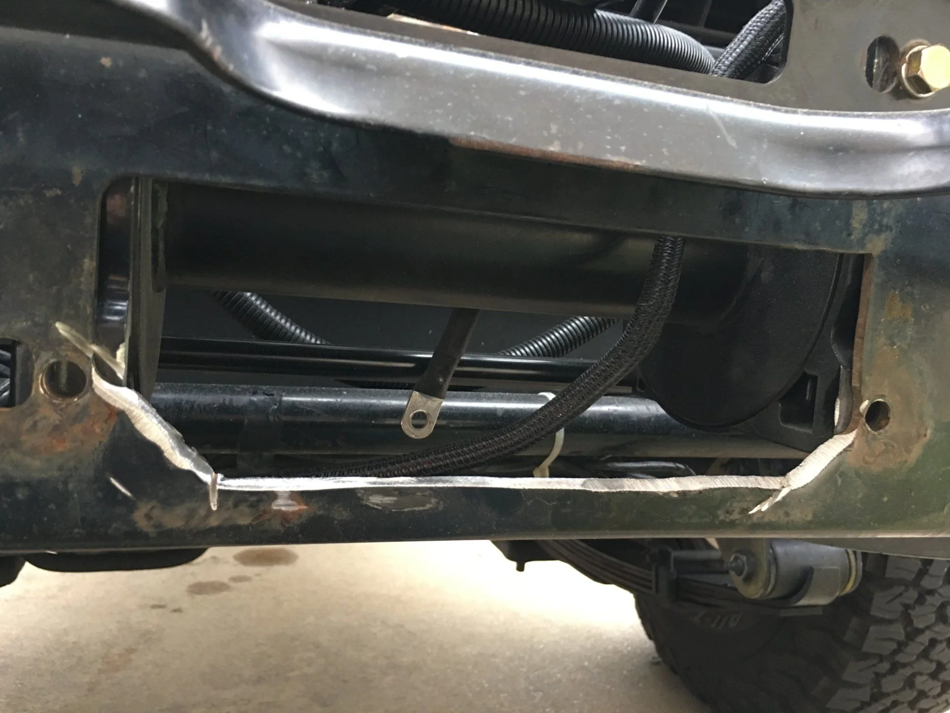

Also, I’m about half way done with the winch install. Ended up with a previous generation Warn VR10000S.
Some pics of how I had to cut the arb bumper for clearance on the hawse fairlead.

The true irony of the snorkel install is that we cut the only panel on the truck was rust free, and I’ve got no regrets.

The winch is on. I had a bad remote out of the box but warn was awesome to deal with.
