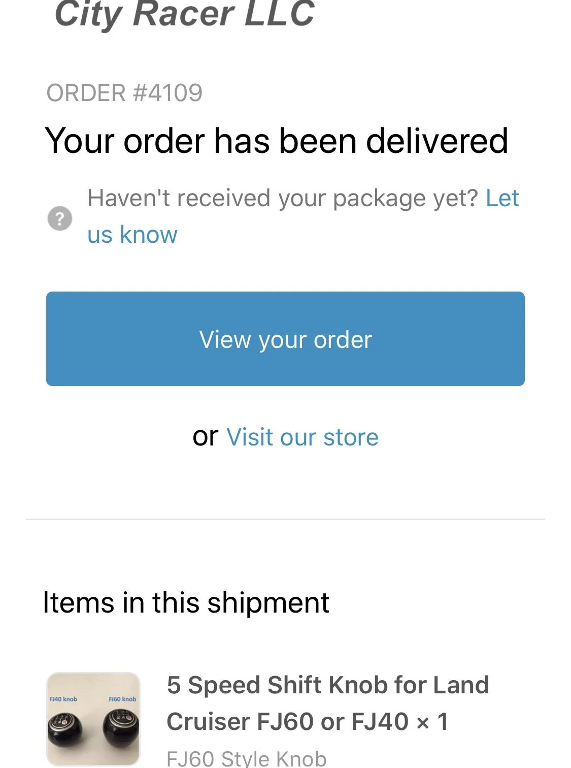

New H55F & Rebuilt split case from Georg @orangefj45
City Racer 5 speed shift knob
