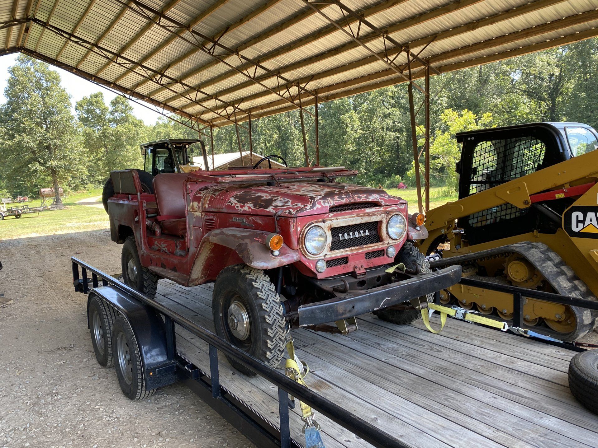

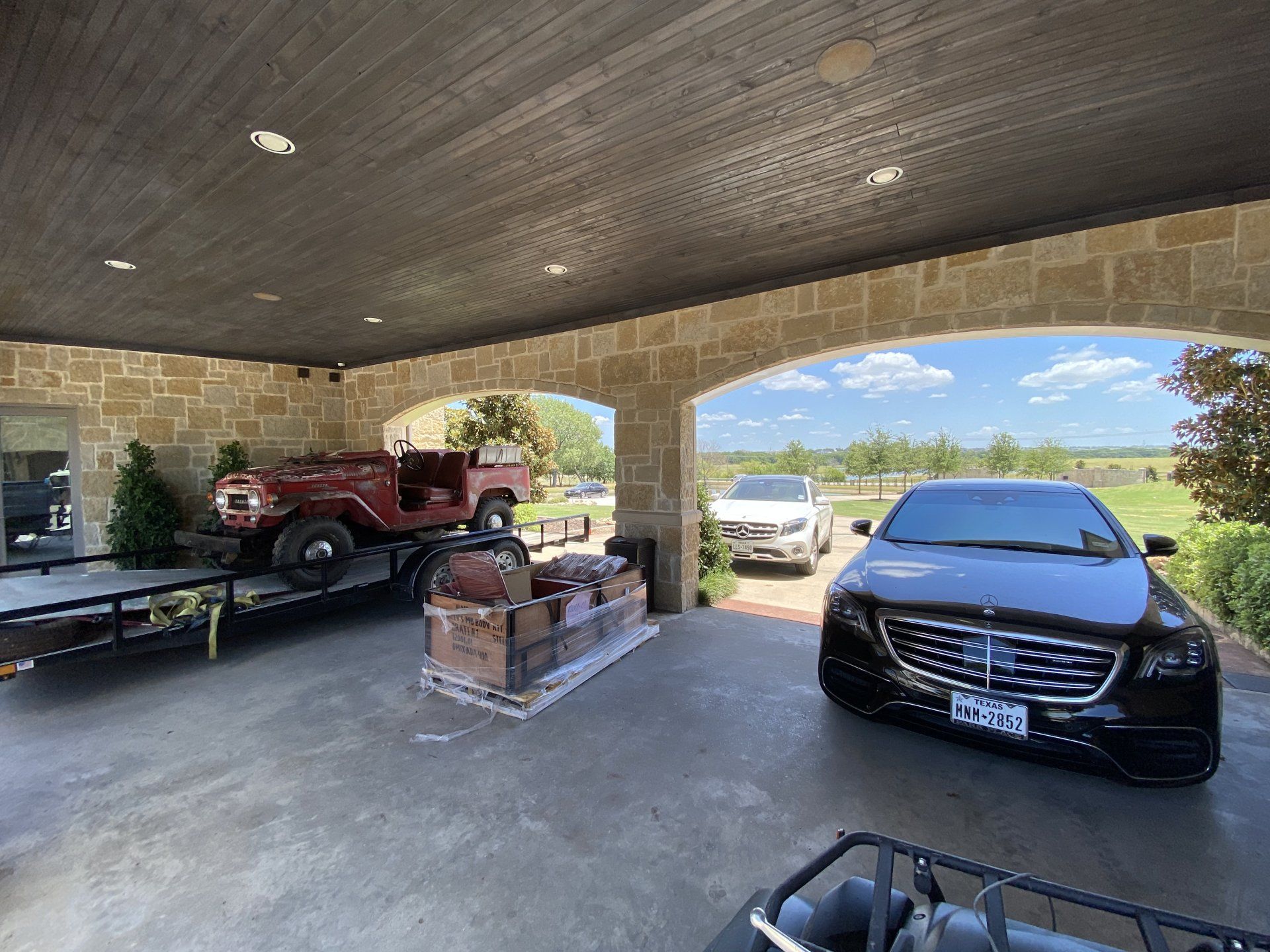

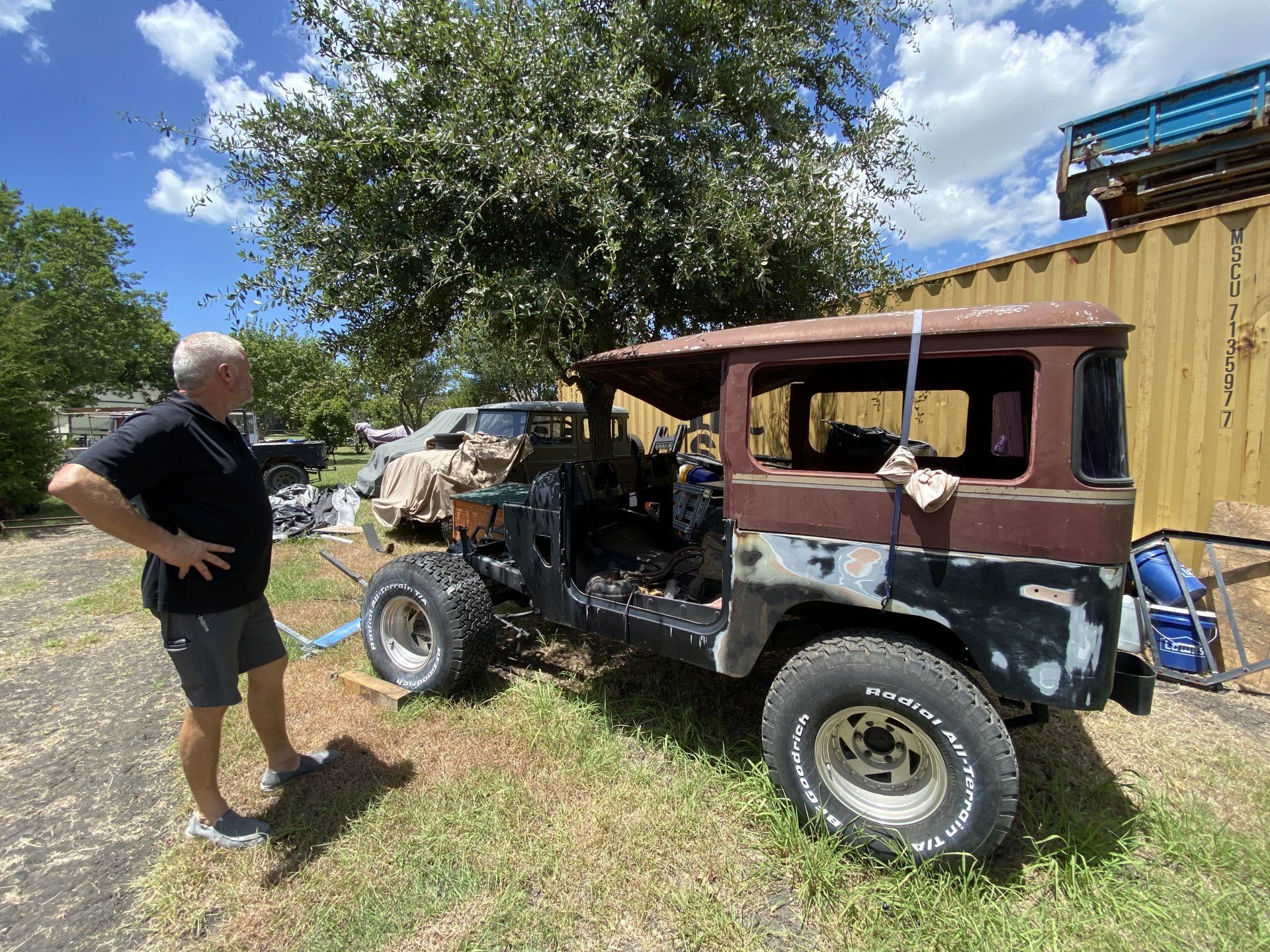

Made the trip over to the Dallas area. The new owner has quite a fondness for old 40s and 25’s so I know Texas Red found a great home
@whitey45 @Indygbd you know where it landed

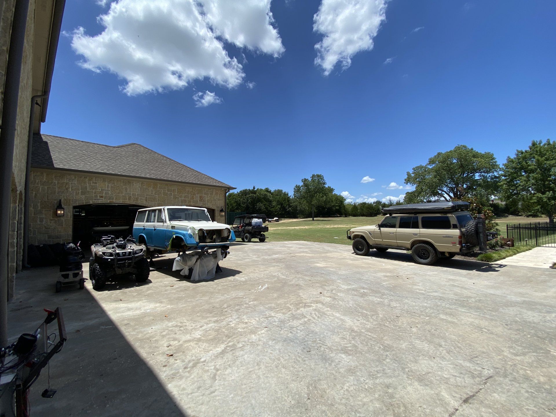

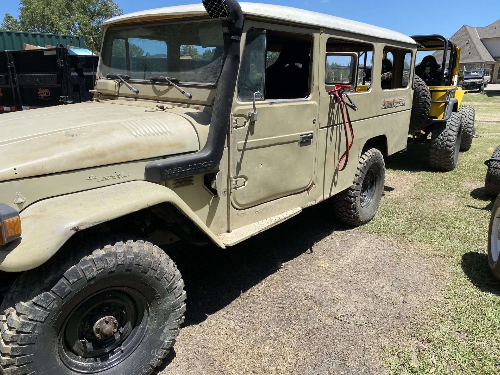

So @Robert shields was quite the host today. He let me touch all of his Cruisers and his many many many cool NOS Cruiser parts and tools.
He smoked some meats and even has his own beautiful Texas Red (head)
So yeah, and to top off the day @joekatana made the trip down to deliver some OEM gas cans for @jmlockwood ’s project in his killer cool 70 series
A few more random shots. As you can see, Texas Red has a fine new home. I’ll bug him for updates as he sorts out the dead engine and hopefully I can get him to keep us updated on this fine Texas 40

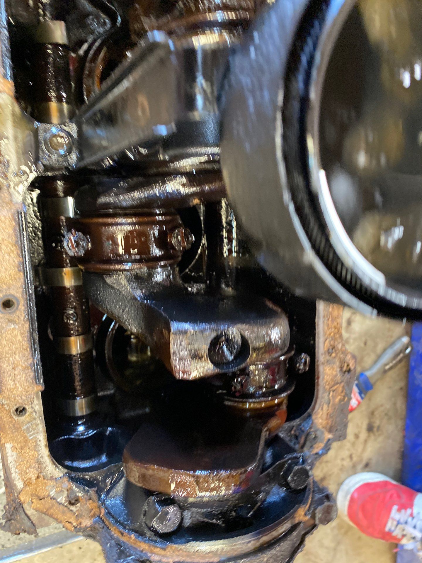

@Robert shields wasted no time jumping into this engine issue.
Remember the water that was in the air cleaner? Looks like that’s not the only place it
Was. The oil I drained out of the motor was black and not milky but there was water in the oil pan.
