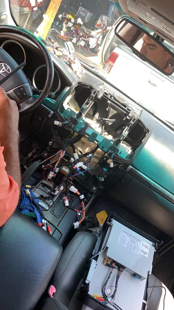

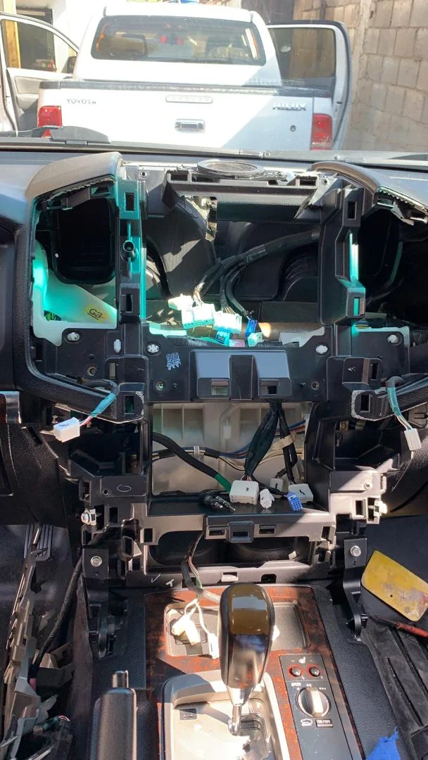

hello friend TLC,
How are you, please i need your help, I live in Venezuela, I do not know English, I use a translator, I apologize if you do not understand; buy a krando 16 "system to install in a Land Cruiser 200 year 2009, same as yours, North America version, I was all day trying and I could not know where each cable goes, krando I do not send me a specific installation manual, just a pdf file with photographs, I've been searching all the time for more information on YouTube and the internet and I found your forum, I apologize for daring to write to you, and then I contacted you through this means.
you could please, guide me in the installation of this system, in the photos of the forum, it is not detailed where each connector goes, I do not know if I should use all the cables that the equipment brings, there are connectors that can be connected in other ports same
after not being able to do the installation I decided to leave the original vehicle again, now. or the player works and neither does the air conditioning
I do not know what to do .. the seller of krando does not answer me, and does not give me adequate assistance
please TLC, help me identify where each wire connector goes, how can I make the audio work for me, the roof screen, the hazard light, the air conditioning.
I only managed to make the android turn on but nothing works, I need your help please
note: one must disassemble the components of the original equipment and the air conditioning to use them with the android?
If someone has the detailed installation manual, and you can help me please, I will be grateful

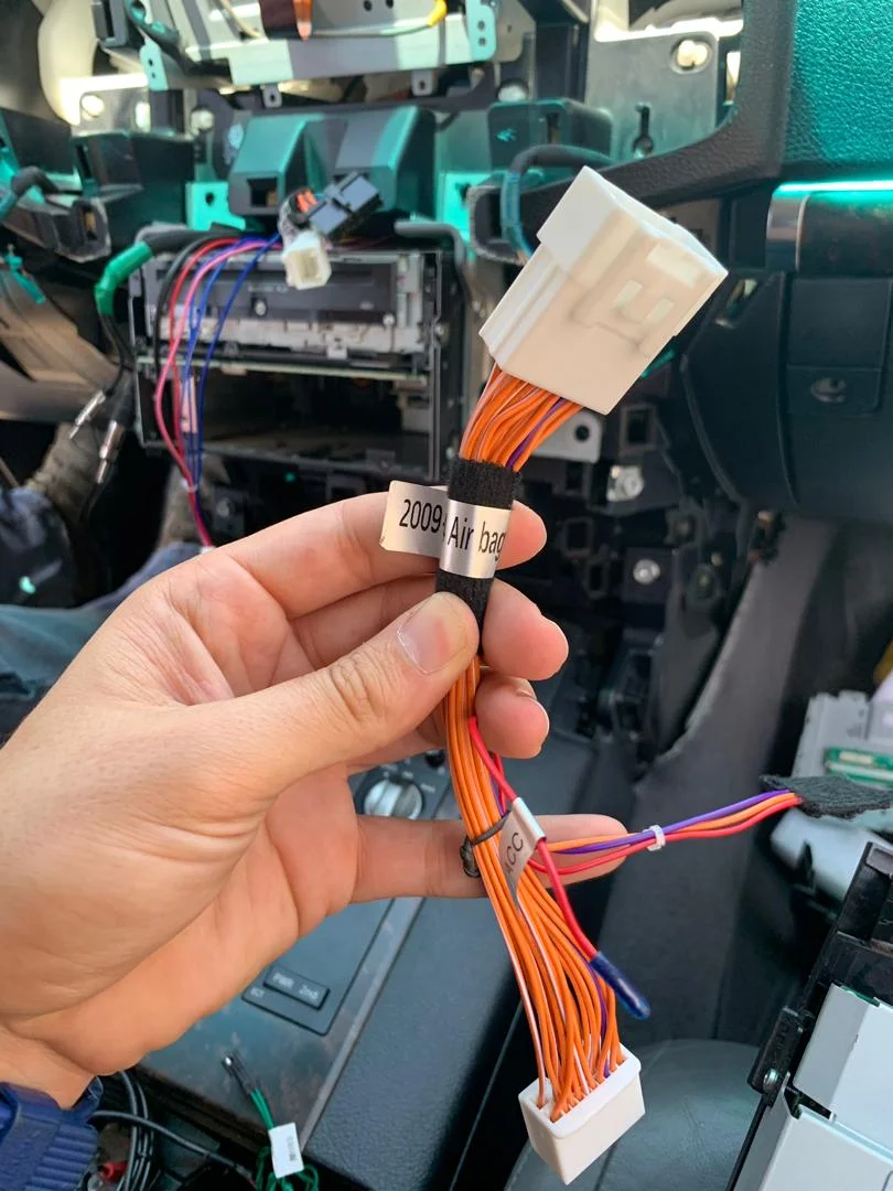

The install was relatively straightforward. I had an airbag light on for a week that I couldn't figure out and they sent me images of where to plug in the harness I hadn't plugged in. The Harness had a sticker on it that said 09-16 airbag extension. If you are hesitant, you need to have someone else install it. The harnesses mostly all make sense.
However some things like the antennae harness didn't work and I just plugged my antenna straight into the unit. Its' definitely not stock and has some quirks and shortcomings.

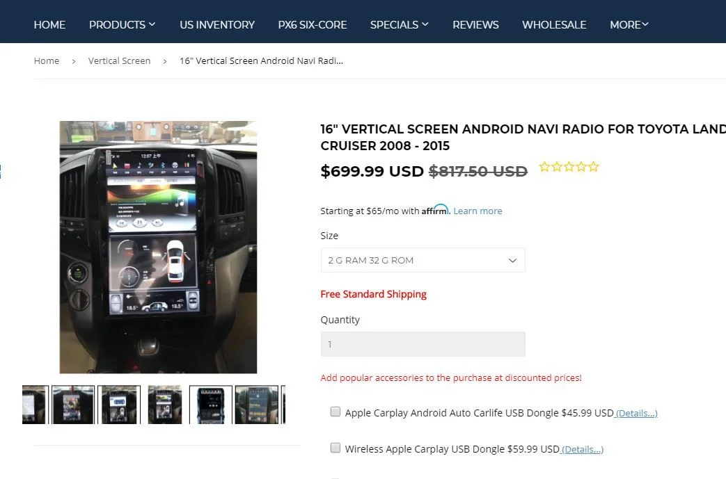

I started this thread a little over a year ago and it is finally time to update the thread with the install journey. Since I last posted my procrastination on purchasing a unit paid off. In late 2019 a fast boot version of the Tesla style radio sprung up for the 2008-2015 Land Cruiser. I was so excited to see that an updated unit had come out because I had long speculated that because the 200 series had not gone through a makeover in over a decade there were to many vehicles out there for the makers of these radios not to capitalize on such an iconic brand. I was also excited to see that Phoenix Radio's was offering the stereo because they have gained the reputation as providing the best customer service - in which I mean that customer service actually exits at Phoenix. By most reports other websites that offer the same products are a gamble as to whether you will receive a unit at all much less help if you order the incorrect one. Case in point the above post by "ProLandCruiser" who ordered from Aliexpress. Now as quickly as this updated unit appeared it again disappeared from their website leaving me to believe that I had imagined viewing the unit on there website after anticipation for so long. I contacted Phoenix and low and behold about a week later I got a response with a link to the new updated unit and sure enough they had updated the Toyota section of there website with several other radios. I was all in at this point and ordered the stereo. Her is a the exact unit that I ordered on the Phonenix website.

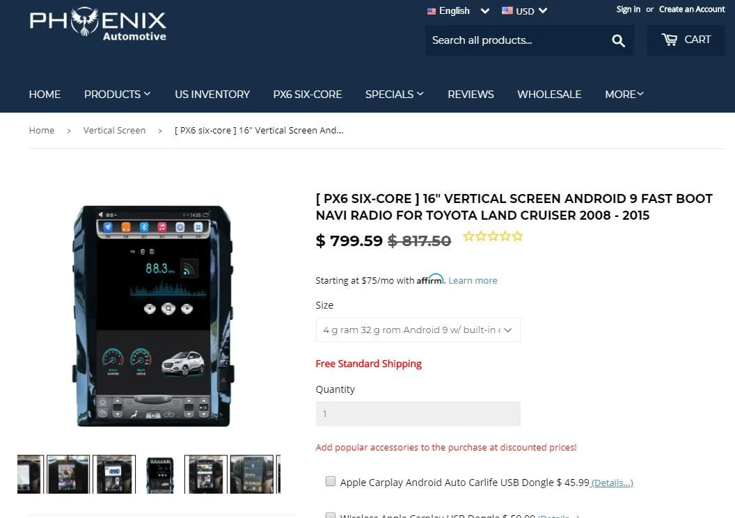

PHOENIX 16" ANDROID 9.0 FAST BOOT STEREO
full
I really want to caution everyone because there are 3 other versions of this stereo that are being offered on the Phoenix Website so you need to pay attention to what you are ordering. Now Phoenix requires you to send them a picture of your dash to verify you are getting the correct unit which no other site does to my knowledge. Here are the other units that are sold on there website for the 2008-2015 Land Cruiser.
This unit is for Land Cruisers which do not have Navigation. Now keep in mind that the fact that the particular Land Cruiser that this is for having Navigation is actually not the important thing. What is important is that these Land Cruisers had separate climate controls from the infotainment and climate control was NOT integrated into the system. This unit has the most OEM look but WILL NOT work correctly in the majority of US Land Cruisers because from what I have researched the majority have Navigation in this country and thus have integrated climate controls in the infotainment. This is the unit for the majority of us to stay away from especially if you are ordering from a site that is just going to send you what is in your cart. Upon inserting the link in this thread I noticed that this unit has been upgraded to Android 7.1 from its original offering of Android 4.4. You can see from the image the stereo has recessed information like time and temp on the top of the unit just like the stock infotainment. This unit is noticeably less expensive having a smaller screen at 12.1".

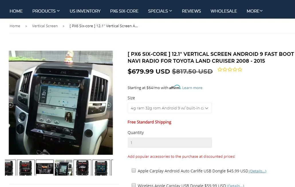

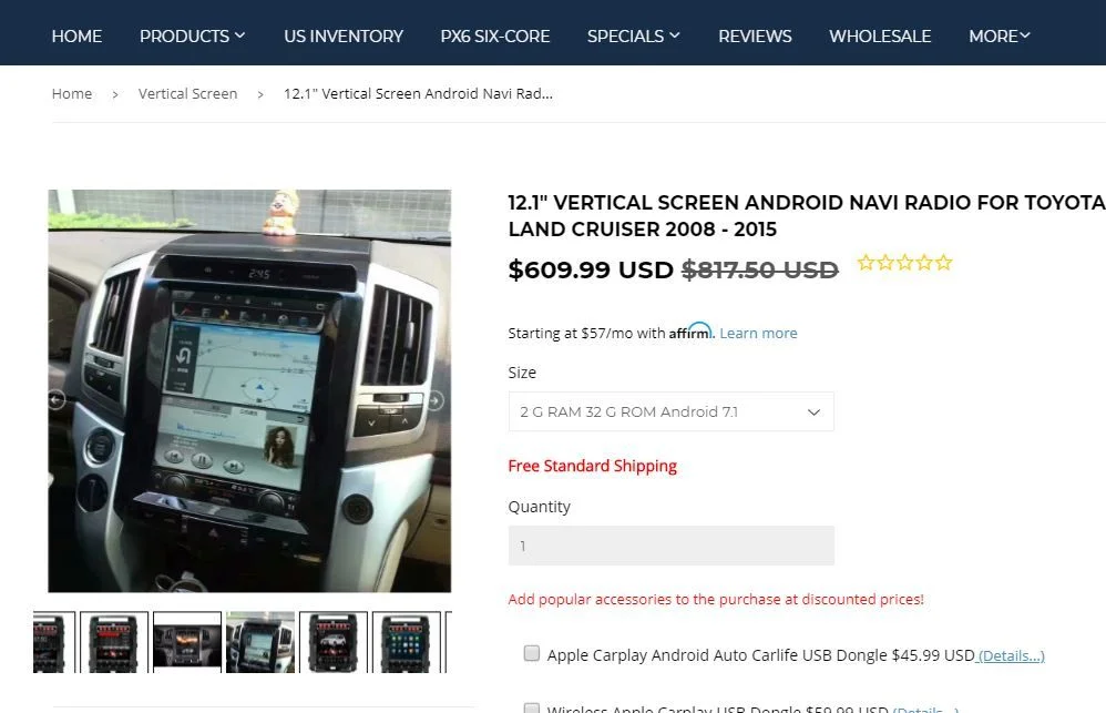

PHOENIX 12.1" ANDROID 7.1 VERTICAL SCREEN STEREO
full
As of the time of writing this thread I was struck by another stereo that I had not noticed for the 200 series. I new that the update to there site created a third page of units for Toyota vehicles but missed this one for the Land Cruiser. It appears that the unit meant for Cruisers with separate climate controls that I just went over has had an upgrade of itself adding to the confusion. The unit now is offered in a fast boot version running Android 9.0 and sporting the upgraded PX6 SIX CORE processor. At $70 more if you needed this unit I don't know why you wouldn't spend the extra dough. Here is the link and image from Phoenix website.
PHOENIX {PX6} 12.1 ANDROID 9.0 VERTICAL SCREEN FAST BOOT STEREO
full
Now the next unit that they offer is an option and was the most recent version up until late last year as I discussed in the opening. This unit has been updated to Android 7.1 as had the older unit but sports half the RAM of the current model at 2G. If you need to save some money this would be the way to go because you will be paying a "C" note less. (Some will have to refresh my memory as to why a $100 is called a C note?) Here is a link to the Stereo along with a screen shot from their website.
PHOENIX 16" VERTICAL SCREEN ANDROID STEREO
full
So you can see now why customer service is so important when you are purchasing these units. We are up to a total of 4 different units that are available from various websites and most are far far worse than ordering from Phoenix. Another quick note is avoid listings on there site that are for the Land Cruiser Prado - the listings for these units look almost exactly like those for the plain Land Cruiser. At one point I was considering ordering from Rhino Radio's out of Germany but thought better of it and have been rewarded for my patience.
