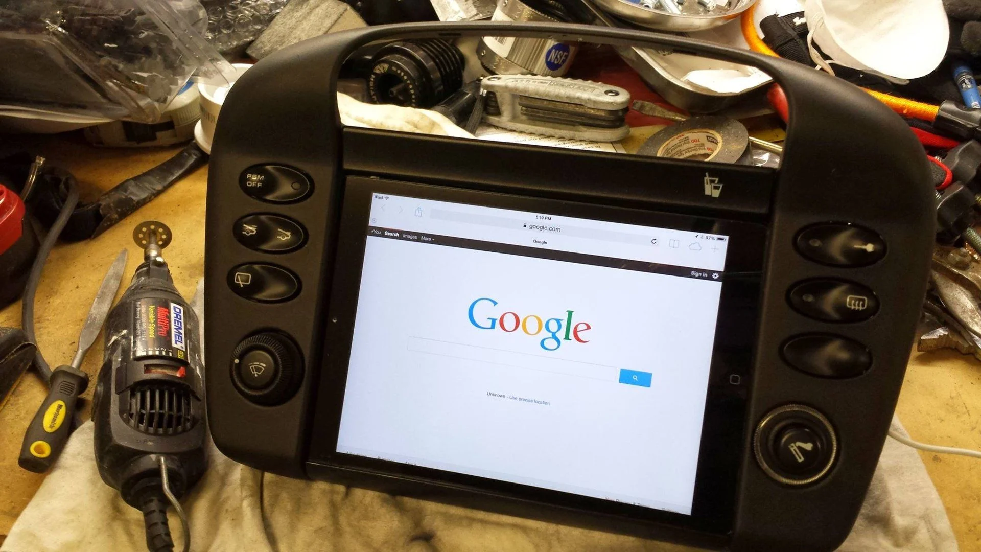

So I exhausted all simple ways to potentially add CarPlay to my 2016 so one day I realized that my iPad mini would be even better than CarPlay and thanks to the smart case and the metal speaker grill this became and ez choice for me... [I will take better pictures later]
I’m using iPad mini 4 Cellular for 2 reasons
Mini 4 allows for iPad Pro like split screen
Cellular has proper apple maps behavior
Set Screen off through Display Settings - Climate audio etc comes up upon hitting hardware buttons.
Flip iPad up to back up or utilize OEM system
I tried to make it look as stock as possible with a simple logo
And black background for the Home Screen for clean OEM/Carplay look

Just flip it up and it lays on top (I forgot to upload the other pictures)
Basically I have the Head Unit Screen Off through display options, when I need to reverse or control something I just flip up the iPad. Pressing the Climate, Audio or any hardware button brings the screen back up...

How do you make the iPad stick and not bounce around after you flip it down?
Not sure what he used, but I used Velcro when I used to flip mine. The screen surround is angle somewhat, so there was no flipping around.
Comparatively, my more recent magnetic solution is absolutely motion-free...yet easily removable. I got tired of flipping the screen to engage general functions still controlled by the main screen...and simultaneously noticed how rare my need for DVD/CD controls mattered.
It just doesn’t, the magnet of the smart case holds it in place thanks to the metal speaker grill. I also added a strip of magnetic tape to the middle of the case to add additional strength but that is really not needed, just did it for overkill. The angle of the Dash on my 2016 and the weight of the iPad is enough to stay right in place

The Apple mini as a car computer is just awesome. I have one mounted in my 996 Turbo that I use daily. Of course, it never had a screen/NAV from its vintage. The way it can be integrated is just awesome. One would never know it's even a tablet unless the look closely.
I have mine jail broken. It turns on by itself when it detects power, and starts playing Spotify to my headset. Detects power off, and goes to sleep. All the power and speed, and updates, of modern portables, with the usability and integration of OEM.
