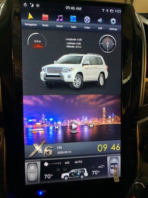

I received the adapter box for the 4 cameras I have
The existing setup has two connectors that are the same, one blue and one white. You would think the Blue one is the correct one, but it is the white one
Now all 4 cameras work. The rear camera comes on automatically in reverse
I did not realize that the icons at the top scroll and there are more if you swipe left or right. You have to scroll those across the top to the Console app and then use the setting icon. Then change the year to 2016. That enables the cameras to work
The first time it boots after install it takes 30-45 seconds. After that it goes into standby when you turn off the truck and turns on quickly
Probably some settings still to play with, but I am very happy and pleased
The only thing that appears not work is the rear DVD player and I knew that going in. There are Video and auxiliary inputs on the back to connect a rear entertainment setup, but I have no desire for one.

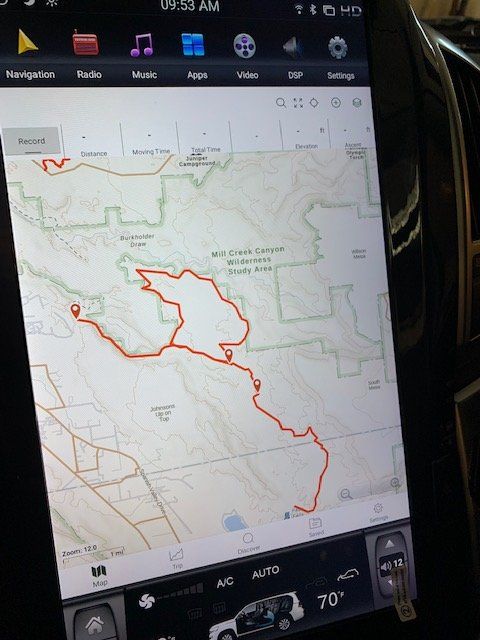

Internet is great at home. I havent set up my phone as a hot spot or gotten a MIFI device. If you download offload maps for Google Maps the navigation works fine and you can press the mic button on the google map screen to give it a destination
Works like a google tablet with all the apps I have loaded so far. Giai works fine although havent goon offroad with this COVID-19 mess.
GPS works great, and i installed the puck it comes with under the dash top speaker grill. Fits fine with no adjustments required
