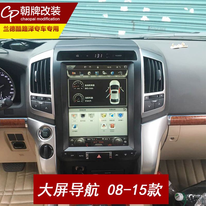

Has anyone tried the aftermarket "tesla style" head units? I've seen reports of people installing these in other Toyotas/Lexuses with good results, but curious if anyone has tried on a 200.

I am planning to do a post on my install. This is the very latest hu for Toyota Land Cruisers 2008 - 2018 (new design), I did not have any issues with the install (other than typical no instructions from stuff from china). All controls work, only Eflasher, seatbelt light, security light, hard controls left (see on right side of unit). Price was $630/install was a little over 1 hour.

How is the phone BT audio? My '08 has been really good in that department, compared to aftermarket I've had in the past, and I'd sure hate to lose that. It looks like a really good fit from the pic - would you agree with that?
