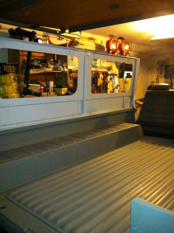

Before and after
That is an improvement. Hope the window fits back in.
Where to store the panel
It's starting to look like a troopy again. Might as well put the panel where it's eventually going as opposed to taking it back to the storage unit. It'll be painted off the truck, so it's only resting there temporarily in it's natural spot.

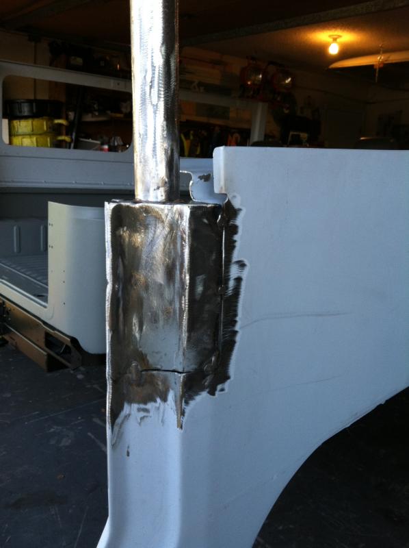

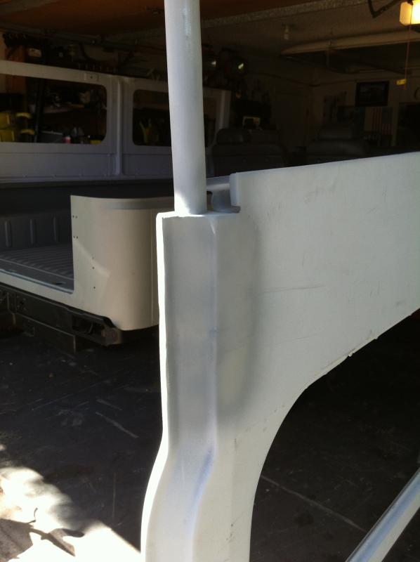

Another side panel connecting post replacement
I'm getting there thanks to those rusted out spare panels I bought. I lucked out in that some of my nasty areas were in better shape on the spare panels. I didn't think I could use much of the metal but it turns out I used quite a bit. $100 well spent!
I've got it tacked it and after I hammer a few spots, I'll weld it up.
Thanks guys, I'll try to get up to the Turkey Trot in Ocala. It sounds fun!
A little filler and a good paint job and this should look OK.

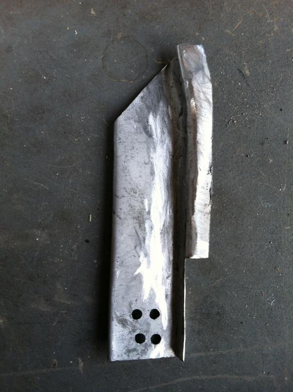

I made a replacement piece for the panel. It took a couple of hours, but was fun. I guess it's part of a flange of sorts where the top of the side section meets the bottom. The other side had the same rust issue and I fixed it rather crudely. I may go back and do it this way. These stupid little things that no one will probably see, tend to end up nagging at me. So I might as well go back and fix it while I have it apart.
