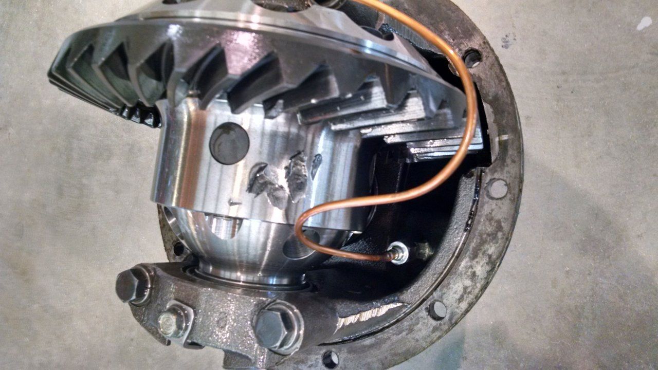

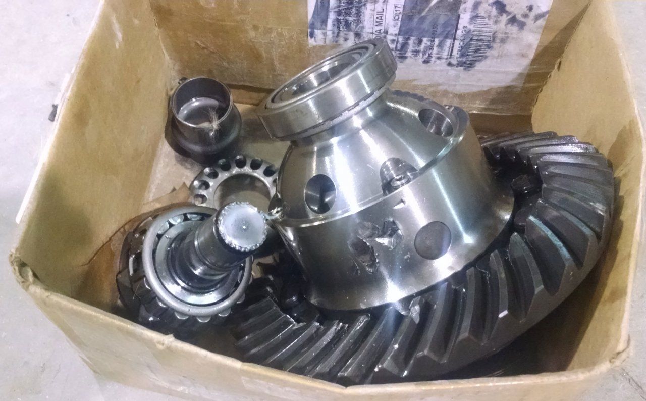

Well I have an update, first the good news,
I was able to adjust the windshield squirter to hit exactly were I wanted..
Now the bad news, I was out for a test drive and apparently the new gears are not as impressed with the boost as I was..
