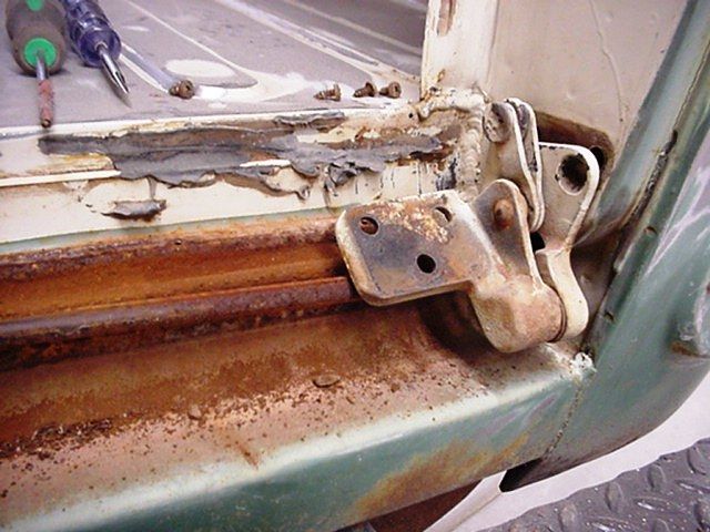

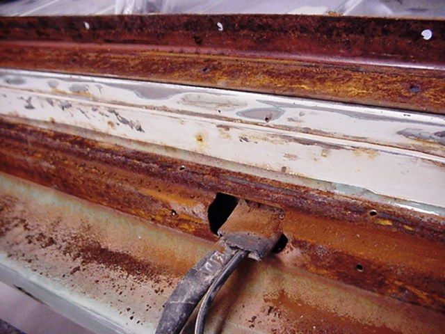

True to my need to take pictures of everything, I took a few pictures so future searchers can know what these mechanisms look like!
