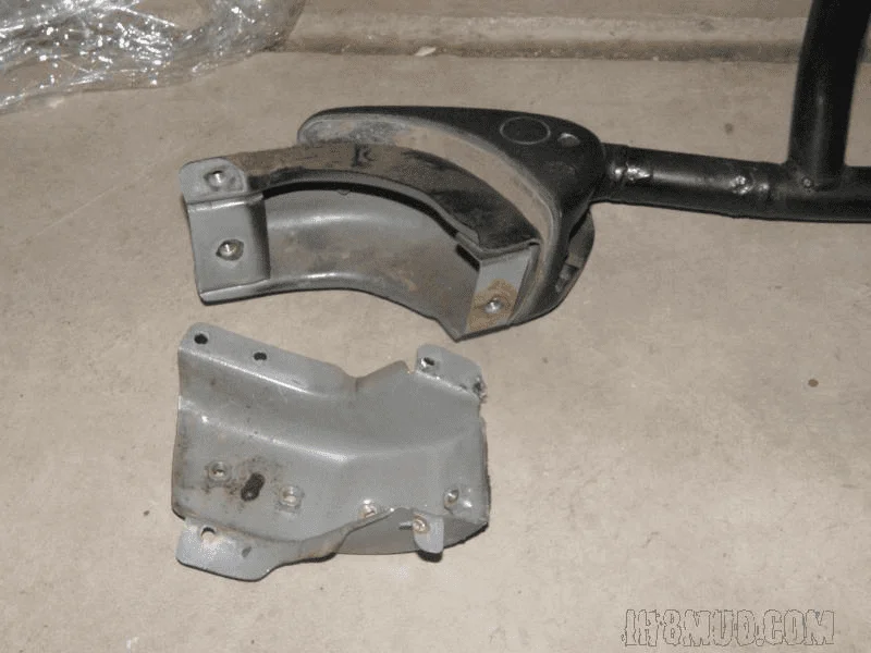

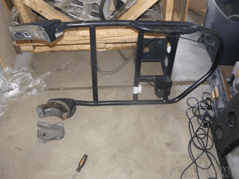

Below you'll find 2 photos of the OEM tire carrier along with the 2, D pillar internal mounting brackets. Not only do you need the 2, D pillar brackets to install this, but the tail gate has a latch plate that needs to be installed too. You use to be able to buy this in the USA from Cruiser Parts. But by the time you get done paying for it, and it's shipping cost, you're getting right close to a 1000 bucks, and then you still need to install it. There is a thread here on Mud by a Mud member who bought, and installed one, along with the internal brackets that had lots of photos, but when i searched for it i couldn't find it.

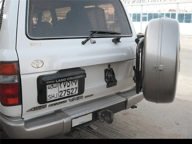

In the photo below you can see the latch plate mounted to the lower tail gate that locks the swing out tire carries in place when in the closed position, along with the overseas offset lic. plate bracket. Please take note of the upper swing out tire carrier anti rattle bracket mounted on the upper tail gate that you'll want to install too.

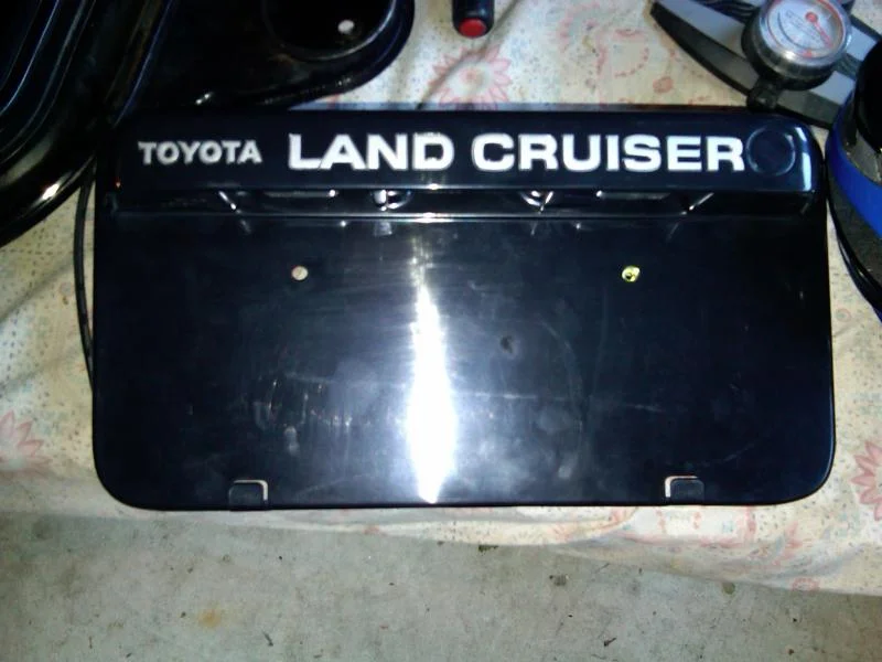

Can you provide any info on the license plate bracket?
Below you'll find a link that has all the info and photos you'll ever want. But just a word of warning if you decide you want to install one of these. Just make sure you measure twice before you drill your lower tail gate, because you only get one chance to get it right.
I considered this route. In the end, I just used some aluminum scrap and drilled it out as an adapter. I used some rubber stripping with an adhesive side to protect the back side from the extra through bolt on the left. Total cost was about $2 and is fully reversible:
