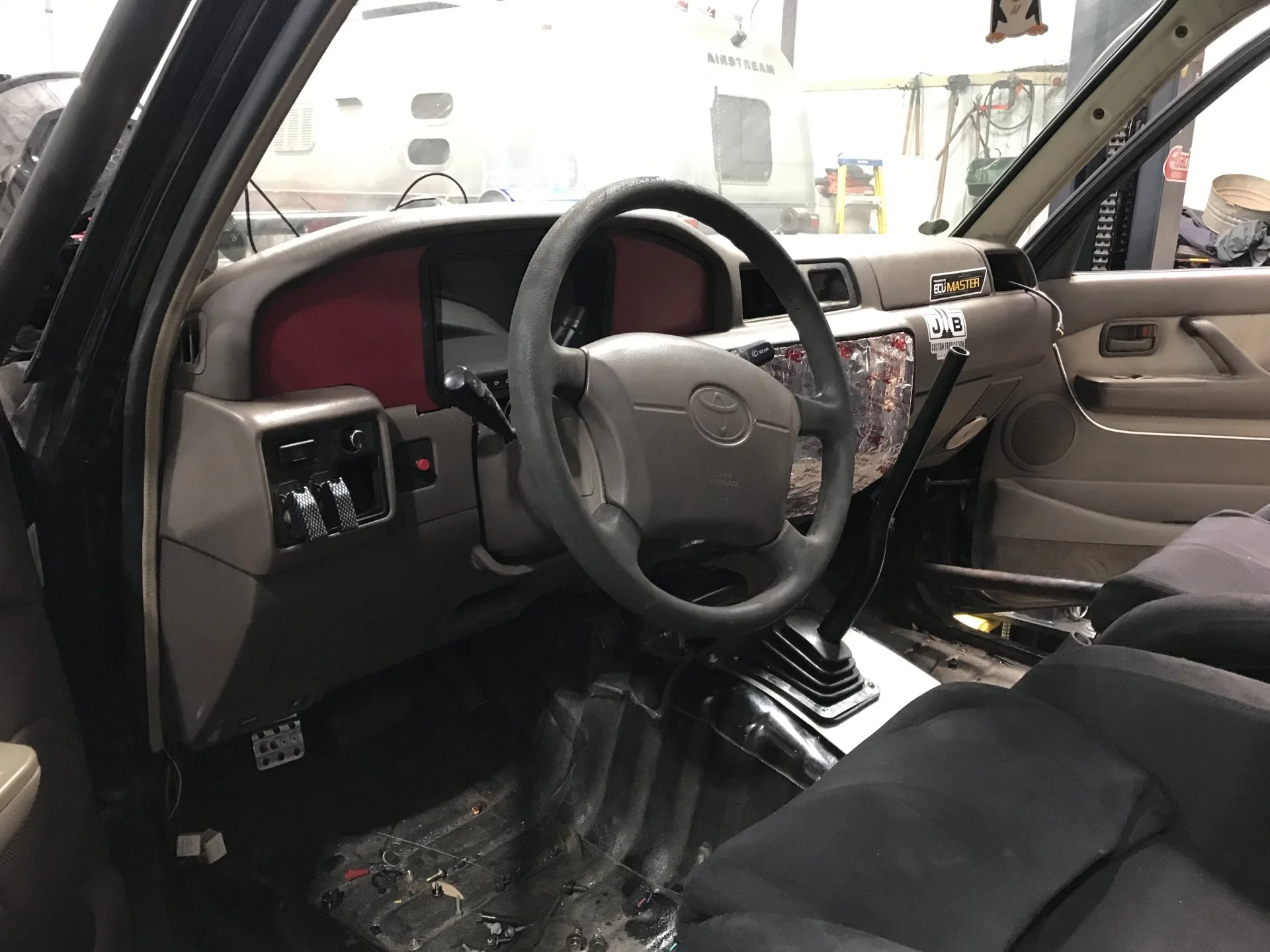

Haven’t driven it yet but it starts and runs better than before. I will be finishing the gauge cluster before I take it for a rip around the shop to identify any potential problems.
Can confirm this thing drives and it is absolutely terrifying in the best way possible

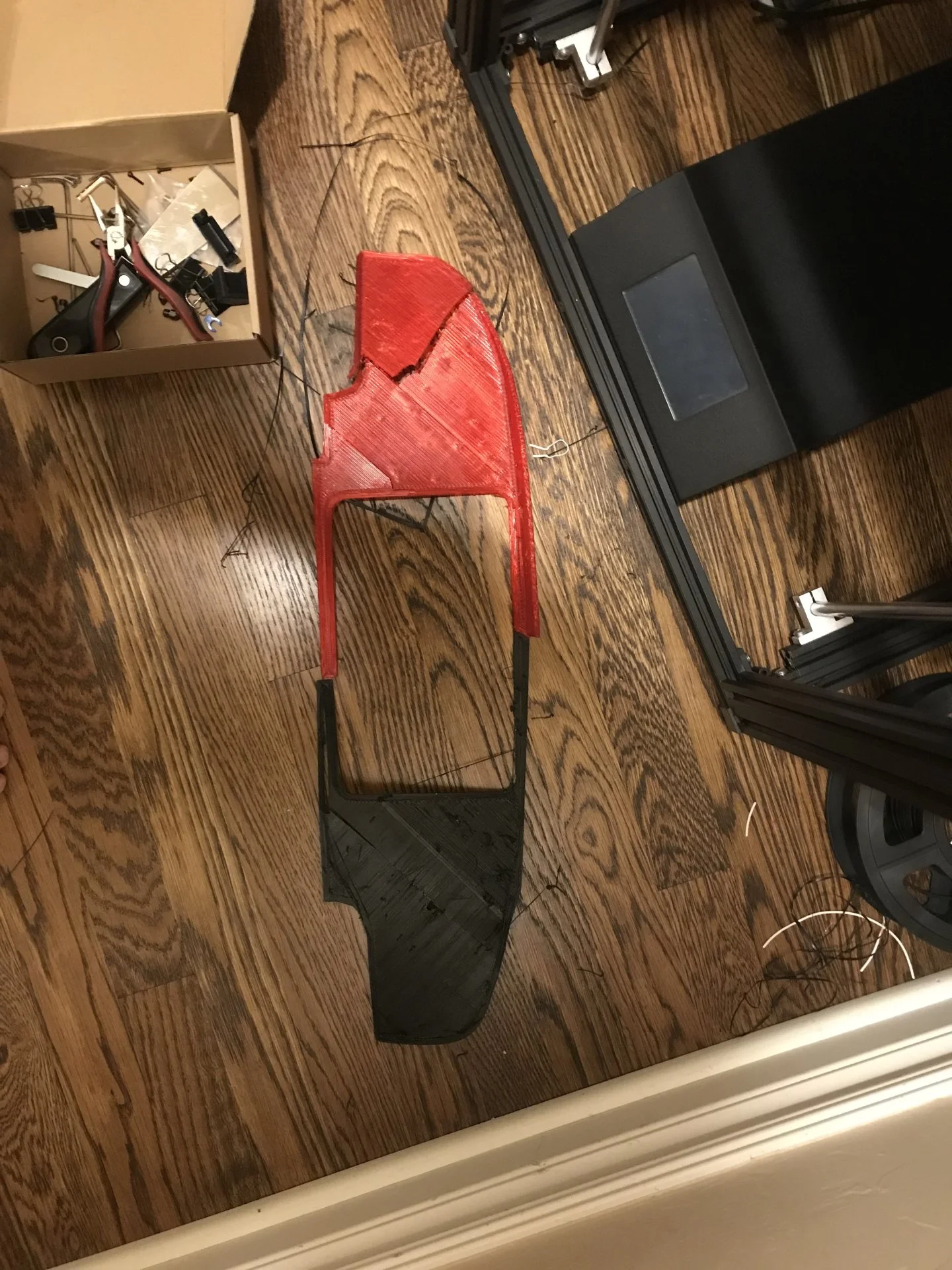

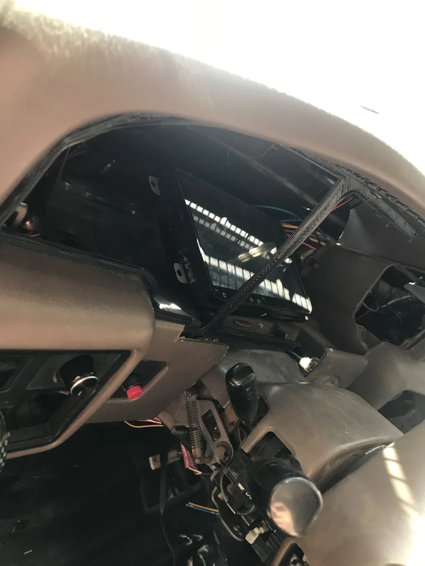

Back to making dashparts when I’m not at the shop, upgrading my printer to print hotter materials that won’t warp in the sun hopefully

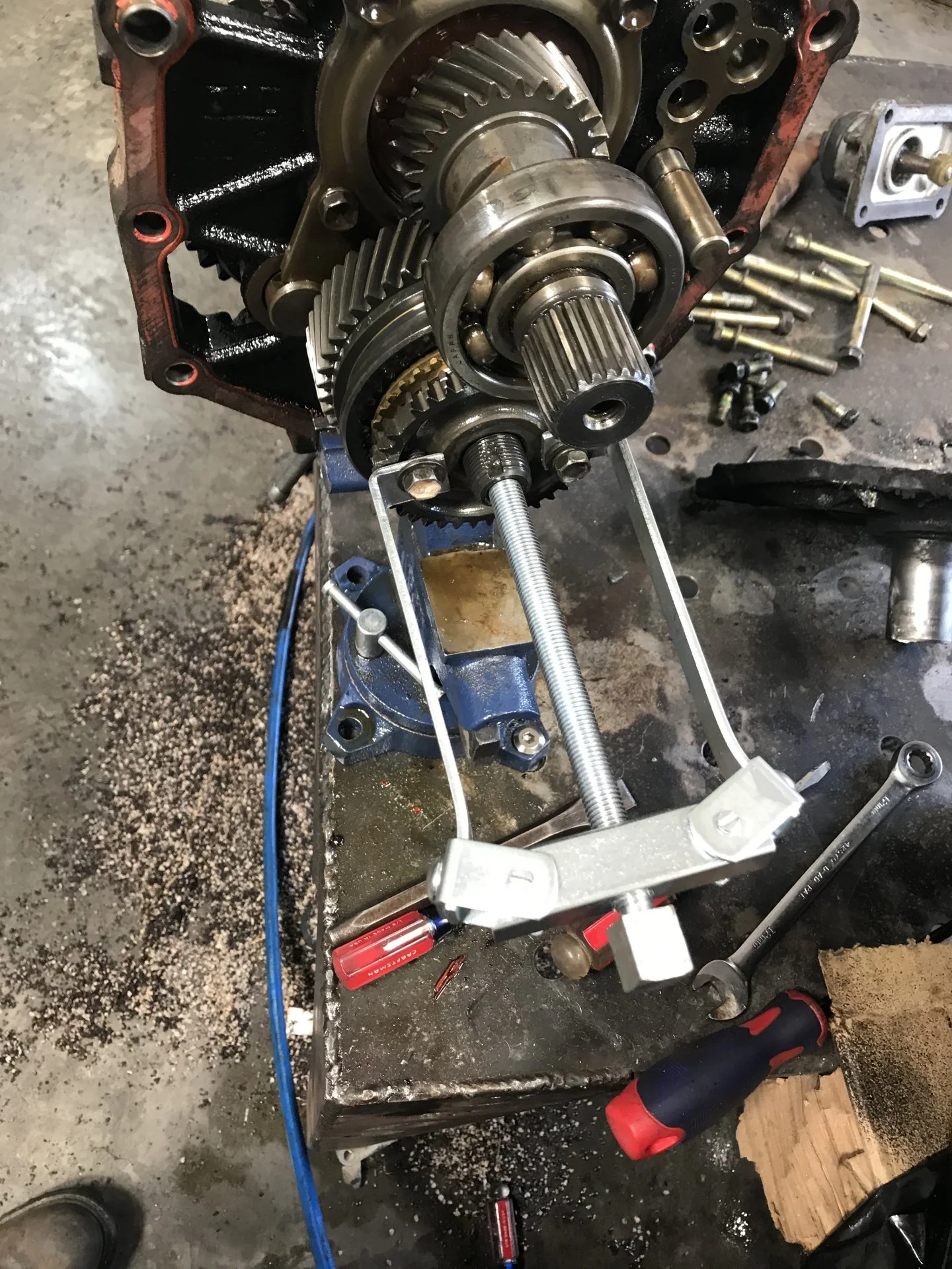

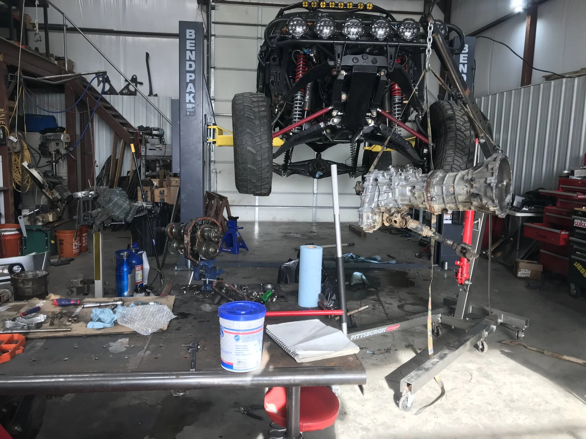

Drove the cruiser some more and it’s definitely time for a trans rebuild… I beat on it pretty hard before the ifs swap
Already have the parts have just been putting it off
The classic 1st gear thrust washer and an hd bearing holder
Should handle 500hp no problem
Will probably just give the steering more leverage for now
Definitely want to add hydro assist as well down the line

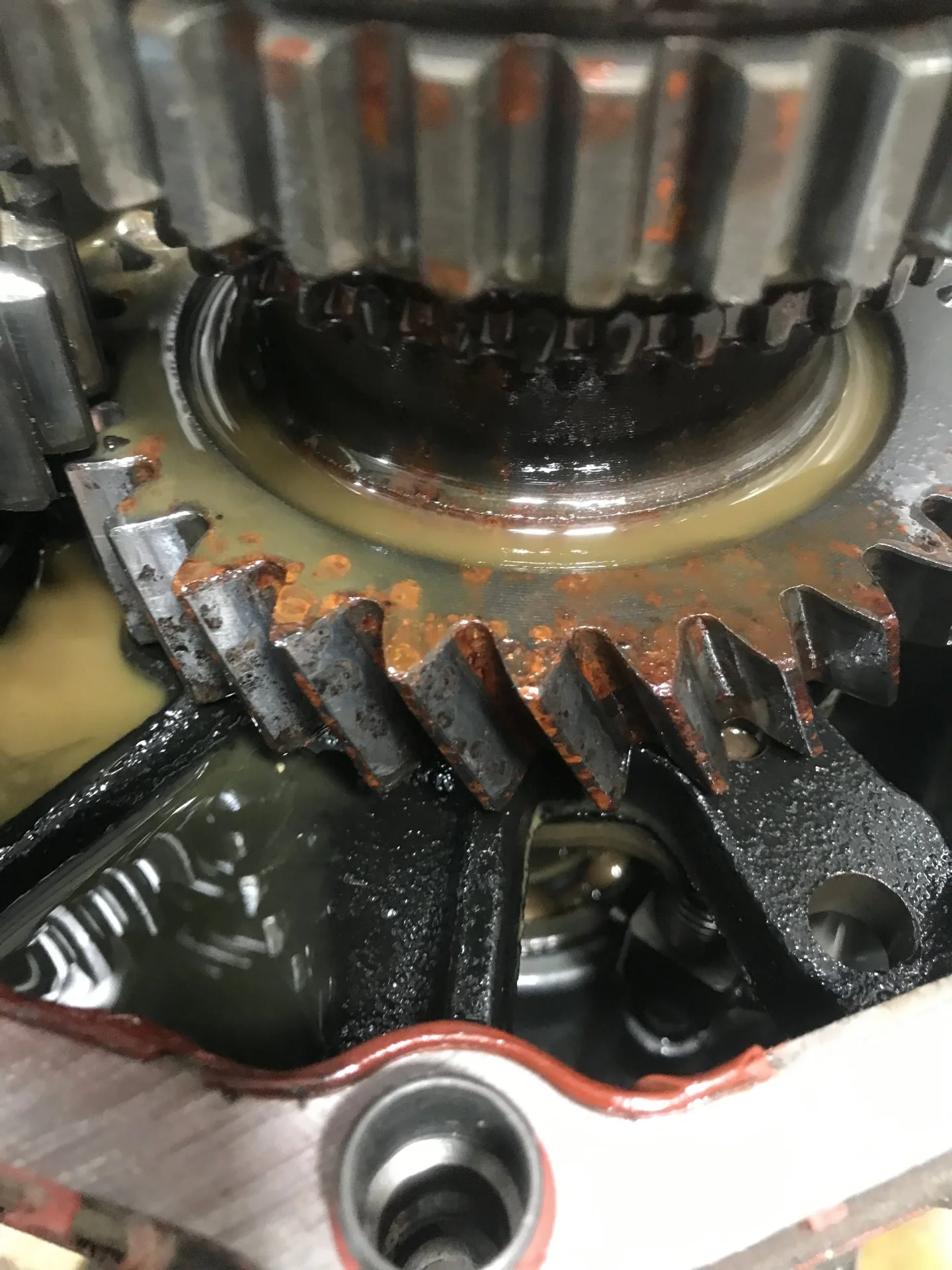

There just happened to be another R150f 20 min away so I can drive it and mean while I’m going to rebuild it possibly cryo and REM the gears with all the marlin parts
Everything is back in the truck driveline wise.

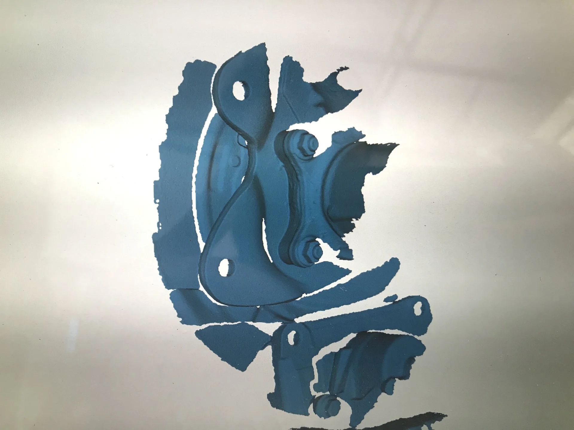

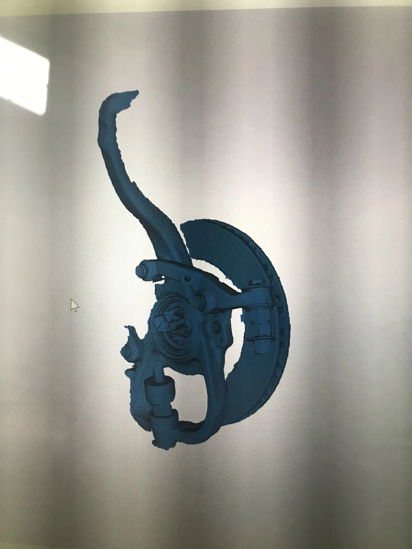

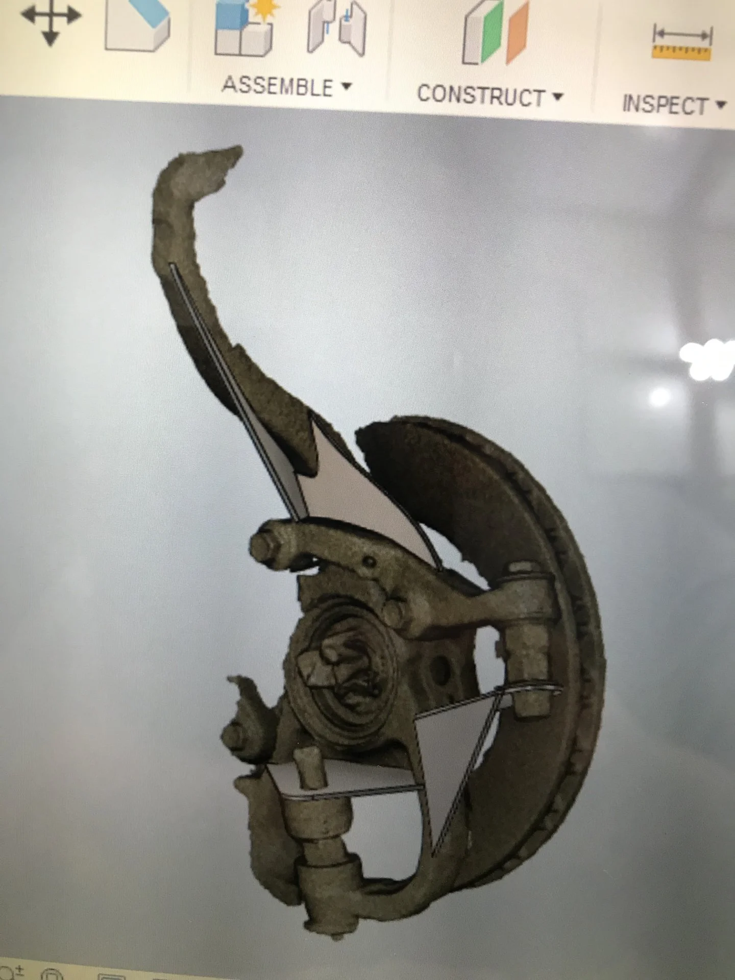

The spindle is getting some beef. Dual shear everything. Got the 3d scan done for modeling should be done today.

Trying to get this trans apart to send gears in for REM and CRYO because I like to drive it like a drift car. (Zero mechanical sympathy)

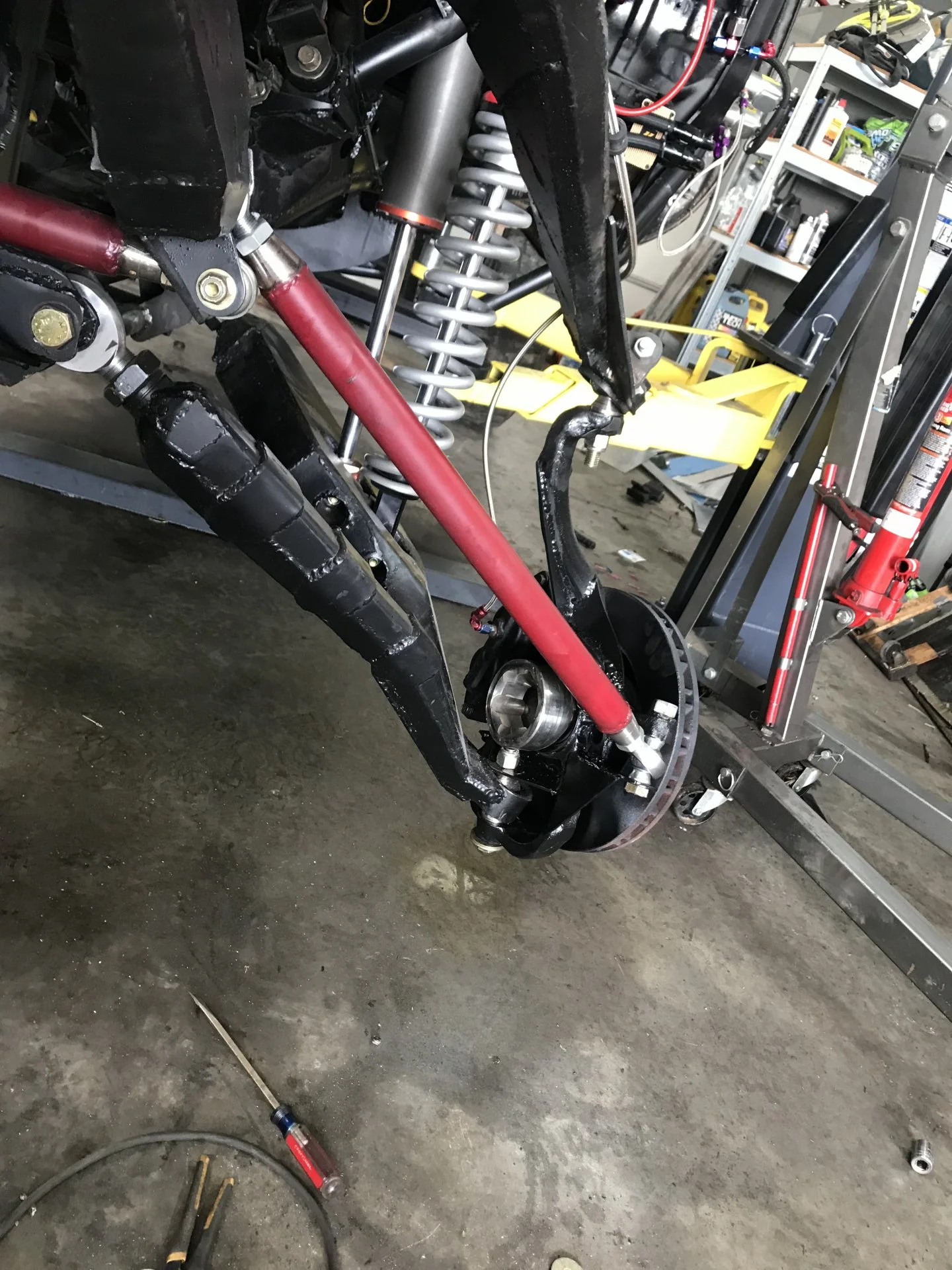

Finally the only real issue

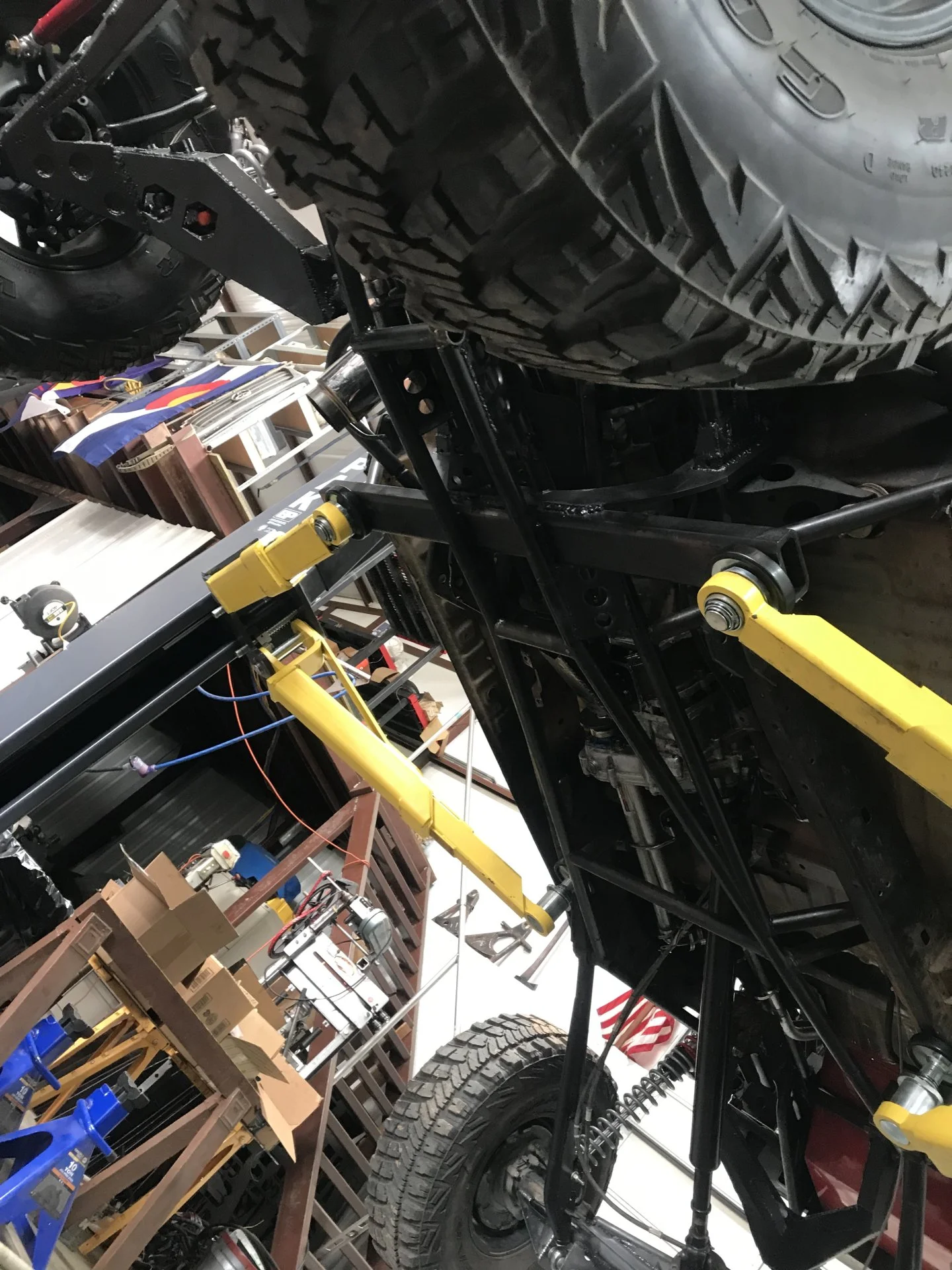

Steering is weaker than I want it to be
I have a lot of caster > 7* with 37s
Looking at doing the V2 of steering arms will prototype these as much as possible before I do those. Having minimal binding at full lock full compression.
Goals for v2 no binding
Mounts for hydro assist
Obviously photoshoped pic below
Now that’s it is on the road I have a few more things to do but it does indeed work and feels pretty good steering has a little play need to try to really get those hiems tight

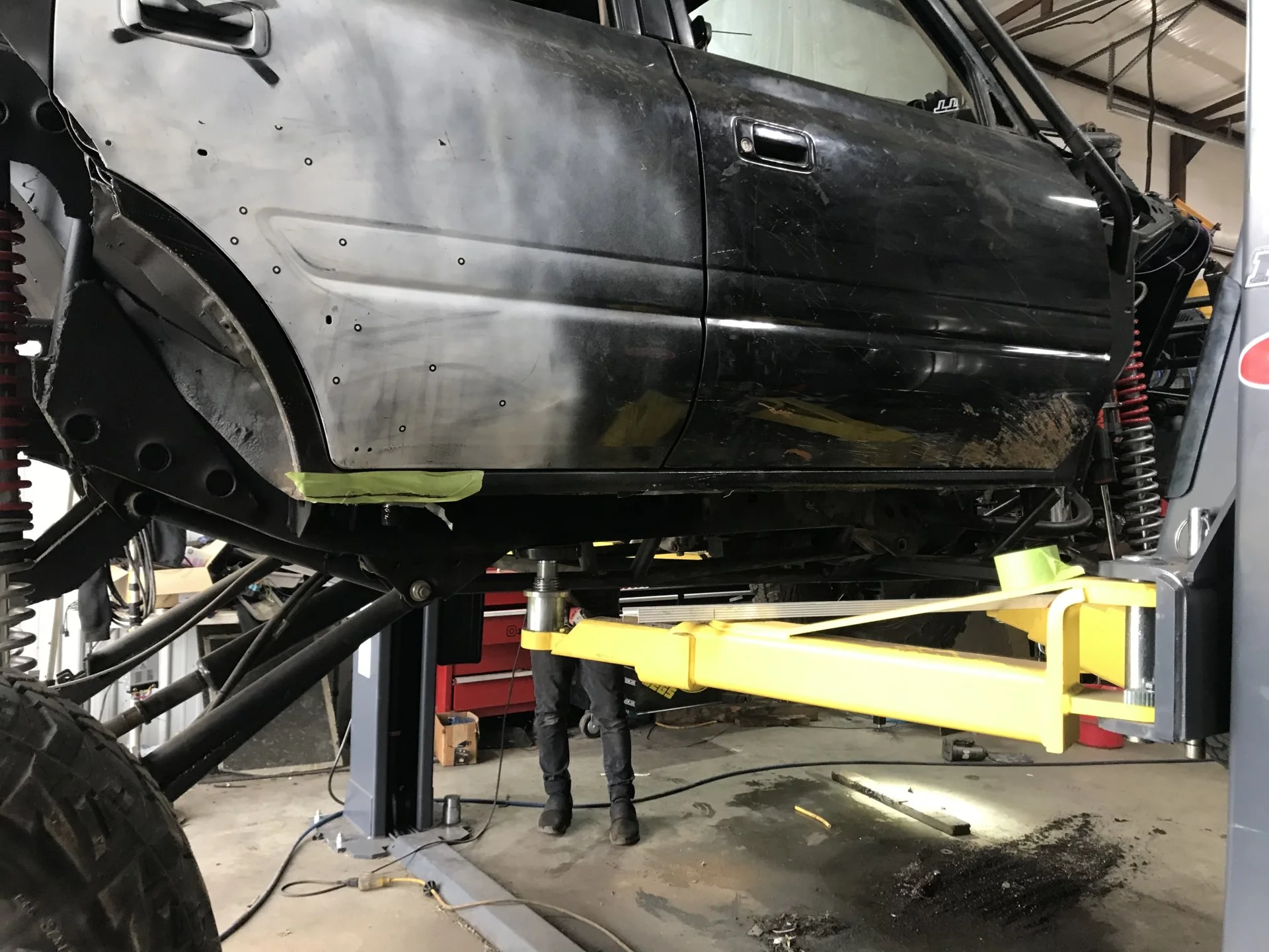

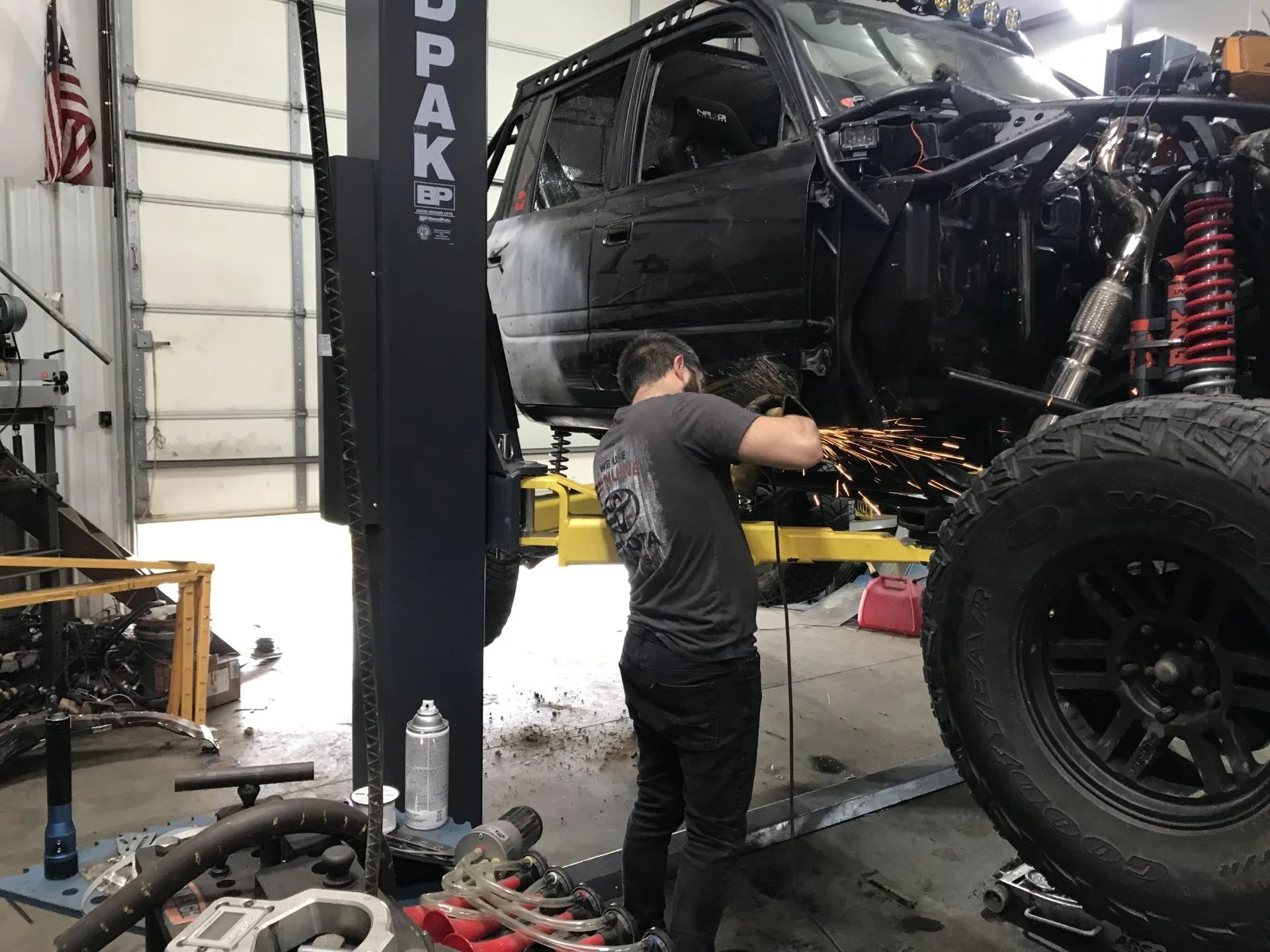

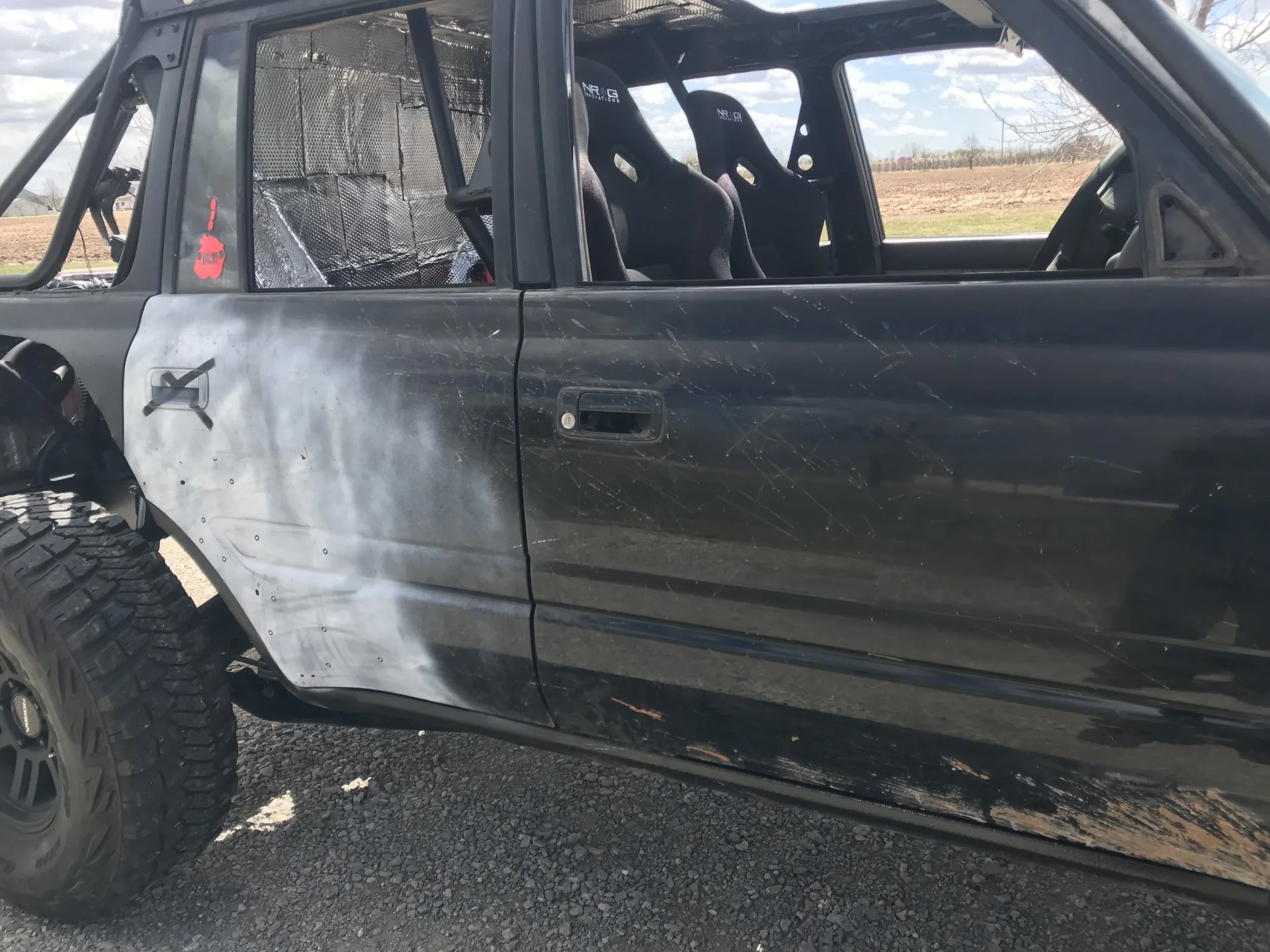

Lots of little things getting knocked out. Started dual calipers and the wide body with integrated sliders
Chopping the rockers and throwing some 2x10” boxed sliders there
Pretty sure it was mostly bondo on the driver side🤦
2x10" sliders? Wow
