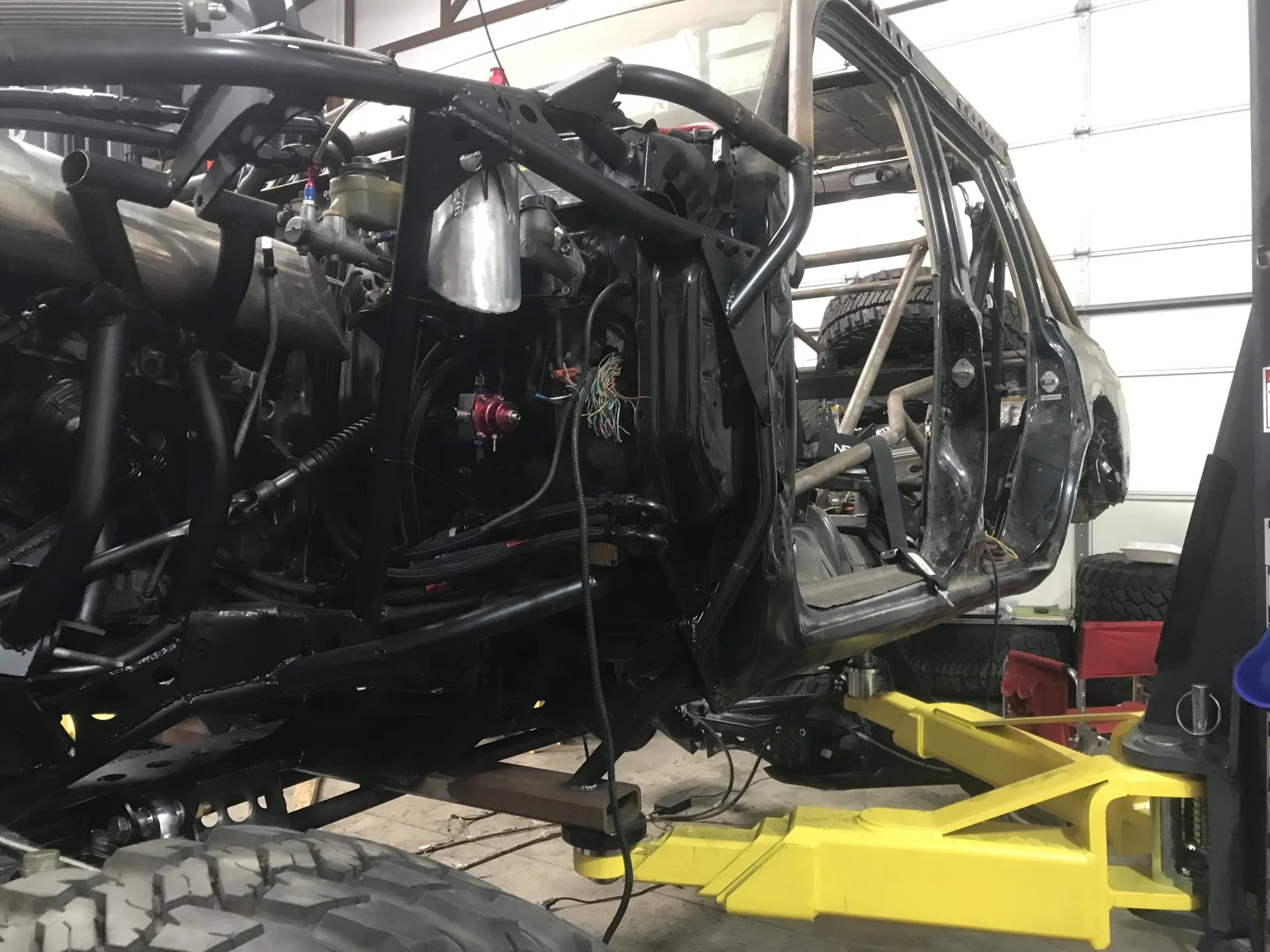

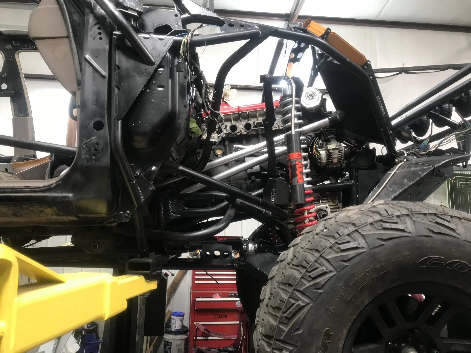

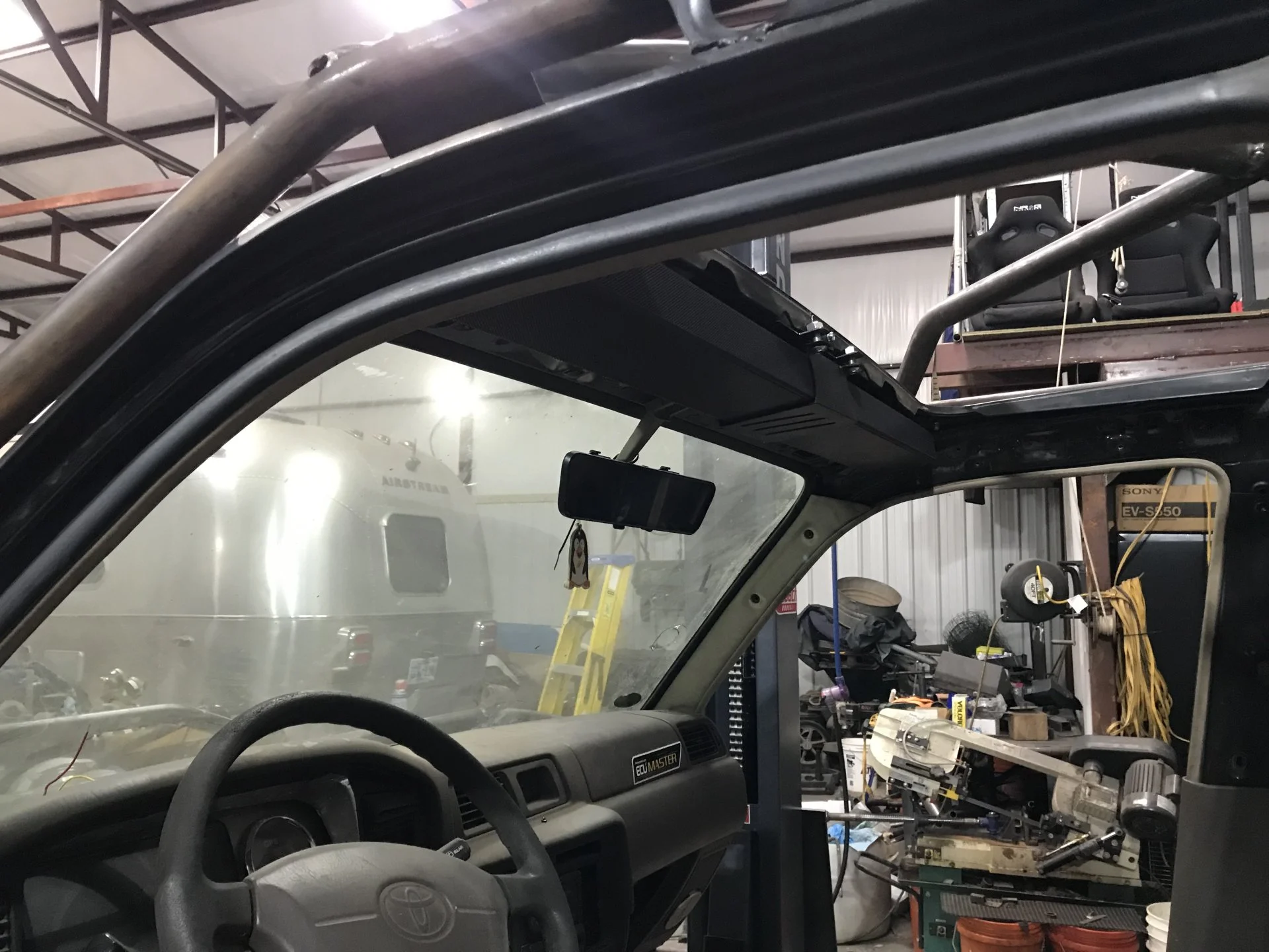

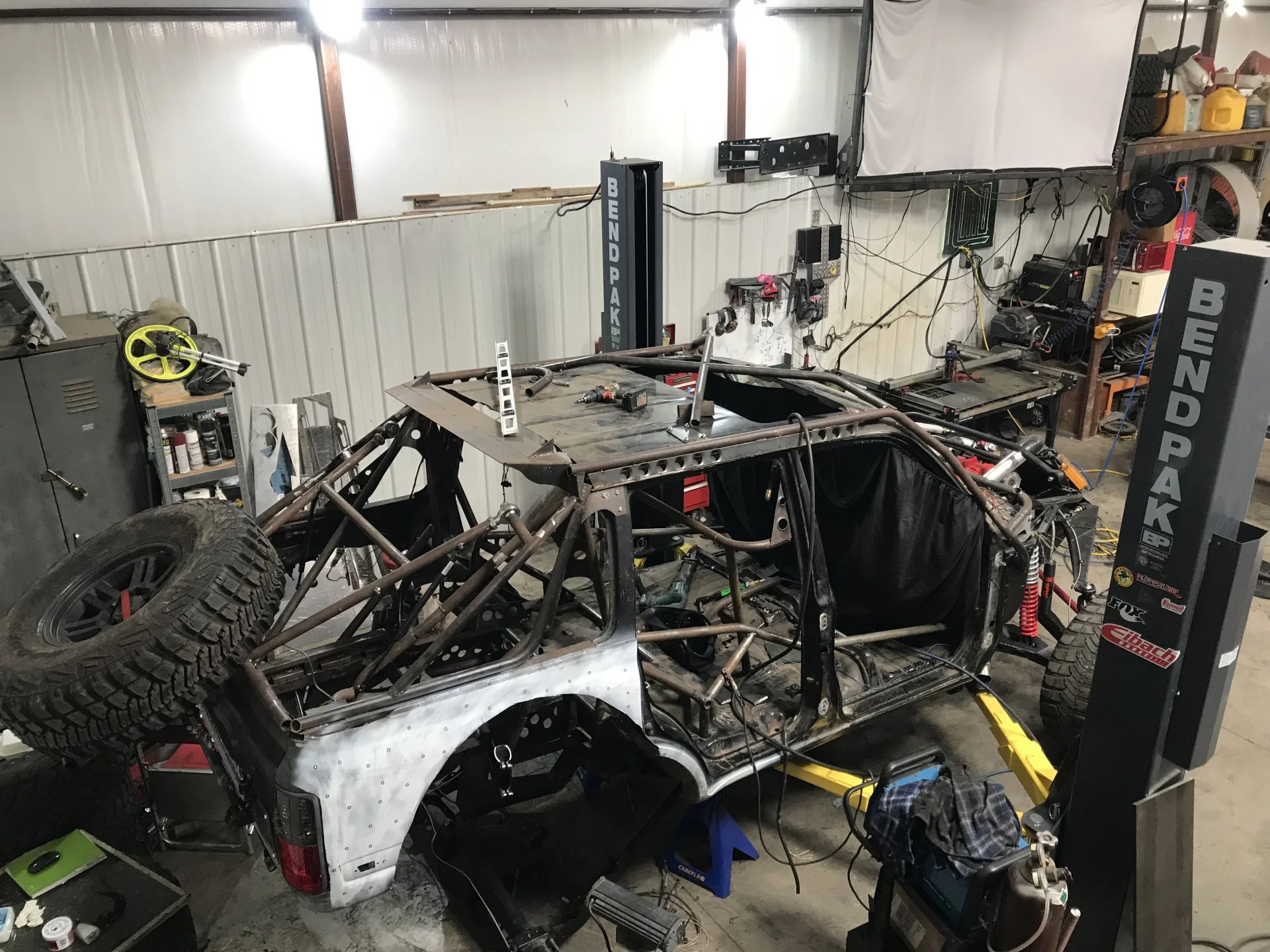

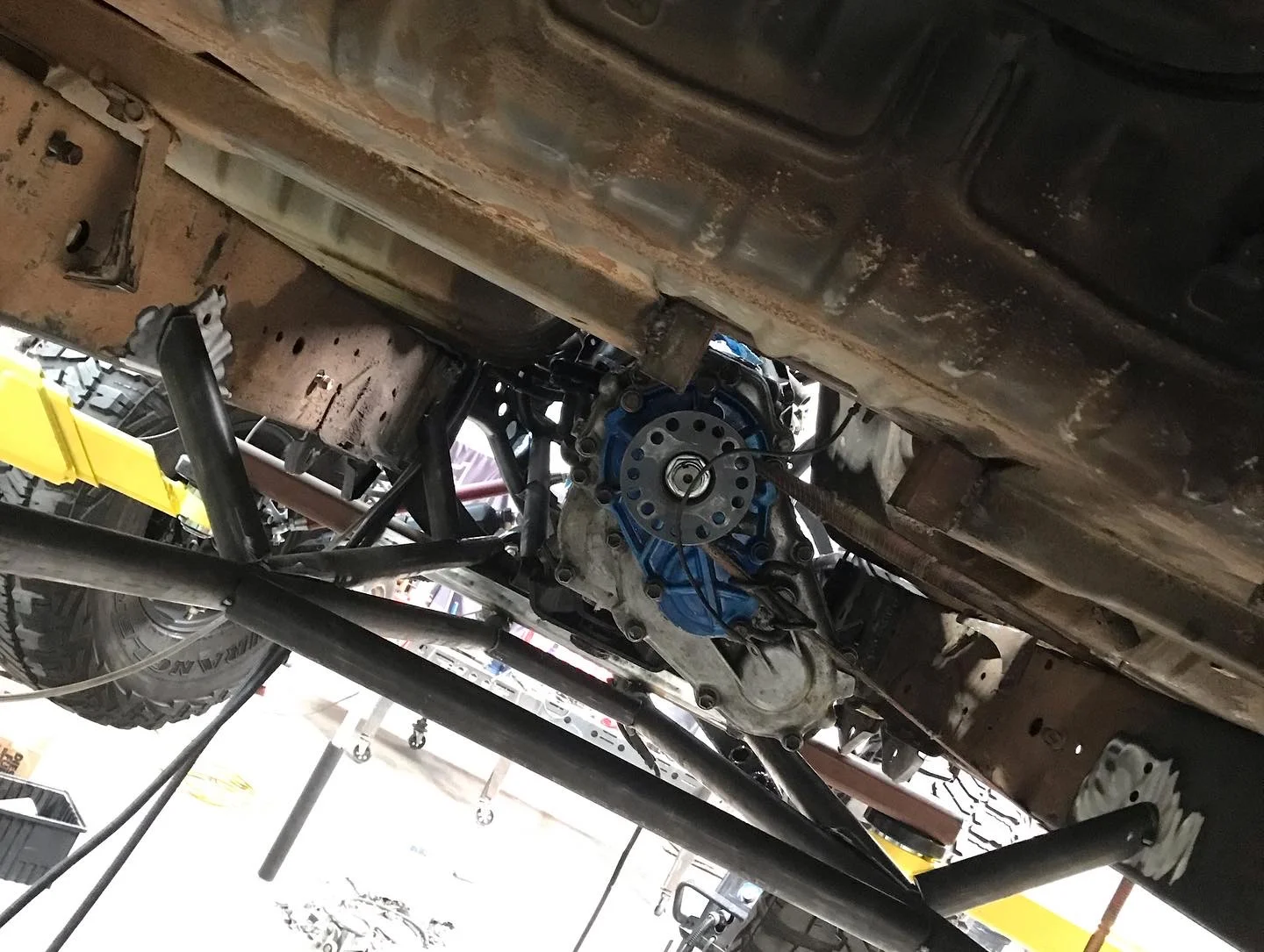

Tied the cage together in the front finally. Sandwiched the pinch weld and tied it to the lift points
Really want bigger tires to max out suspension travel, would gain 4” of up travel with 42s in the front however the rear isn’t the same story unfortunately. Probably should have done irs too but too late for that😂
Tied the cage together in the front finally. Sandwiched the pinch weld and tied it to the lift points View attachment 2920796View attachment 2920797

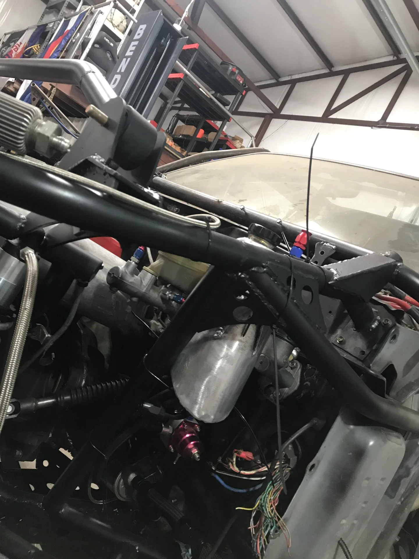

Top x brace - will be connected to the harness bar to tie it to the lower frame
Harness bar tied to frame
Steering shaft finalized with a bearing and a rigid coupling

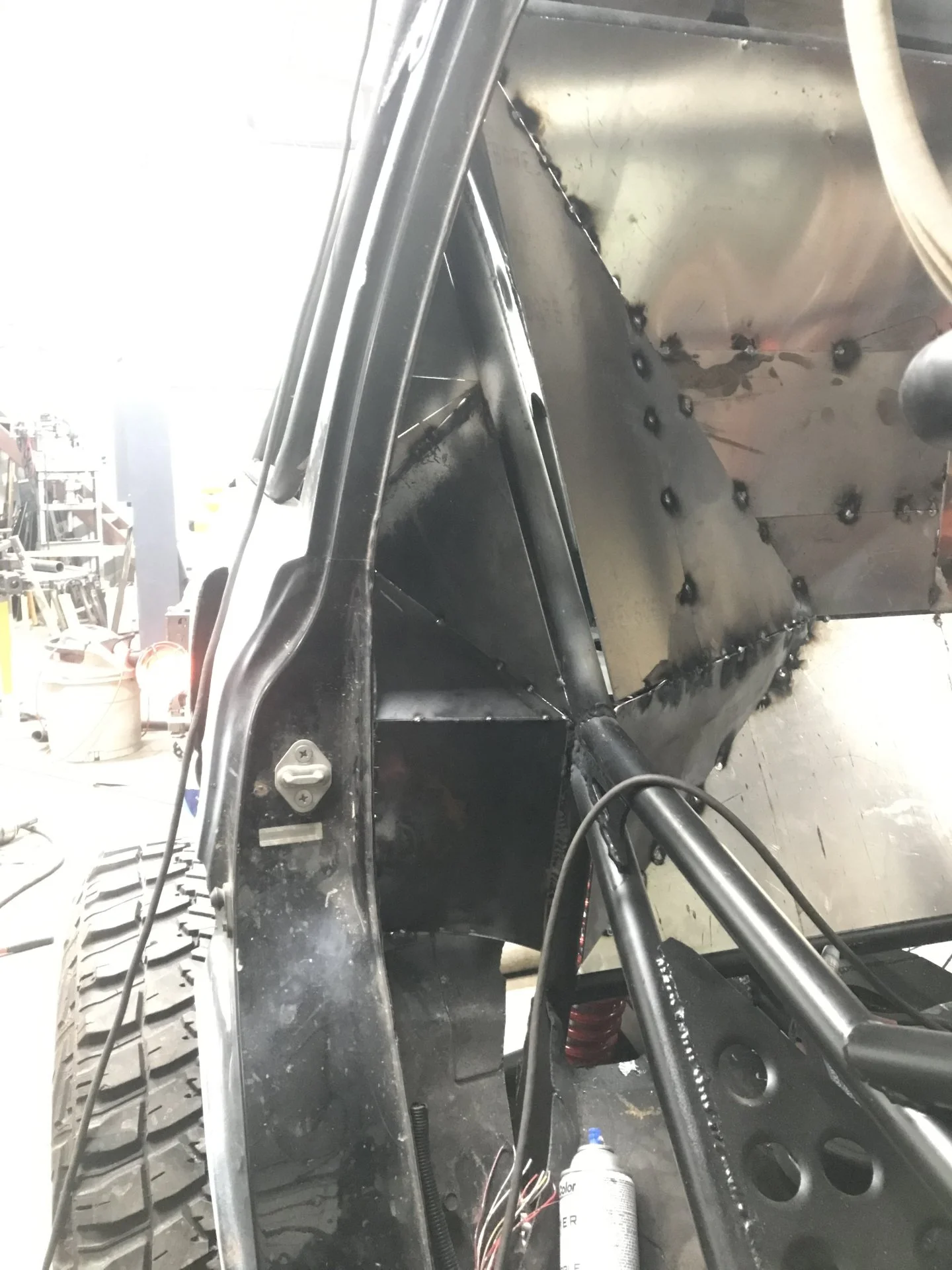

Rear frame gusseted

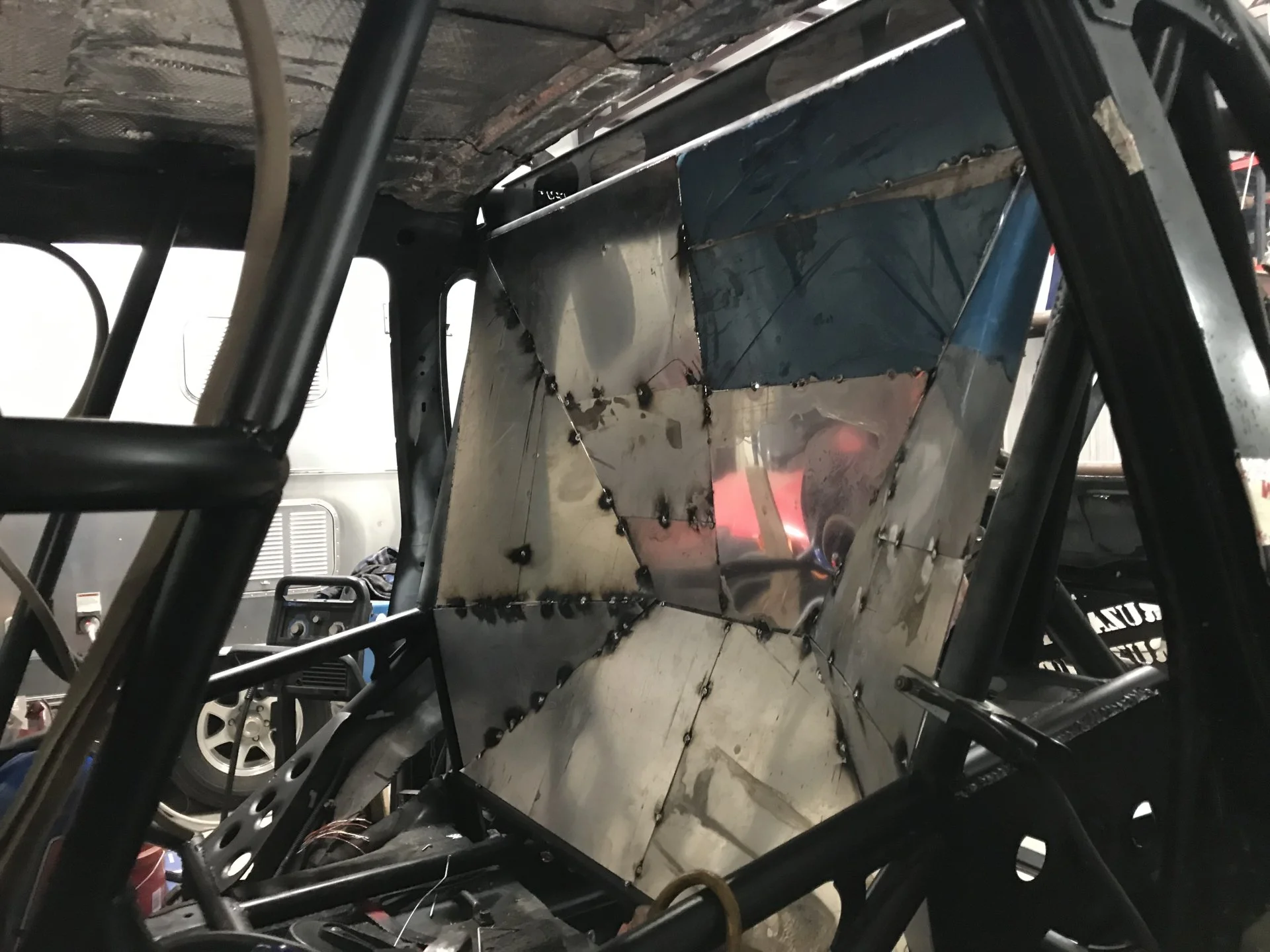

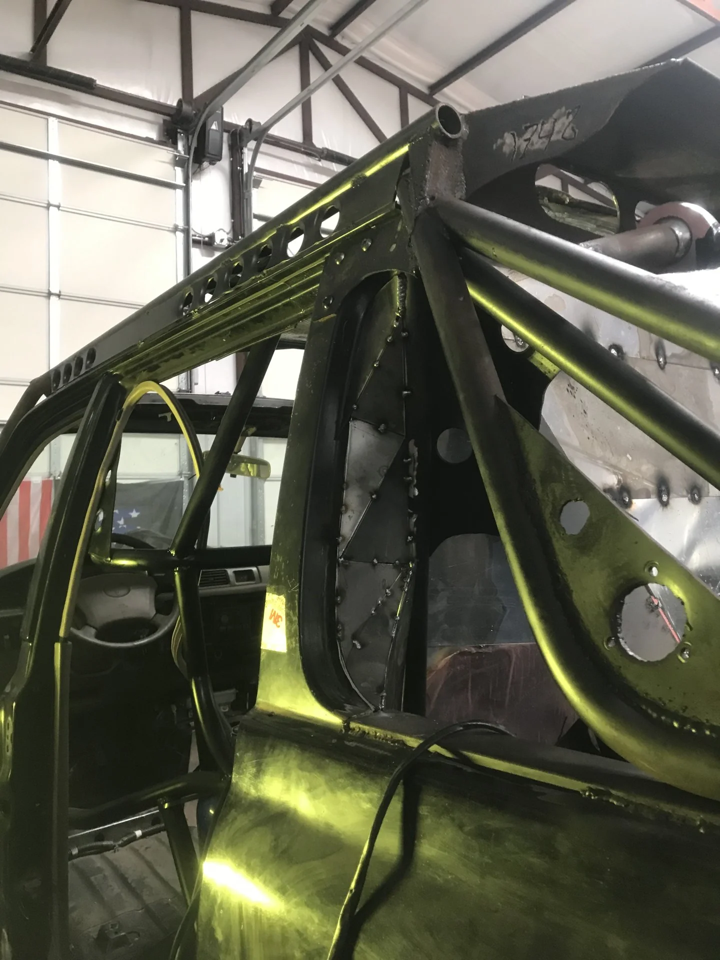

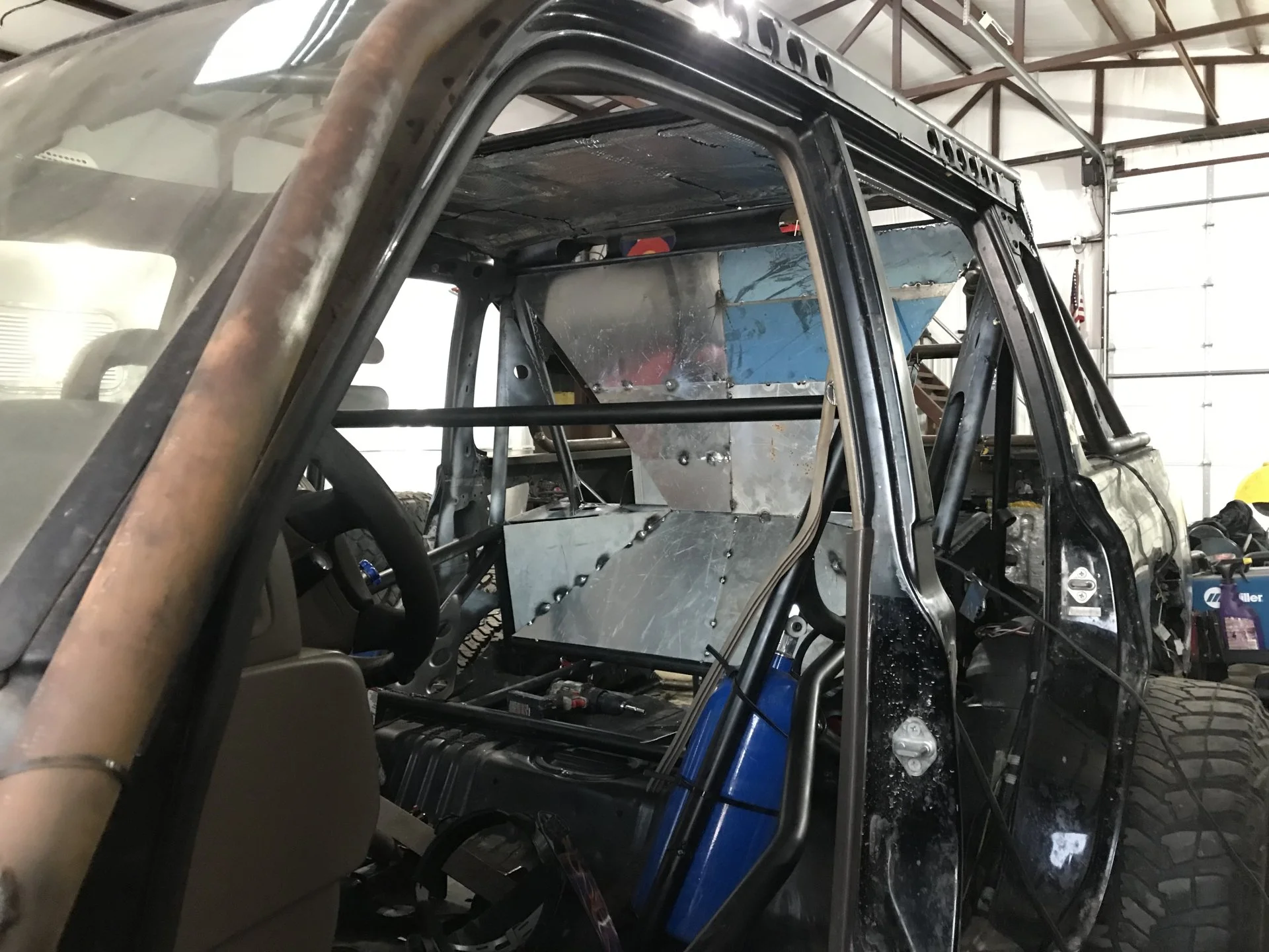

Almost to painting the interior roll cage
Damn nice day to paint. Cleared out Napa for paint again might paint the truck with this stuff just to keep the rust away for now. Not sure how much up travel I should run. 10” 15” got some Amazon springs and they seem to be compressing more than the lower spring rate non Amazon springs. So 10” will have to do for now.

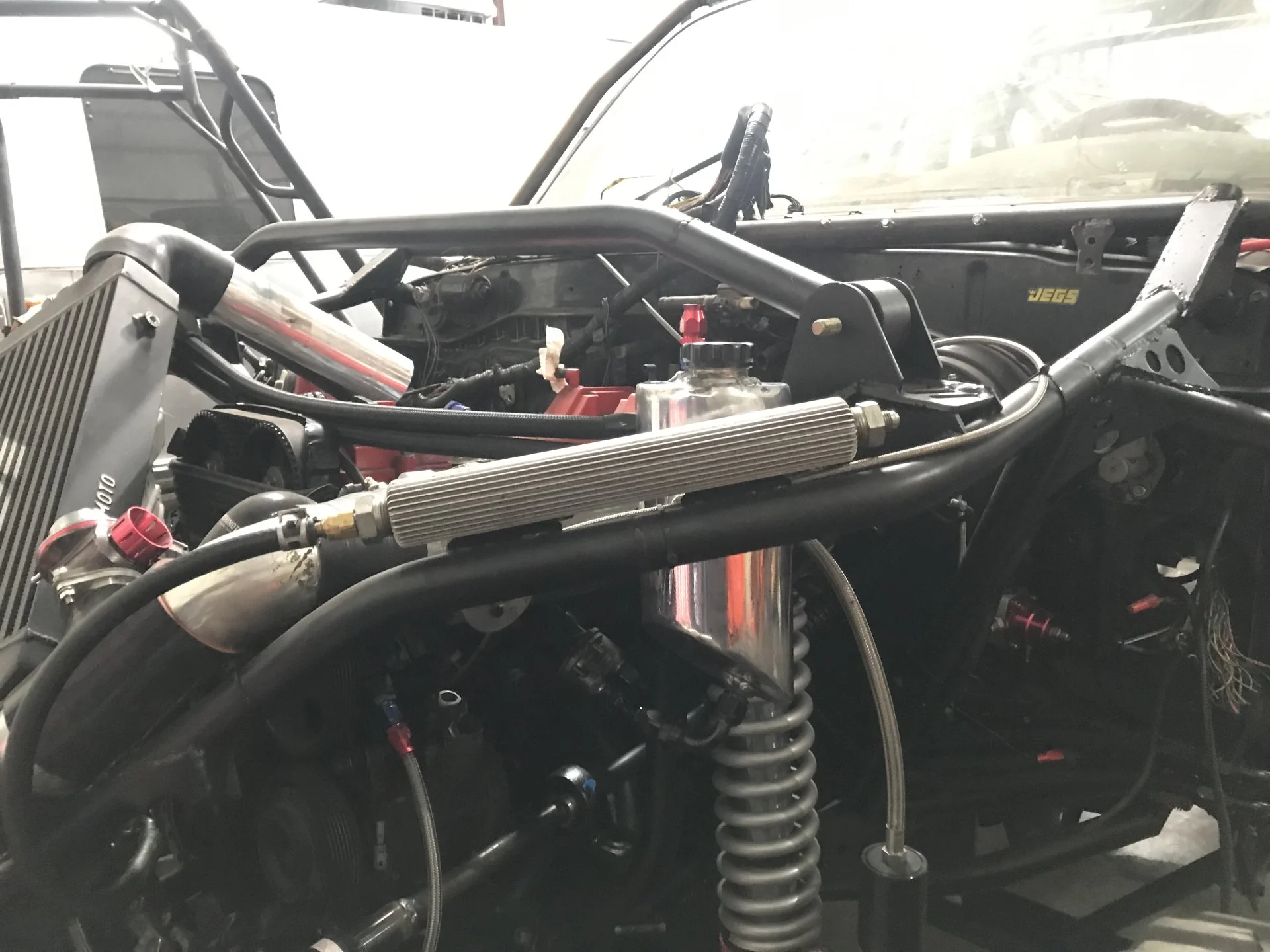

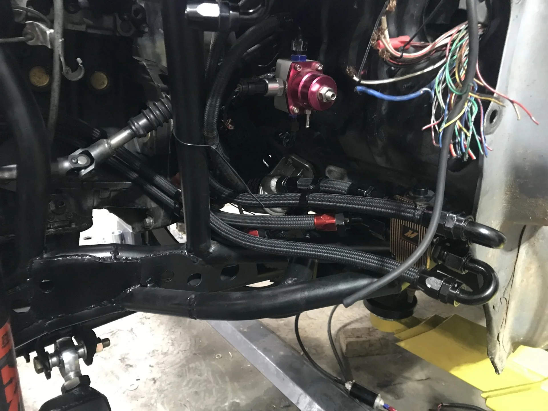

Plumbing - All the everything

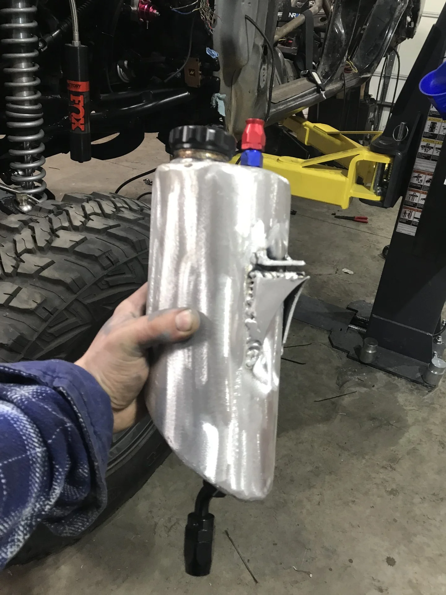

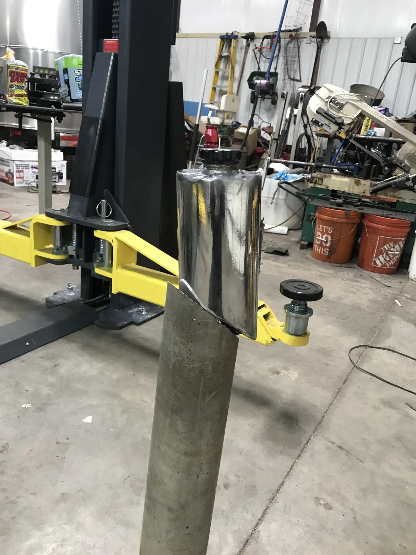

Fuel
Radiator
Power steering
Nos
AC will come later after I gut the lemons car for weight

Almost sealed in the back

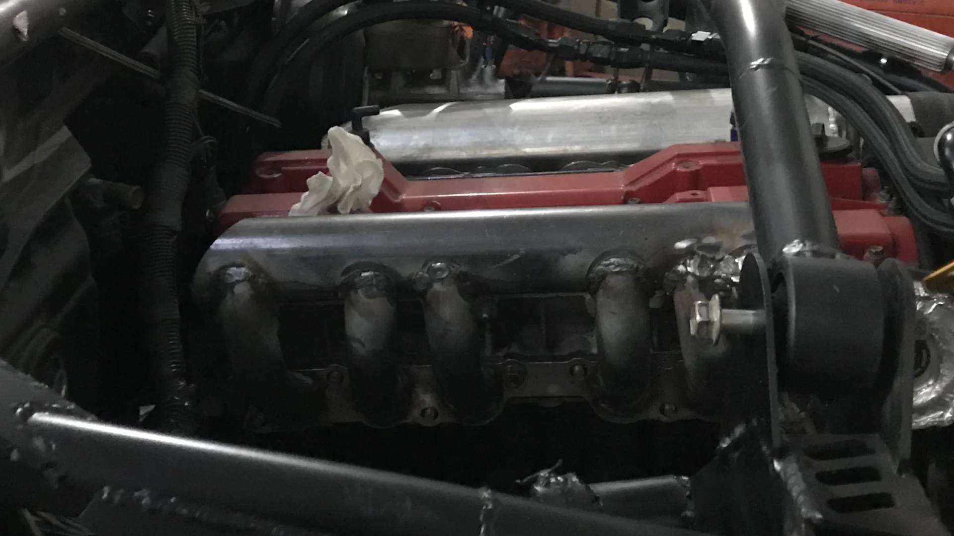

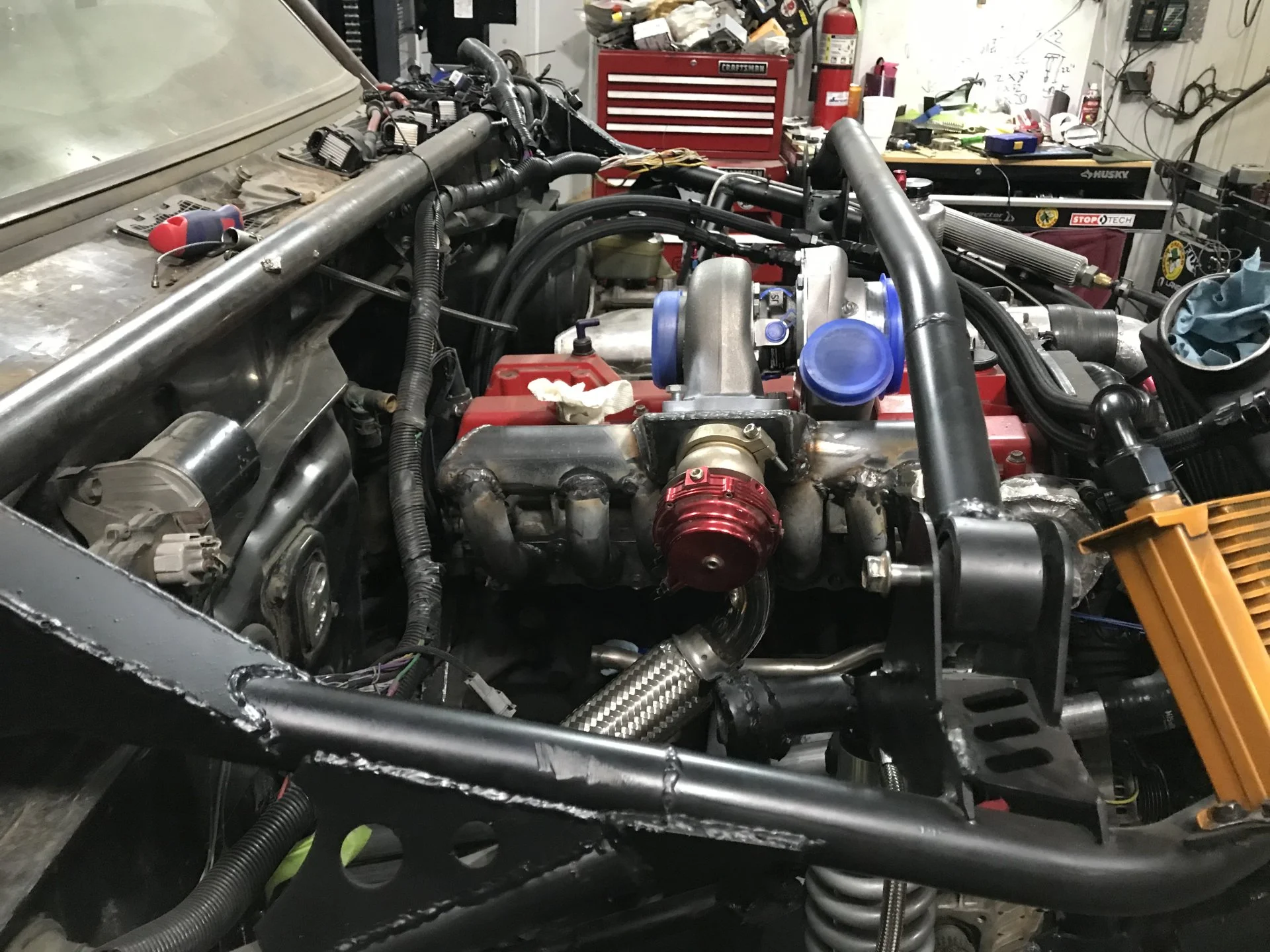

Started on a new turbo manifold
Got the rear hatch working with the dual linear actuators
Turbo is in, looks bigger than it is in the picture. The T51R mod should sing pretty good
Also started mapping out all the wiring
Got a bunch of little stuff done brackets mostly
Waiting on one more part for the turbo manifold, wastegate flange, other than that it is done

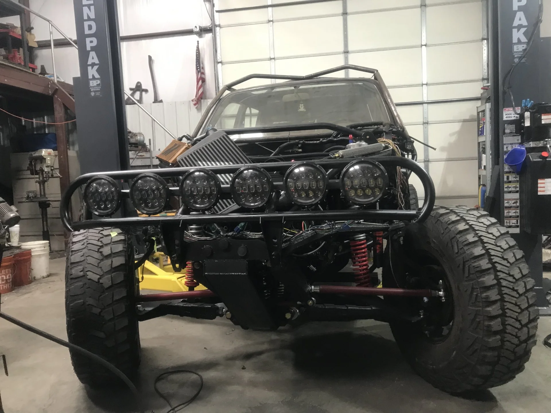

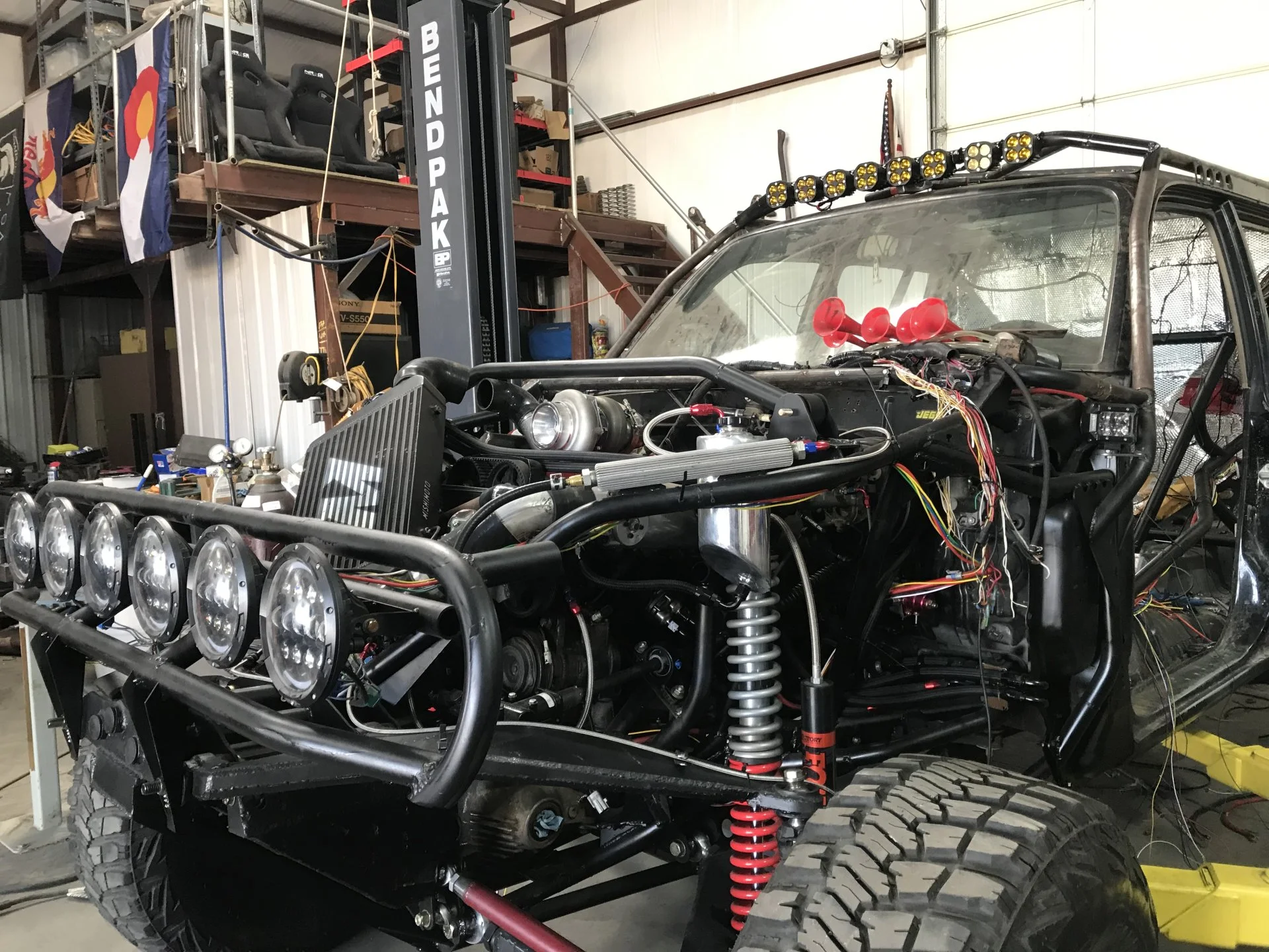

Ditch lights, front bumper, radiator lines.

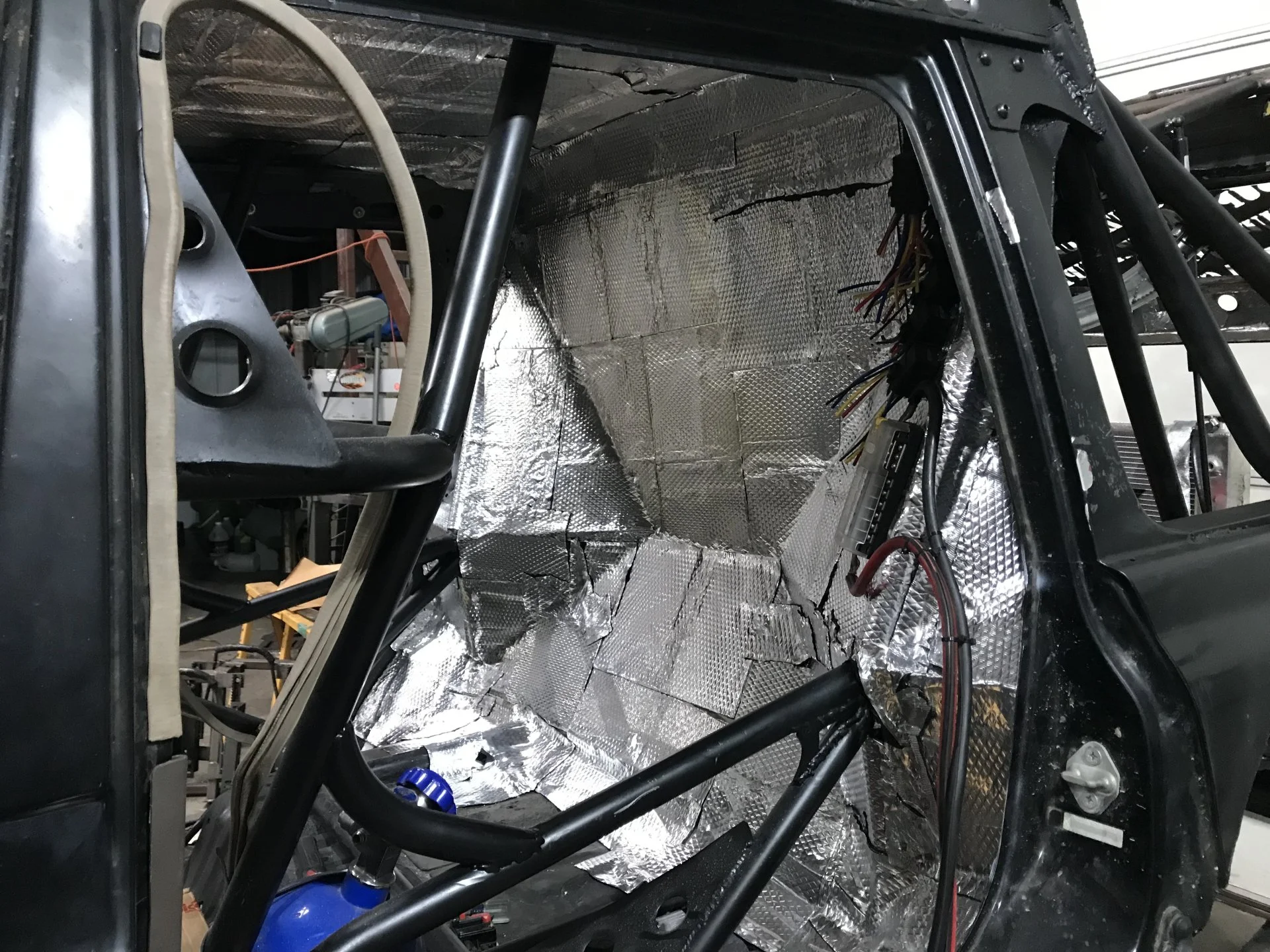

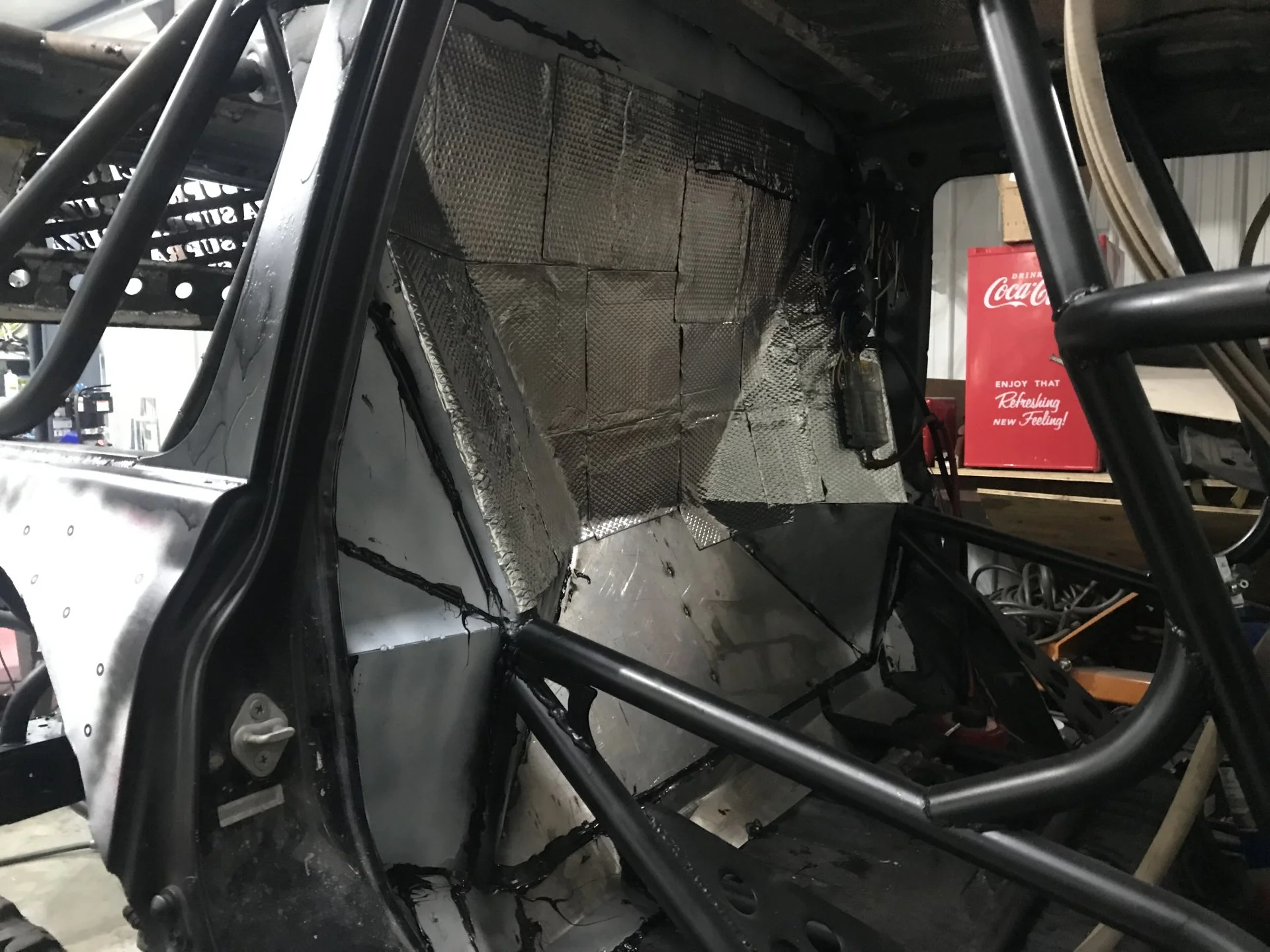

Finished the sound deadening on the rear. Hammering everything out as fast as I can.

plumbing is pretty much done minus AC and heat

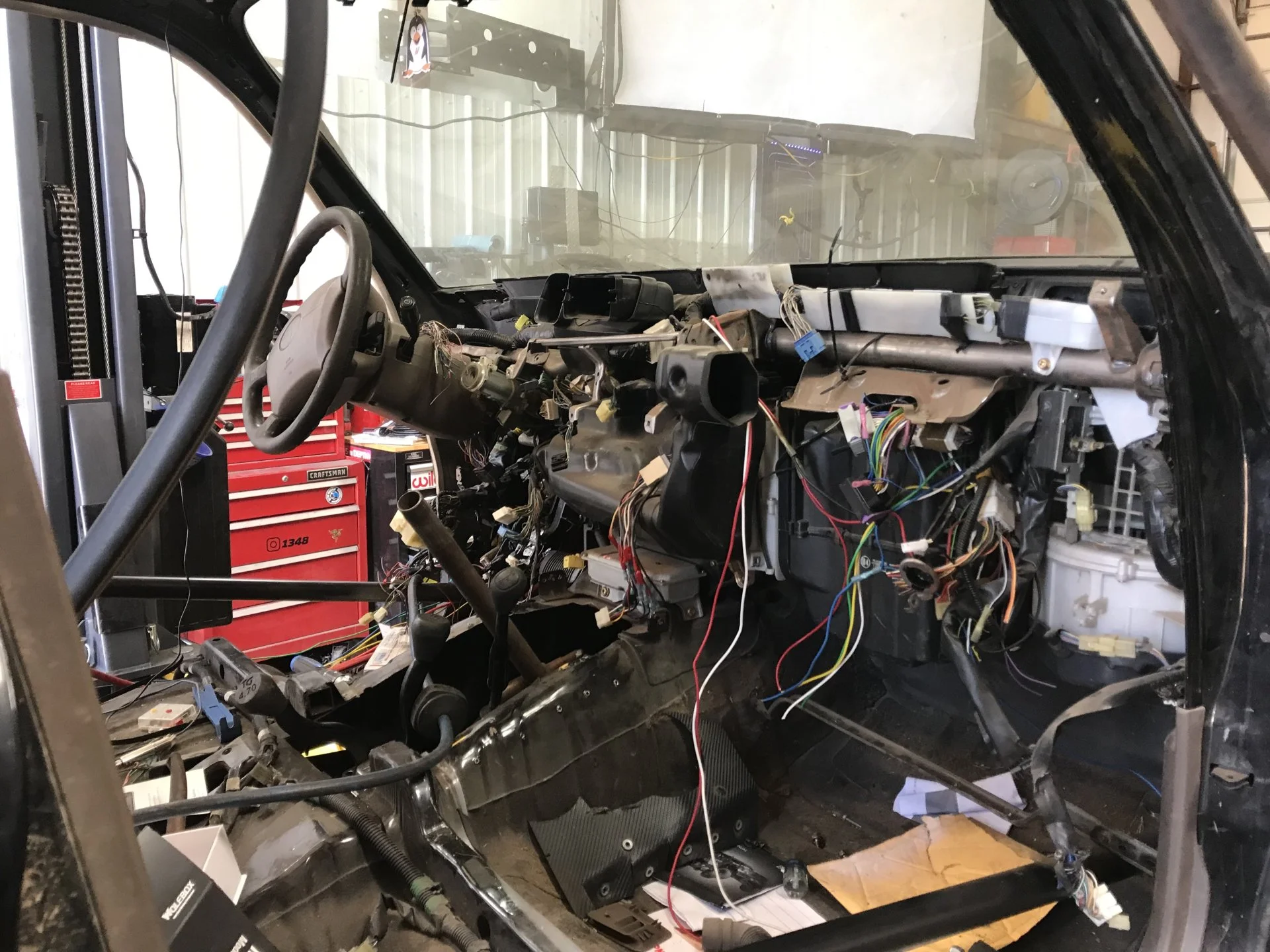

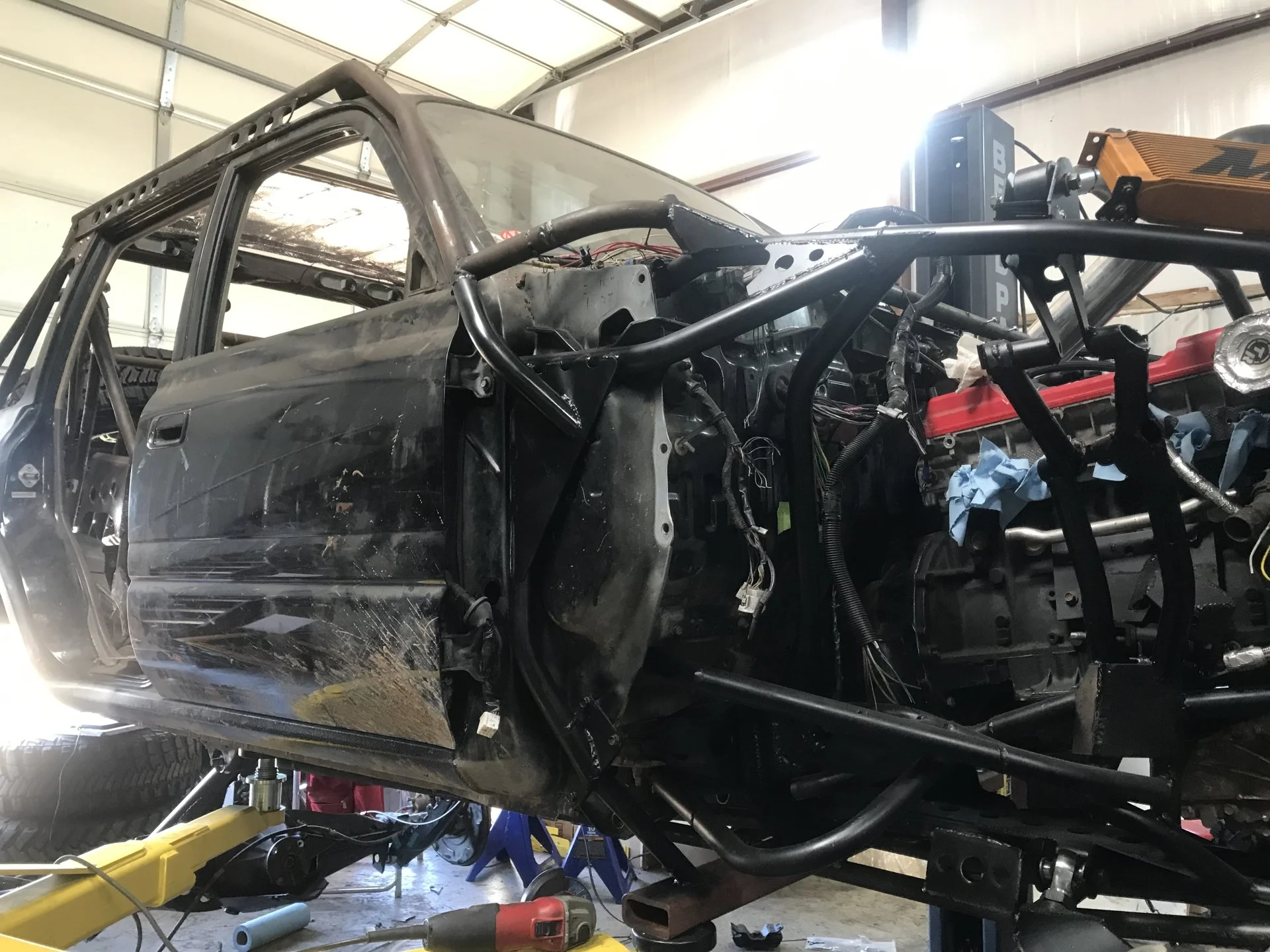

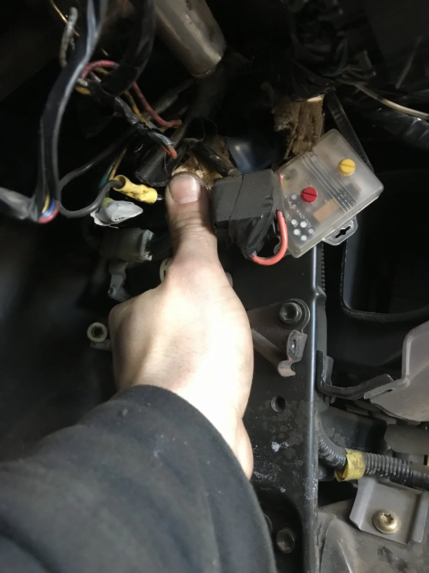

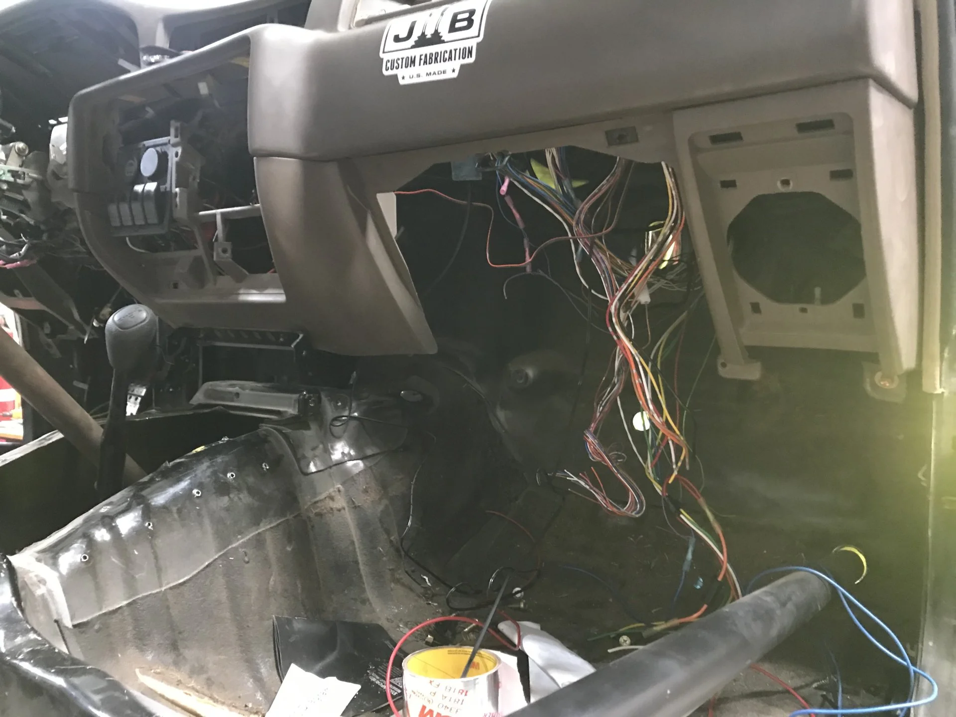

Started to do wiring and was getting weird results on the volt meter

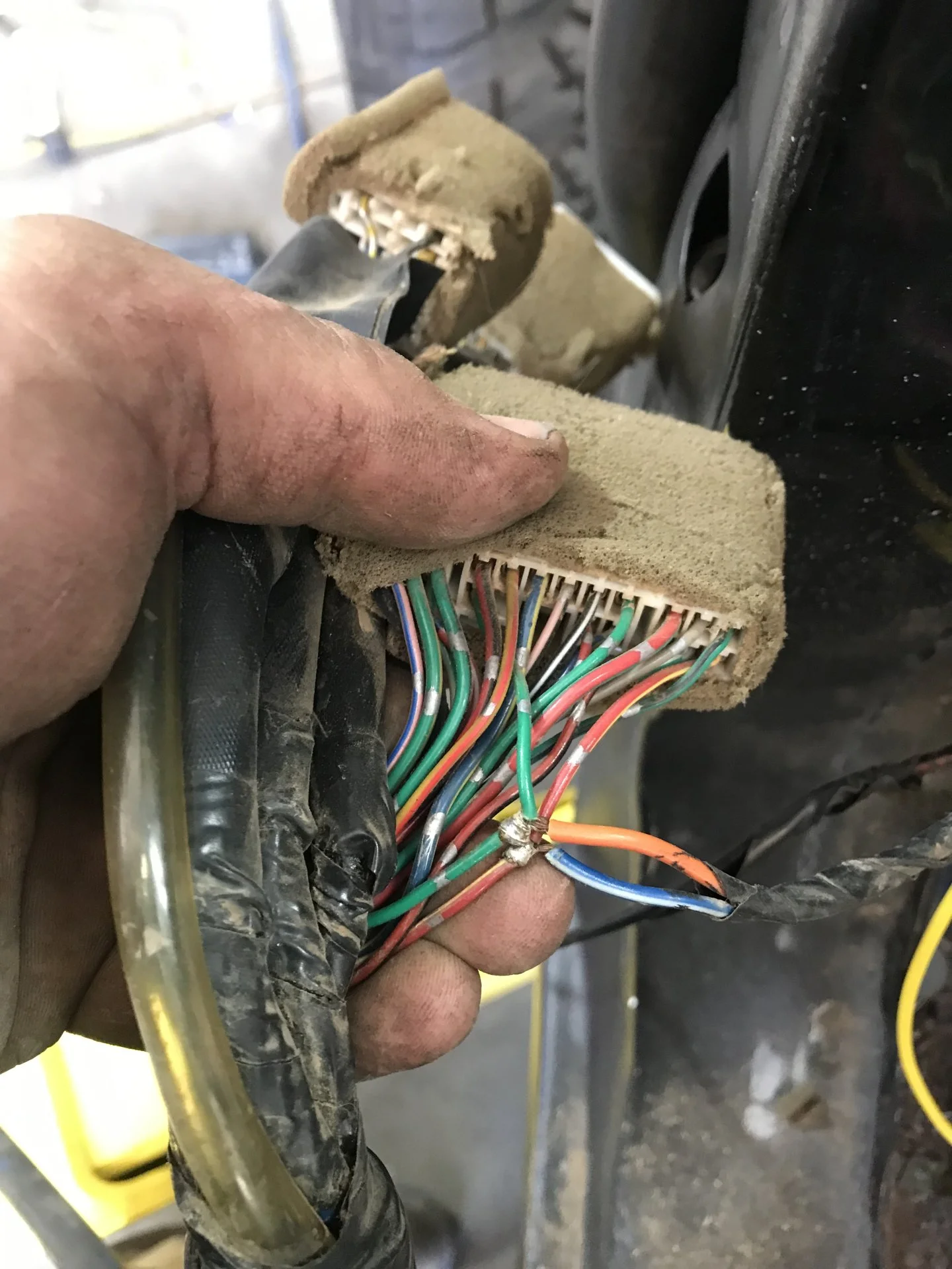

After removing the dash, super fun btw, found a few areas that were questionable at best and probably would have resulted in a fire.
So I have gutted the whole thing. doing a fresh harness. Also means that I should be able to avoid having every other thing triggered by a ground wire.
Furthermore I’m going to 3d scan the dash and do some custom panels off the 3d printer. So it looks less jank
No idea what the guy was doing with the wires but he had tapped into the harness in 7-8 different spots with either shotty home depot connectors or a booger and no heat shrink
These were touching, glad I found it
Officially day 1 of wiring the harness

At least I’ll know everything that goes on with this truck.
