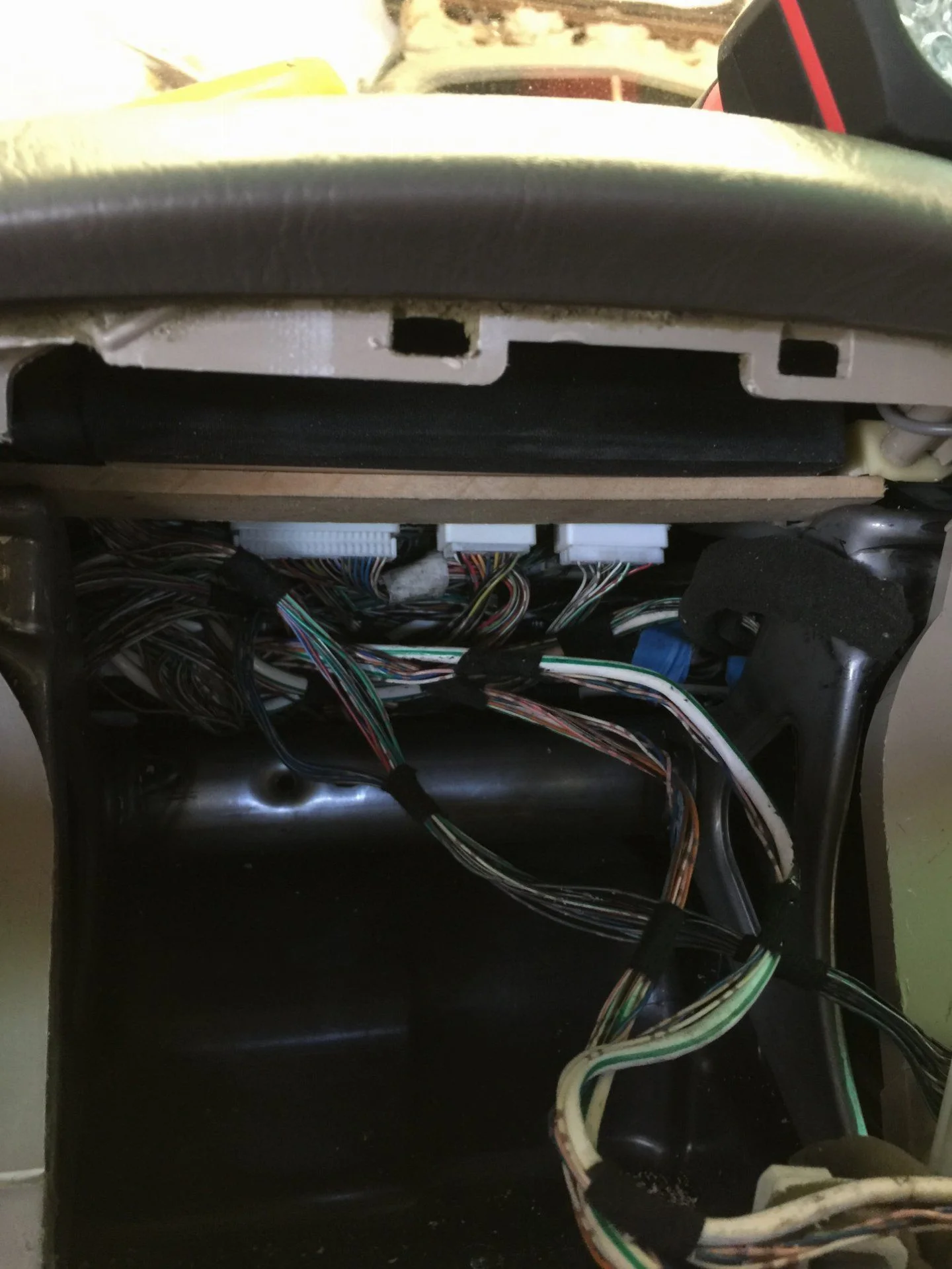

Wires were neatly tucked away to make room for the new stereo

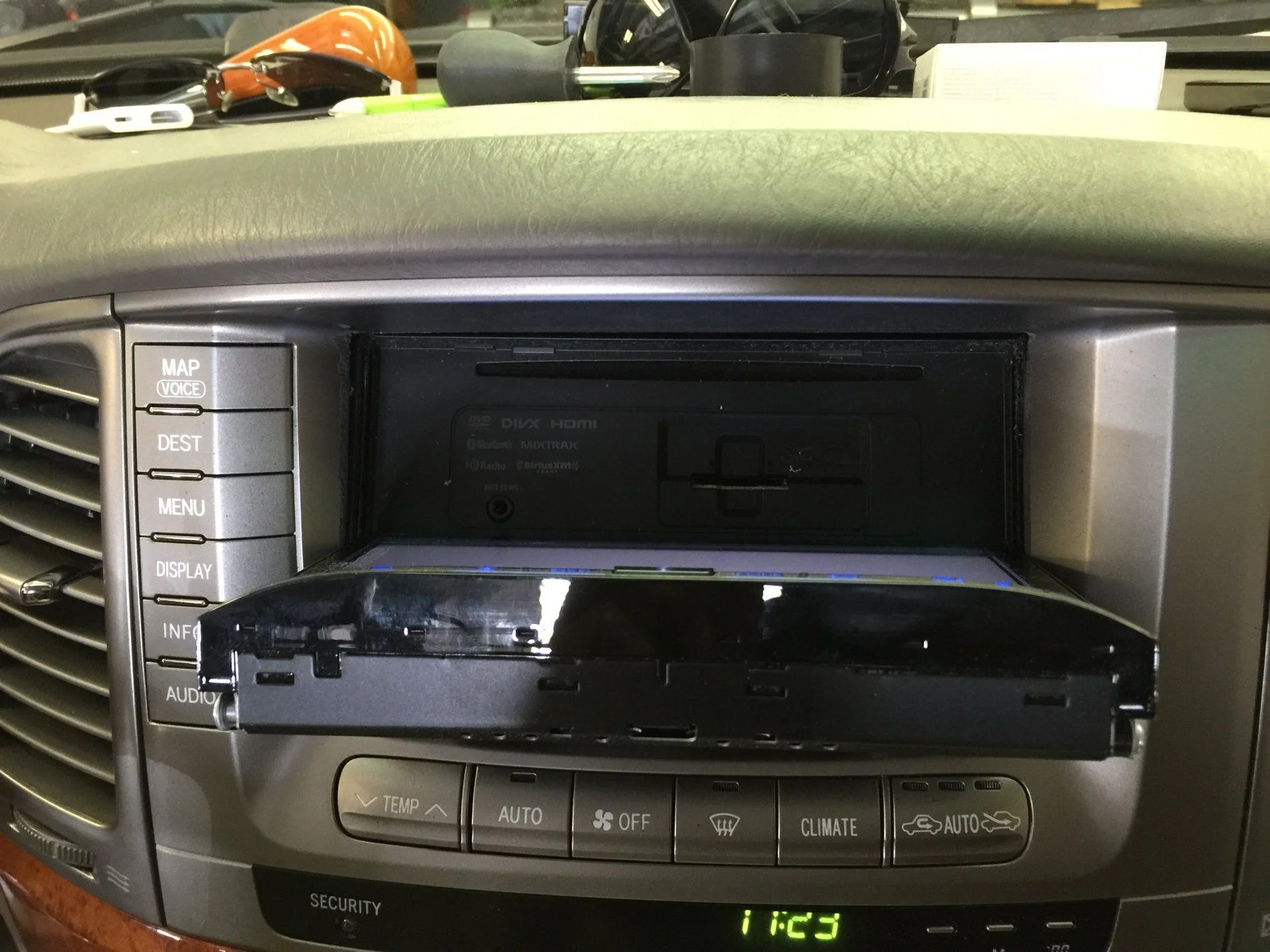

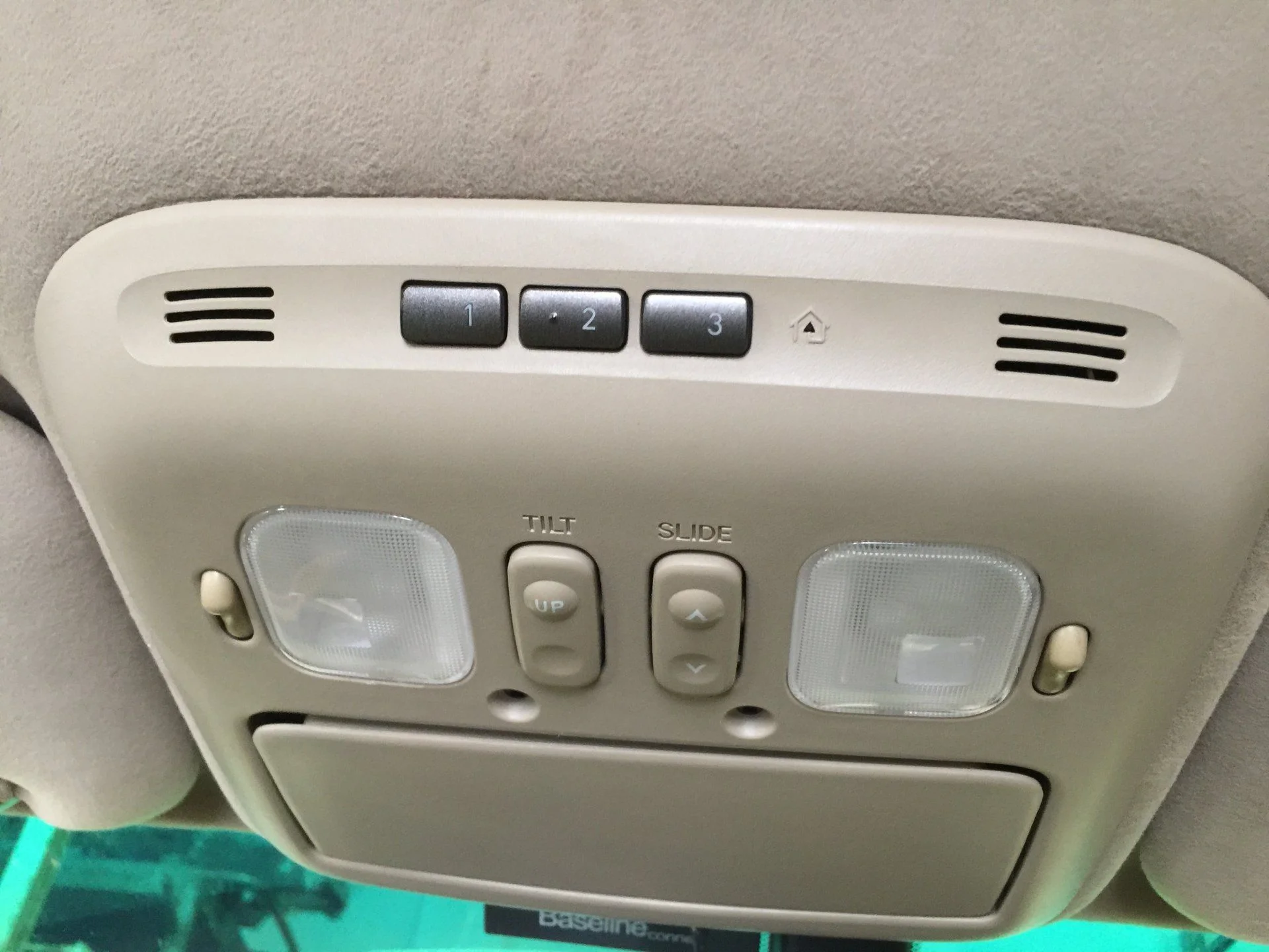

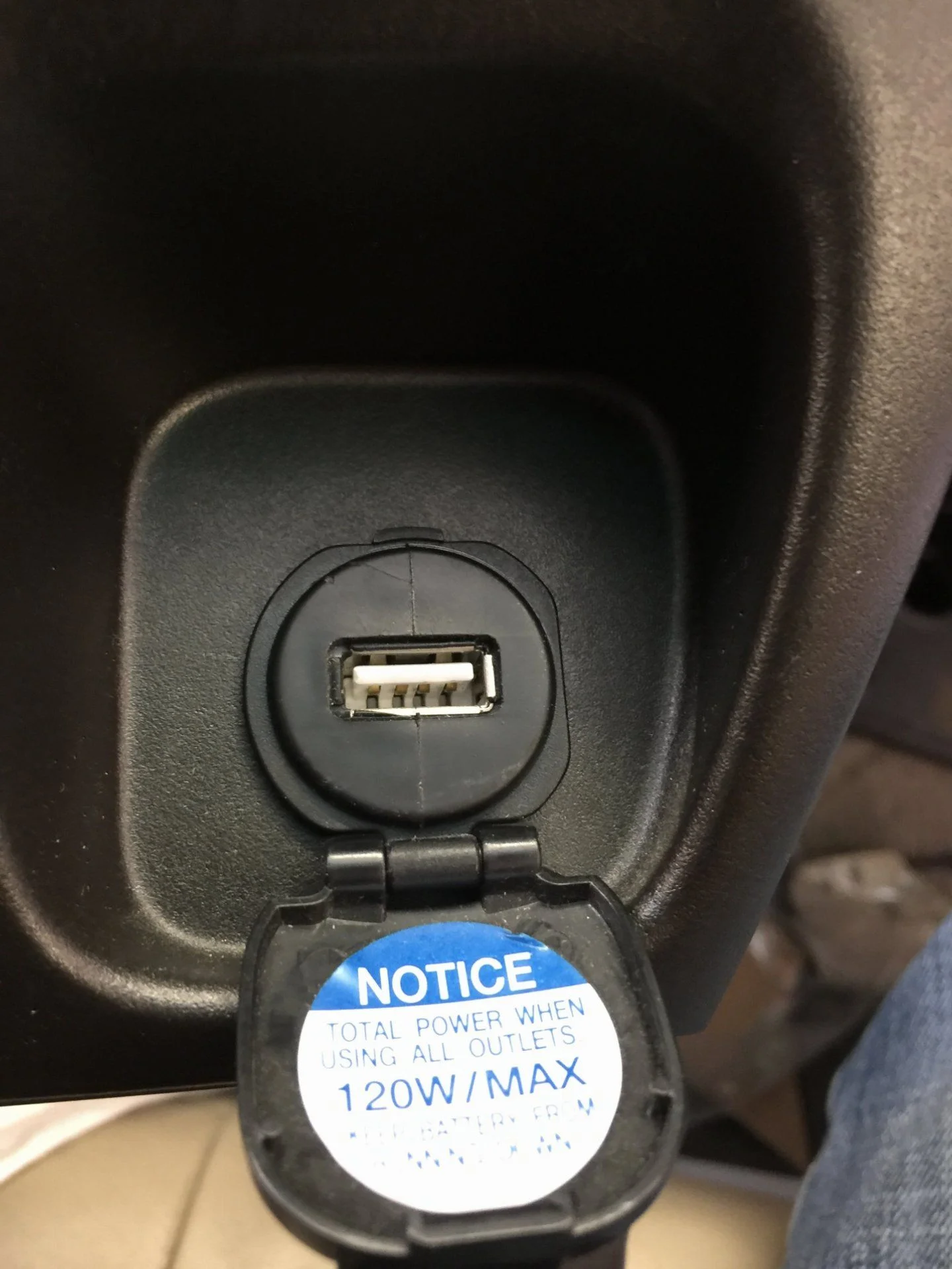

Pioneer was finally powered up today. USB port for Apple car play was installed in place of the spare power port next to the cigarette lighter. Cigarette be relocated and will eventually be replaced with more USB port for additional phone chargers. Factory mic location was utilized for pioneers microphone. Everything with the radio is functional but no sound yet we are working on installing amplifiers.

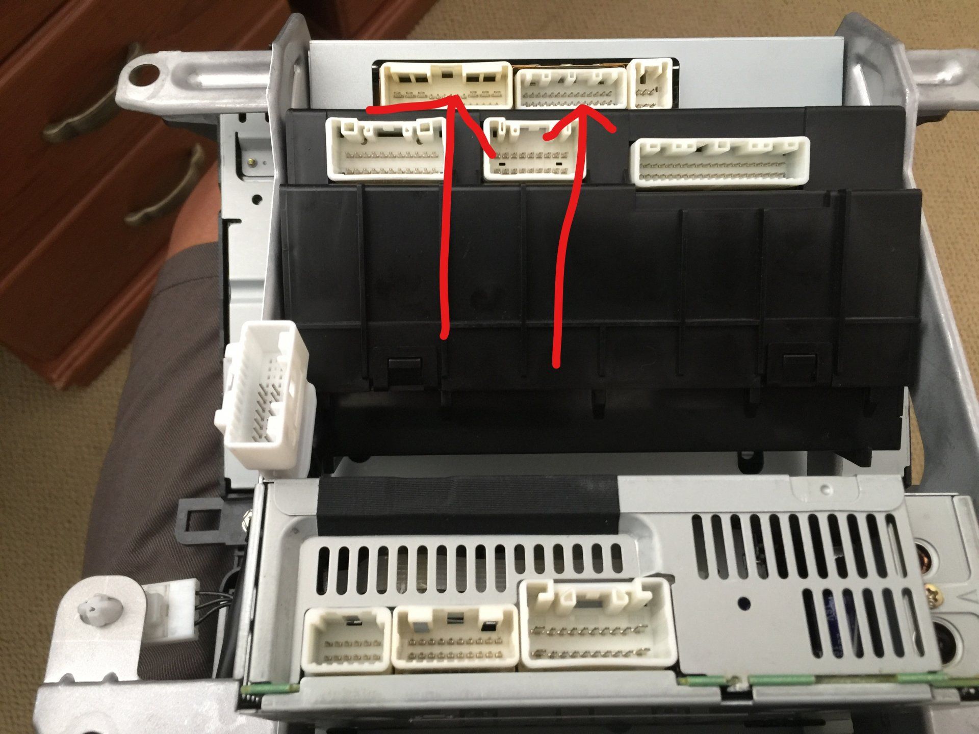

Thank you for the suggestions but as far I'm aware 2004-2007 Lexus Lx470 did not came without a navigation option. With OEM navigation, the climate control are controlled by a software rather than a physical controls and providing an external controls will be extremely difficult. If you look below, they are 3 sets of 3 connectors on the back of the unit. 2 connection from each set have to be connected for the climate control to properly function.

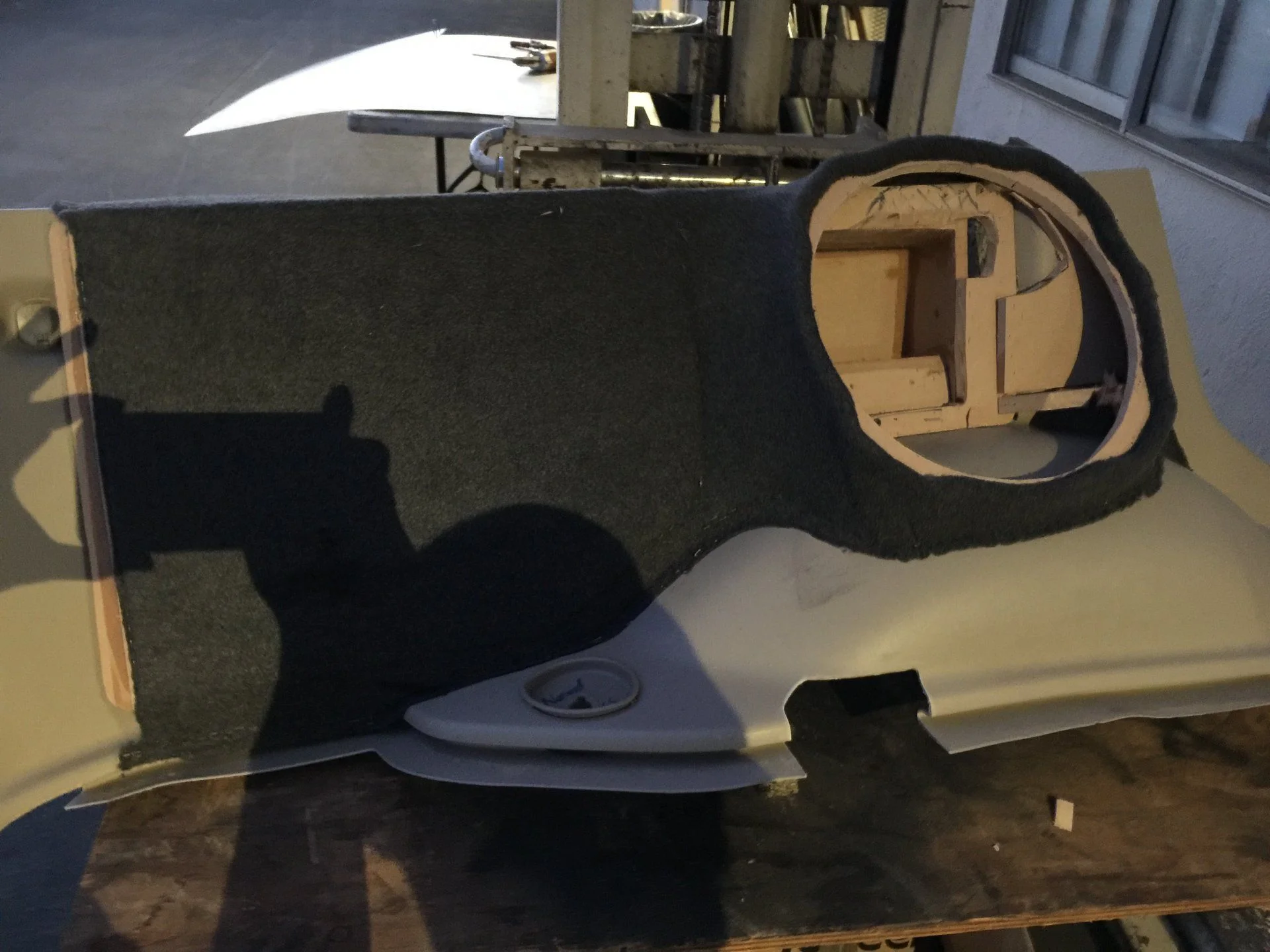

Got the truck back today. Only about 40% done. Waiting for the fiberglass box to finish before stereo shop will finish the rest of the install. Below is picture of the skeleton box.

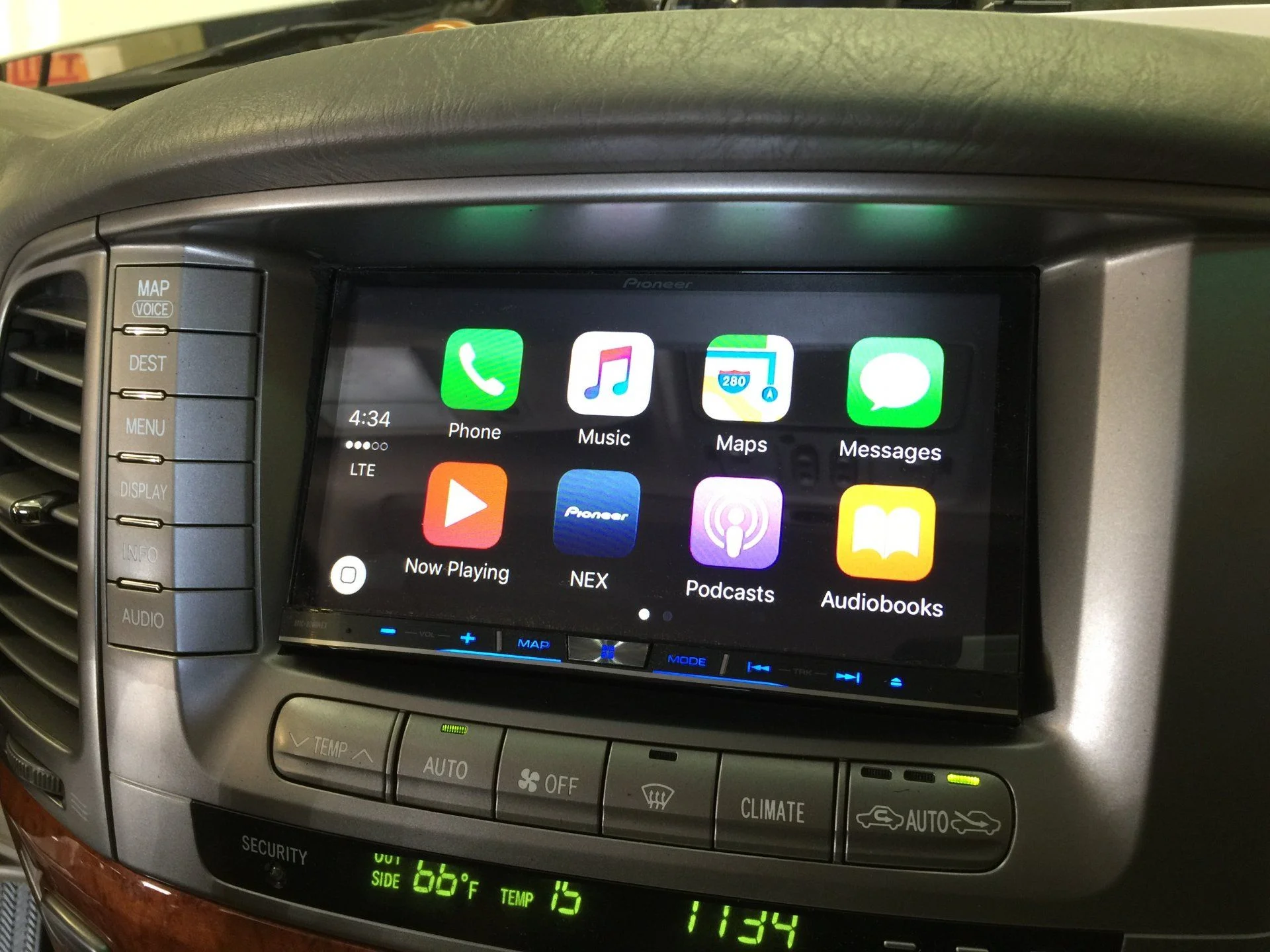

Had a chance to play around with pioneer today, stereo shop had left it with only front and rear speakers working (no sub). I decided to wire up my own sub amp and sub on a normal enclosure (12" JL W3) and boy it sounds amazing. It blows the ML system out of the park (remember the system was previously wired using the same amps and speakers bypassing ML amp. YOU CANNOT EVEN COMPARE!!!! EQ, crossover, dedicated sub output, and time alignment (individual speaker output control). Apple Car play is amazing, having a choice of either XM radio even at a demo mode, 2 Ipods, Itunes from my phone, Bluetooth audio, CD, FM (who listens to FM/AM anymore) and audio streaming. Endless options under one interface!!! Its definitely worth all this work!! I can stress it enough IT'S JUST PLAIN AMAZING!!!! Still need the front and backup camera, finish with custom housing for OEM screen and the custom fiberglass box. Can't wait until its all done.
